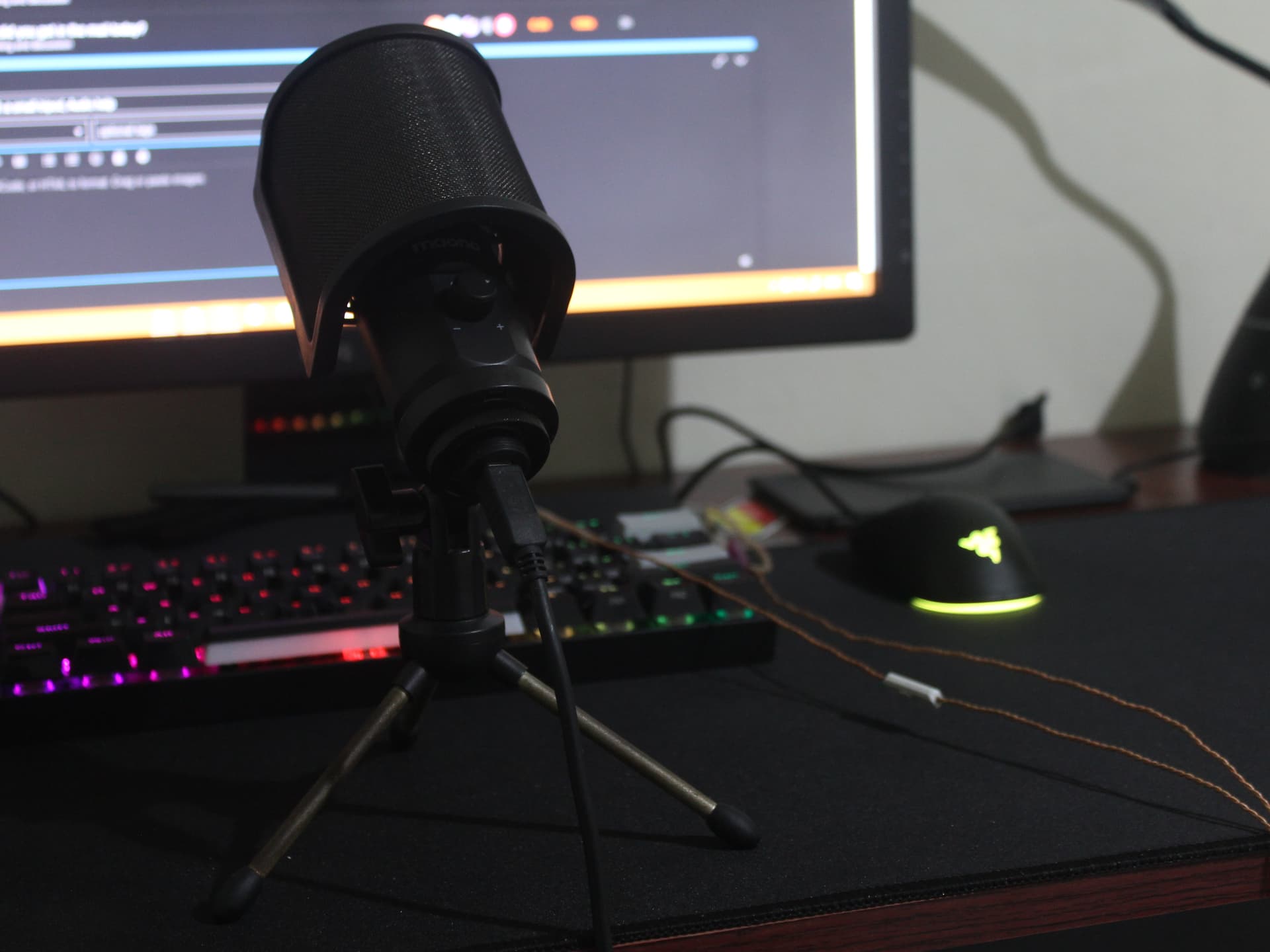

I have a Maono PM461TR that came with its own tripod, and my issue is that whenever I press anything on the keyboard with moderate taps, the vibrations reach over the mic and picks up the boomy sound from it, even with a shock mount (from my BM-800 microphone) And I think the thick rubber cable also absorbs the vibrations and it picks up the sound that way too. Do you guys have any methods of eliminating those low boomy frequencies without using high passes in EQ at post-production?
I also have a boom arm but my desk has no space for the mic stand to attach to, it is a frustrating predicament…

![image](https://www.keebtalk.com/uploads/db8059/original/3X/0/a/0ad86da871bdcd3131f327d7247eef9596f3798a.png)
You definitely want to separate your mic from your desk if possible. Is there a way to attach a shock mount to your current desk tripod? That should help as well
I tried but even with the shockmount, the USB cable it has transfers the vibration to the microphone diaphragm QAQ
Also weird thing to add, the shockmount I have is pretty much ineffective, tapping it still transfers sound probably due to how the mic was built, it isn’t the case with my BM-800 though
Seconding the recommendation of a floor stand - so far it’s been the only way I’ve been able to totally eliminate what you’re describing from my own recordings. I’m currently using a really cheap one and it does what it needs to, but I wouldn’t mind a more sturdy one down the road - say that to say you don’t have to spend a lot to get the benefit.
