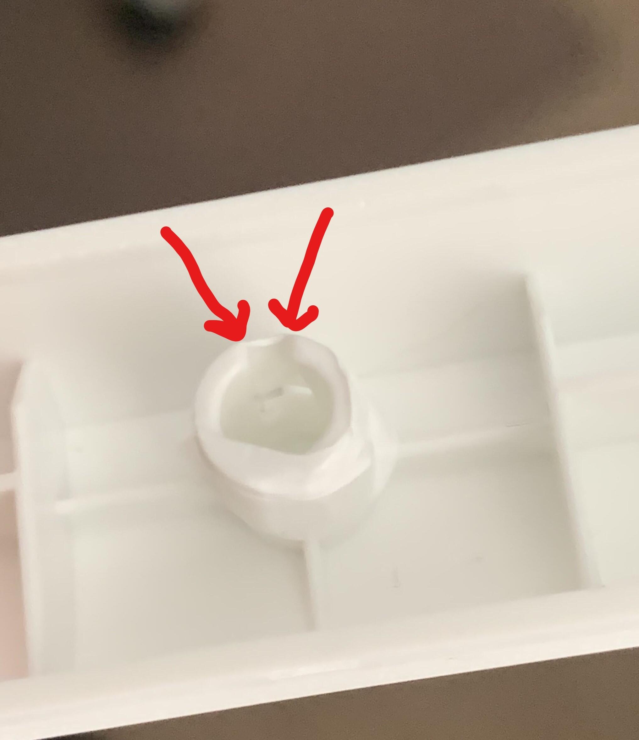

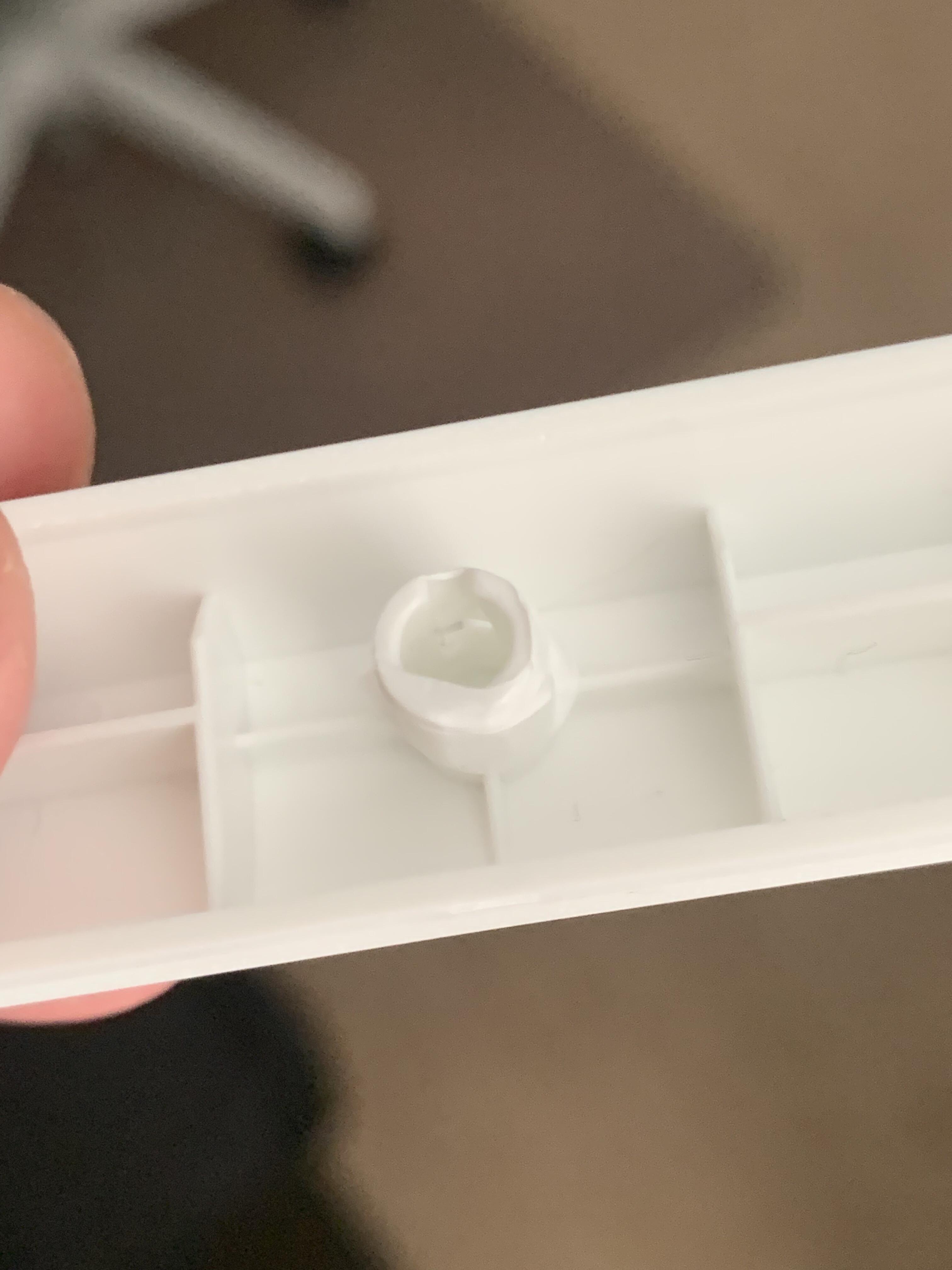

I just swapped out the space bar with one from another board and the noise is pretty much gone. So what issue on the space bar would cause this noise? I tried adding teflon tape to the stabilizer holes on the space bar but that didn’t change anything.
Could it be the stem? I seem to remember a mod to fix stems that have issues on topre. Either stuff the hole on the stem or wrap it. Hmmm…

No, it doesn’t do that on my other one. Maybe a tolerance issue
Yea, that’s what it seems like

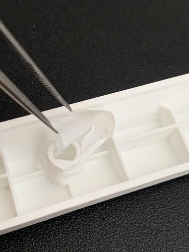

Okay, I found a solution but I don’t understand it completely.
Wrapped stem with Teflon tape
Sound fixed!

I don’t remember where I saw that recommended, but it works. Perhaps there is space between the notch in the stem and the slider nub where it causes the cap to rattle if they are slightly out of tolerance range?
This is interesting, because I think I have some alphas that make this noise on other boards. It would be a bit time consuming, but well worth it if you want to silence additional clacks. The tape stays in place quite well and is extremely easy to take off.
This isn’t adhesive tape. It’s a thin and slick sheet of teflon coated plastic often called plumbers tape that I bought for replacing a shower head about 12 years ago. I think it’s from Home Depot.
