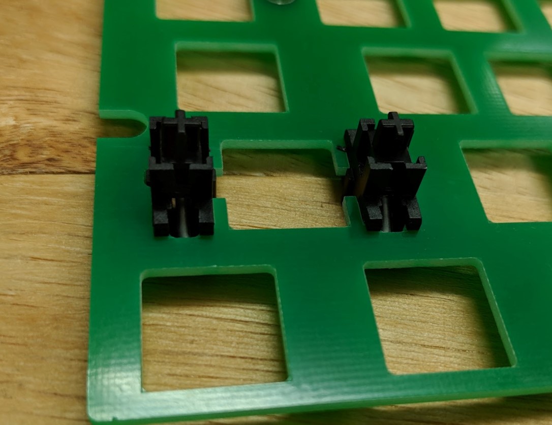

I might be the stab stems or cap itself banging off the the extra plastic bits that stick out on the top of the stab.
See how the tops of the stab housing extend up much higher than on PCB mount ones? You can shave those down some without it causing issues, although I can’t 100% promise it will fix your issue. That’s just my best guess based on you post & video.
Anything that moves will make noise when it hits other parts. In a stab, movable parts are:
  1. Stab wire - against stem hole
  2. Stab stem - against stab housing and PCB
  3. Stab housing - against plate or PCB
With stab wire, most of the noise comes from the wire hitting the sides of the stem. While you can wrap the wire ends, that interferes with movement so applying a thick glob helps. Be sure to inject fresh lube when it starts to rattle again.
With stab stem, it’s just slapping against the housing so smearing inner sides of stab housing with a layer of 205g0 will dampen the generated noise. Again, reapply as needed. Noise also comes from stem hitting the PCB. You can add band-aid landing pad but that makes it feel squish. I normally just stop at clipping.
With stab housing, any kind of gap in how it’s fasten to the plate or PCB will generate noise. This is why screw-in stabs are favored over clip-in or plate-mount stabs. Same solutions for your spacebar issue also works here. Anything that can reduce the gap will help: band-aid, paper, tape, rubber, nail polish, whatever. Remember that gaps exists around, below and above the area stab housing touches. It doesn’t matter if you can’t completely fill the gap. Reduced space to move means reduction in movement which means reduced noise. Anything is better than doing nothing.

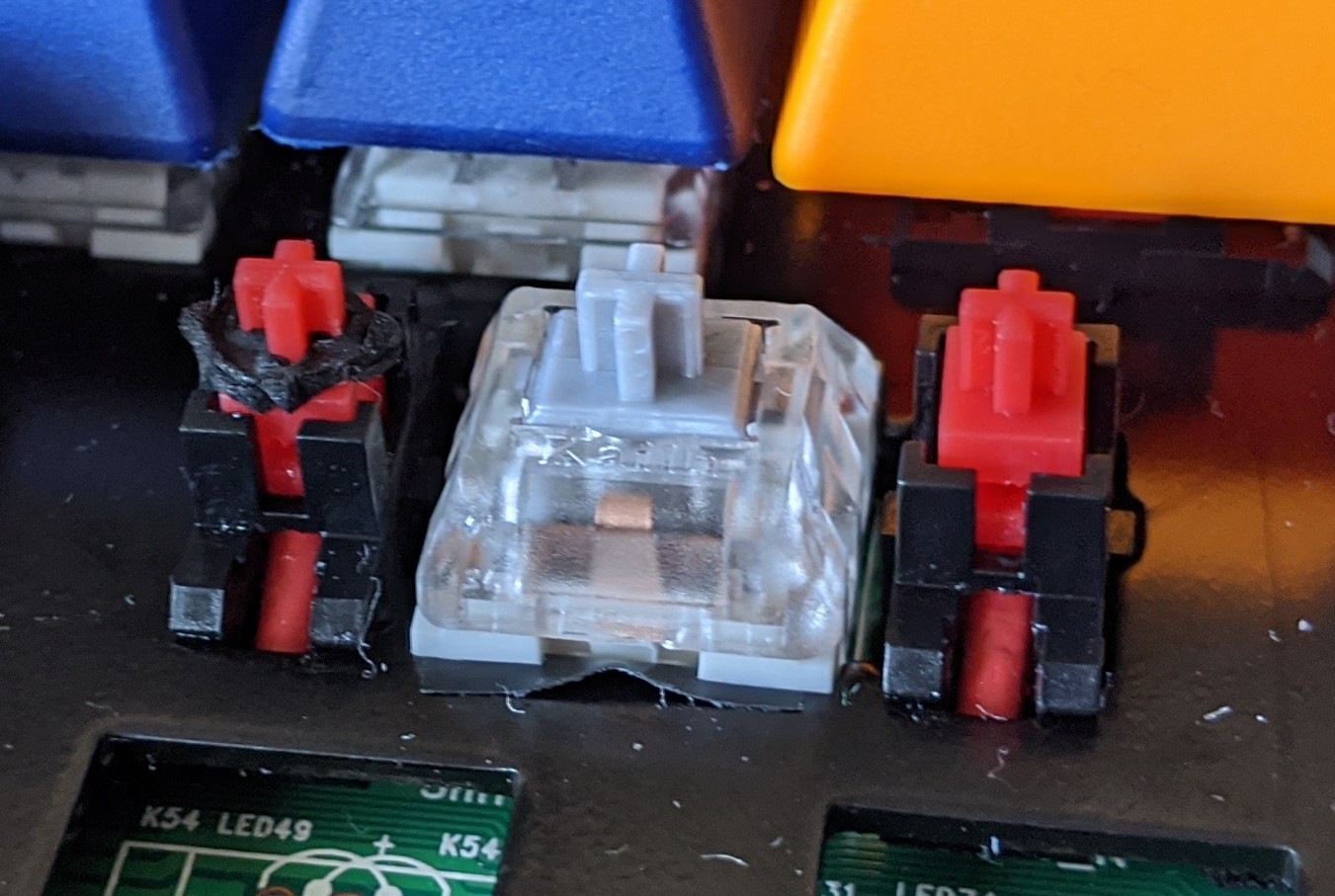

UPDATE: I’ve written my reply as a general famework for diagnosing stab noise. There is, however, one overlooked area which is unevenness. Without getting into how it happens (twisted wire, switch height, and switch stem dimensions, etc.), the symptom is keycap tipping to the side as it’s pressed. You may need other measures as well but, whatever you do, you’ll have to even out the height. What I use is switch rings, typically used to address North-facing switches rubbing against keycap. Even it out so there is no room to tip over then go from there.
Everything mentioned above is pretty much gospel. I stumbled across this post by @Walkerstop on teeter-totter stabilized keys that worked for me. I ended using an o-ring on each stab insert which prevented any unintended key wobble. Hope this helps.
Ha! And I thought I came up with that… I have found that it helps in a lot of situations, though - I’m using those same washers for north-facing switches on many of my stabs now.
They really help for those situations where the stab bottom-out is lower than that of the switch; which is even more of a concern for clipped stabs. Once I started using those washers, my band-aid modded stabs started sounding and feeling a lot better.
Thanks all for your ideas.
Padding the stab stem so it’s sorta “pre-pressed” and eliminate the wiggle room was a great suggestion. Previously I tried filling the + in the keycaps hole with paper towel fragments, but it worked as well as the idea sounds :sweat_smile:.
Seeing it done properly on the stem helped. Inconveniently, I don’t have those washer rings and am too impatient, so I tried it with some thin foam cut to fit.
Padding both stems didn’t seem to help that much, but then I had the glorious idea of trying two layers on one side, to force the caps in one of the extreme end of the seesaw, accommodating the angle that my finger tends to press.
And it sorta works! In synthetic tests there still some minimal wiggle, depending on where I touch. But in real typing it is reduced enough, especially on the Shift that is supposed to be quiet (linear). Since the Enter and Backspace use Box Whites, the remaining minor rattle seems to be more than acceptable. (Famous last words).

Ended up needing the cotton balls (shreds, rather). It was a bit tricky to get the right amount staying in the right spot when inserting the wire, but so far it has a good result. Feels better than my crappy stem paddings, too. Hopefully this is the enduring solution for my troublesome stabs…
