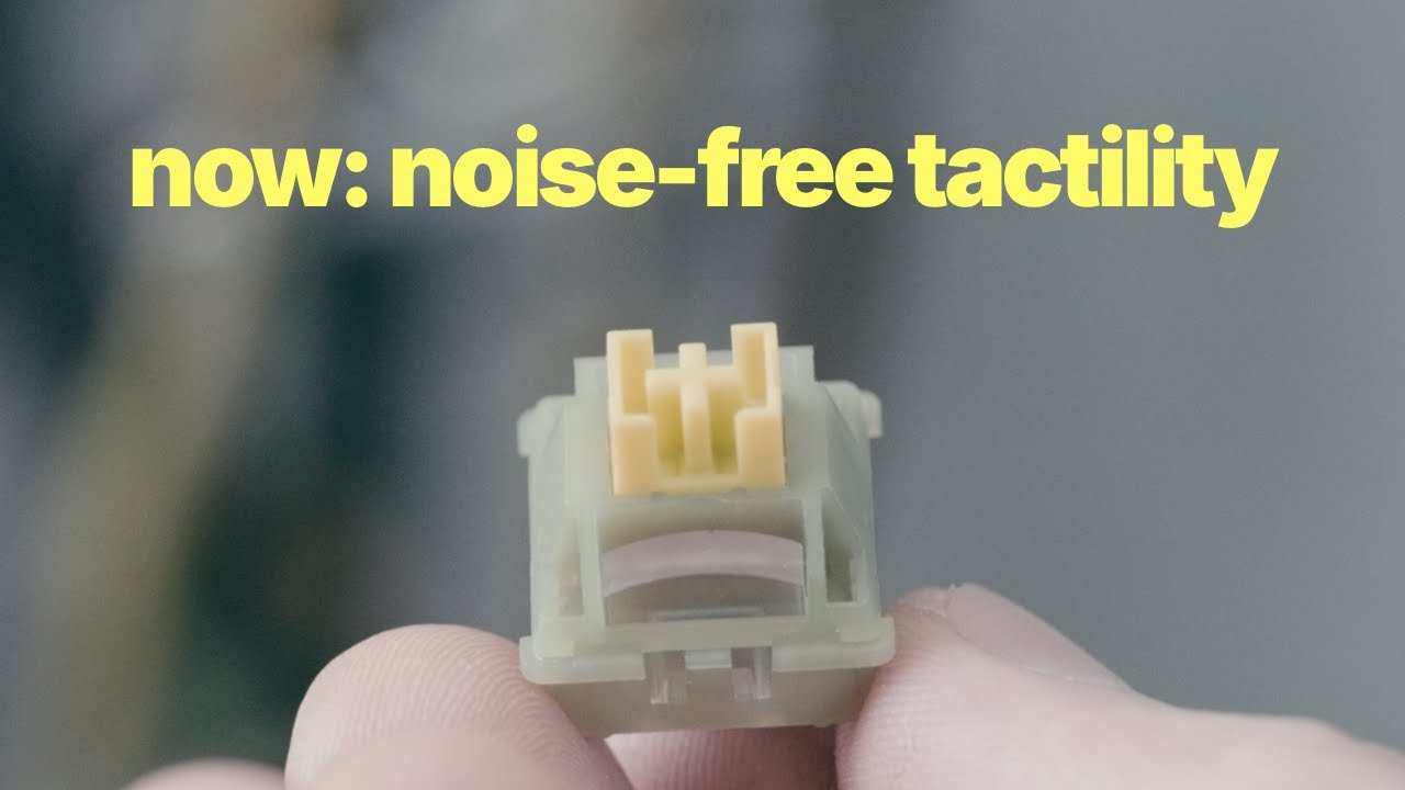

Jade Yellow
These are relatively consistent with one another, for OUTEMU silents. They really are quiet, at least on a semi-dampened board. Just some dampener-shuffling noise. Quieter than many office keyboards.
So it fits the bill for silencing.
Feel-wise, it’s a toned down D-bump U4 Boba, maybe. A bump that takes up a lot of the keystroke, but is fairly mild in intensity. Not a heavy-tactile. Not in the least.
It bottoms out with a pillowy or marshmallowy softness, mitigated somewhat by the extended tactile event.

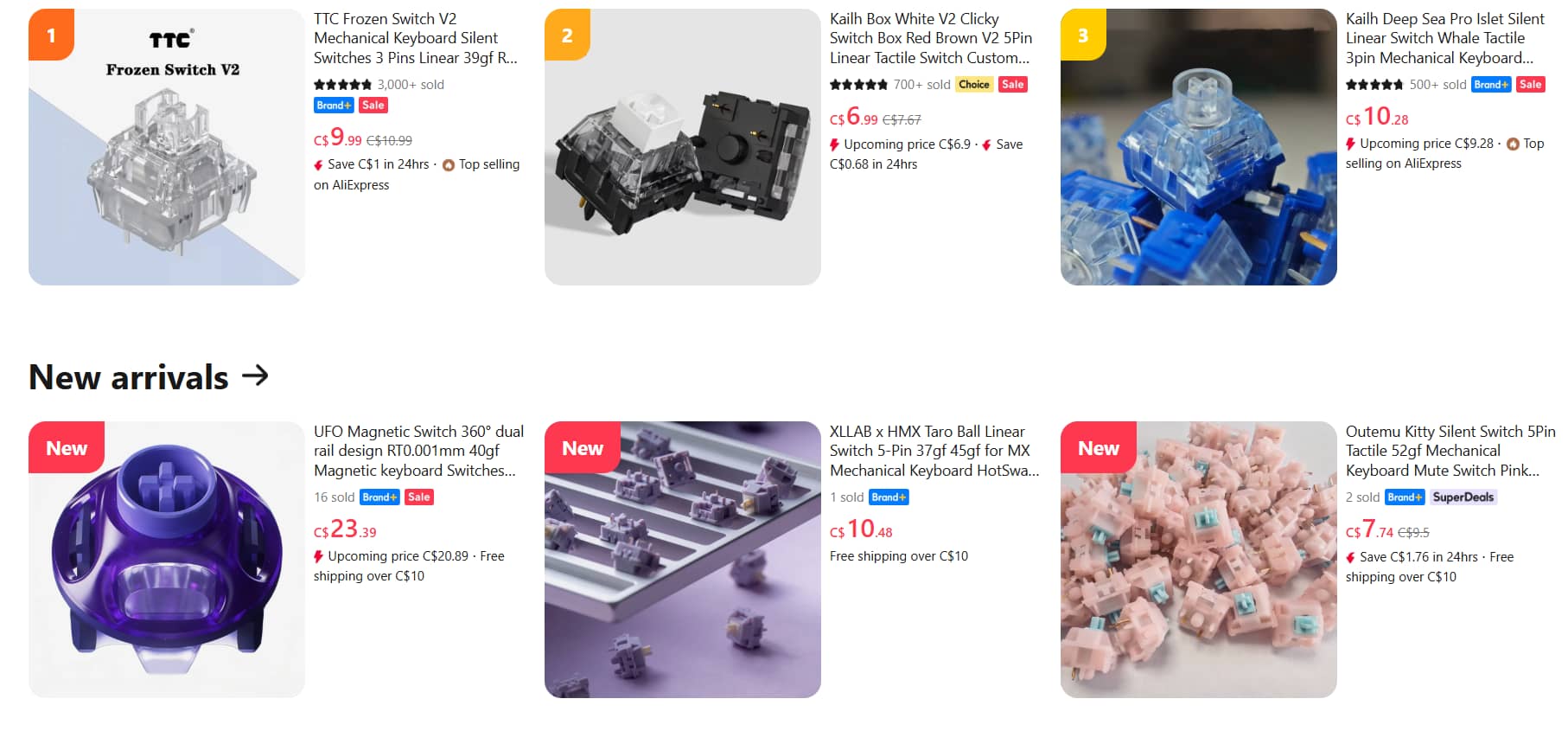

For linears, Peach is the cheapest. But I strongly suspect that Akko and TTC are offering strong competition, maybe HMX, even if more expensive.
I would definitely buy samples from this store during the sale [link in image]:
ItisTemp
If you ask nicely, they might even add one or two sample switches of other switch types. Just add a comment when purchasing.
Try the TTC Frozen V2, Kailh Islet Silent Linear, OUTEMU Kitty silent tactile, and [from a different store] the JERRZI Misty Purple Silent Linear. It would be hard to find those items for cheaper, this month.
Yes, Jade Yellow is still my pick for affordable silent tactile. I am not certain what the best silent linear is, given the diversity of choices today.

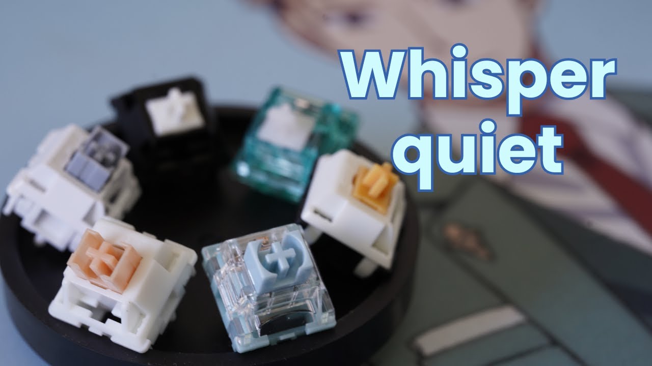

I asked somebody here who knows these things for more information about silent switches.
This person prefers partially-dampened switches. Switches that are quieter than regular switches [muffled or muted, not silenced], and crisper than OUTEMU.
Here is what that person recommends:
LINEARS: LICHICX Silent Lucy (made by WEKT) and Gateron Zero Degree.
TACTILES: Kailh Midnight Pro, Kailh Deep Sea Pro, and TTC Bluish Whites.
I think that the tactiles correspond with what we already know: Kailh Midnight Pro and Kailh Deep Sea Pro [Whale], and TTC Silent Bluish White are pretty good if you want a balance between crispness and silencing.

For linears, I would explore TTC Silent Frozen V2, Kailh Deep Sea Pro [Islet], Bobagum [if budget allows], and Gateron Zero Degree.
OUTEMU Silent Jade Yellow is still the best quick tactile option for you.
Linear option is unclear - there may be several good choices. Silent Peach is the most affordable.

I just want to add emphasis to the fact that there are the “TTC Silent Bluish White” switch and the “TTC Bluish White” (non-silent, half-dampened variant). Easy to mix up when ordering if you’re not careful. :slightly_smiling_face:
