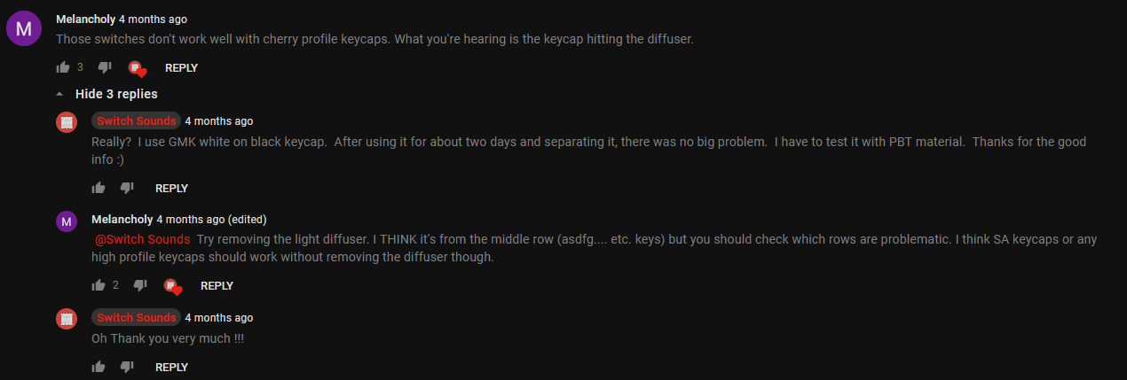

While this sounds possible, I have a suspicion this person is off-base about their diagnoses. Have you tested it with removed light pipes?

Sure enough I am using GMK on this board and I removed the diffuser and the terrible noise from the NCR switches is gone…
The diffuser removal requires opening the switch, so this is going to be a very boring project one day when I have time. Good thing I put them on a hotswap board.
