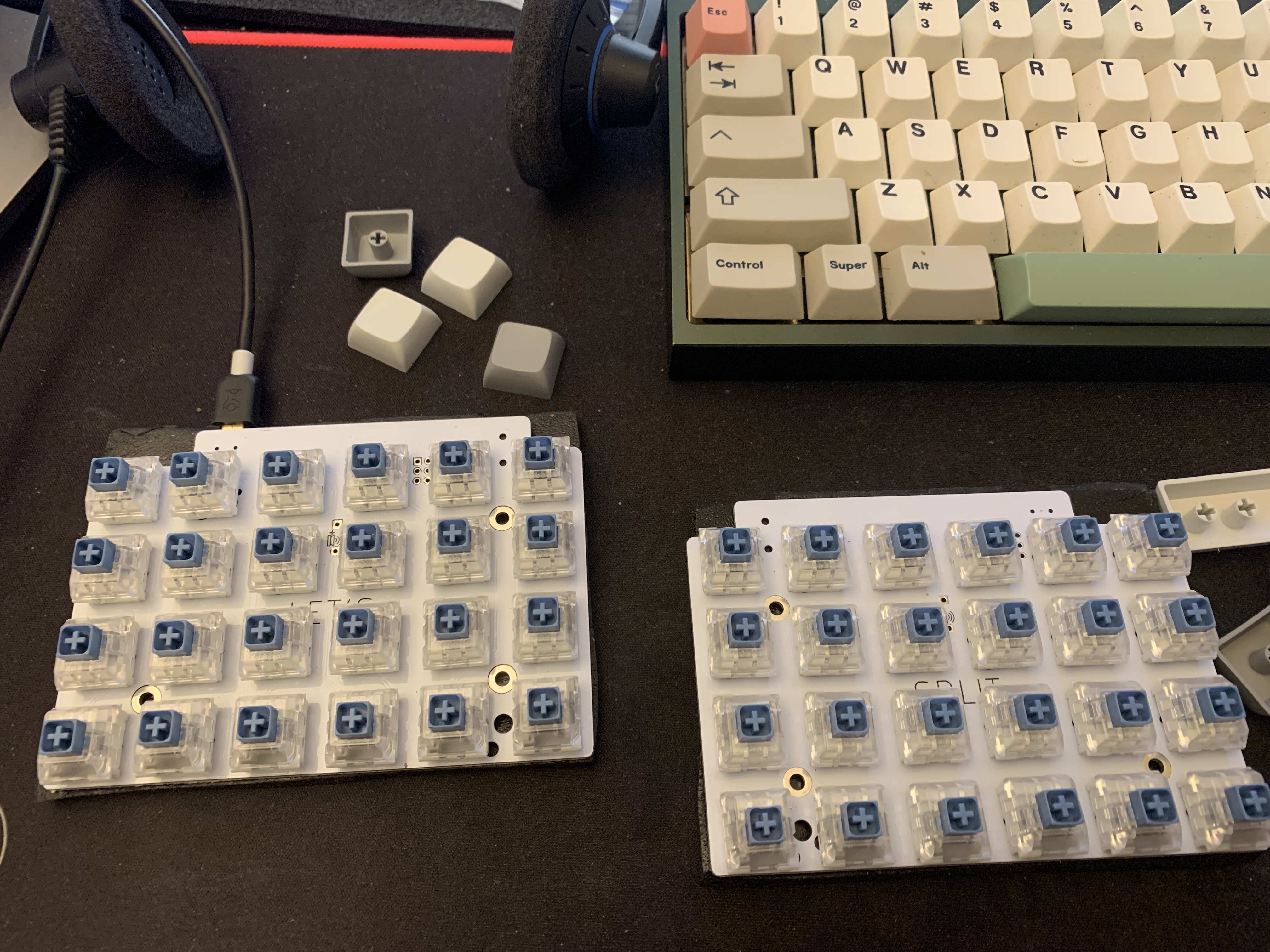

I was thinking about getting 1upkeyboards’ Sweet 16 Macro Pad when I saw Vitamin Included, a Let’s Split fork, in the list of keyboards supported by VIA. I had gotten Vitamin Included rev1 from NovelKeys long time ago that was gathering dust since I weaned off ortholinear.

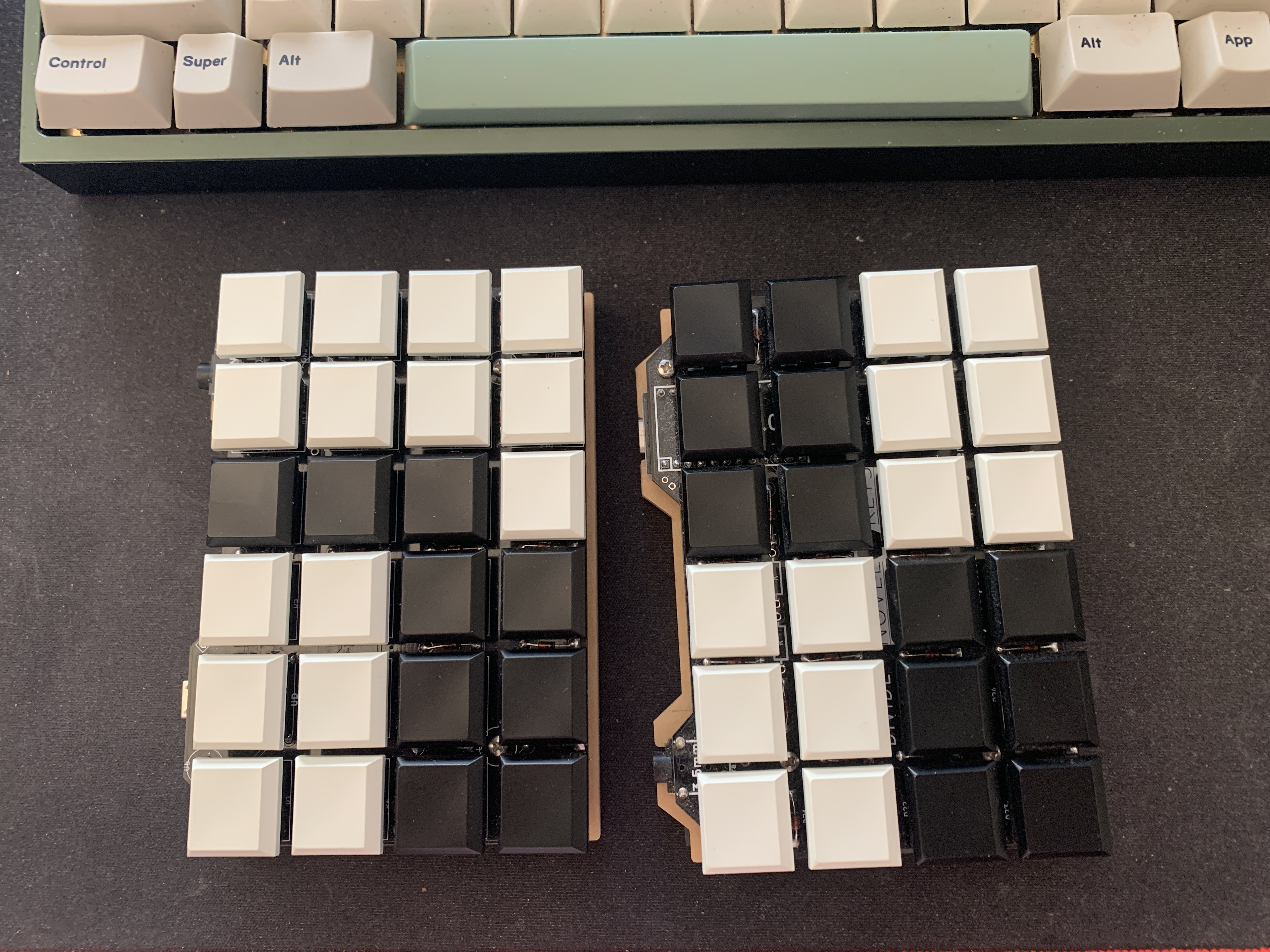

Each side can be used independently so, after flashing VIA firmware onto both PCBs, I now have two macro pads that can be programmed ad-hoc. . I only need one so the leftover macro pad will go to my son.
If you have unused Let’s Split boards supported by VIA, turn them into macro pads, Two for One! ![]()
Those cheap blank PBT XDA keycaps in the photo are handy for macro pads because you can write on them using a Sharpie then rubbed off later with isopropyl alcohol.
