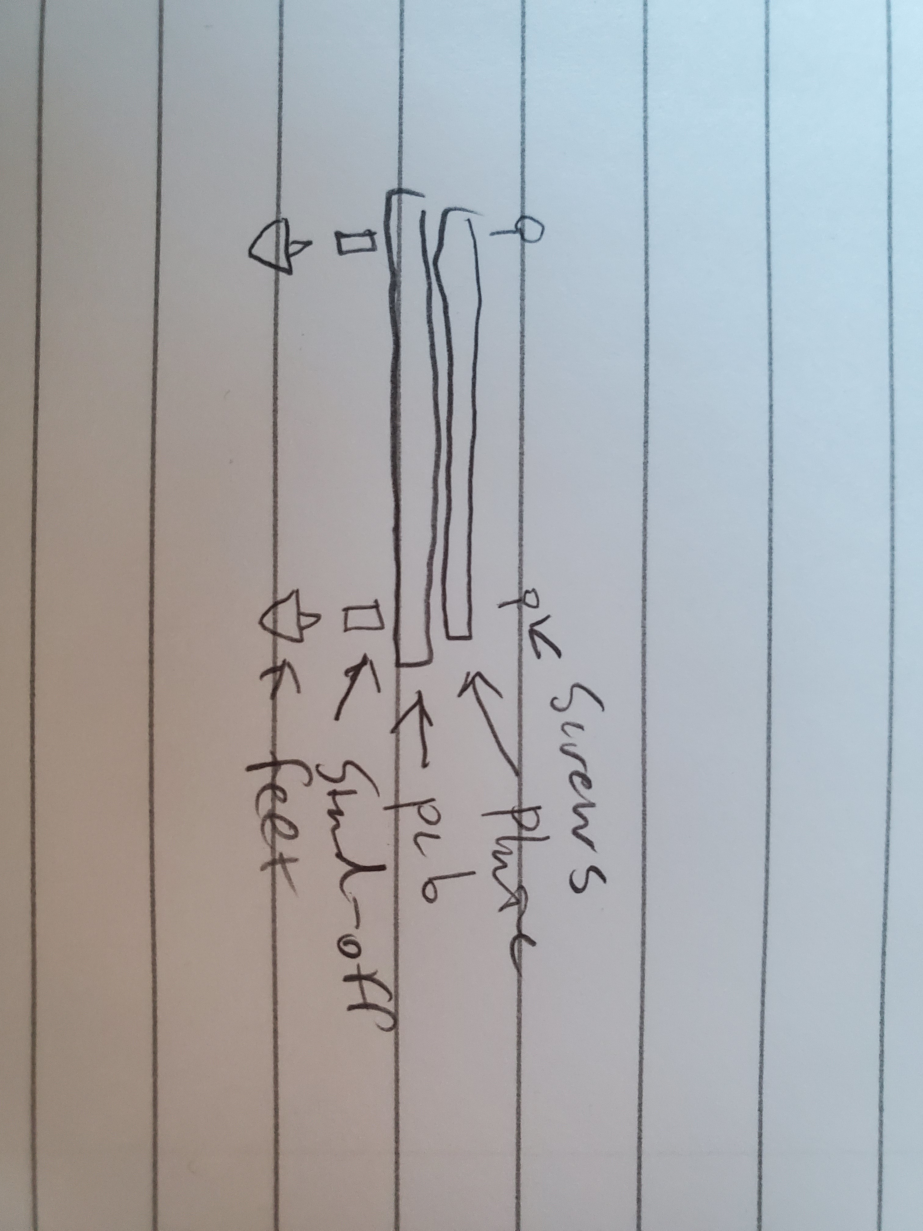

Yeah, what if you had stand offs that screw mounting plate to pcb could screw into. Then the other end of stand off got some rubber feet threaded on?

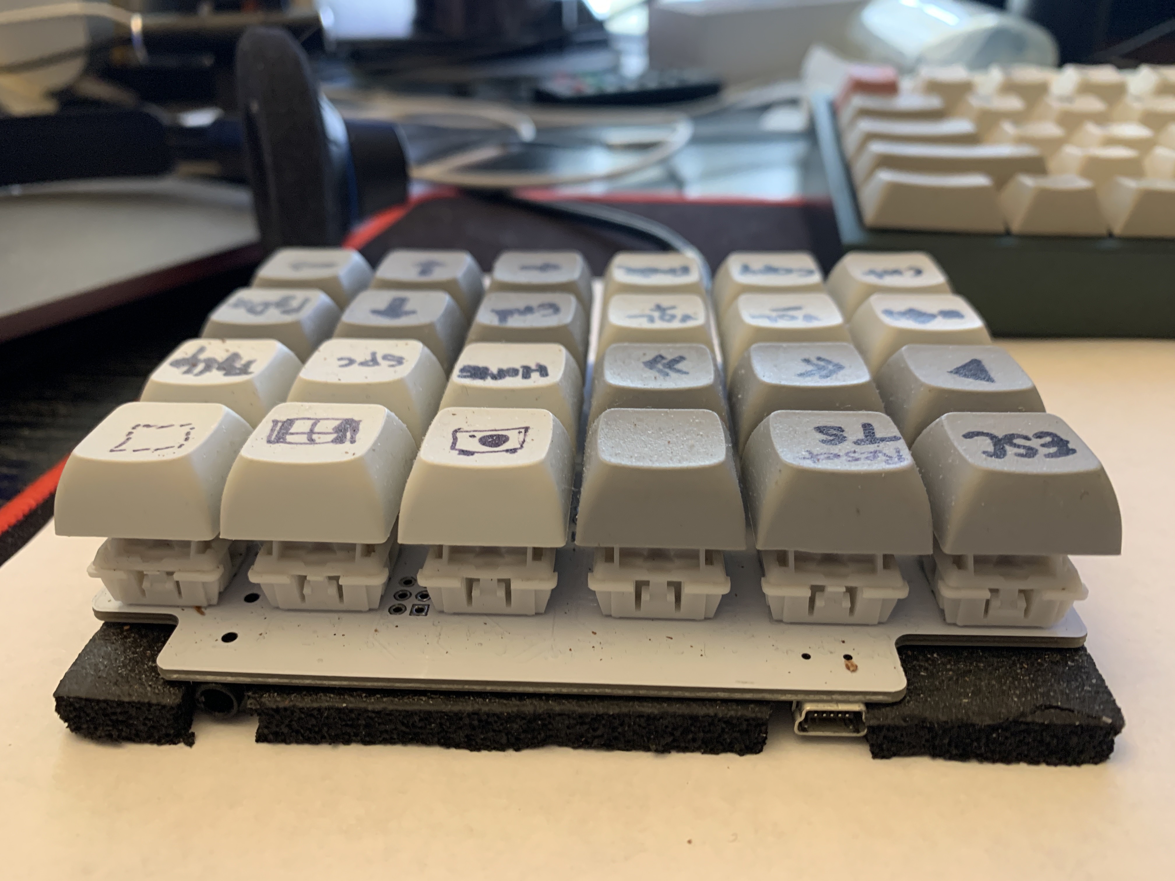

My caseless 6x4 macropad (left-half of a Let’s Split+VIA) with just foam bottom. Mauves are better plateless IMO. Sickest macro on it is “Reset TS” which restarts typescript service. Urgh.
