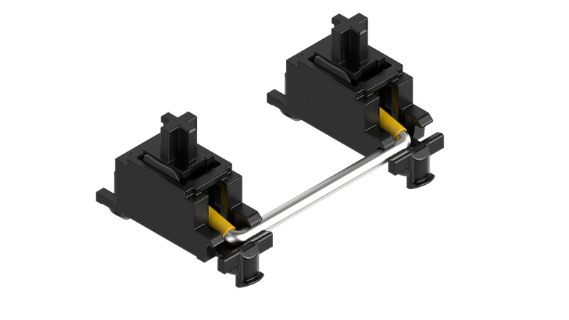

I wonder how well they’d do on the end of stab wires…
Caulk is good in that it is generally very hydrophobic, non-conductive, and malleable. Though you will run into adhesion issues. General purpose caulk likes rough surfaces to adhere to. More specialized solutions like GE silicone adhere well but are nearly impossible to truly ever remove.
Probably not well unless there is some grease between the wire and caulk.
Have you ever tried RAMA’s heat shrink technique? All my attempts resulted in no key return. I’d love to know what I’m doing wrong.
https://rama.works/silencing-stabilisers
just posted on this Keyboard Chores: Share your projects! - #23 by ddrfraser1
I haven’t tried it yet - I’m guessing that method’s success depends heavily on the tolerances of the given stab; I’ve read comments from people who swear by it - but I think I’ve read more where folks experienced what you have.
Edit: @ddrfraser1 - That’s really cool. It reminds me of the pre-cut modular foam from KBDfans - I’d imagine your method is less expensive.
I’ve tried the heatshrink mod and it didn’t make any noticeable difference for me. putting lube inside the housing where the wire touches, however made a world of difference.
