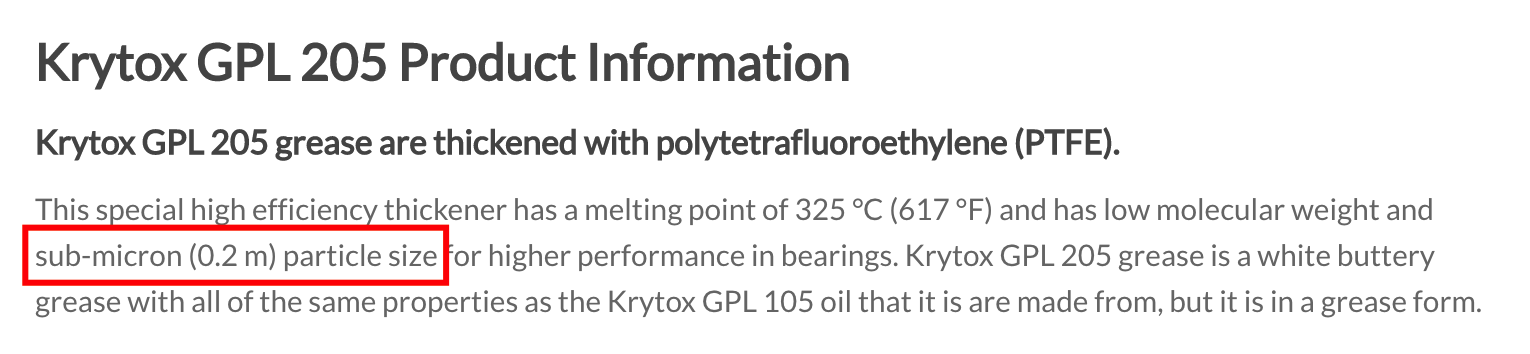

Turns out 205g0 has 0.2 micron particle size so 0.25 micron diamond paste is in the neighborhood.

You may want to consider ordering a “variety” pack of the paste to see which one will work. The PTFE particles in lube are smaller but they serve a different purpose. If you go too small you could be using the switches for a long time to make them “vintage” smooth.

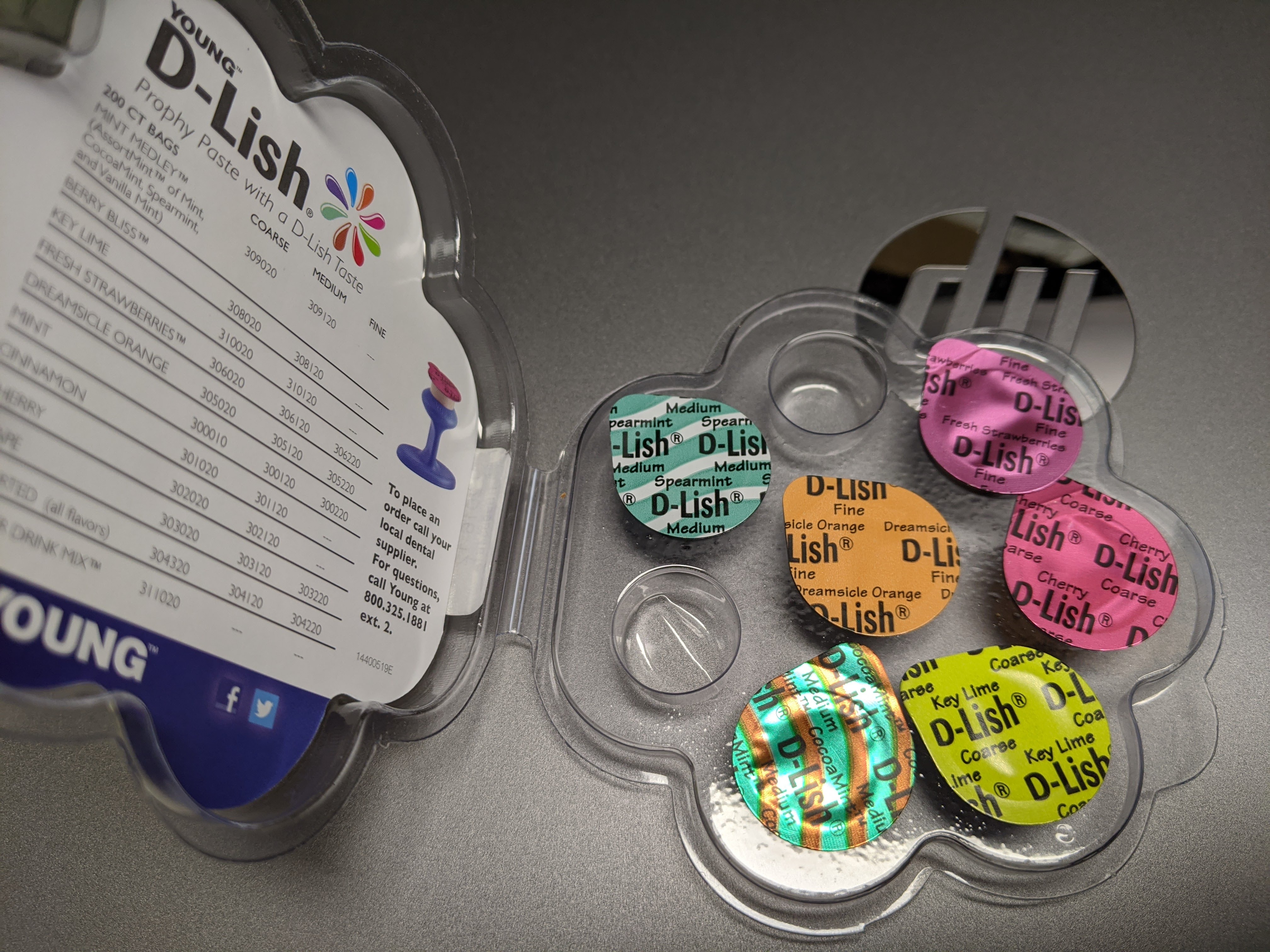

Toothpaste typically has Small amounts of prophy paste In it, which is the abrasive substance, that a dentist will use to clean your teeth.
Clinpro Prophy Paste contains perlite, a unique abrasive particle. The perlite in Clinpro Prophy Paste converts from coarse to fine grains when applied to a tooth surface during a prophylaxis. This self-adjusting abrasive property allows the paste to be used in both the cleaning and polishing of tooth surfaces. source
Cleaning, abrasion, and polishing effect of novel perlite toothpaste abrasive
Good call. I actually did try prophy paste that was medium grit. My wife had some samples from college that I happen to have at home… Attempt 1 resulted in the worlds scratchiest switch, one Boba U4 was sacrificed in this :frowning:
I have a fine grain prophy paste, I could try tomorrow. Looks like there is a choice of strawberry or orange flavor.
Prophy paste looks promising. Self-refining and delicious! :slight_smile:
