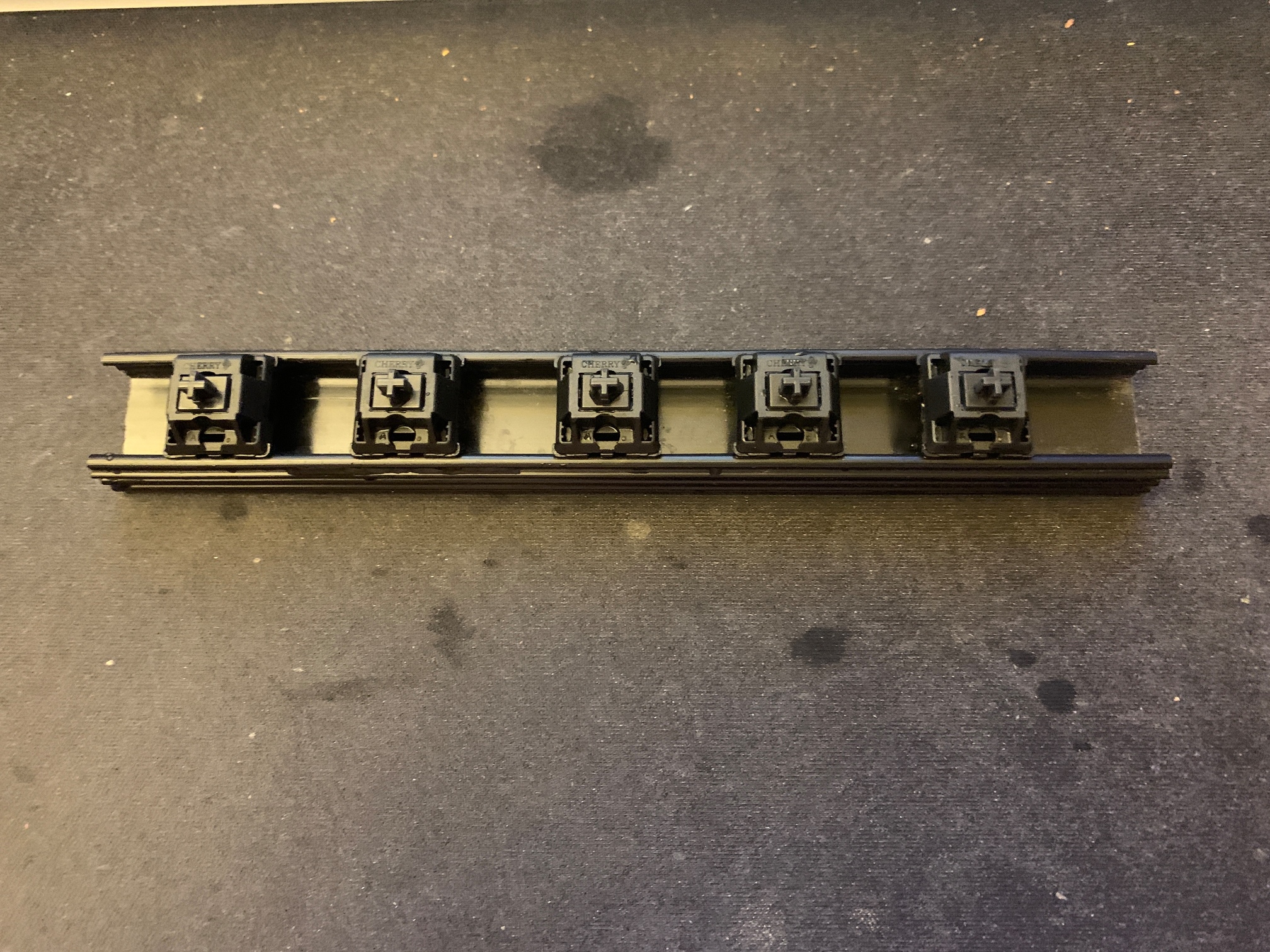

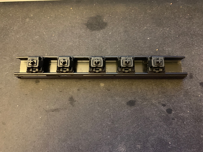

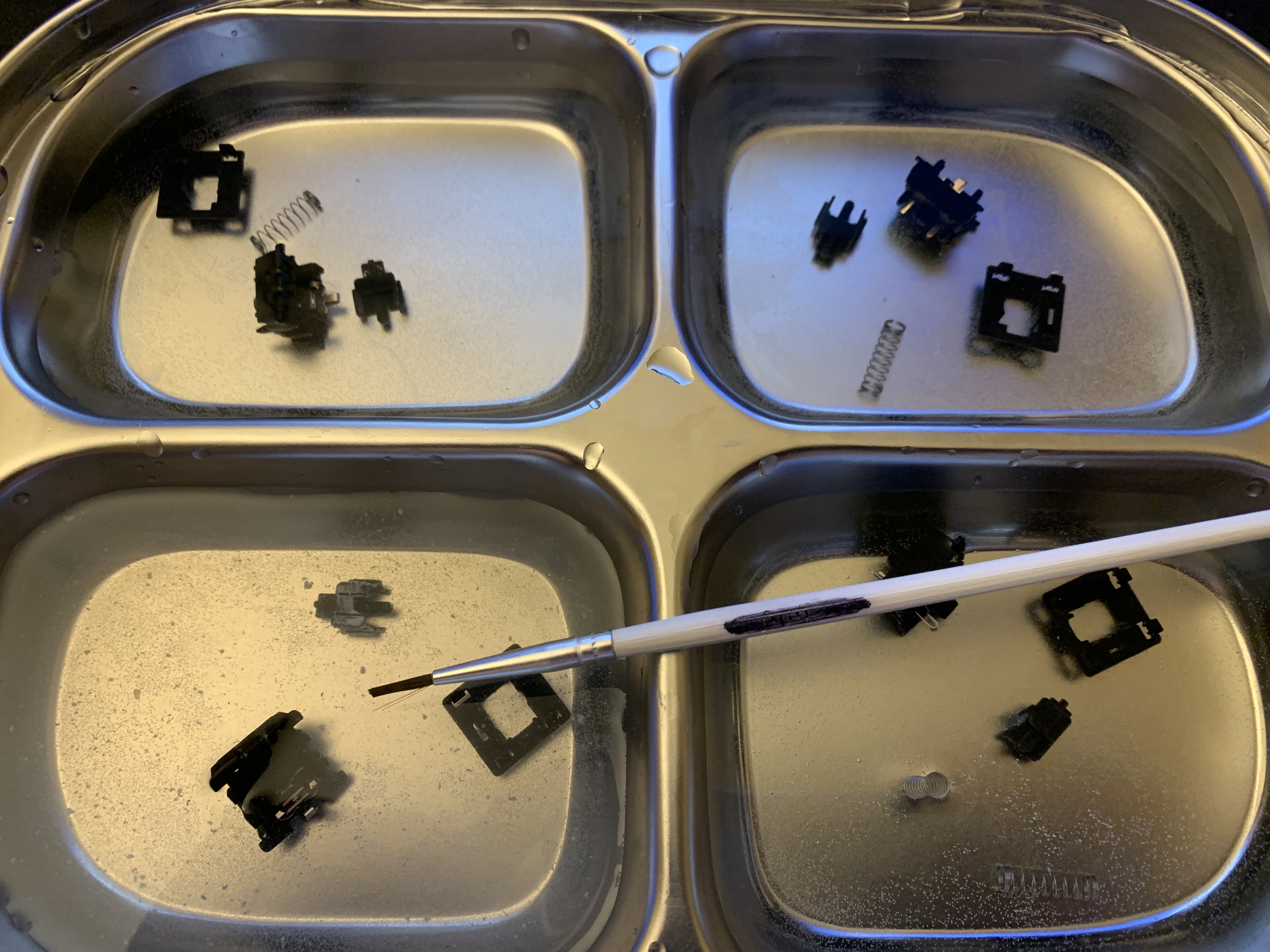

After 2 1/2 hours of polishing by balling over the switches, I washed and reassembled the switches. I don’t think more than two washing bins are needed.
While polishing, I set aside a switch every 30 minutes. So switches below represents 30min, 1hr, 1 1/2 hrs, 2 hrs, and 2 1/2 hrs of polishing with 0.5µm diamond paste. Intention was to find the optimal duration. Note that this was active polishing, not causal polishing-in-use while typing. I basically rolled a ball across switches constantly.
Test result was inconclusive because even the switch polished for just 30min was pretty smooth and smoothness increased ever so incrementally every extra 30min. Improvement seem to slow down after 2hrs but I’m not sure. I can say this though: even just 30min of polishing felt impressively smooth.

Just curious are cleaning out the diamond paste with an ultra sonic cleaner? or with just plain water?
trying to see if I should look into getting one or not. If I do I need to find another non-keyboard use for it :wink:
I don’t have an ultrasonic cleaner but I’m pretty sure it’ll do a better job at cleaning. I’m using plain water because plain water + hand brushing works well enough for simple linear switches.

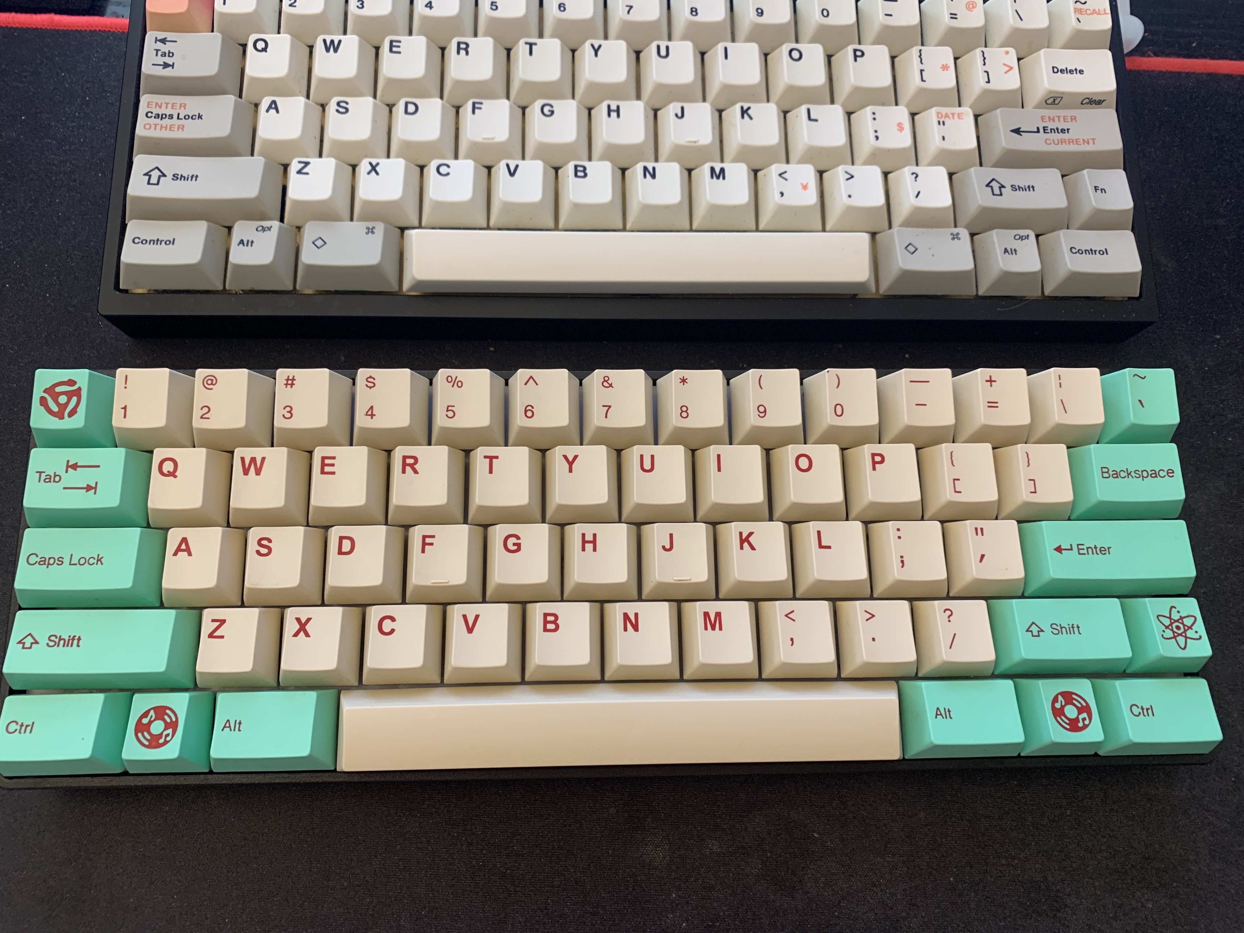

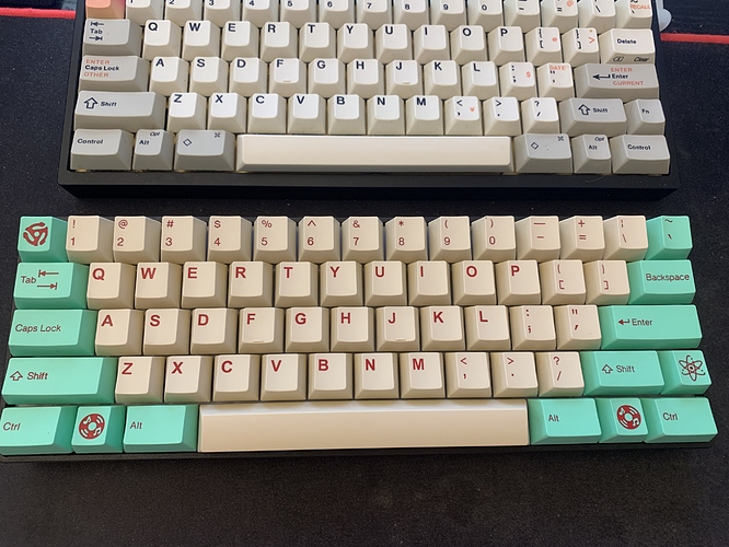

I had only ~20 unlubed Cherry MX Blacks on hand so couldn’t polish enough for a board. The rest came in today so now the board is ready to be stepped on for leisurely polishing while coding. The case I chose is plastic Poker board, light enough for keys to be fully extended.

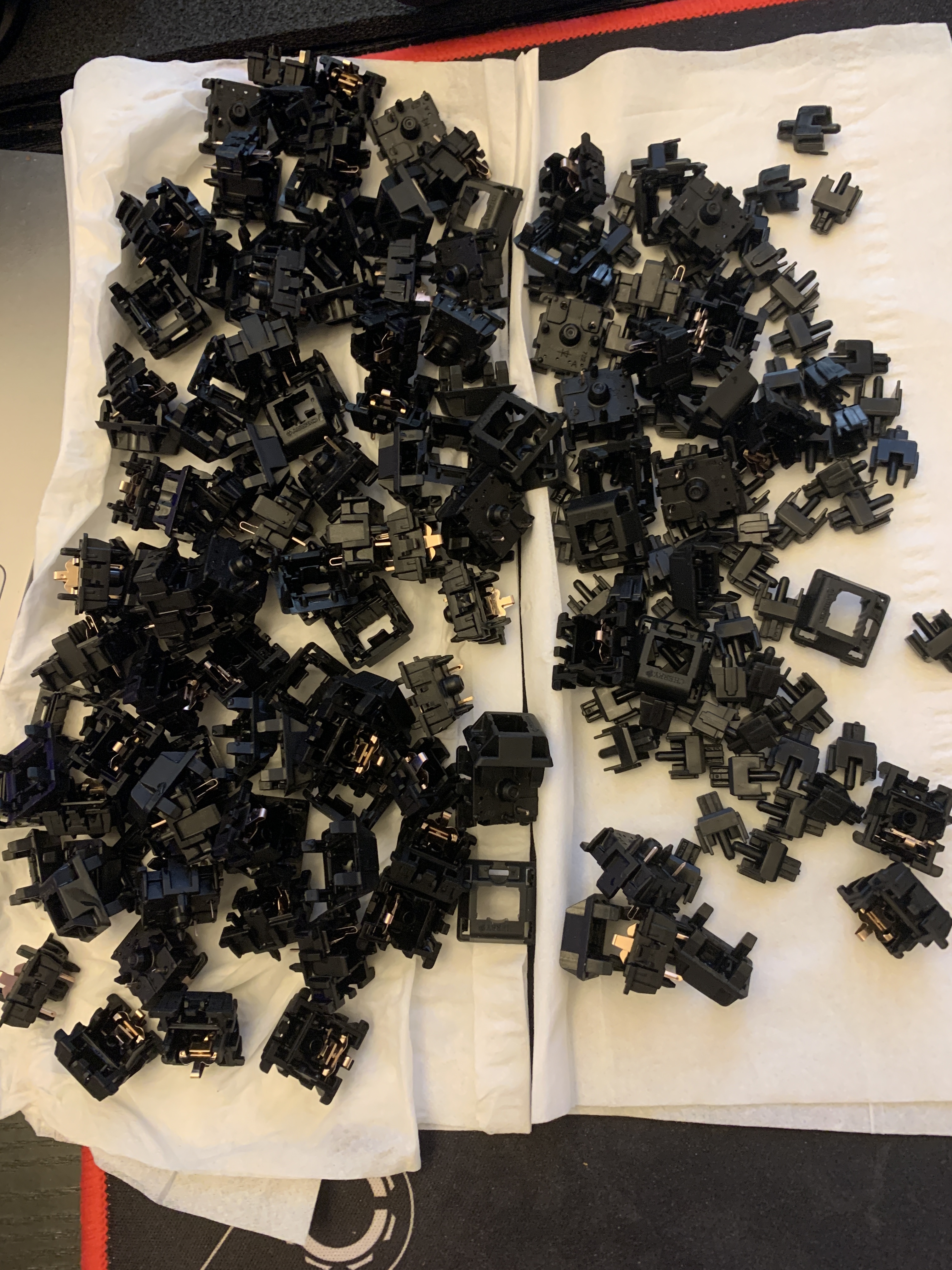

Polished blacks being dried before reassembly. Have not yet decided whether to lube them or not. It’s skating smooth unlubed.
