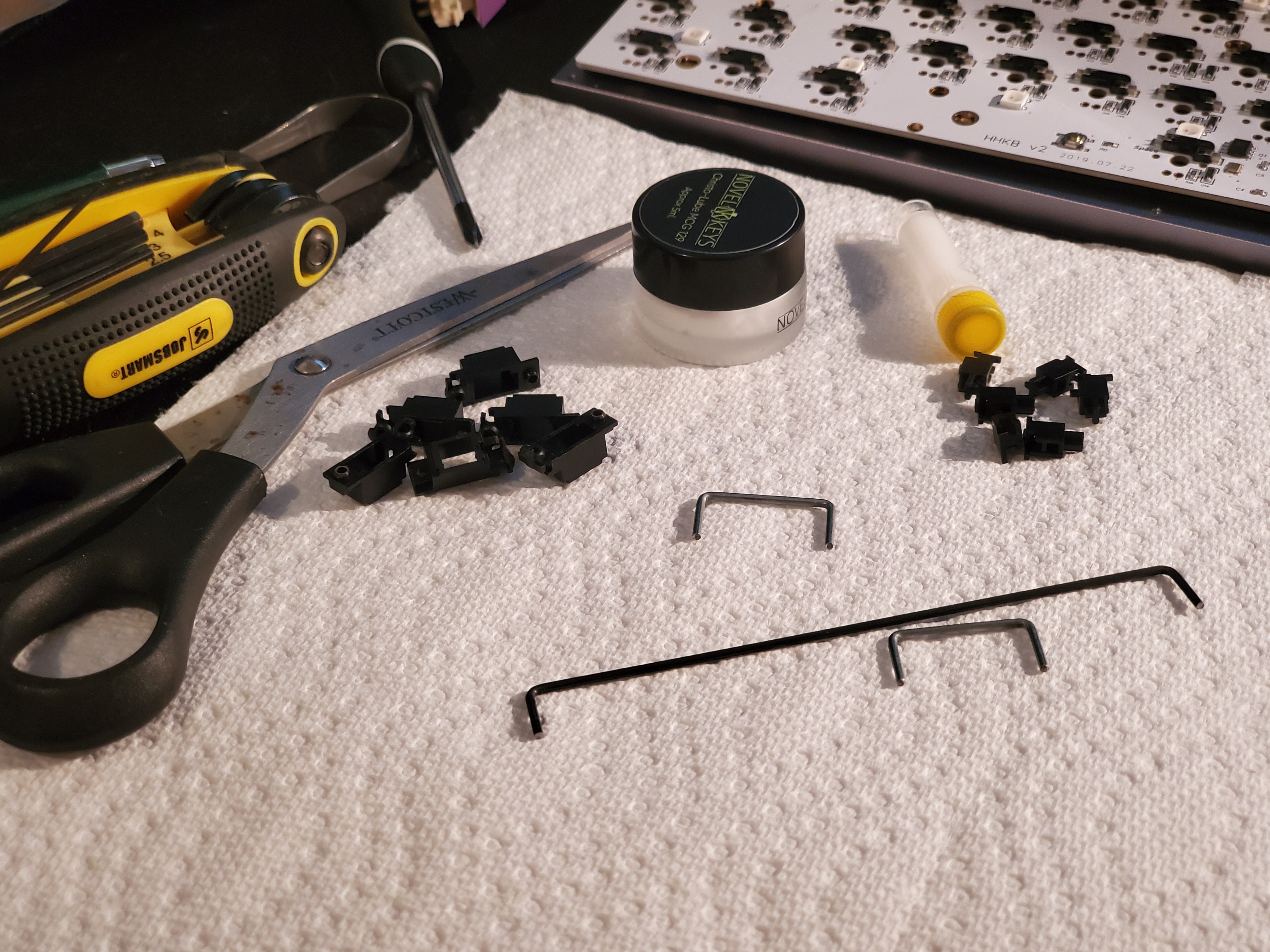

First things first, the disassembly and stabilizers. I decided to try a mix of Christo-Lube MCG 129 and 205g0, but I ended up realizing that it made the stabilizers too sluggish and sticky, so I ended up with 205g0 and some Finish Line on top to keep it smooth but not overbearing.

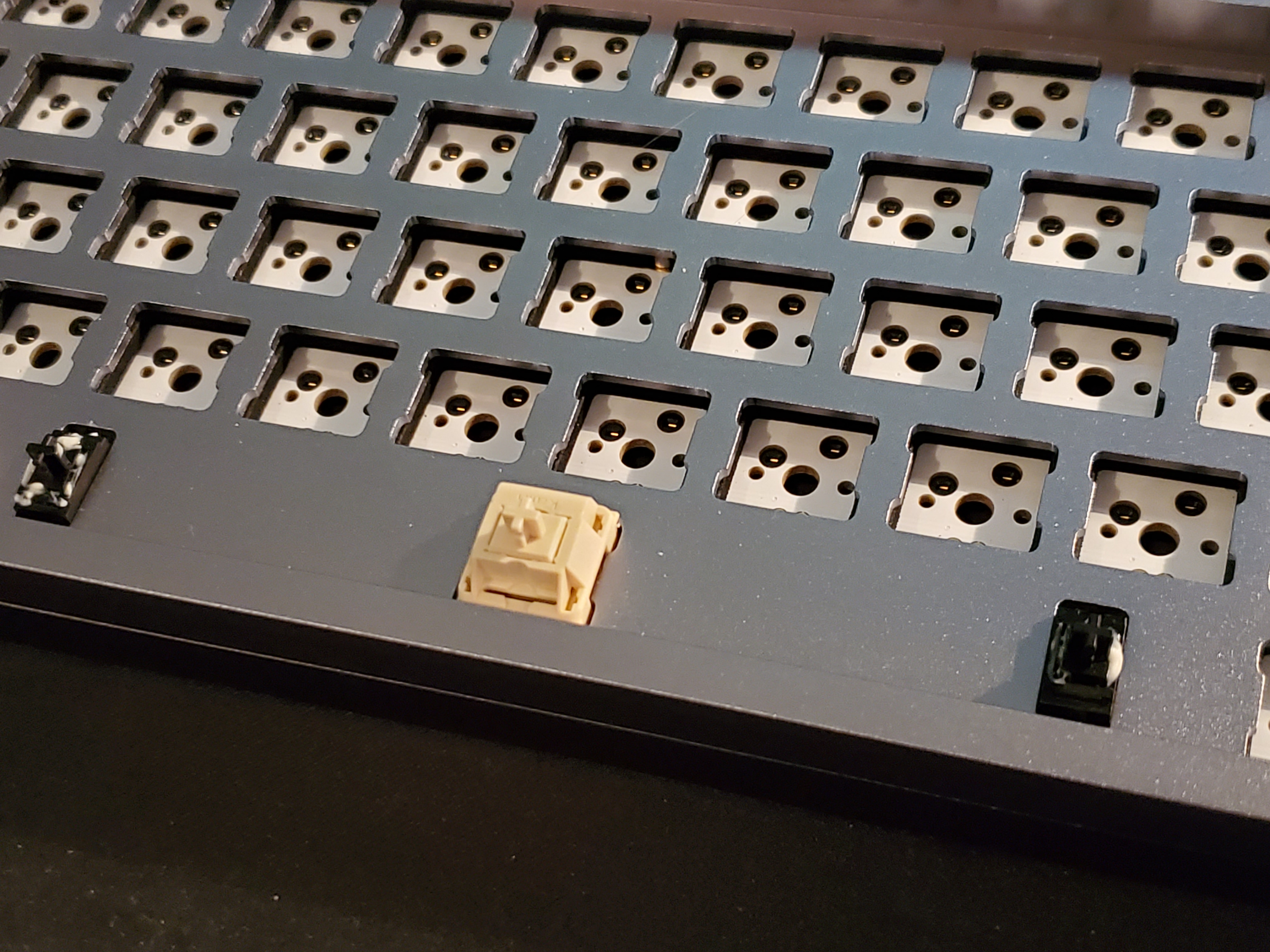

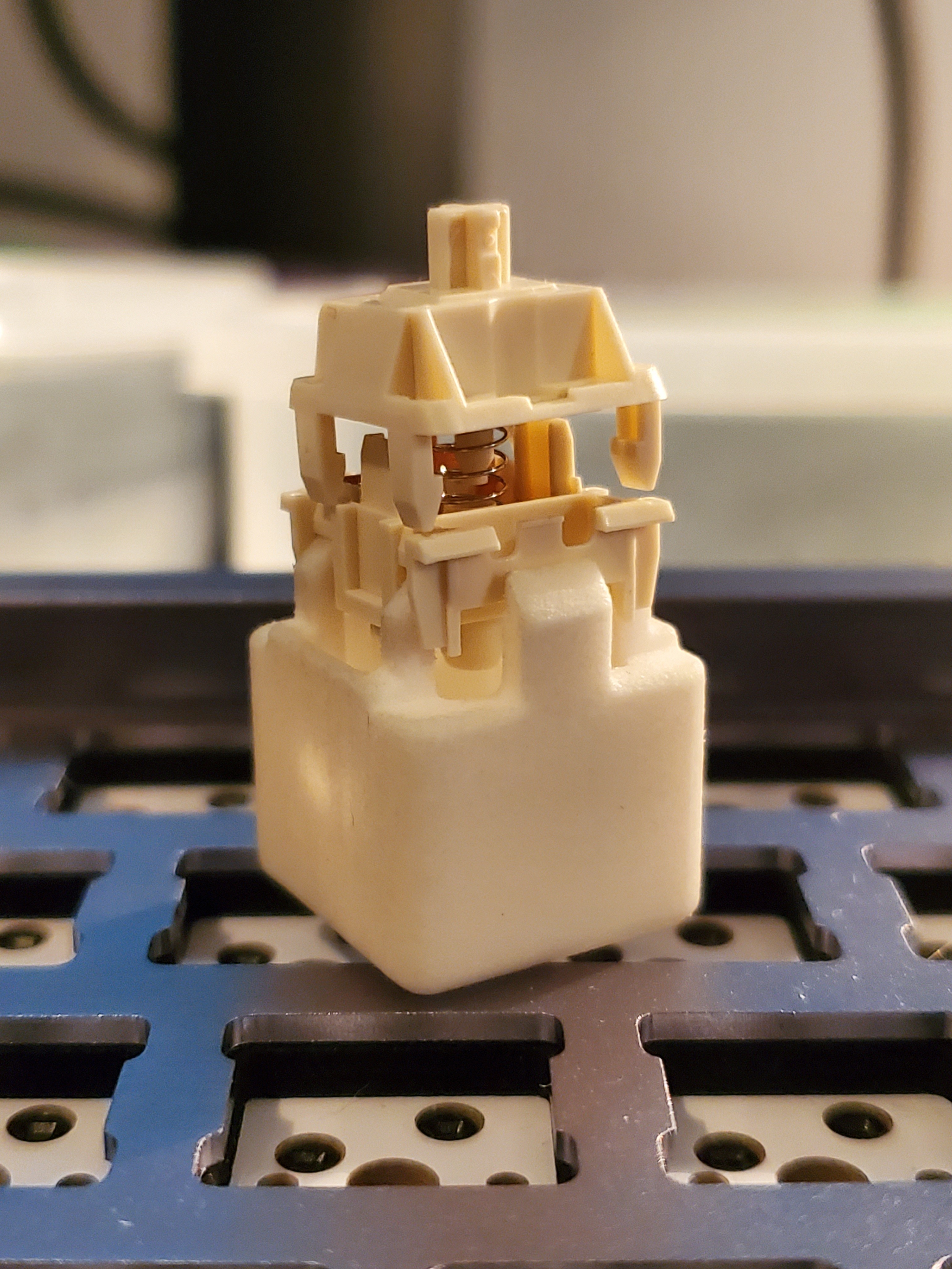

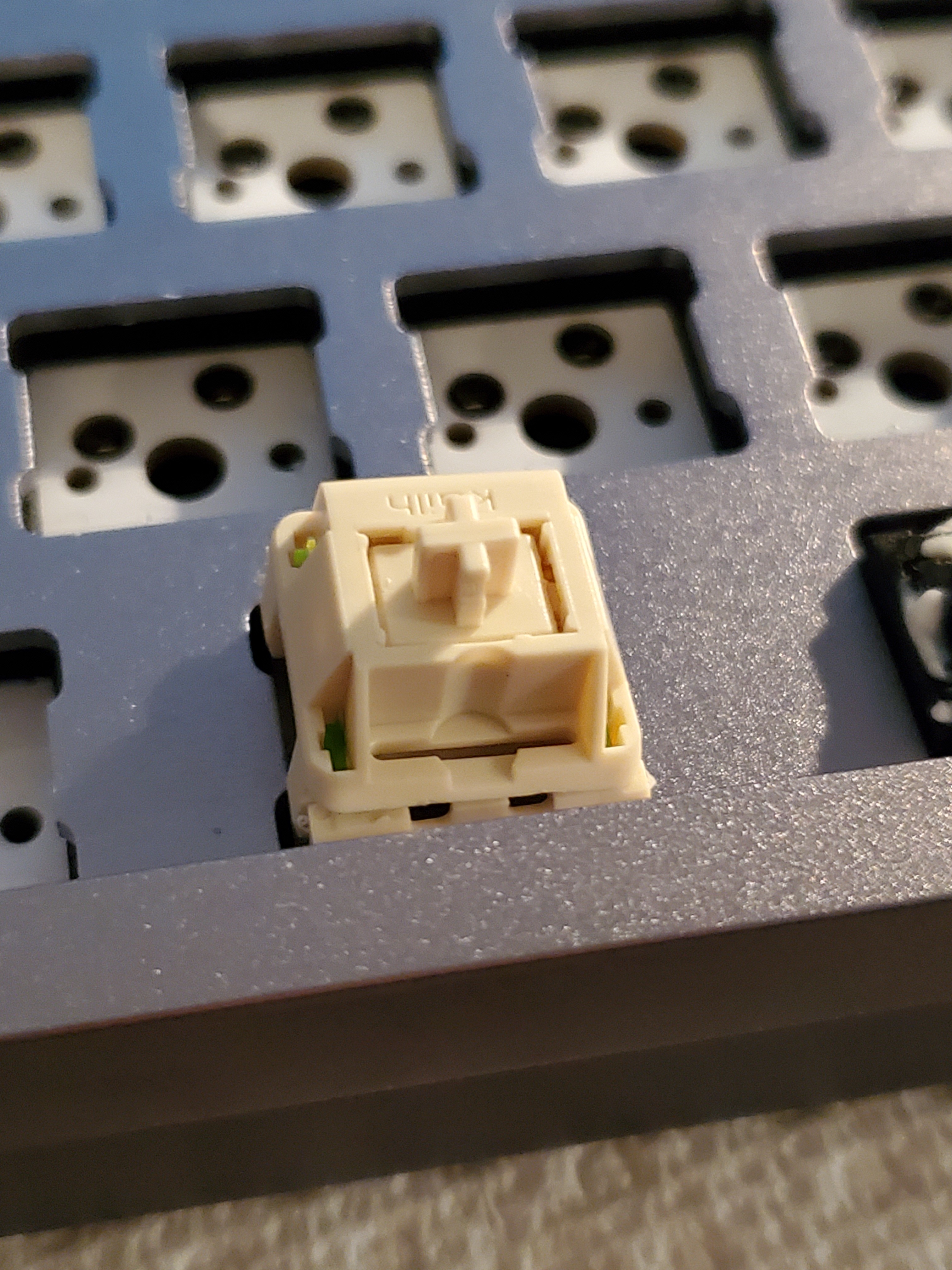

With the stabilizers installed, a ran into a problem that I blame @donpark for. (I’m not actually angry at Don.) Turns out that filmed Creams do not like holding onto their tops, and if you try to pull them out of a hotswap plate, they WILL come apart. Whoopsie. Therefore, until I can find a way to make the films fit snugly, they remain unfilmed for this build.
With all of the switches disassembled, it’s time to get to work.

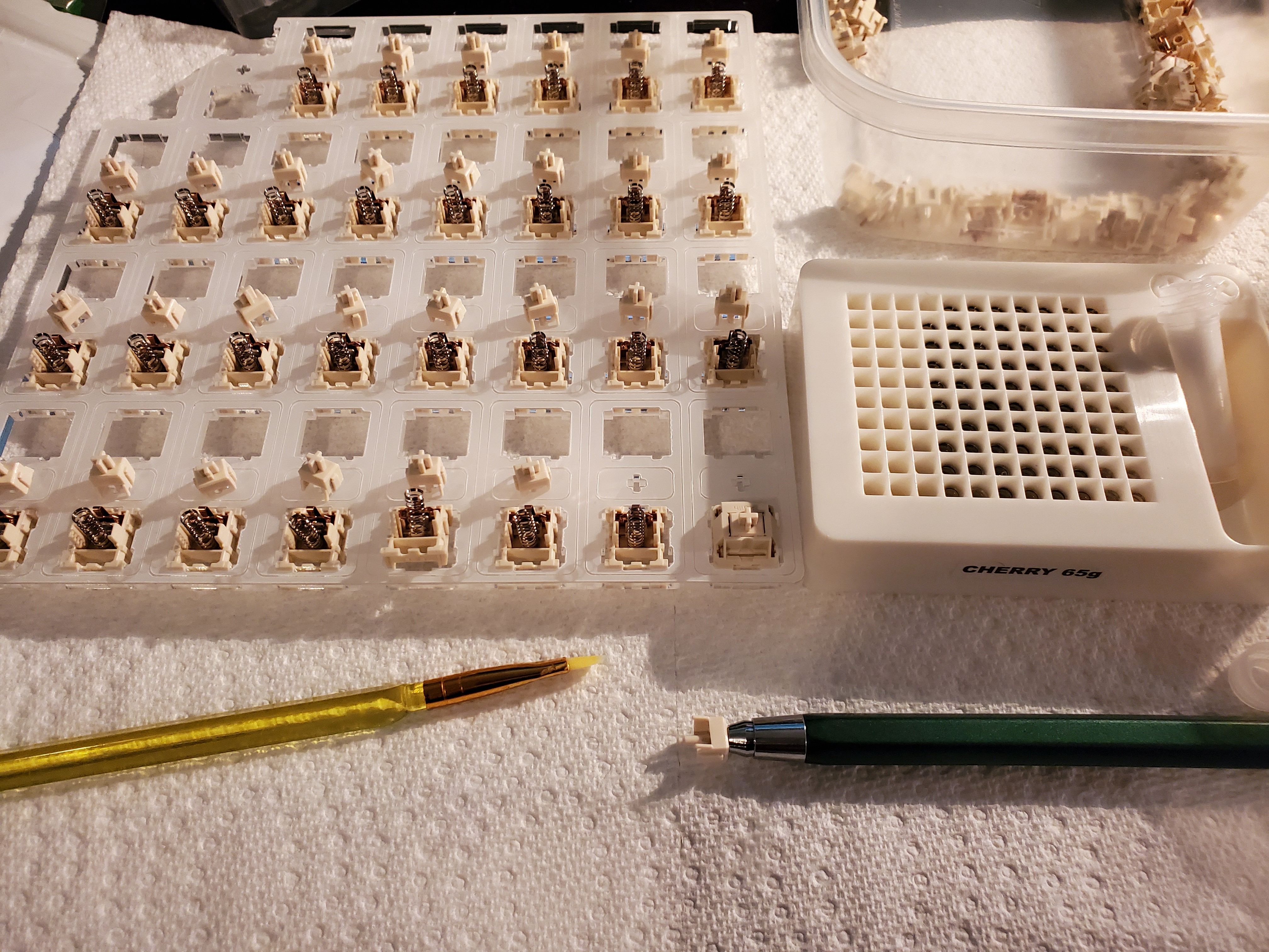

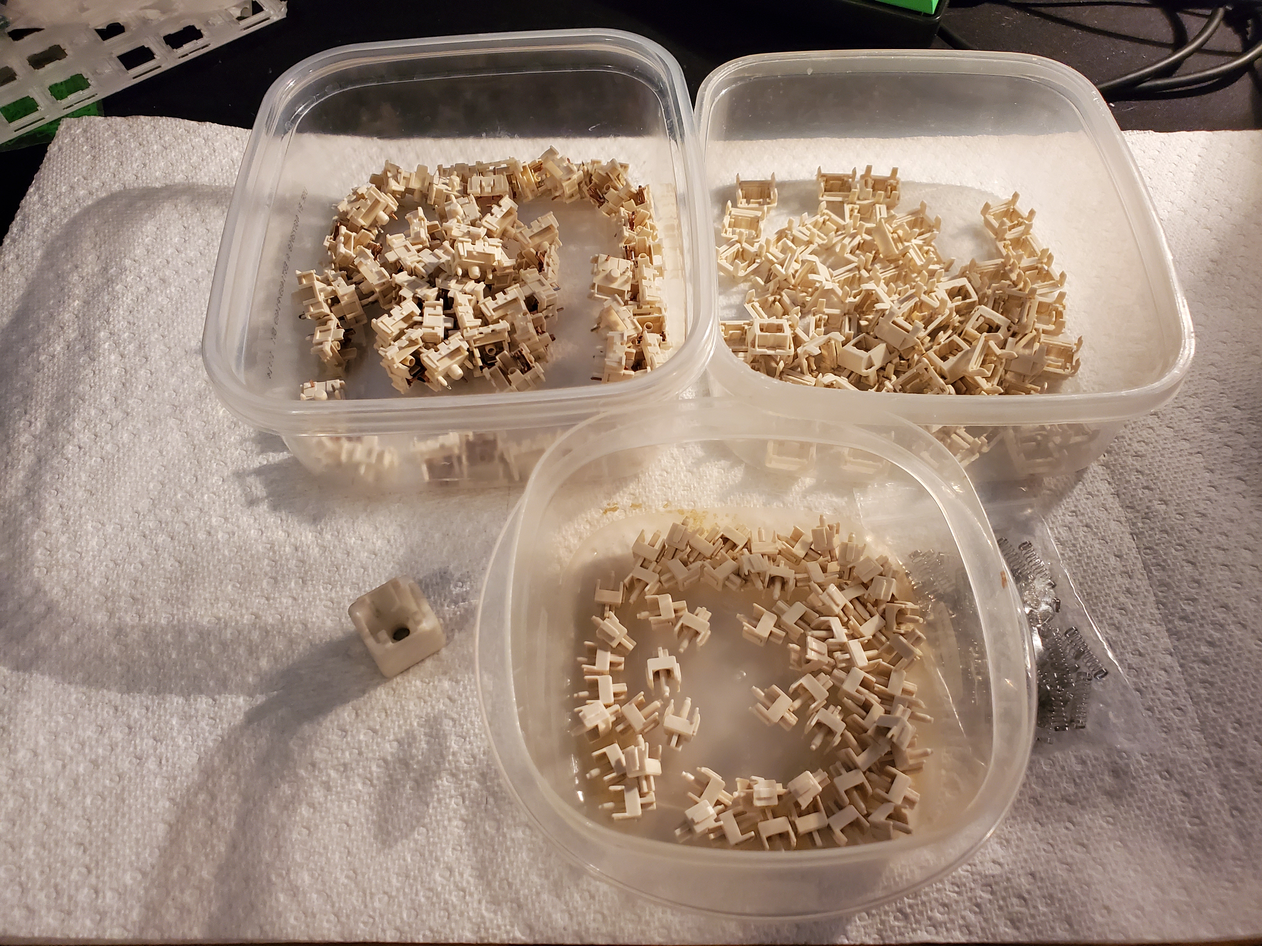

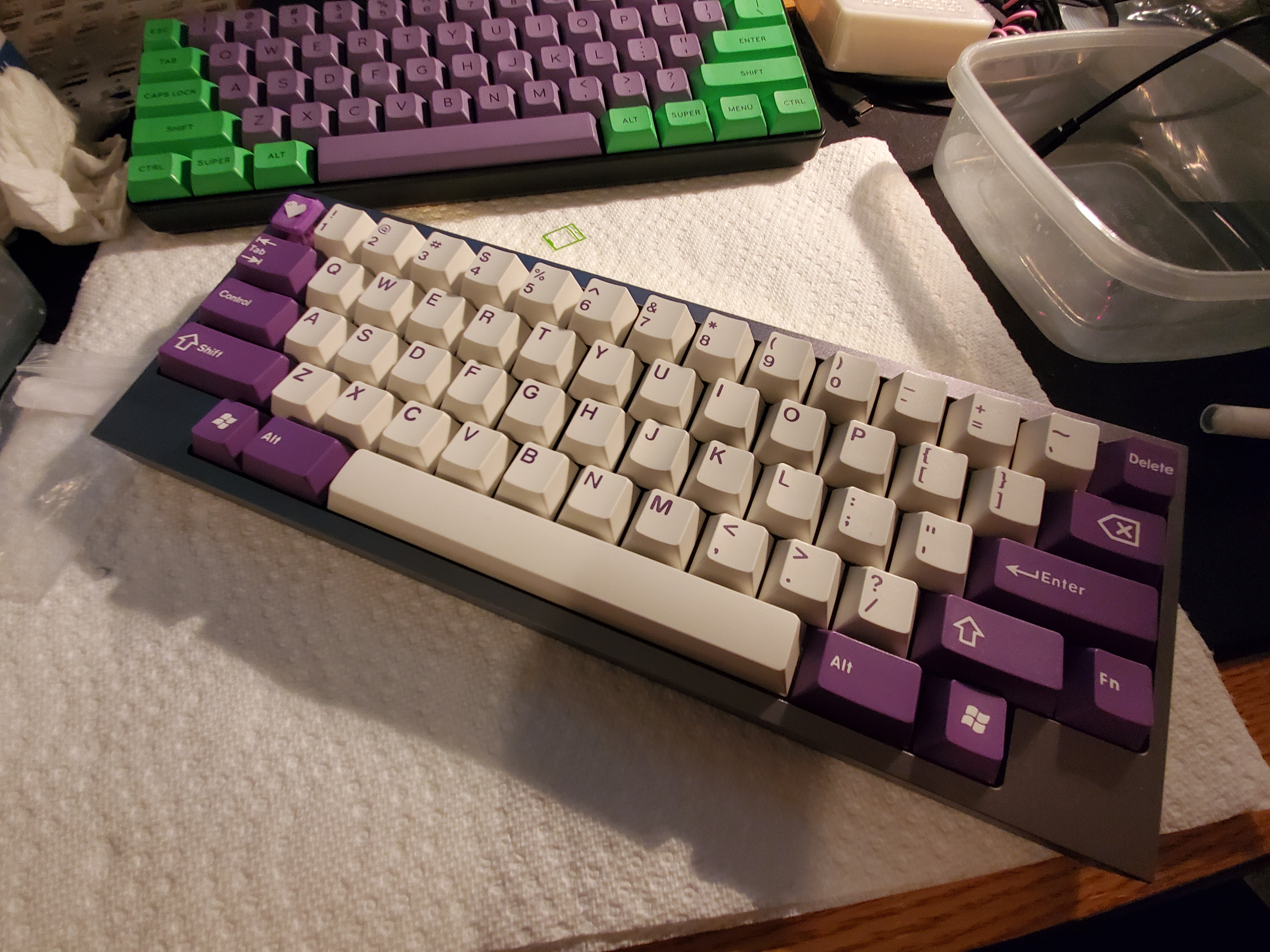

And now, my workstation. A banged-up lube deck from everyone’s favorite acrylic cutter, Qlavier, the TX keyboards switch picker, some oiled 65g TX springs, and a cheapo paintbrush, I went to work. I decided to give these an initial coat of 3203, with plans to touch it up later when I’m more patient.

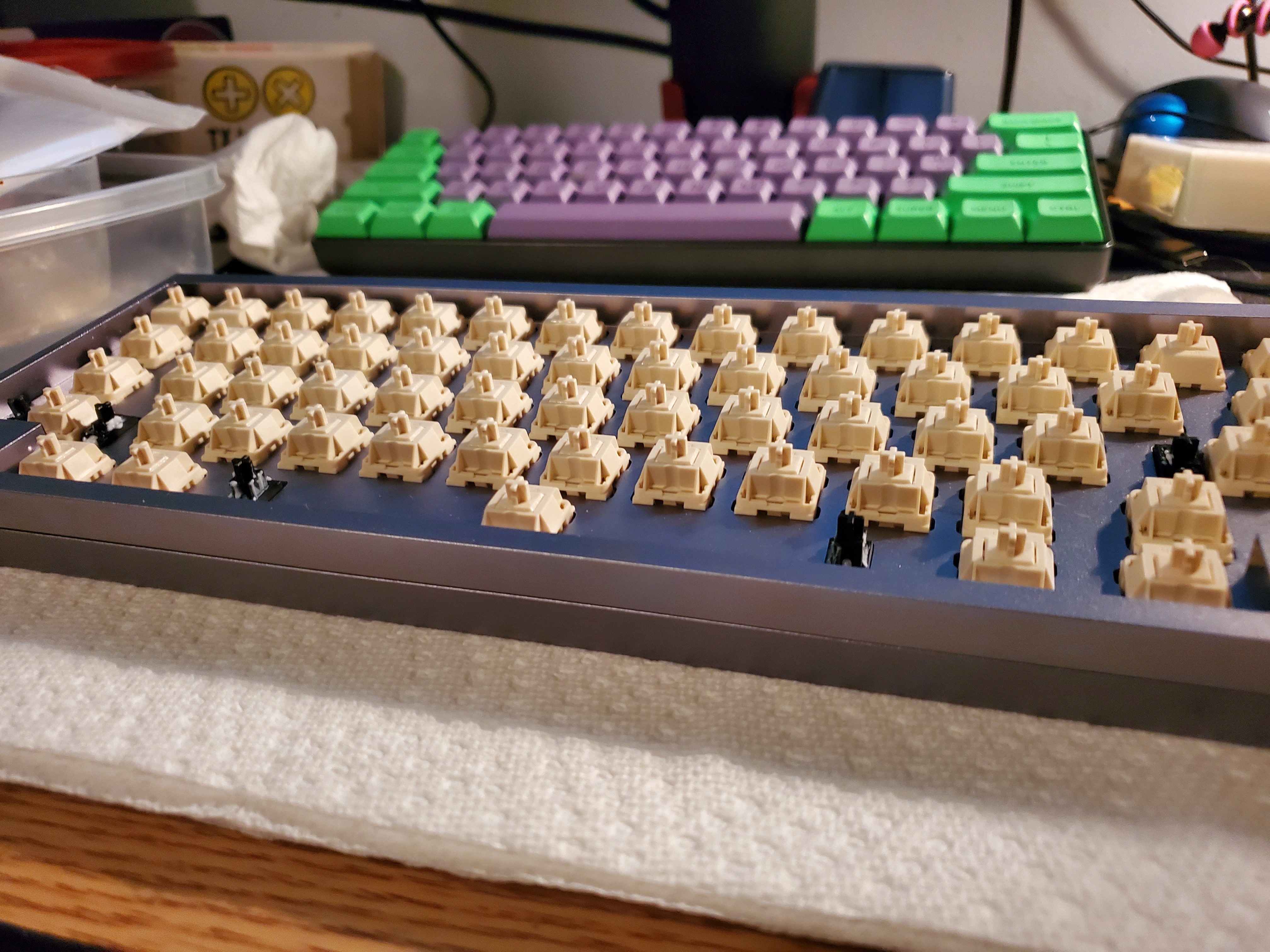

Three lubing sessions and 2 days later, everything was done! Creams are surprisingly pretty, aren’t they? A cute little beige on the grey plate works so nicely.

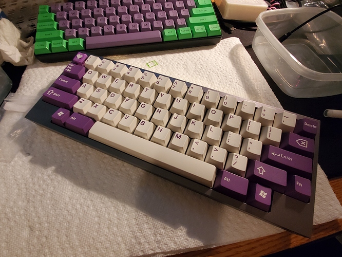

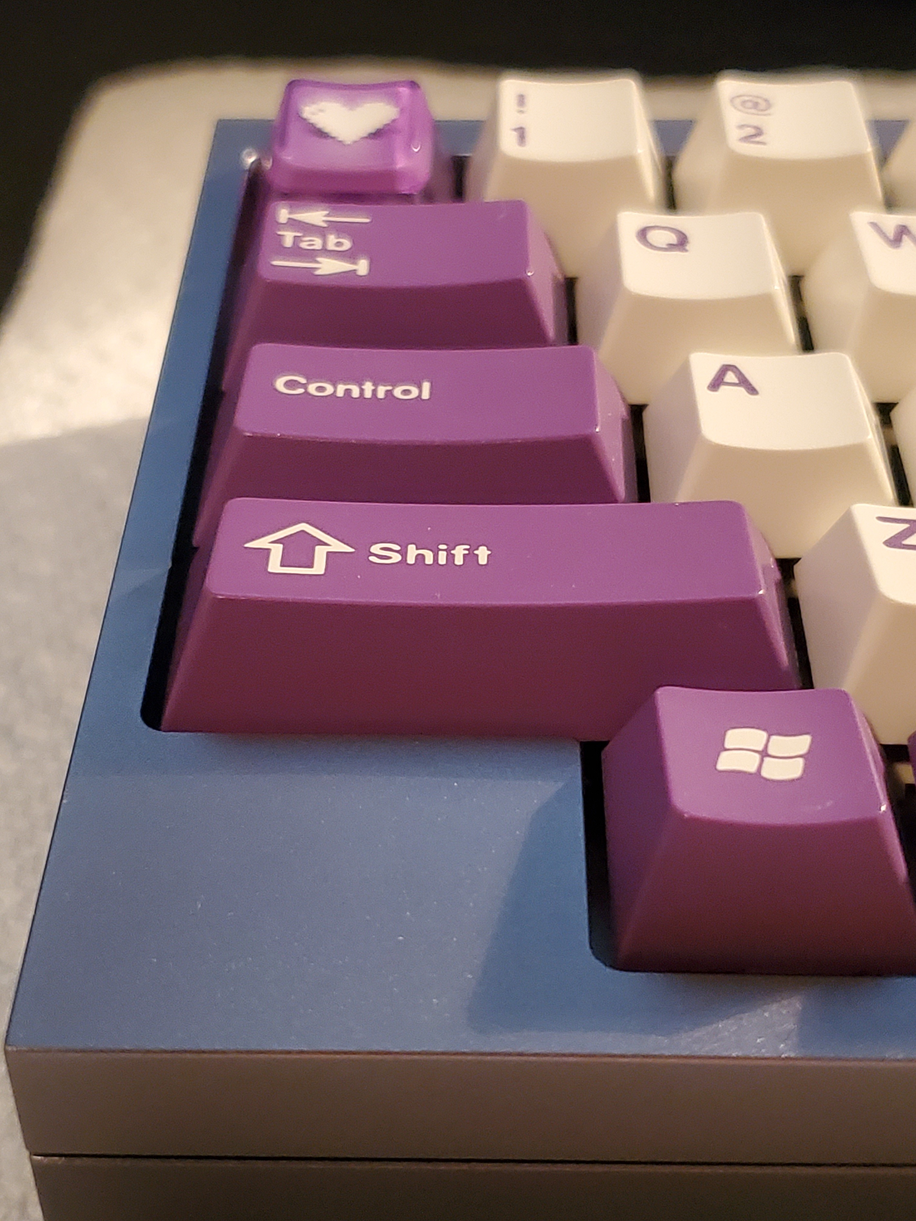

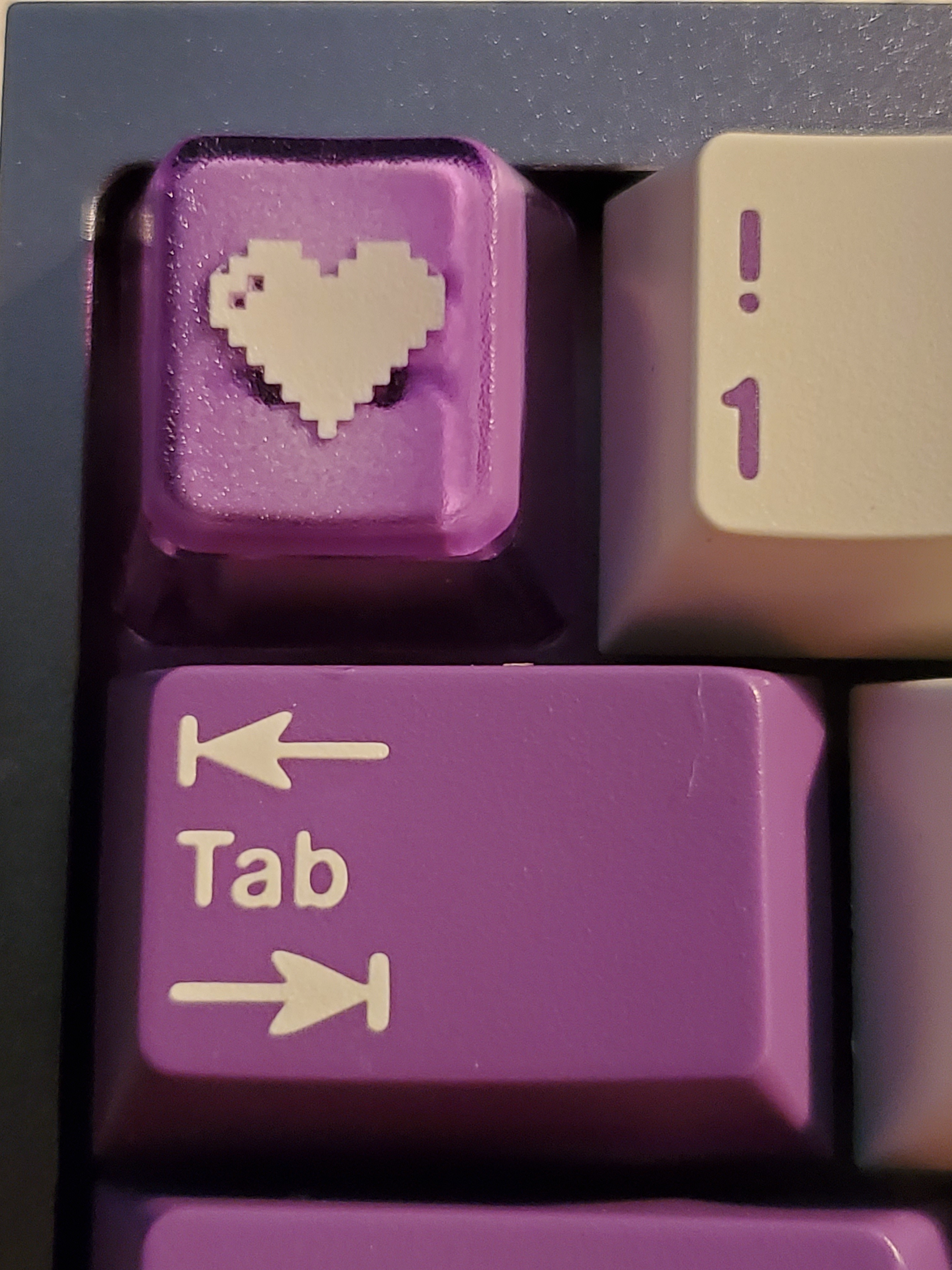

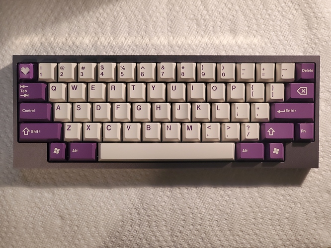

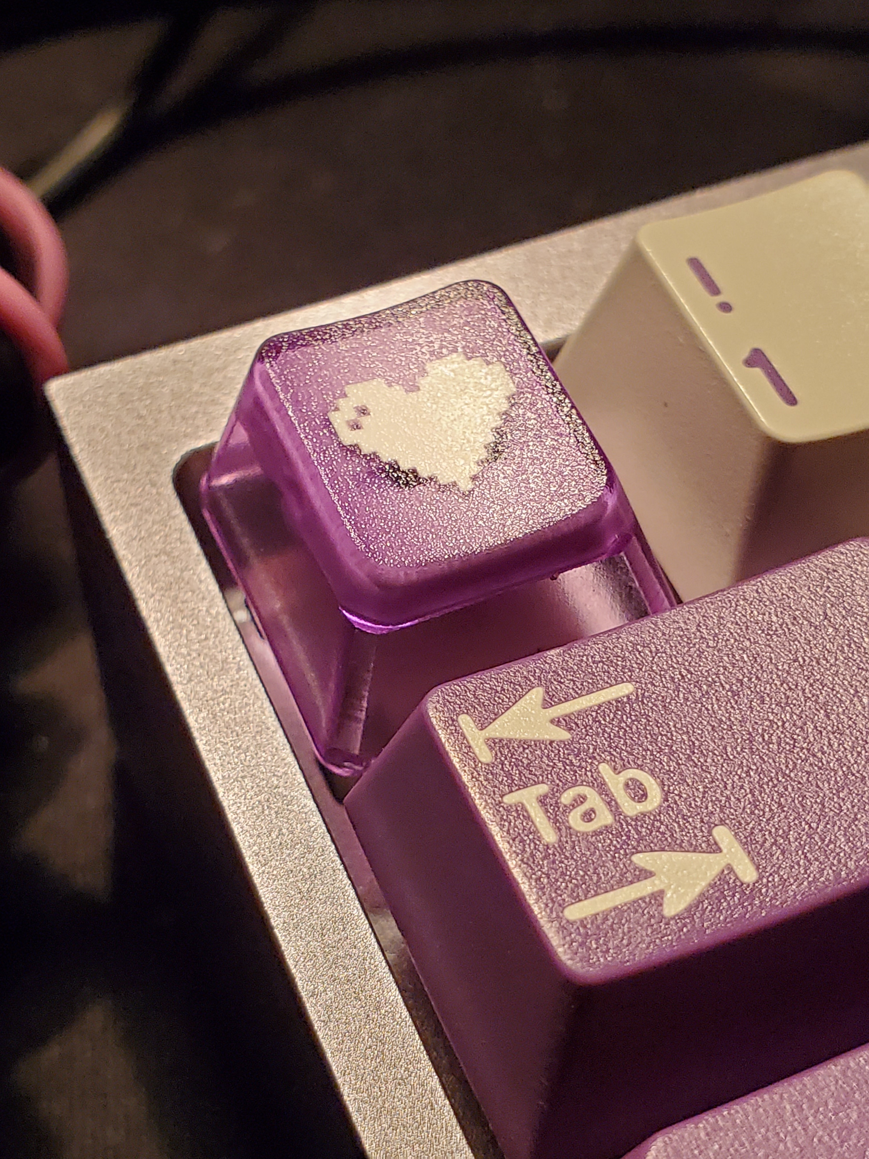

Tada! JTK Purple on White plus a Keypop 8-bit Heart Keycap for the escape, and we’ve got one pretty looking board. Glam shots?
Glam shots!
With all of that, here’s the TL;DR of the board:
- KBDFans Tofu HHKB (Grey)
- KBD6x PCB
- NovelKeys X Kailh Cream switches (Lubricated with Tribosys 3203, springs replaced with TX 65g springs
- GMK PCB Mount Stabilizers (Screw-In, lubricated with Krytox 205 grade 0 and Finish Line PFPE Grease)
- JTK Purple on White, KeyPop 8-Bit Heart (Translucent Purple)
