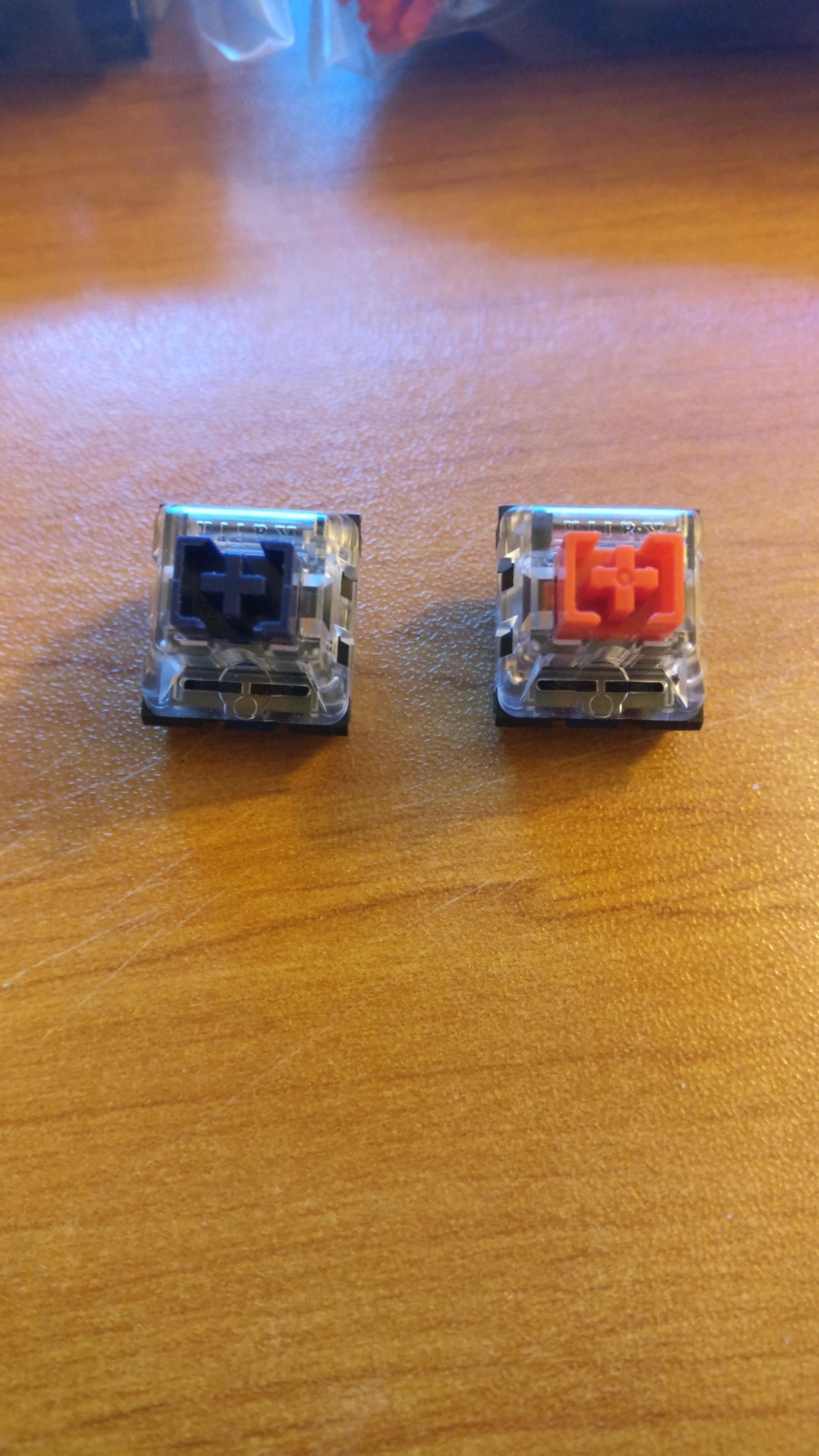

Kailh switches from AliExpress arrived today, Both linear and clicky variants.
Those are a bit special
Yes, both are optical as I’d like in a future project to mess with them.
They don’t have any contact leaves that adds to the friction of normal switches, so they are surprisingly smooth out of the box, once lubed I guess they’d become very nice to type on.
The nice thing with these optical switches are also the possibility to take parts of normal Kailh switches:
- springs.
- click bars.
- top case (I guess)
- stems ? (probably not, must have to check that).
The interchangability looks to be on par or even greater with Gateron opticals, that I also ordered.
Can’t wait to receive them

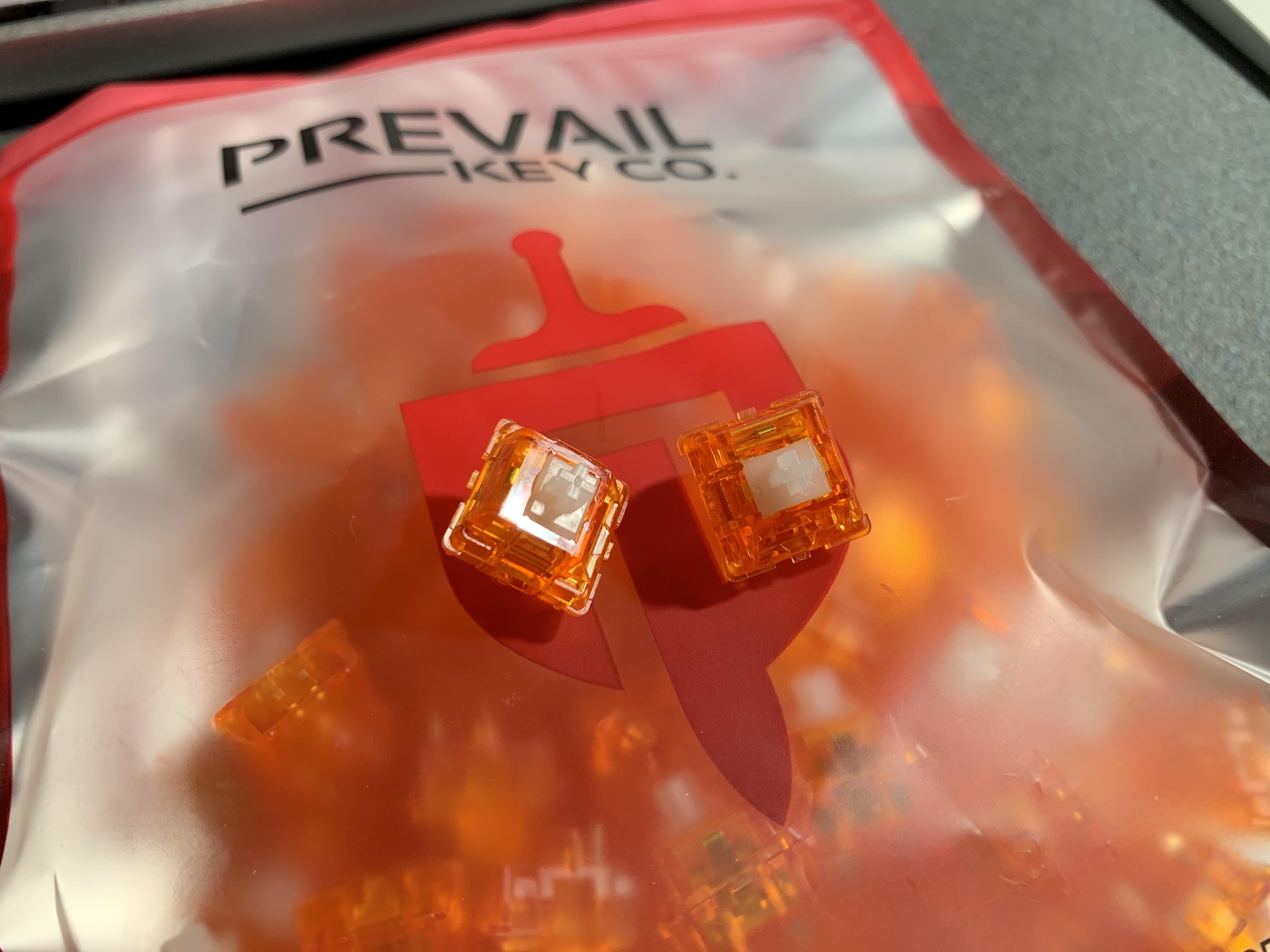

Still hoping that Optical Future from Swishy pans out
From Prevail’s page for them,
“These switches have a full nylon housing*, POM linear stem and 58.5g stainless steel spring.”
" **Nylon housing is a different type of nylon compared to their other offerings, to keep the price down. Sound & performance may differ from other full nylon housings.*"
Sounds like JWK is using the cheapest nylon they can get for these TBH. Would makes sense with them not willing to put their proper name on it. Kinda a shame, but I’ll stick with Gat Pro yellows for my budget switch for now.
