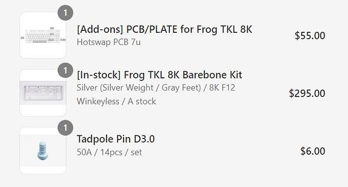

Broke down & grabbed a Frog 8K! Kept coming back & looking at it after @pixelpusher ordered one, finally I figured I better grab one since I like it so much. Couldn’t find any info as to if this is a one off run Geon did, or if he plans on continually restocking these like the Frog TKL. Although it’s such a unique layout I can see this being a one off run, so I wasn’t chancing missing out on it LOL!
Also gonna give a hotswap PCB on this build a chance for a change, since it only comes with a aluminum full plate. Then I’m hoping using the softest 50A tadpoles will offset the stiffness of the full plate. Definitely pump for this board, fingers crossed the shipping is fast enough to get it to on sat. That way I can build it over the weekend!

I ordered a F12 winkey a few months back, very nice board: I constantly switch between it and my Manta75 in my workplace.
I have it assembled with the aluminium plate and the same 50A tadpole as you.
The soft tadpoles gives a bit of bounce that is nice to experience.
The leaves on the plate are not super effective to give any bounce as some leaves length are very short and close to a mounting point.
Keep in mind that, as there is no daughterboard (usb soldered on the PCB), the amount of flex and bounce must somewhat be contained in order for the USB connector to not collide with the case. And the board is also well designed to prevent that as the plate leaves makes contact with the bottom case before it can happen.
I also have one of the gorgeous hotswap PCB designed by Gondolindrim ![]()

Actually just a out all thay advice should apply to the 8k too. As im pretty sure its just a frog with more cutout of the top case by the arrows. From the sounds of it using the 50a tadpoles will be the ticket for me. I dont want huge flex on it cause of the PCB having the USB come directly off it like you said. So between the soft tadpoles & little bit of flex the leaf springs give im hopeful it’ll end up just right!
Also im gonna have to keep an eye on the optical switch PCB for the Frog TKL. I was going back & forth between the 8k & TKL last night. I do plan on picking up a Frog TKL sooner than later & being able to use optical switches with it would make it a must buy for me!
Yes most of what I said applies to the 8K, even more for the 8K plate as the mount is much more top mount traditional: the leaves are different and very short (and of the same size), just to prevent having a hash bottom out but no more than that.
I guess he tadpole softness will play a more important role for this plate than on the Frog TKL plate.
