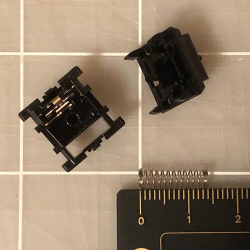

To anyone that got in on the limited edition black U4’s, did they have the longer (16mm+) separately purchasable Gazzew springs?
Looks like 14mm. (Factory donut-dipped; guess they started that earlier than I thought!)
3Dkeebs.com has restocked the U4T Blacks - they are currently available in 55g and 65g versions, but I’m not sure if those have the same spring type as the first run or not,
I like how the measuring tool matches the switch. :sunglasses:
Sold out at the moment, but it’s Wuque’s FR4 ruler:
