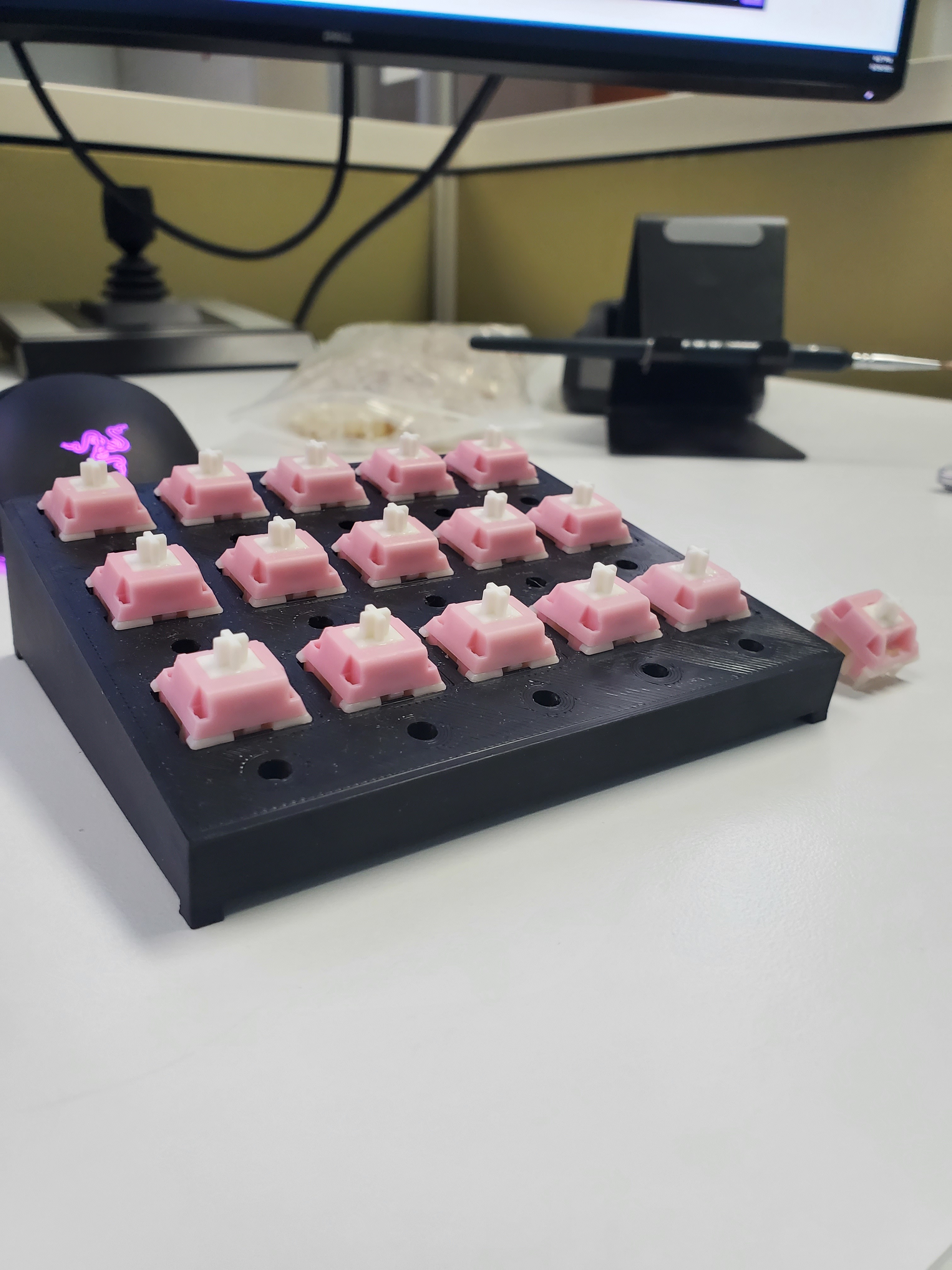

Havenât put the Bobas in a board yet, but got mine and can confirm they are quieter and less crunchy than say an Outemu Silent Sky or Aliaz.
The tactile event feels very short. I was expecting a rounder, longer tactile action.
Need to put into a board for further assessment.
I have some prototype U4 stems and I can tell you the bump feel depends heavily on the leaves theyâre paired with. Havenât tried the Boba housings yet (any day now!) but earlier the versions I have pair well with Pandas.

i have these in a board now and itâs great. slightly deeper tone than aliaz, and i feel like tactility is within the realm of dropâs HPs. it came with some custom PTFE blend or something (labeled #6) that was meant for doing the spring donut dips. i didnât add any other lube. canât tell if itâs scratchy or not. itâs kind of hidden behind the tactility.
overall, pretty happy with them. itâs kind of funny but I would describe my personal experience with these switches as a nostalgic recollection of how topre feels in my memory, but not how they actually feel whenever i go back to the hhkb.
