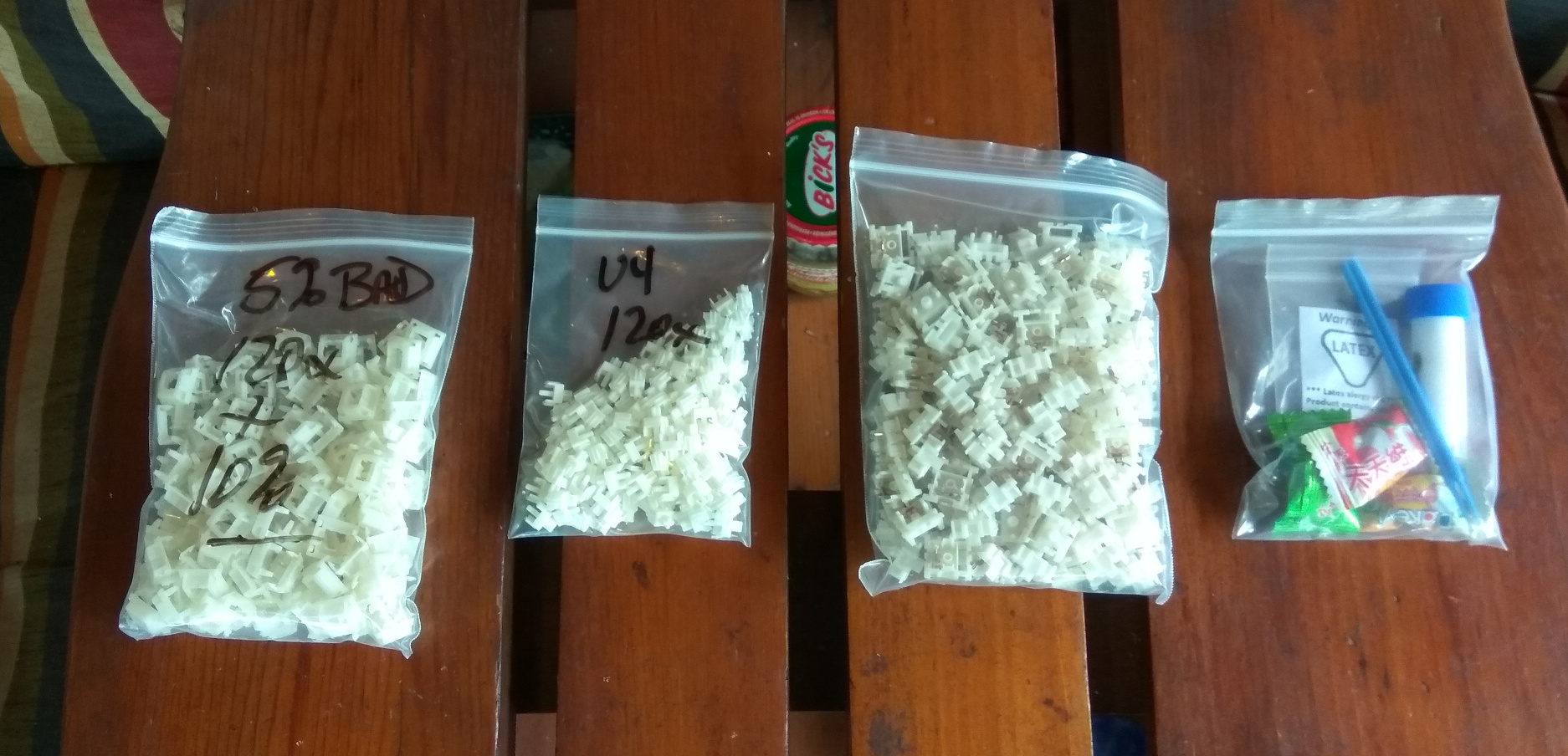

My Boba housings are in my mailbox! Definitely gonna make a few of the linears I was talking about above in the thread tonight to see how they do. Will report back here once I’ve done it.
So I finally got around to messing around with some different stem combos in my boba housings & unfortunately they are not too hot for modding. GazzeW has such tight tolerances on the tops (& bottoms to a lesser extent) more stems bind in them than actually fit. JWK/Durock stems too big, Gateron stems too big, modern Cherry stems too big, Zealio V2 & V1 stems too big, etc. The best fit’s I found were Cherry vint black stems, Halo stems, Invyr PE stems (the ones that were in spec), & OG Sky stems. For linears they really don’t seem to be anything special, even with the softer nylon they use it still feels & sounds like an above average vint or retooled black. Tactiles shine a good bit more in them, but require fairly high spring weights as the leaf is very, very stiff.
On the other hand the couple U4 samples he sent with my housings order are easily the best silent MX tactile switch I have tried to date. I would highly recommend them already without even using them in a board TBH (which probably will never happen for me as I am not a fan of silent switches). I’m not gonna totally give up on the project though, I have to hit good old hbheroinbob up to see what linear stems he has on hand. I still think if you have a non silenced linear stem made with the tolerances to properly fit the top housings (those being ultra tight are the real problem & 99% of other top housing are not compatible with the boba bottoms) they will make for a killer linear.

First, these are the components for the switch that I received in the mail:
-U4 Silent Tactile Stem
-“Pearl White” switch top [no slot / no LED]
-“Pearl White” switch base [linear / tactile leaf]
-62 gr Korean spring
-PTFE Lube Blend for springs
