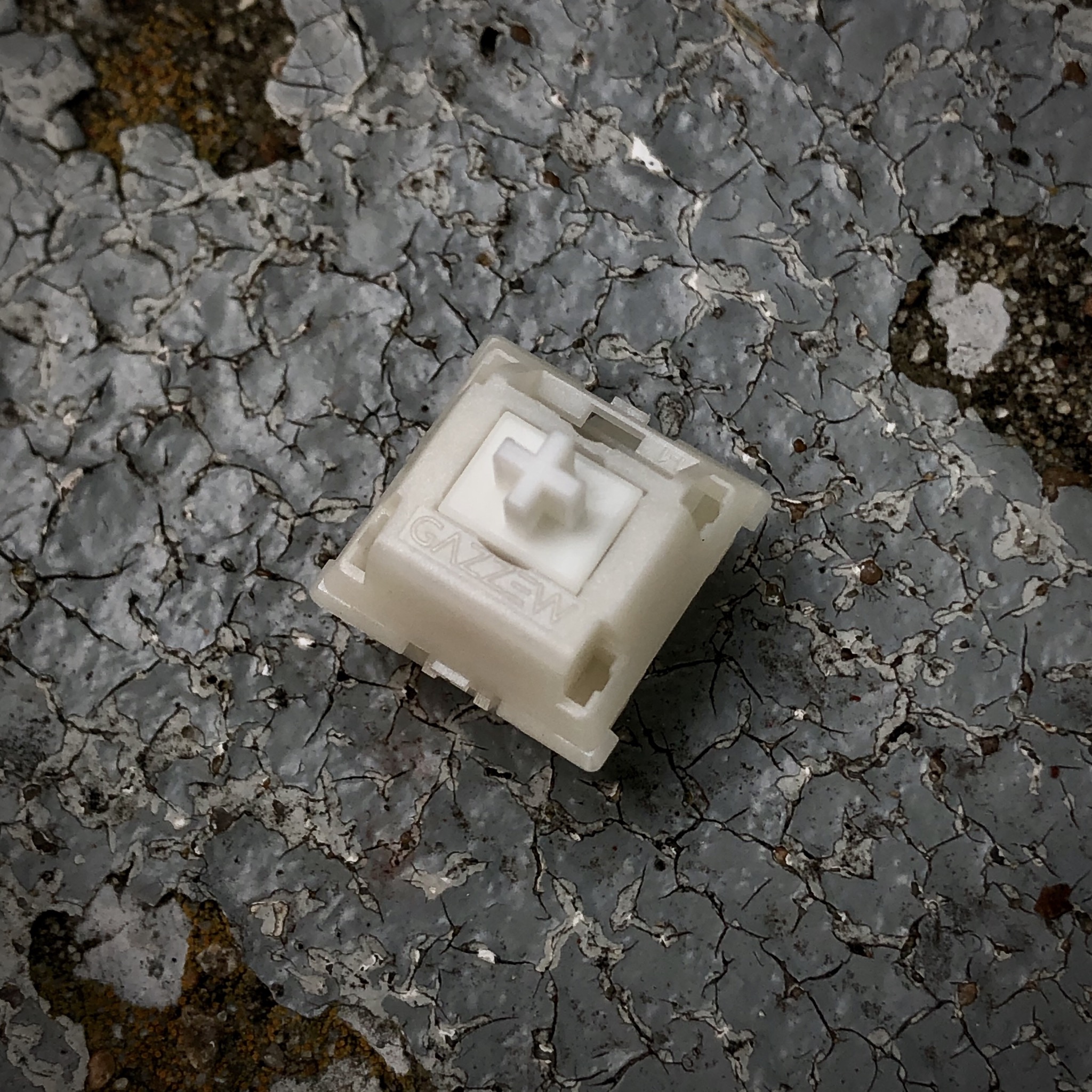

Got mine in the mail today and mounted them earlier this evening.
Some initial thoughts / first impressions:
  • Snappy! Very positive tactile feedback; there’s no second-guessing whether or not you’ve actuated one of these. “Positive” in the sense that you positively feel the tactility - the tactile style itself is “negative” though, with the bump starting right at the top of the travel.
  • While I would indeed class these as having a “D-shaped” bump in that it’s big, round, and takes up the majority of the travel, I wouldn’t say “no post-travel” is totally accurate. It’s more like a “D” with a little tail… say, between a “D” and a “P” - but closer to the “D”. So far I’ve only tried one switch that truly has no post-travel whatsoever, and it’s a frankenswitch.
  • These switches immediately joined my short-list of others on which I find it extra-easy to type with high speed and accuracy. Others on that list would include Box Whites, Kiwis, and Holy Pandas.
  • The peak force of the bump on these is high enough to wear me out quite a bit more quickly than most of my other switches, though. I might see how I like them with some lube on the legs of one or two.
  • Can confirm one of the two metal pins on each switch being super dainty. Care is definitely required when mounting these in hot-swap sockets.
  • A bit of dry-sounding leafy-crunchy noise here and there, but overall more quiet than a typical silent tactile, even in their factory bone-dry state.
  • Not 100% consistent, but probably above-average in that regard with variances being few and minor. Some leaves make a little more noise / seem to have a little weaker of a grip against the bump, but even those resist accidental presses very effectively and retain a strong, snappy bump.
  • Folks weren’t kidding; I’m super impressed with how little wobble these have, even putting BOX switches to shame. A few of the switches have a tiny bit more than others, but I bet films would even that right up. I also bet that when the silent linear stems come back to market, these will be the best housings to put them in.
Trivia:

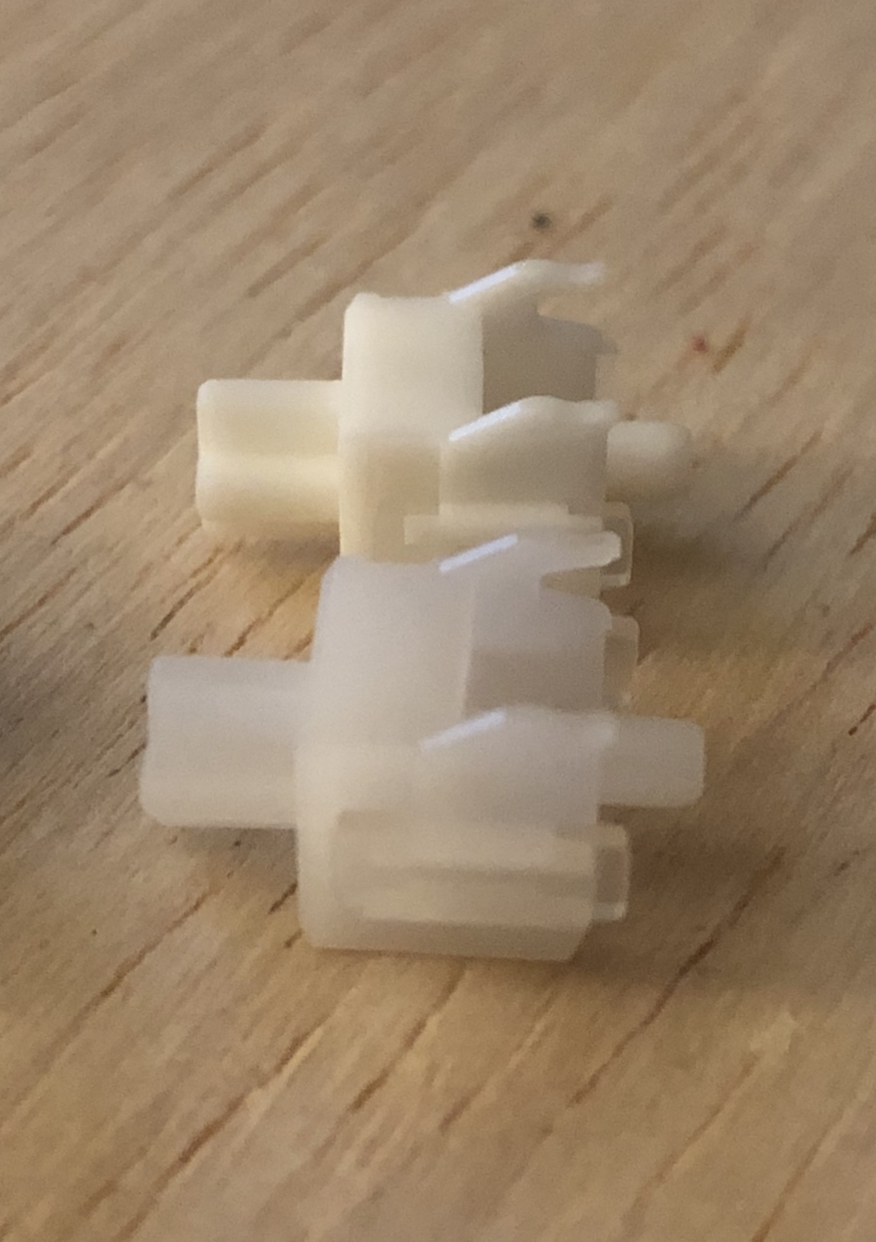

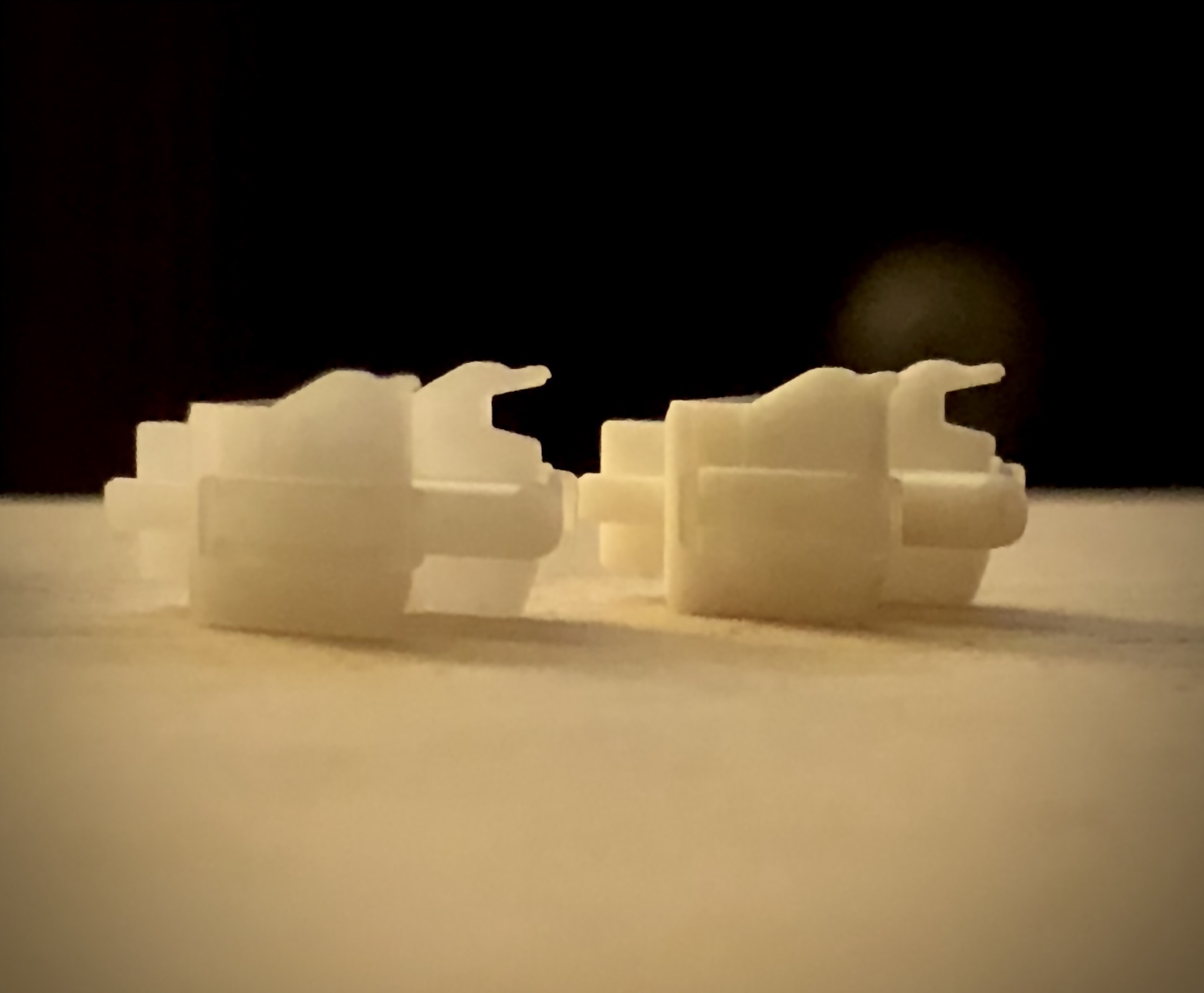

  • The stems in these are a mostly opaque milk-white, vs the prototype U4 stems I got from Daily Clack having the same translucent look as Halo or Cherry Clear stems. To my eye, the shape appears identical between the two versions. (Edit from the future: it isn’t.)
  • The “GAZZ☰W” logo is upright when the switch is North-facing, at least on the slot-top versions I have.
These feel a little bit like Silent Box Browns with a rounder bump in that they manage to be impressively snappy even with very modest to light spring weighting.
If I can successfully mitigate the dry-feeling creaky / crunchy leaves in a few of these, I think the Boba U4 will end up one of my very favorite switches. Either way, I’m already very impressed, and excited to start tuning and kit-bashing them.
Edit: some potato photos comparing the previous U4’s I had with the ones pre-installed in my Bobas;
Color. The one farthest from the camera is from a Boba U4, the other I got separately.
Stem legs. Not a straight-on photo so not the best comparison, but it gives you an idea of the shape.
Update: The new stems are definitely not identical to the prototypes, similar as they may appear.
The new stems produce a stronger bump and have less wobble than the prototypes; both in the Boba housings and in others - specifically Halo housings, as-tested. While the prototypes feel a little muddy in Halos, the new ones feel discretely “cushioned” prior to actually bottoming-out on the silicone pads.
While the new stems appear especially dialed for maximum tactility and minimum wobble with Boba housings, I might prefer the comparatively mild experience of putting them in Halo housings.
