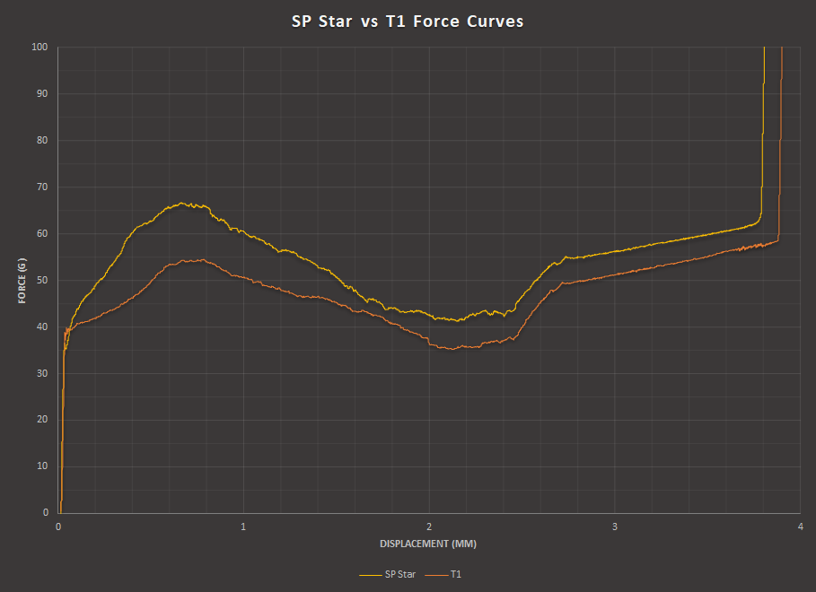

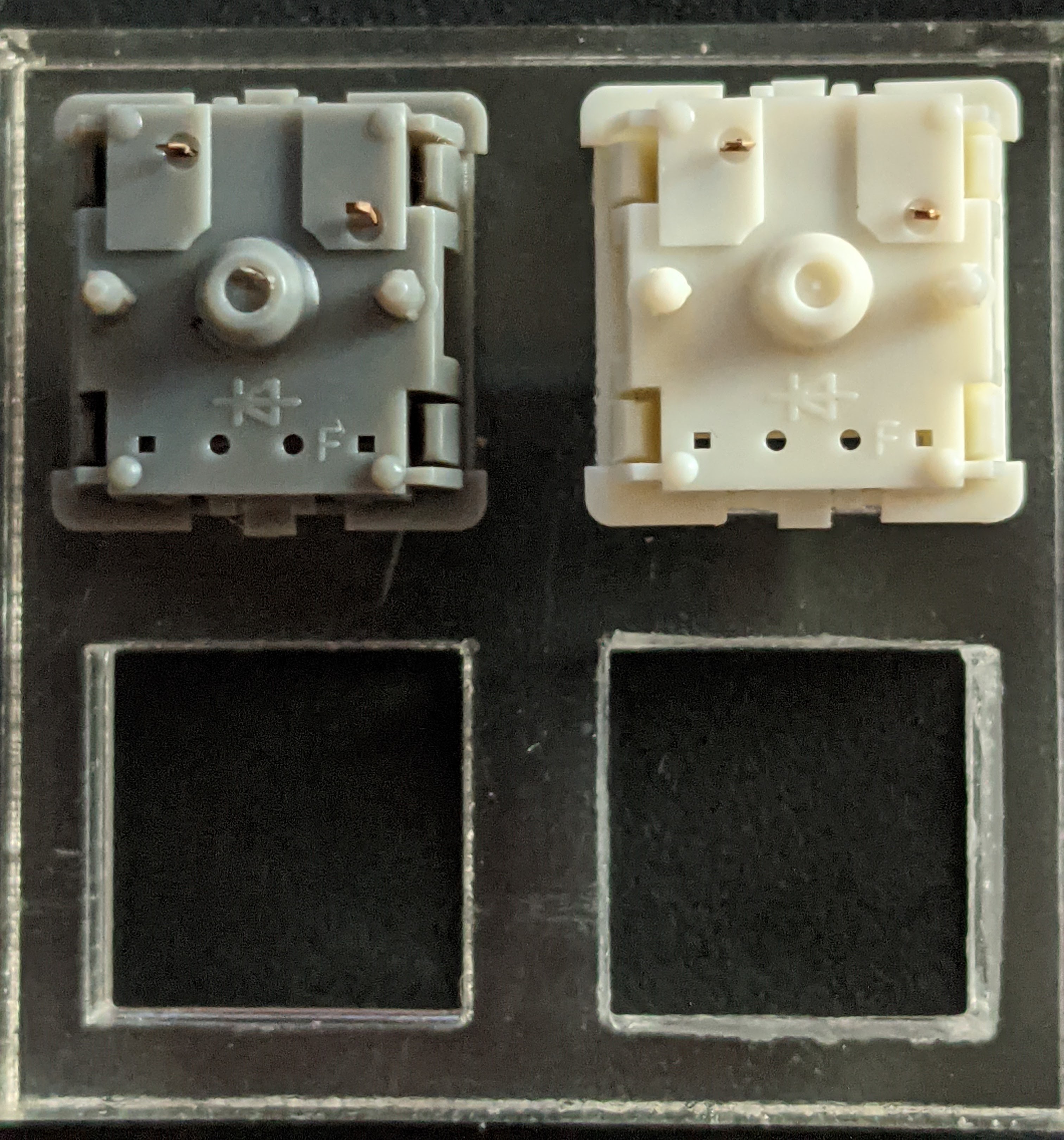

I recently got some of the SP Star switches and compared them to T1, generating force curves for both:
Based on their housings being very similar, along with these force curves, I would not be surprised if it was JWK making these switches.
Yes, I recently tried a purple SP Star tactile, and it was a substantial bump much like T1.
It might even be stronger than Kiwi, but I’m not sure the two switches were lubed the same. Definitely part of the T1/Kiwi family in terms of feel.
could be Leopold or “SP Star” paid for their own unique molds and JWK designs/manufacters them? I covered this in my review, but the mold markings on the linears showed that they are not the exact same as JWK.
the SP Stars and PrimeKB T1 samples I have exhibit very similar markins, some with matching letter codes on the bottom.
