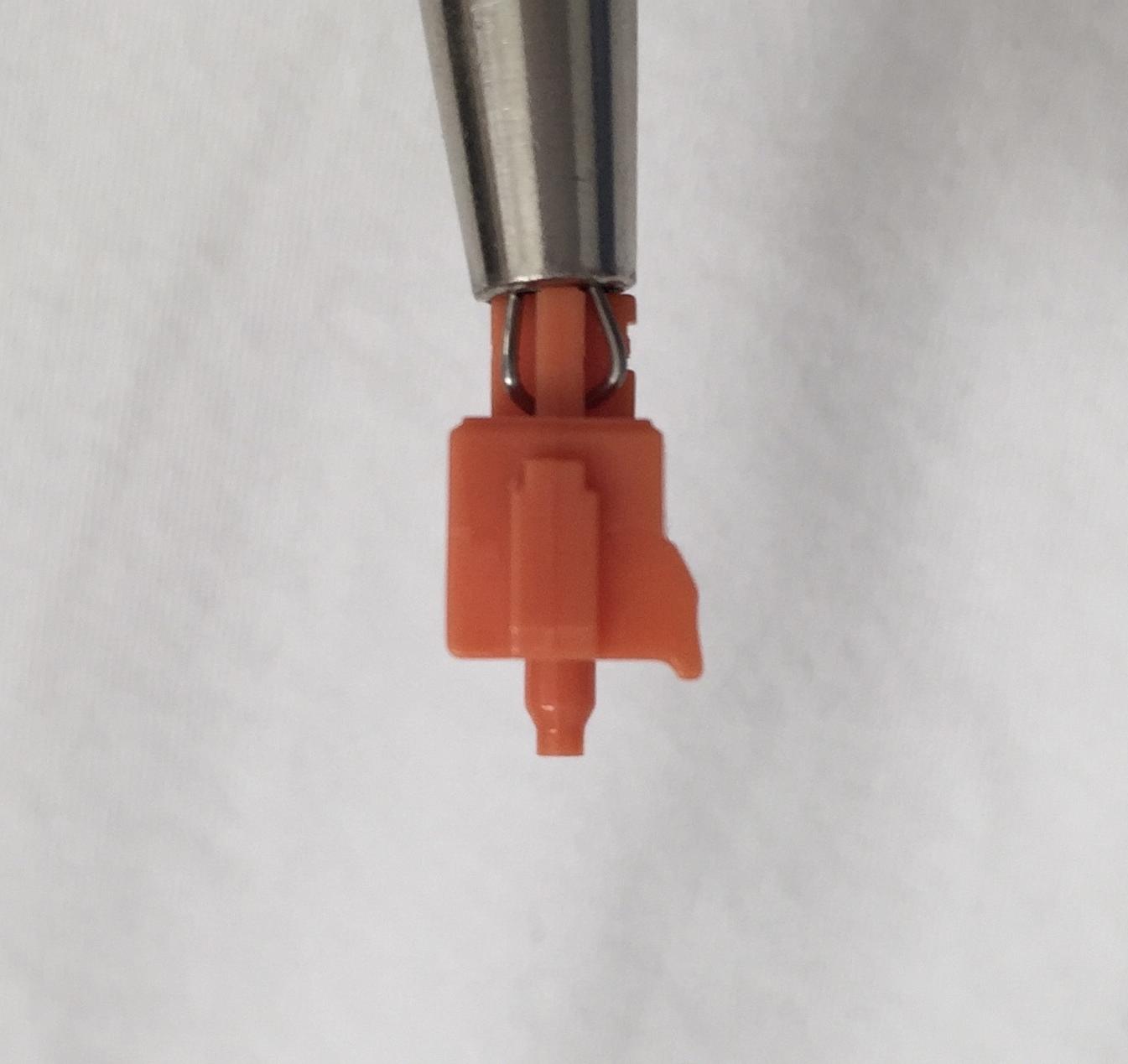

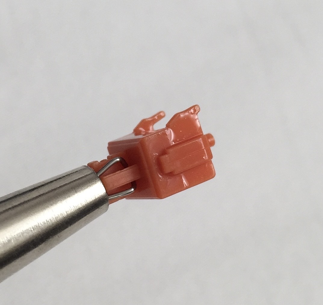

Just the extra little nib at the bottom of the stem pole & I use flush cutters for it.

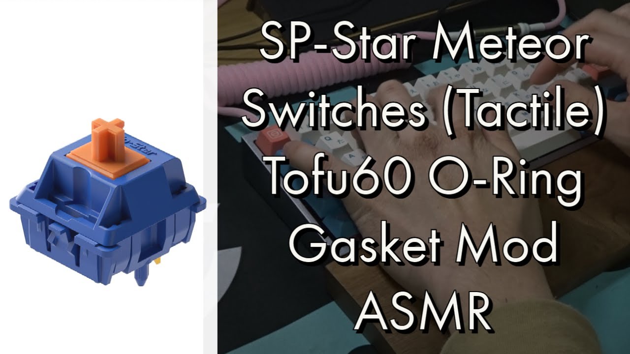

In this video, the Youtuber claims that lubing with 105 and filming led to improvement:
Stock Meteor Orange actually sounded good on the KBD67 Lite:
I had an R1, and the polycarb plate really helps some tactiles. I dunno, maybe in the right setup stock Meteor Orange would sound good?
Yeah, that sounds nice with pc plate. What shines to me the most is browns on plateless/half-plate, so I might plan on lubing these with 205g0 and build it with half plate!
