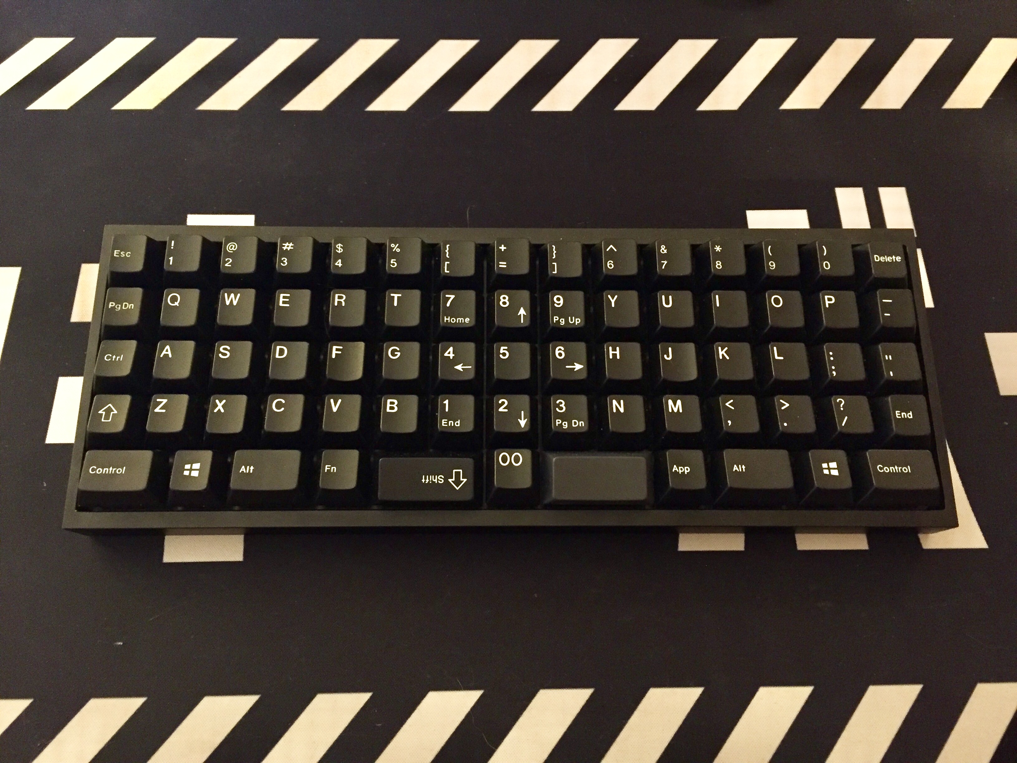

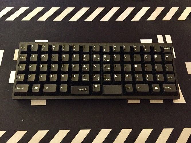

(forgive the strange lighting in my apartment)
Recently finished building this board. I’ve been using it for about a week and am enjoying it. It will be my day-to-day keyboard for the foreseeable future. I made the extremely bird-brained decision to use a layout with 2 x 2u space keys, so it will be a bit of time before I get a keycap set that looks clean on the board, but functionally it’s exactly what I need for my work.
Plexus75 PCB
Tofu60 case (slightly modified)
Gateron Ink Black Silent, 68g progressive springs, 205g0, TX films
Carbon Fiber Plate
Wow that PCB is gorgeous! is that some sort of 40% layout? This might be the first time I’ve seen a 40% build that is not ortholinear. Love it! I look forward to seeing pics of it built when the time comes!
Really there are are a couple of ongoing GBs with non ortho 40% on atm
