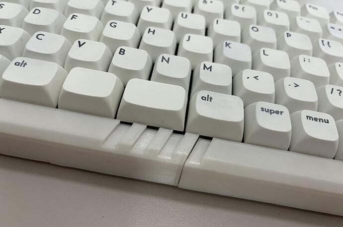

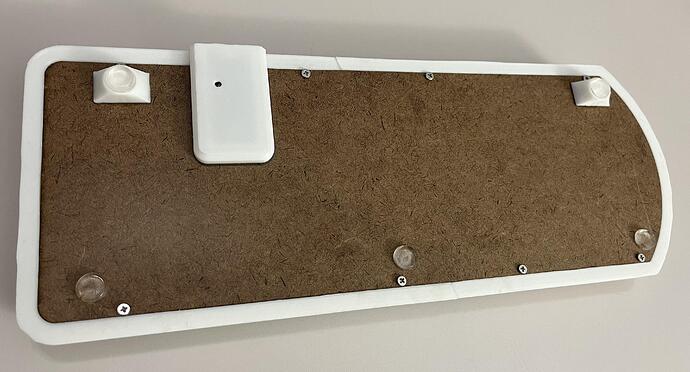

This one just moved from workbench to desk today. No stabilizers 98%. DIY as much as is practical for my “workshop.” Handwired, 3D printed case, bespoke 102-key layout, laser dye-sub XDA keycaps (more on that below), laser cut “Masonite” plate, Kailh Box Jade, KMK on an RP2040.

It’s early obviously, but I’m optimistic about this one. It feels pretty nice, and the Jades are almost as nice as the Navies, just missing that slight “kerchunk!” that the Navies have. The Jades are a bit snappier, and I agree that they may be ever so slightly louder, but I don’t think they dethrone my dark blue fingerbreakers.
After my last set of keycaps came out with some fairly obvious alignment issues, I rethought my jig and made a new one that could support 26 1u keys, plus one of arbitrary width. I also went with corner legends instead of centered, as that punishes a lack of accuracy much less, if you can at least get your setup repeatable. Then, I did clusters together in batches (i.e. all alphas in one run, all F keys together, etc.). The result is a much less jarring alignment situation. It would be ideal, if the plastic itself had cooperated. This PBT recipe didn’t like the infusible ink nearly as much as the DSA keycaps on my other no-stabs build. Legends are not as crisp as I’d like, and the colors are pretty muted, but the improved alignment makes this a modest victory.
Overall, I like (though not quite love) the way they came out, and the overall effect for the board, between the layout, case, and font, is a bit “Apple meets Logitech circa 2004,” which may or may not be a good thing, but it’s always satisfying to wrap one of these up.
