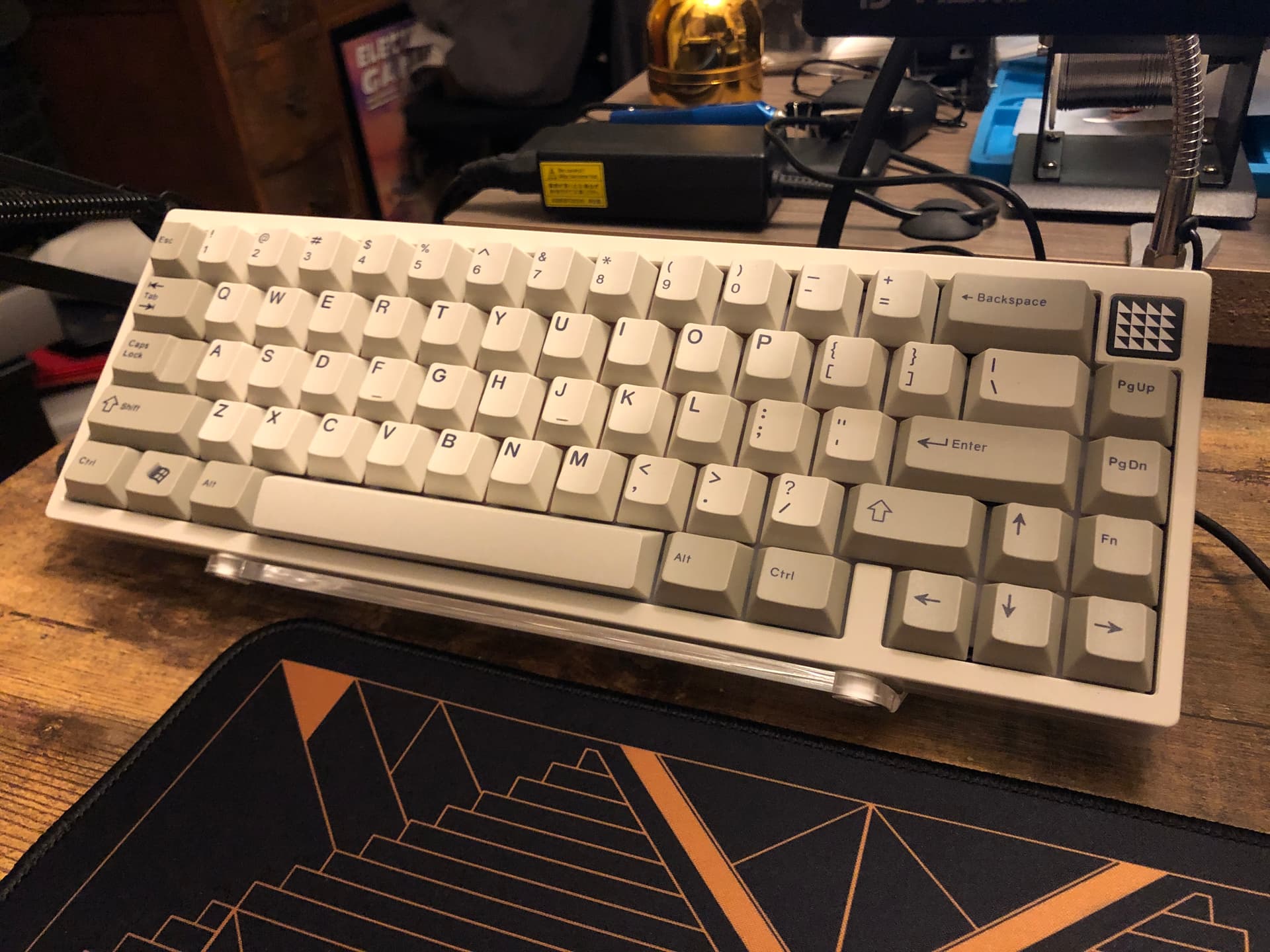

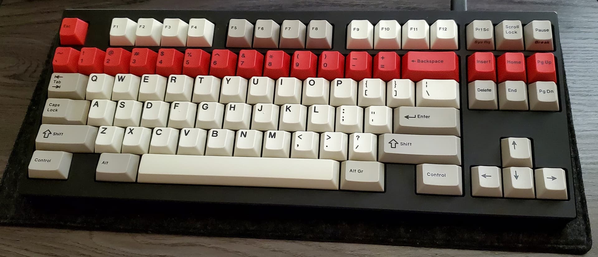

Had to try this keycap combo out on my F1! Also the combo of blue cheese v2 switches, on a PP plate, topped off with CRP really gives the F1 some low end kick, definitely what you could call a “thocky” board! :upside_down_face:
Can I ask what keycaps set that is?
Oops! Forgot to include that. It’s JTK Ride :slight_smile:
Thanks!
Honestly yea, Cherry on alu is still king for a reason haha. Keyspensory alu plates are so top notch I may swap like half my collection to alu.
such a classic

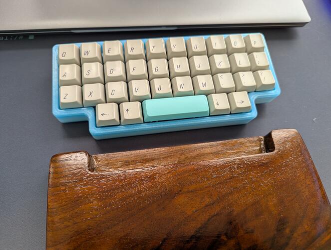

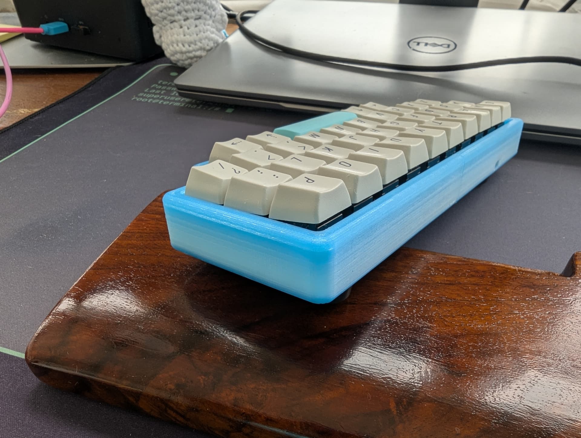

I put some AEK II keycaps back on this board because the relegendable keycaps I had on it before felt terrible to type on. If I don’t pickup a different ALPS keycap set somewhere, I will probably reprint the case with a slope on the top edge so that there is not a gap between the caps and case on the back.
Minimalist caps on a minimalist board. Came out great!
