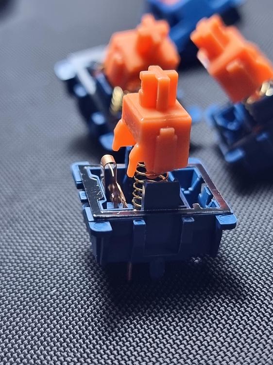

(Above: A disassembled SP Star Meteor Orange switch, with film applied.)

MeteorOrangeSampleBuilds
(Above: Builds “3” and “4” have elements of this proposed switch, namely the Meteor Orange internals and Cherry top-housing, stabilized somewhat with films.)

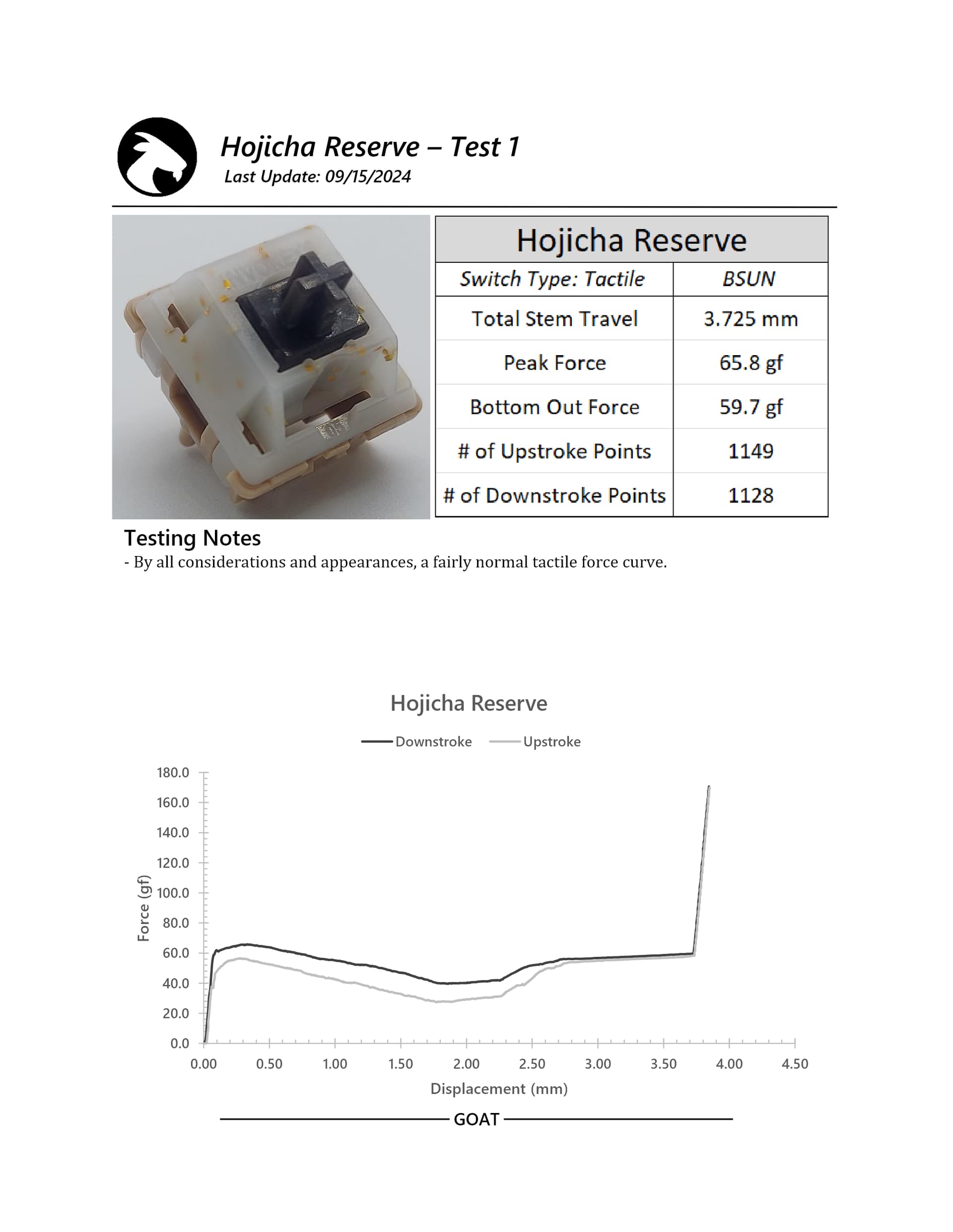

Luckily I’ve come to really enjoy a recent switch released by Invokeys - the Hojicha Reserve.
It has a top aligned bump that’s smaller than T1 but larger than alternatives like Mode Tomorrow or Ergo Clears. The materials are definitely nicer than the standard Nylon/POM affair, with full POM housings and LY stem so they get that glassy frictionless feel. And from Theremingoat’s testing, its a pretty well balanced switch with the stock 21mm 60g spring in terms of peak tactility to bottom out force. And unlike most other long poles it actually has more than 3.5mm of travel when measured, instead of that 3.3-3.4mm range.
A very pleasant and usable tactile switch for all day typing. I thought the “everyday tactile” marketing was a bit cliche at first but I’ve come to really enjoy it over time.
I personally clean up the lube and relube myself with 3203, no films or spring swap required.
I see that it’s “revolutionary”, “unprecedented”, and “unique” but are there any comps on this particular switch? Seems interesting.
There is a very detailed review:

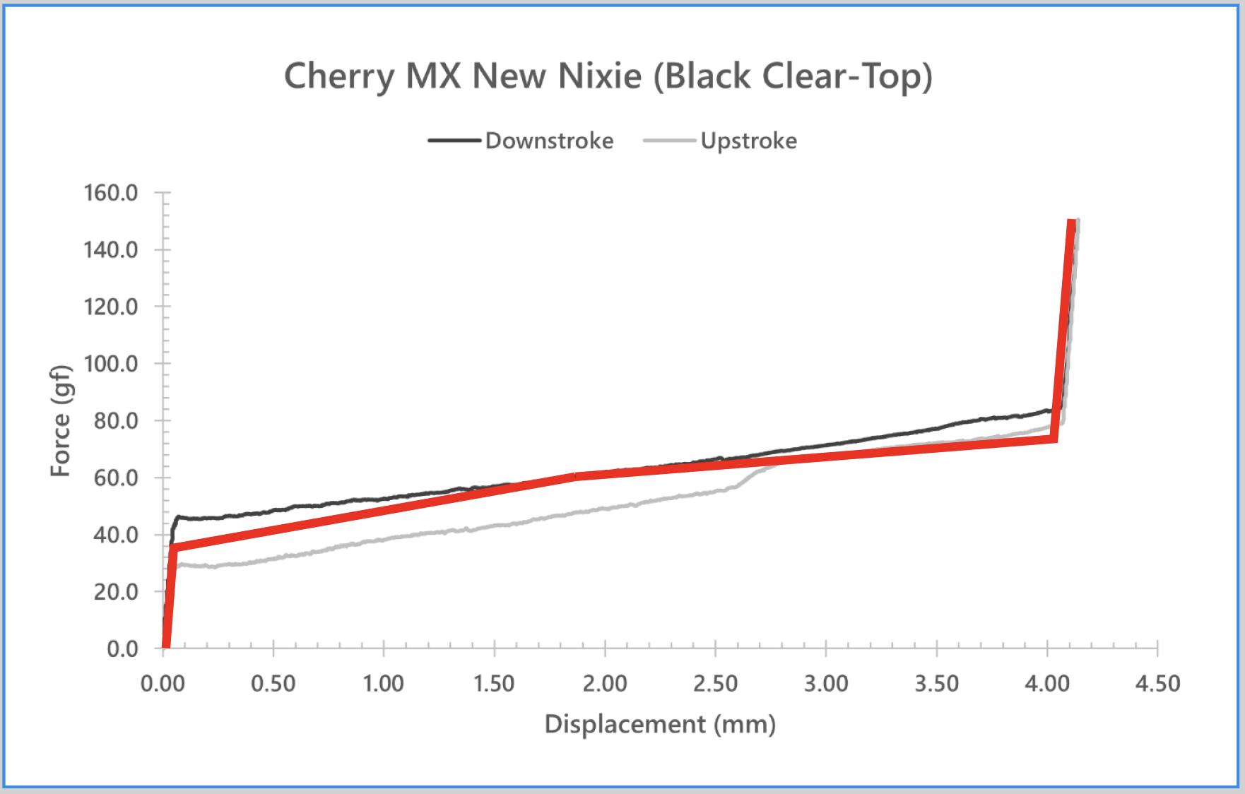

I am not sure if this kind of tactility has been made before or is even possible but this is my ‘ideal’ linear/tactile hybrid force graph. It’s essentially a linear switch that changes its force graph slope right at the actuation point. Sudden change in slope should feel like a small but sharp tactile event similar to slicing through dental floss.
It’s not clear yet whether increasing or decreasing the slope afterward would feel better. I’ve experienced the later with super long spring in New Nixies and it’s pretty nice.
As to what to call it, maybe catchy or snaggy linear?
