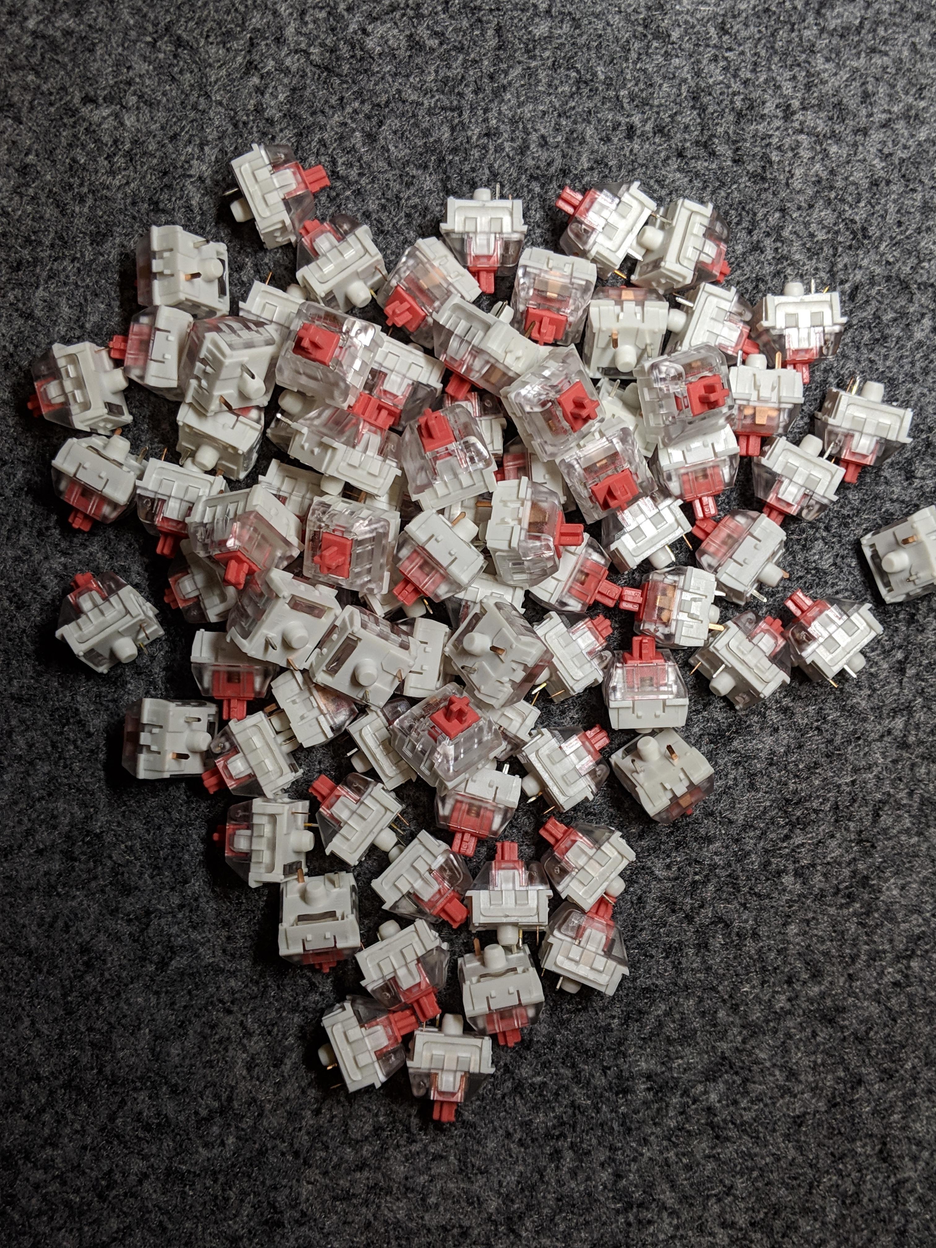

I’ve been trying to find a use for the 110 Halo housings I have laying around. I decided to make RGB ergo clears using the Halo housing, 68g springs and Cherry Clear stems.
Overall that combination is OK, but not great. The down stroke feels nice. There’s a little pre-travel and a sharp tactile event. The upstroke, on the other hand, is forceful, loud and jerky.
The housings seem nice, at least for a keyboard with backlight, It seems like a shame to throw them away. Has anyone found a good use for leftover Halo housings?
