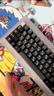

Today I built my M0llY with the lubed Gateron Deepings I worked on yesterday.
It’s a very nice board. Of course it is also an amazing steal for $70. After I built it I did some typing and was a bit bummed because I didn’t like the sound or feel of the switches. But then I removed the silicon insert in the case. Oh boy. Night and day difference. Sound and feel is 100% better.

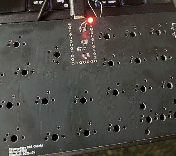

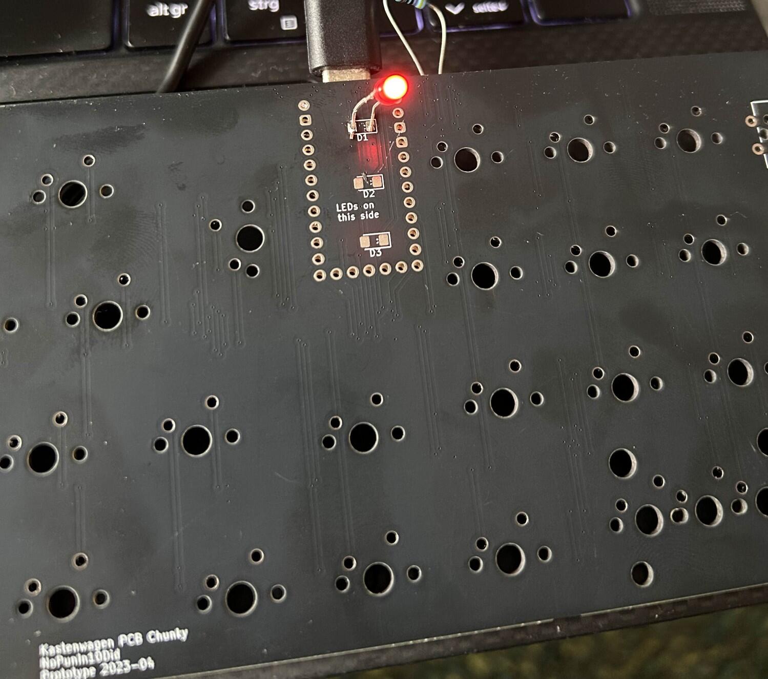

More work-couch than workbench today, adjusted the Kastenwagen1840 PCB (which nopun already adjusted to fit a ISO Enter) to fit a RP2040 helios, as I learned its not 100% pin compatible with the Elite C. The Pin for the first Status LED was not routed to a GPIO if you just switch out the MCU. So I adapted the PCB to a Helios footprint. As im too lazy to wait for my SMD LEDs to arrive, I did the first test with 3mm ones. And after some fiddling with the QMK files and creating a VIAL port of the Firmware, this looks extremely well. Very excited for the finished project.

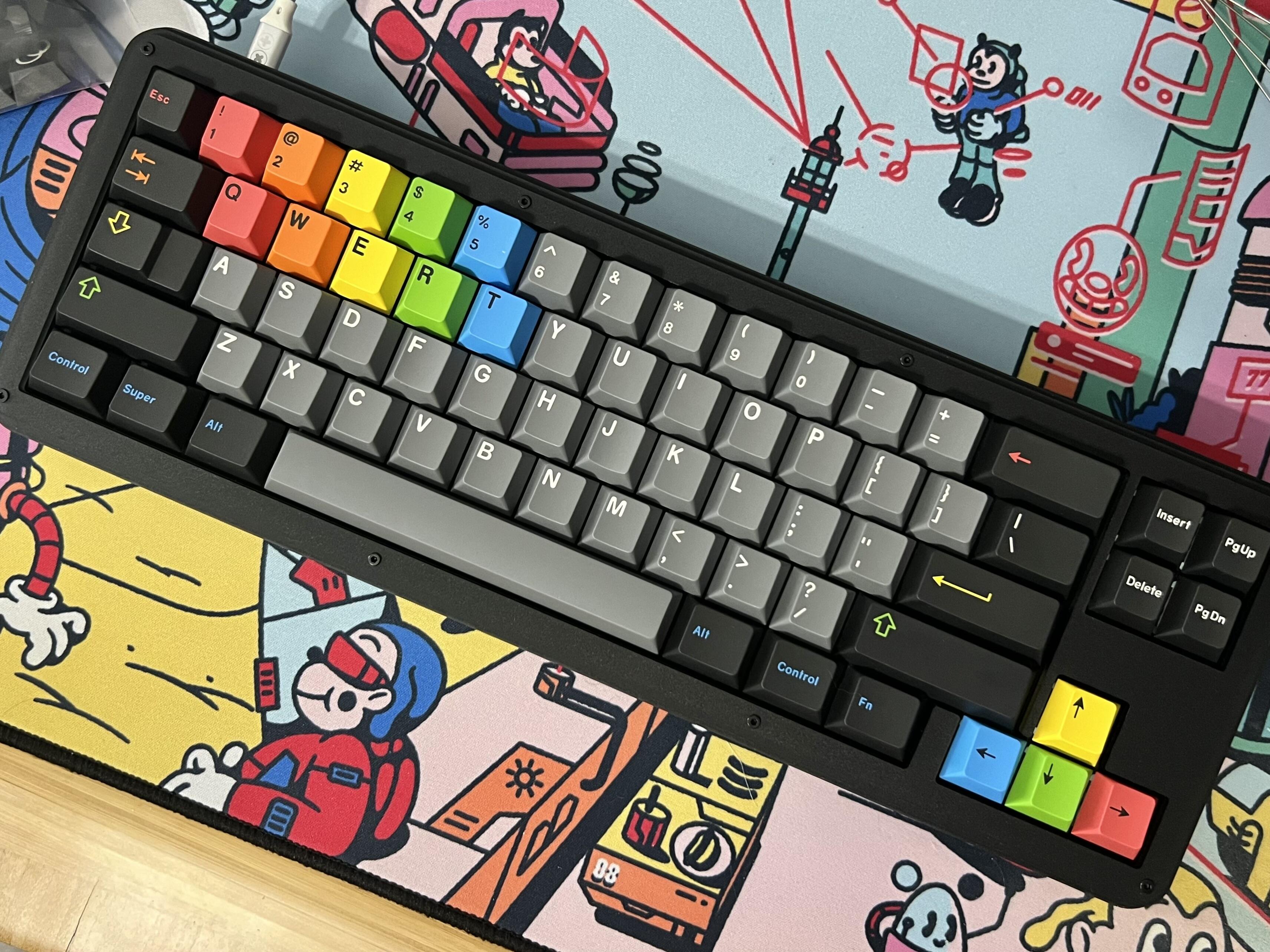

I built another Stellar65 this morning. Couldn’t pass on the super cheap deal from Omnitype. $70 for a nice hotswap kit that includes a carry case? That’s an insane value. I think I like this one even more than my night runner edition. Love the matte black.
This one is built with newly arrived BSUN waves rail bottom-out linears
New switches are very good but need work. The single stage loong spring feels good but needs lubrication to eliminate spring ping Also, this is a deep, thocky switch. But since its sound profile is rather clean and low pitch, any higher pitched sound sticks out. These suffer, like most switches, from an irritating high-pitched tick when you tap the front edge of the keycap. It happens often while touch typing for me, probably because when I type fast my fingers don’t press the center of the keycap.

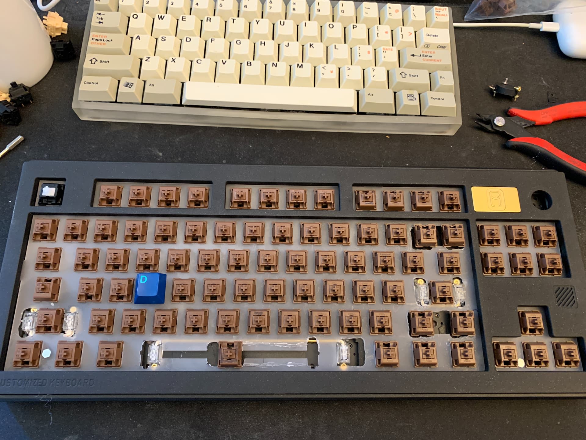

I made a fine mess of plate trimming but Bastion TKL PCB is working just fine in…I forget what the name is but its cast-iron case sounds pretty good. Switches: Akko POM Browns except for the Cherry Ergo Clear switch CannonKeys threw in along with the PCB.
NOTE how F9-F12 cluster is north-facing in F12 layout. For south-facing, you’ll have to go with F13 layout.
UPDATE: Doh. 7U spacebar means I’ll have to fix cut some more PC.

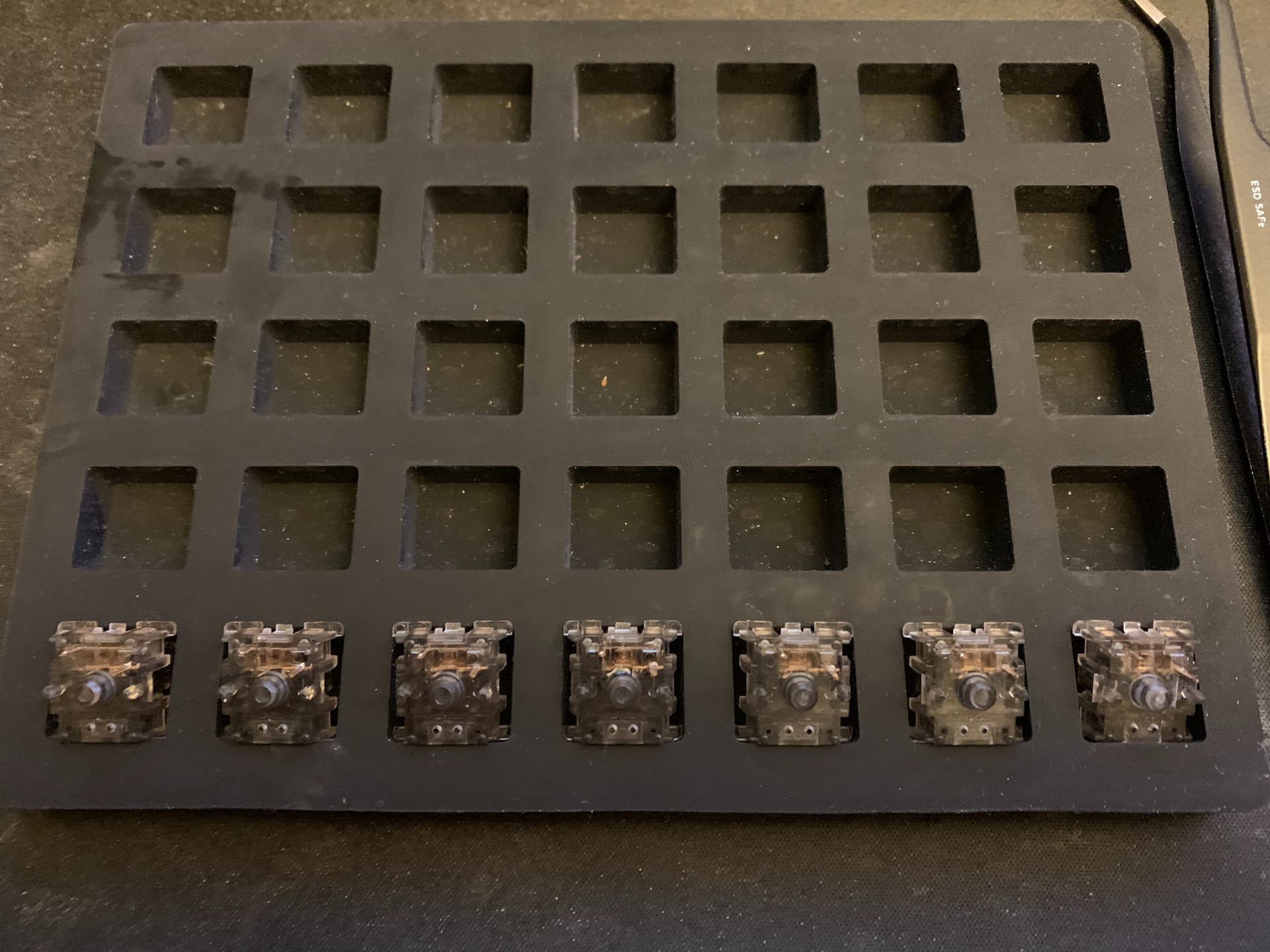

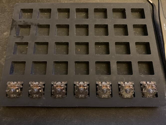

Pin-dripping worked with clear nail polish. Here is first test batch being dried. Just dip a pin into nail polish then touch the base of two pins to release just enough to fill gaps between pin and housing.
No idea how long this will last but, as long as chips don’t fall out, they should be stuck in position.
UPDATE: They’re Gateron Ink bottom housings. Not many loose but many pins move with slightest pressure, the kind a switch would experience as stem moves up and down. My hypothesis is that loose leaf is the source of the ‘dusty’ feel. :man_shrugging:
UPDATE2: After nail polish on pins dried, pins seemed stiffer. Usually, they’d give sideways. Weird.
I tried the same with one of the Gateron North Pole V1 switches which had what felt like a scratch mid-stroke as well as loose pin issue. Same with bonus: stiffer pin and no more scratch. Hard to tell what happened but I suspect tiny pin slippage could not only feel ‘dusty’ in use (typing fast) but ‘scratchy’ when pins are pressed more slowly.
I also tried applying nail polish to bottom side of some unused keycap. Not much pitch change but sound seemed crisper/harder. I’ll check on it after a few weeks to see how it changed over time.
Anyway, result is still tentative as I haven’t seen through the lifecycle yet nor tried other candidates like rubber cement and crazy glue.
Another crazy experiment idea: sealing shut a switch with the stuff instead of film. [UPDATE: Nail polished switch is firmer and less wobbly than filmed. Filmed switch’s bottom out sounds relatively soft where nail polished one sounds hard.]
I want to see how much of a mess it’ll be to reopen the switch. I have some broken Inks around to sacrifice. [UPDATE: confirmed that sealed switches can be unsealed using a switch opener and…no mess that I could see. Just needs a tad more force than normal switches.]
Not crazy. Just curious.
Observation: Of the two leaves, the leaf with thinner pin is more likely to teeter totter when nudged sideways. Applying nail polish fixed that, no idea for how long yet.
BUT I can say that this is a promising alternative type of solution to several old mechanical keyboard troubles. Finding the ideal substance could take some time though.
Don, that looks like a KeebMonkey WK870 case. I have a light gray version, it’s a bit heavy.
Aha. Thanks. The name and vendor sounds familiar now. :roll_eyes:
