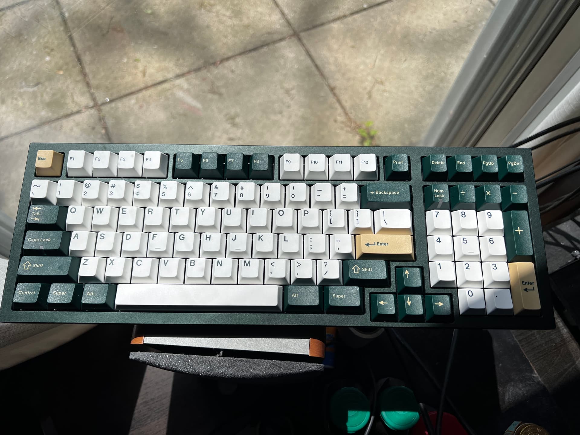

Put this on top of my speaker to capture the light from my window better.
Brutal V2 1800, used to have EPBT 9009, went to Mode Tomorrow keycaps, and now its rocking GMK British Racing Green R2. Hard to find anything that will color match better than this one.

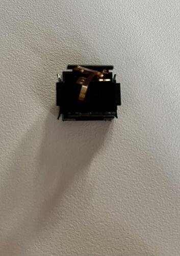

T1 has a respectable tactile leaf, so you will need to use adequate lube so that the DMT stem can function.

Btw the board looks so good!

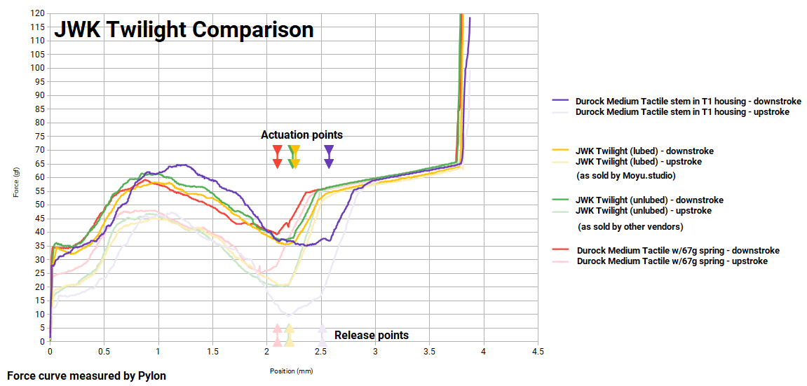

I’m using TX XL 18mm 60g springs and a 18mm 67g spring in my spacebar for return speed and to match the feeling of the alphas. Generous coating of 3204 on the stem, housing, legs and a light layer on the leaf, though if you lube the legs heavily you can skip the leaf layer.
If I recall correctly from reading the Geekhack IC thread Pylon and Brainandforce ended up using the same 67g spring as the stock T1s. Unfortunately it seems as though the actual GB samples Pylon received were using a leaf that was actually the original Durock Medium Tactile leaf instead of the T1 leaf:
When I tried making my original samples I had Durock T1s in clear and smokey housings, and JWICK T1 black housings. The Durock housings felt a little more tactile but also a little more sluggish since the tolerances are a little tighter than the JWICKs, and actually I had a DMT stem get stuck in the clear top housing because it was thicker than the slot in the top housing. Personally, I would recommend sourcing the parts from the official Durock store on Aliexpress if you haven’t yet, because JWICK T1s are usually less than $0.25 USD a switch (currently $0.14) and DMTs are $0.30 USD right now, which makes frankenswitching this very reasonable for a pretty unique switch. JWICK housings are so much cheaper than Durock T1s I’d rather just use those for this, and they sound better being full nylon.

And thank you! It was really hard to find something that color matched quite the way I wanted so after this I think I’m done with colored anodize, either silver or gray for me from now on for color versatility.

So the DMT stems worked. I think I got away with 65 G 14mm TX springs for 1U testing with Cherry-profile. I may also have used 62 G 16mm springs, as those had been recently released.

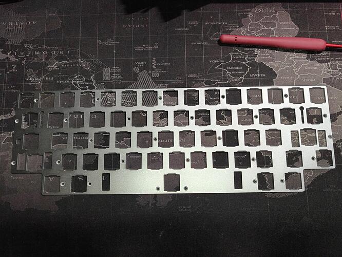

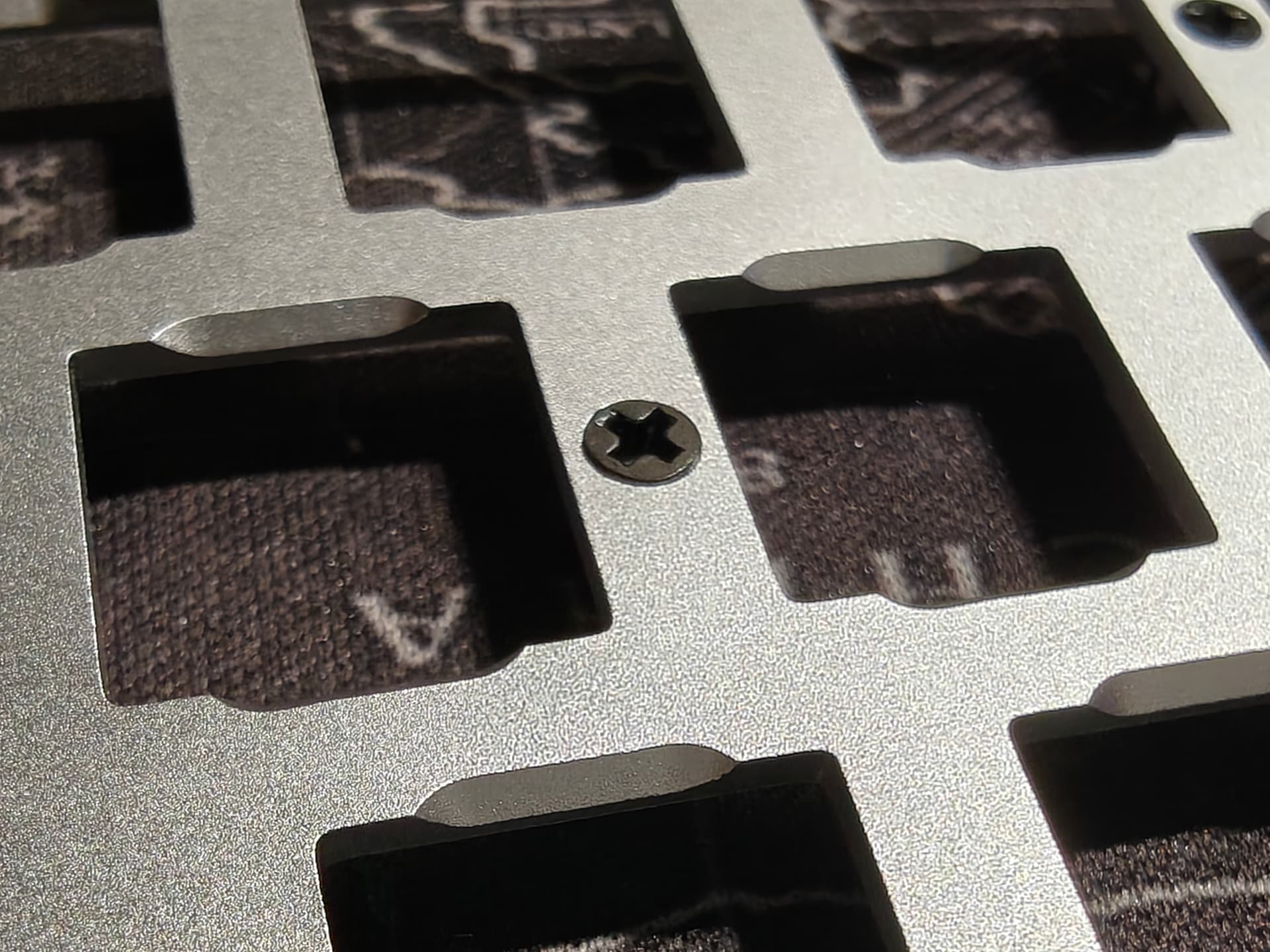

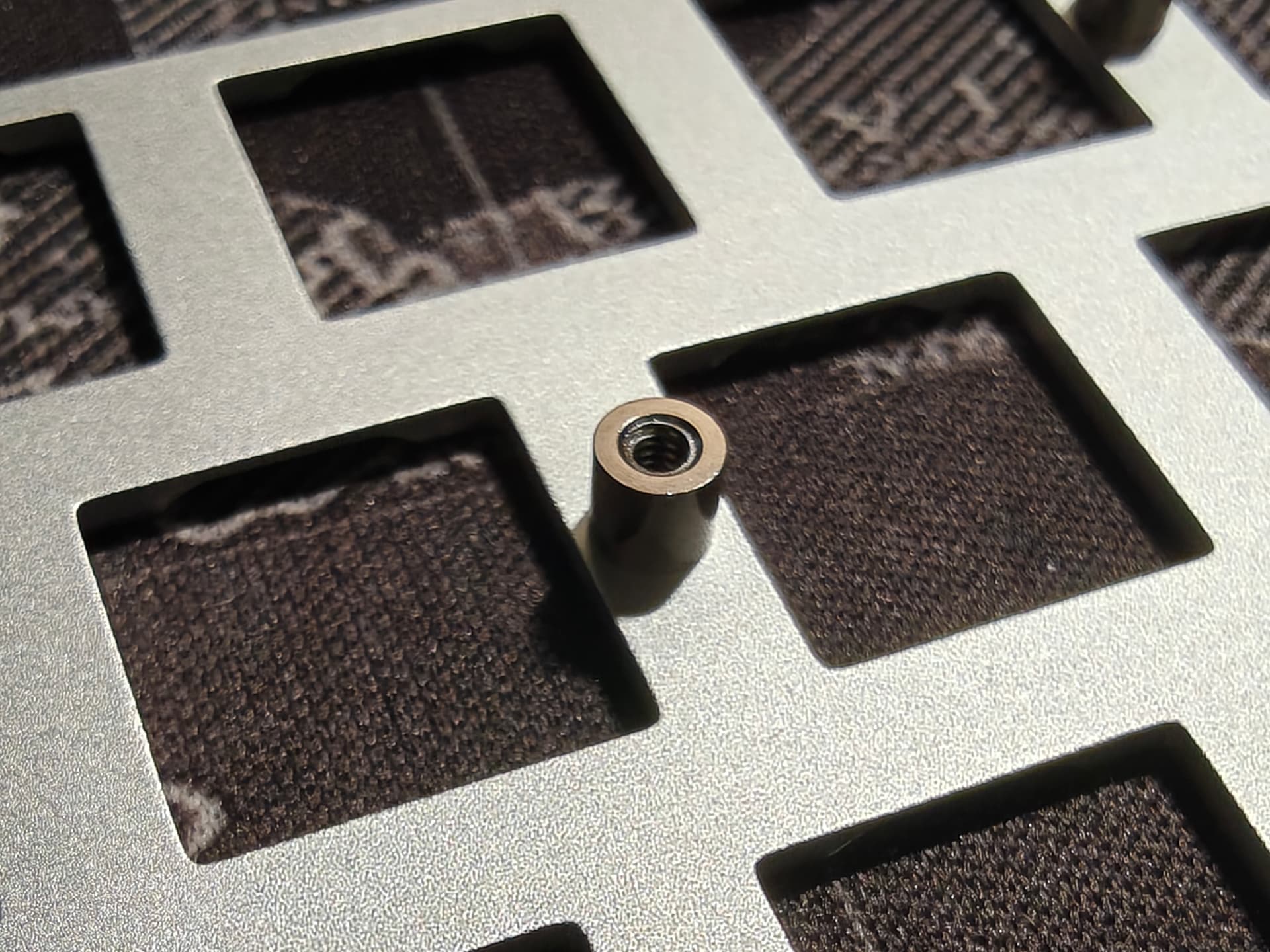

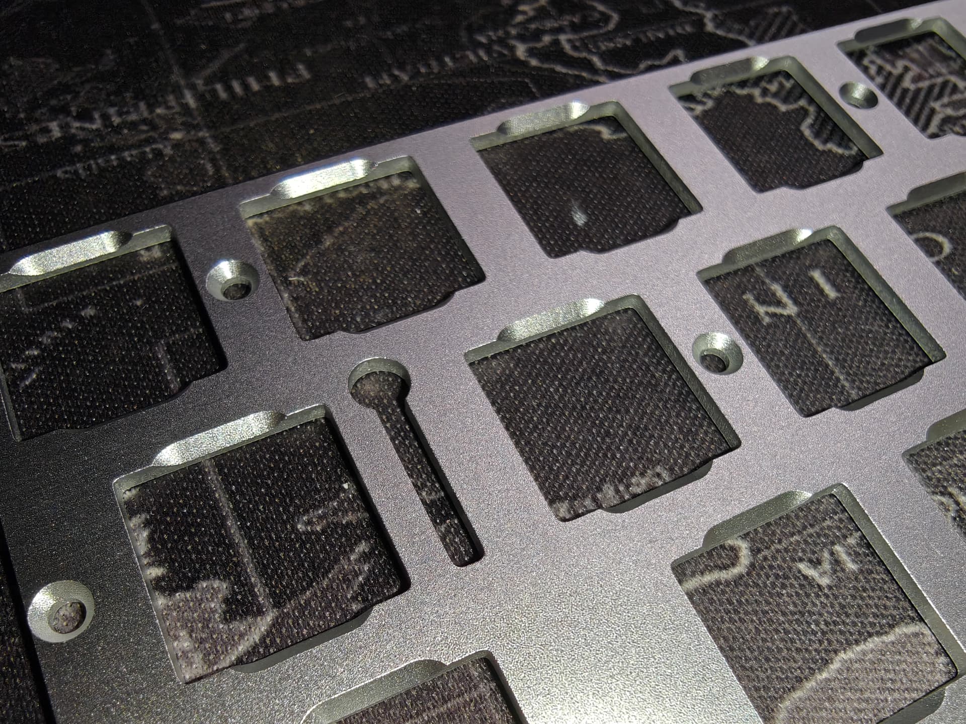

Swapped in the 1.0mm alum plate & swapped the caps out to MTNU Dolch on my F1 today. The 1.0mm plate makes it feels a little bit softer, not hugely different with a 1.6mm PCB though. The sound again remains largely unaffected like with the plateless setup, think that is just the hallmark of truly having full isolation from the case with your mounting system at this point though. I’m eventually gonna pair this plate with a 1.2mm PCB for maximum effect. Also looks so good with my two tone case & seeing the red peak out from under the caps! Although it does kinda limit the sets that will look good on it too. :man_shrugging:
Huh so this is the really thin plate? And then those are flex cuts around the alphas? Looks interesting! I will have to research this guy a little more!
I still need to build up my F1-8x, but I just with with the classic plate. Not sure yet if I want to experiment, but I have been like your posts about what you are doing with yours!
Yep, this is the v4 1.0mm alum plate & the relief cuts around the alphas definitely help it feel a bit softer than using the regular thicker alum plate. However pairing this with a 1.6mm PCB definitely kills any real flex or bounce from happening. I need to get it paired up with a 1.2mm PCB to see if allows for anymore give or not. The problem being is the only 1.2mm TKL PCBs I got are all solder PCBs, so I gotta start to try out some other switches I want to hear/feel in the F1 before I decide what I’ll use there. I also got a PP plate for my F1 getting cut at Hype while we speak so if you want the rundown on any of the setups I’ve used in mine so far just PM me bud!
Being honest though, all setups have felt & sound fairly similar with 1.6mm PCB (even plateless!?) because the mounting system so thoroughly isolates the plate/PCB from the case. So don’t expect huge differences in sound or feel with different plate materials or thickness. Like I said before a 1.2mm might let the feel & sound change a little more, but I still have to confirm that before spreading it as fact.
How do the switches clip into a plate that thin? I thought the MX spec was for 1.4-1.6mm plates. Are there shims, or is it just cut with tighter tolerances for friction fit?
You asked the question I couldn’t properly formulate, but has been stuck in my head since I saw this.
Hmm youre right I’ll have to look at it after work. The switches clip in the plate fine & the plate doesnt move up or downon the switches. Ill let you guys know a little later!
@wjrii & @TheNamesTy45 So regarding the 1mm plate for the F1 & how do switches stay fit in it. I just took my F1 apart to swap in those new Granite switches & took a look. It seems like the switch cutouts are made a little bit smaller than normal spec as all switches feel like a tighter in the 1mm plate so the extra friction helps keep everything in place. It is a switch by switch basis on if the switch will fit tight or loose though, the Keygeek Y2s fit tightly & don’t move around at all while the TypePlus Granites fit decently looser & could move up & down in the extra .5mm of space. However it mainly works because when plate/PCB are installed the switches will naturally sit all the way down on the plate & with the F1’s mounting there is nothing to push back up against the force of you typing. So even with looser fitting switches once everything is all put together the missing .5mm of material the switch needs to be totally vertically secured in a plate actually doesn’t matter.
Also now that I got the TypePlus x Alexotos Granite switches installed in my F1 & have used them a little bit I do gotta say they are really nice! The dry lube they’re using on these works great! They are super smooth, no unwanted noises from the springs or leaves, but they have a livelier sound more reminiscent of a unlubed switch. Same with the feel of the switch, while they are super smooth they have a livelier feel vs a wet lube. The housings are decently tight, definitely don’t need films. Although the top housings are a pretty soft material so they might need films if they get opened & closed a bunch. The stock springs are a little heavy for my liking so I’ll probably swap them out eventually, but totally a preference thing. The springs themselves are definitely high quality. Overall I’d definitely recommend these switches even to a beginner as they’re very useable stock & just feel/sound high quality all around IMHO! I haven’t tried any yet, but I’d assume the Classic Blues are just as good.

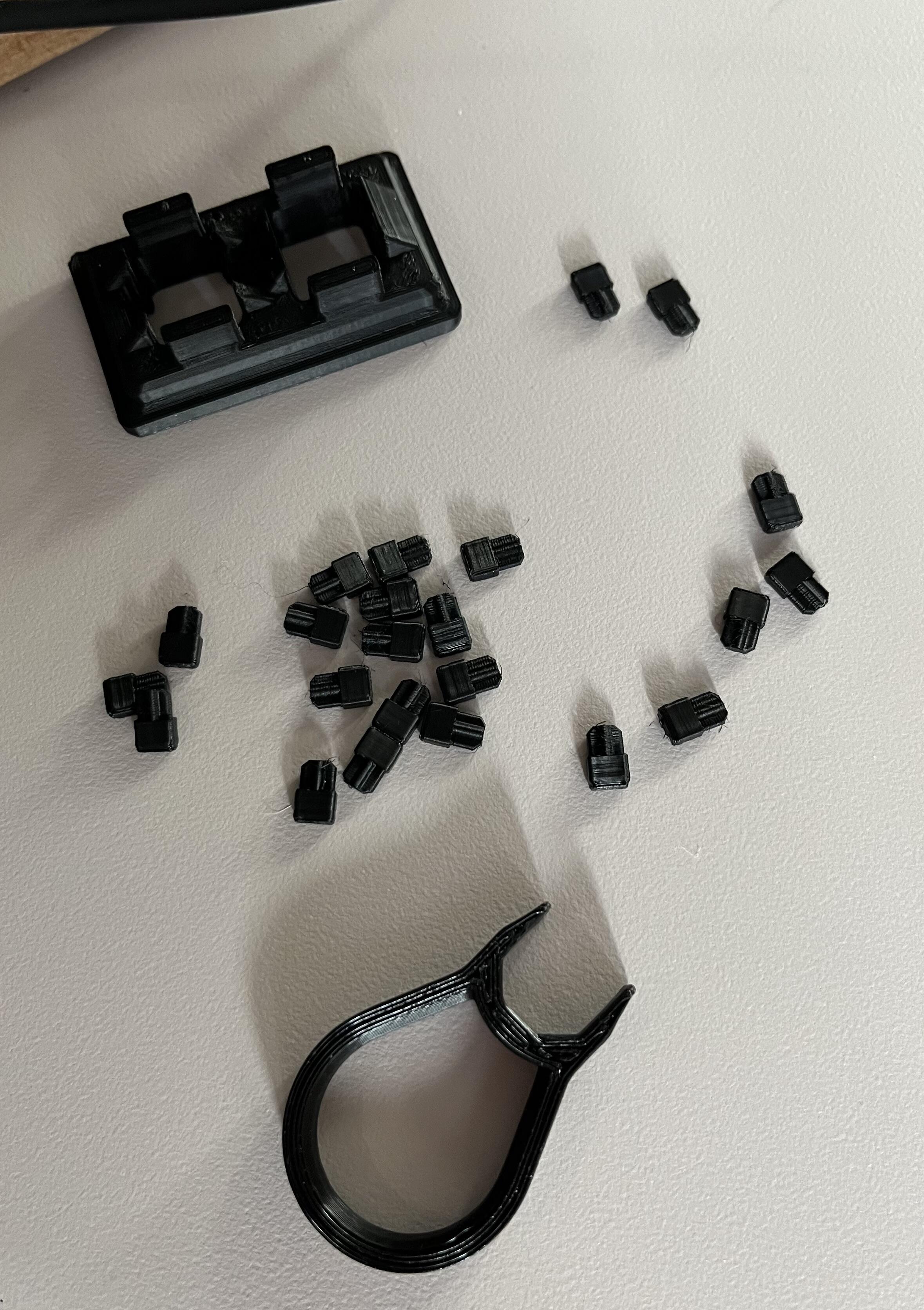

I’m in that liminal space where I’m not quite out of my old 3D printer filament, but I don’t have enough to make a “project.” So, an MX opener that I’ll use until it breaks, an Alps opener that only works well on loose switches, and some Alps-to-MX adapters. The latter will be initially paired with some cheap low-pro caps after I linearize my simplified black Alps Wyse clone.
Bonus blurry pic of the gore when you don’t realize how much more fragile the simplified are than the complicated…

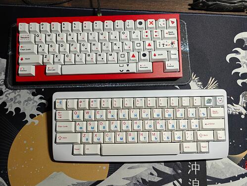

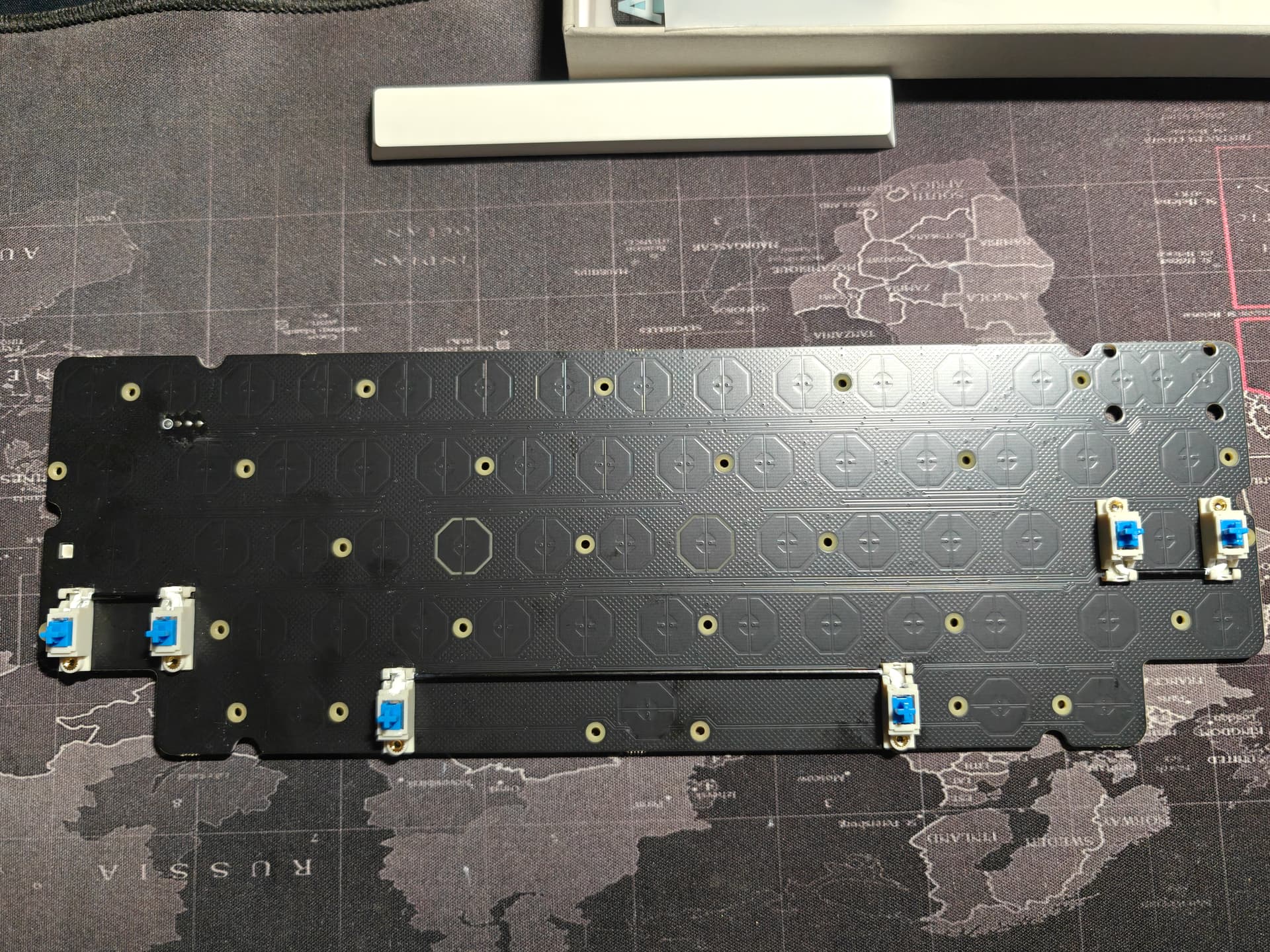

Today I spent most of my time on “Agar”. And tomorrow I’ll spend more time on magnetic switches on Tofu2.0 and will add to this post.

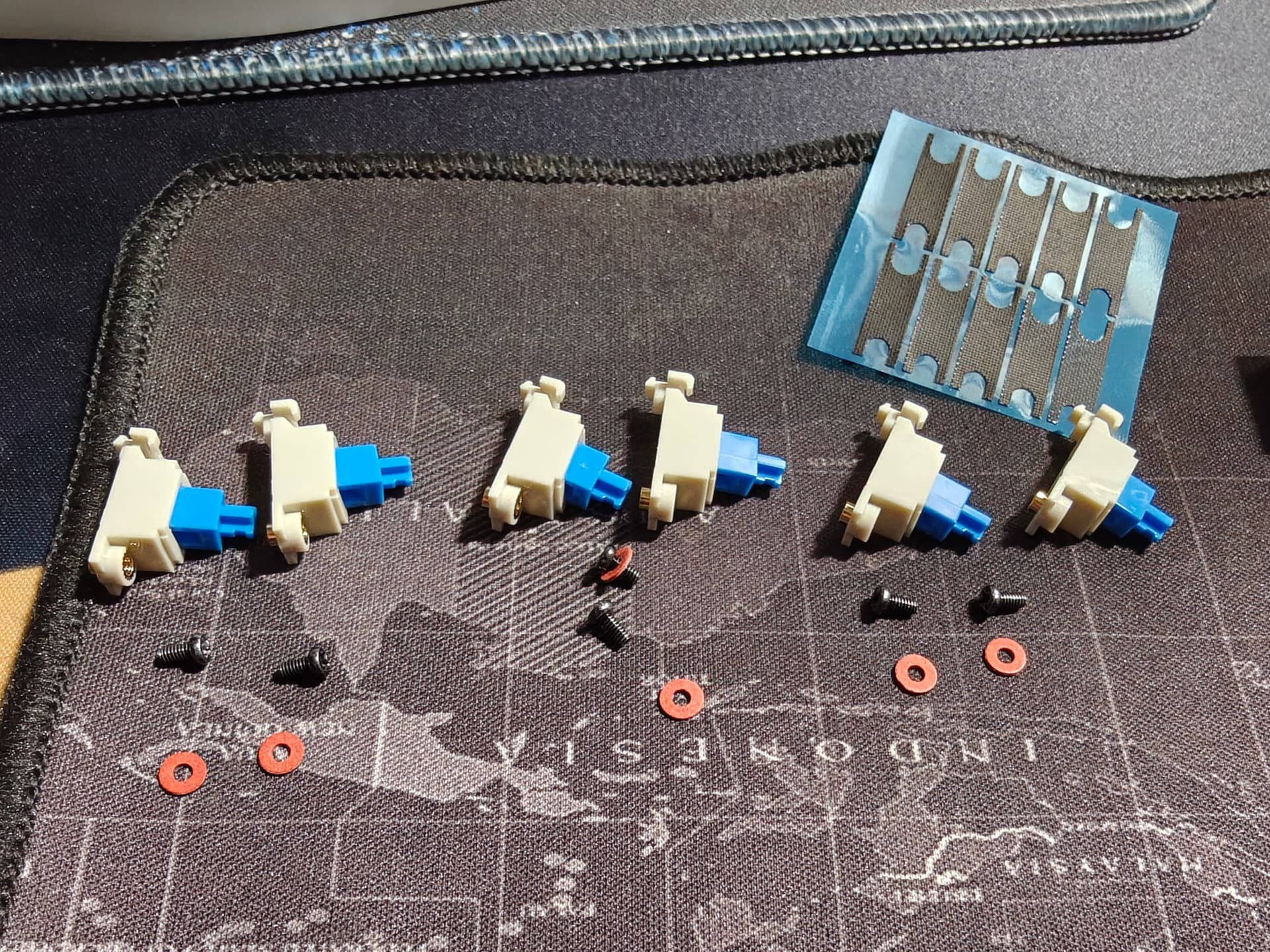

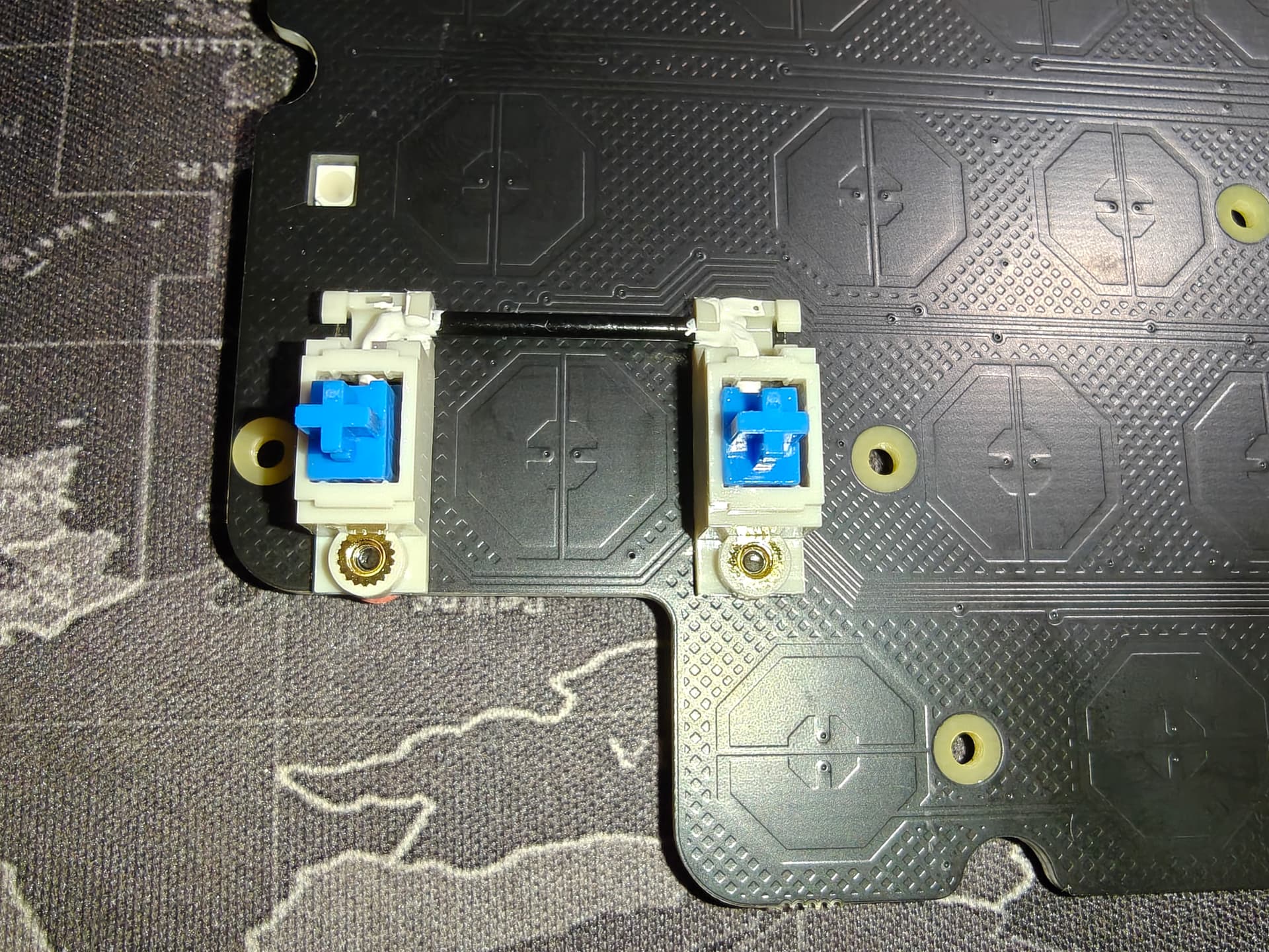

In order not to disassemble or assemble, but to close the topic of stabilizers forever. Plus the switch itself pseudo Topre is silent both downstroke and upstroke.
decided that stabilizers here are more important that they do not make noise than a pleasant movement or sound.
Stabs - Designer Studio Adaptive PCB-Mount Stabilizers are best suited for this IMHO.
Just look at how many bolts are needed here. And you need to tighten it from both sides… :flushed: :neutral_face: :scream:

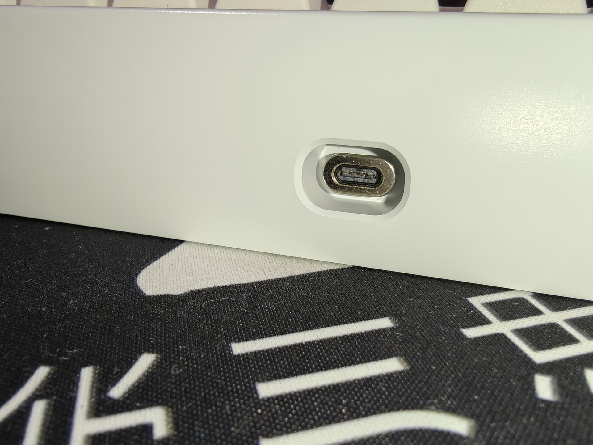

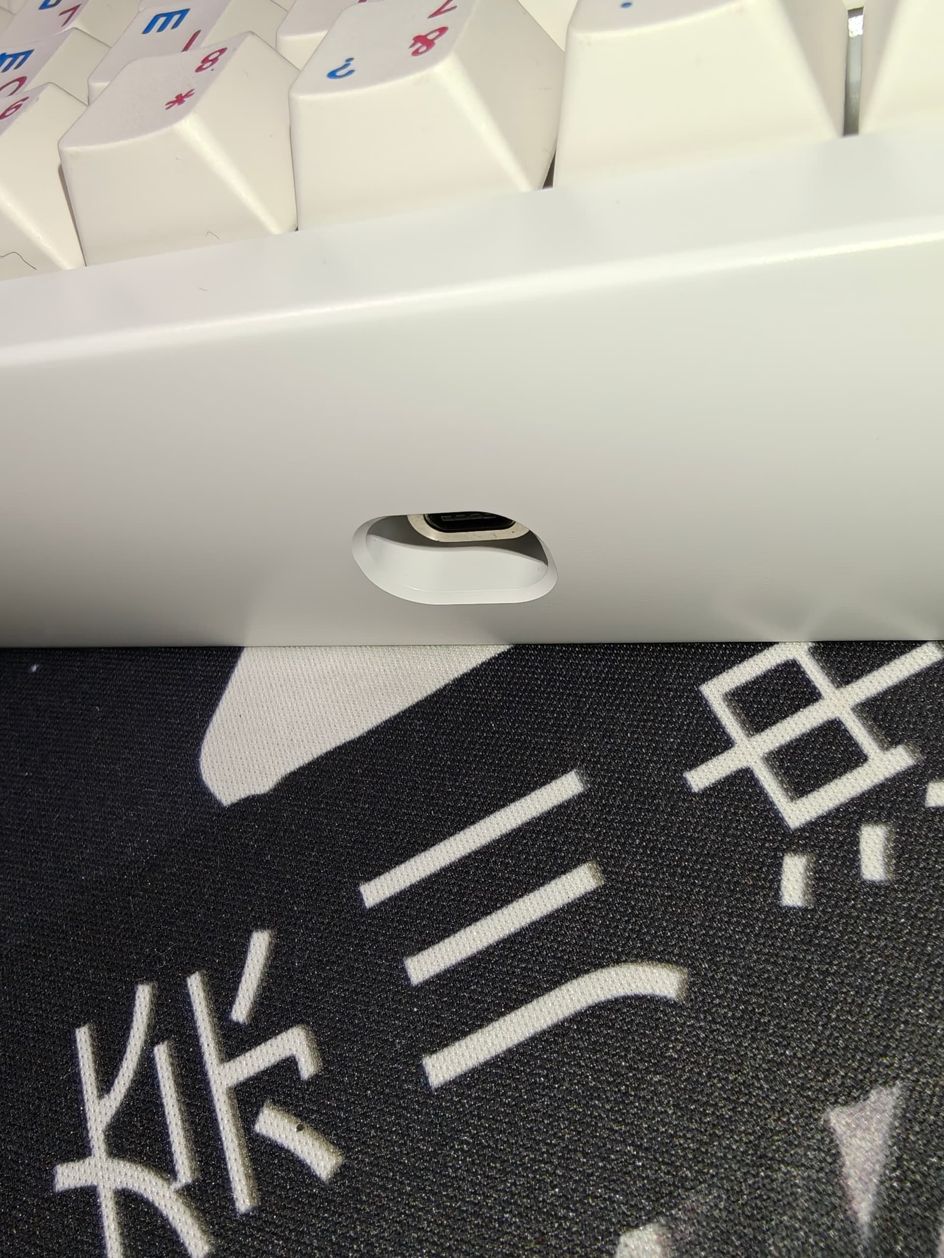

USB is very deep inside.
Not every cable.
But I have a magnetic cable as always)

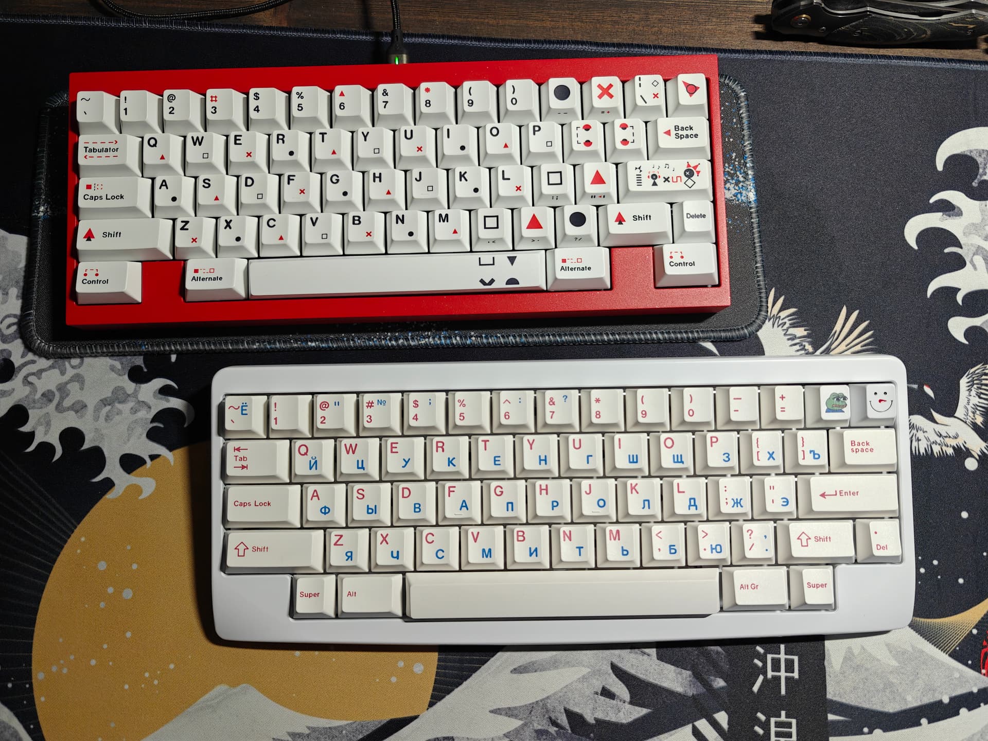

Summary
This story isn’t really about the Agar case itself — it’s more about the quirks of using Tecsee switches.

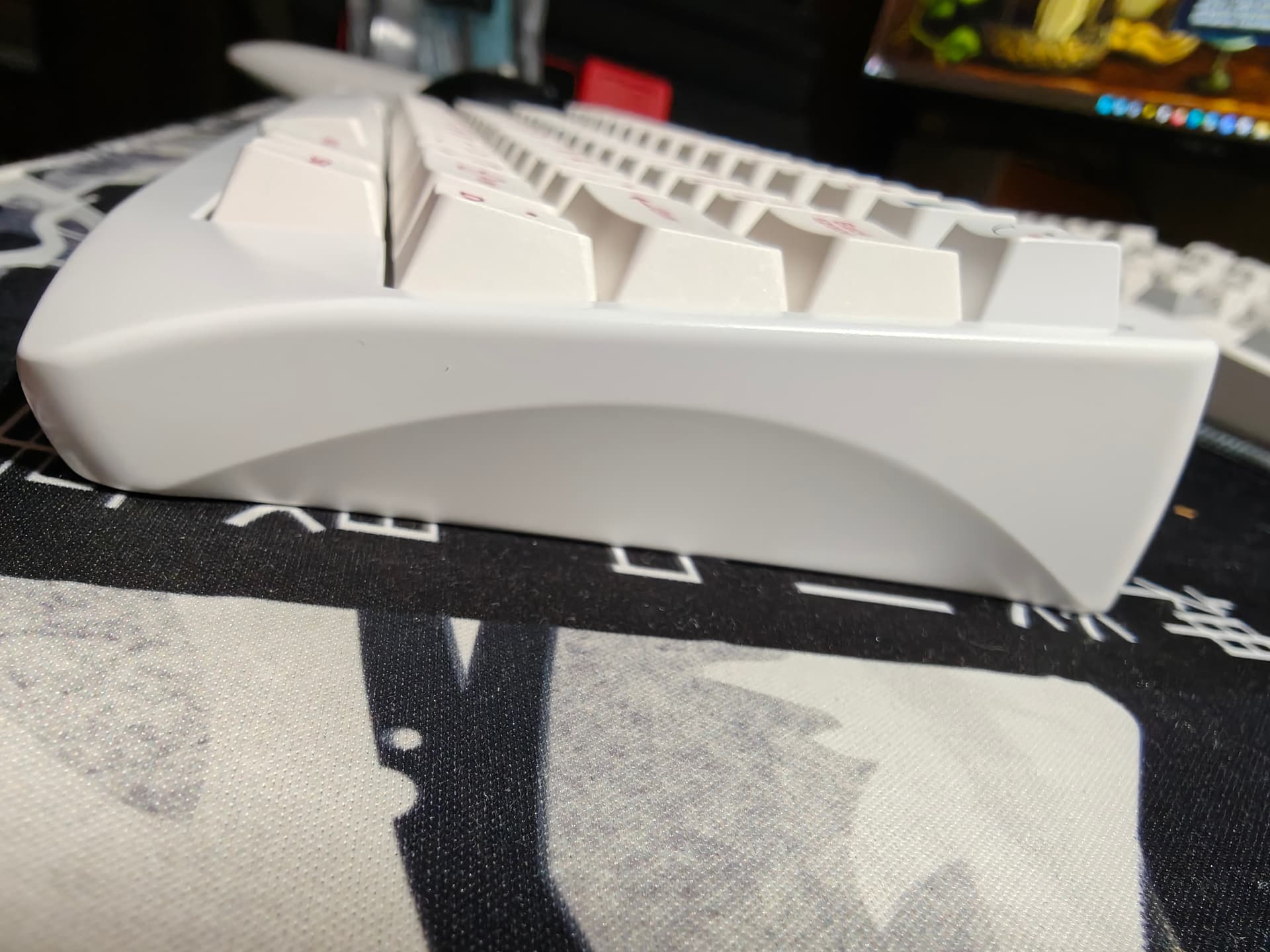

The Agar case makes a solid first impression: it’s heavy, monolithic, and has a nicely rounded aesthetic. The corners in particular feel great — both visually and to the touch. The only minor gripe is the finish. It’s smooth and glossy, almost lacquer-like, rather than the textured coating you’d find on some other cases.
The design doesn’t allow for any break force effect, which is great for maintaining consistent tactility. There’s one aesthetic flaw though: when you use a flipped spacebar, the gap between the keycap and the case becomes more visible than with a normal orientation. Interestingly, seeing the case in person made it obvious that some YouTubers completely missed this detail in their reviews.
The case uses clips for assembly — it’s not just a “sandwich” style. To secure the top properly, you need to press down all four sides in sequence until you hear four distinct clicks. Most reviewers just slapped the top on and ignored the assembly logic entirely.
There is some flex — even with an aluminum build and what seems like Topre-inspired internals. But it’s the right kind of flex: controlled, subtle, and not distracting.
Sound-wise, the center of the board is more resonant, while the edges are nearly silent — like dead quiet.
The USB port is recessed deep into the case, which looks clean and tidy. That’s not an issue for magnetic cables — I have two types of connectors ready to deal with whatever “designer choices”.
As for the Tecsee switches themselves — they don’t really need any prep work out of the bag. Maybe after a few days of abuse they’ll start squeaking or clicking, but straight out of the package, they’re eerily consistent. And I do mean eerily — they make no sound at all. It’s honestly unsettling if you’re not into silents. I’m not a big fan myself.
They’re not completely “no sound,” though — there’s a soft rustling, like lottery barrels in a cloth bag. The travel is short — feels closer to 3.0 mm than the 3.5 mm listed in the spec sheet.
As for the weight, they’re rated at 45g, but they feel more like 55–60g at bottom-out, similar to standard MX-style switches. I haven’t found a reason or excuse to lube them yet — there’s just… nothing making noise.
