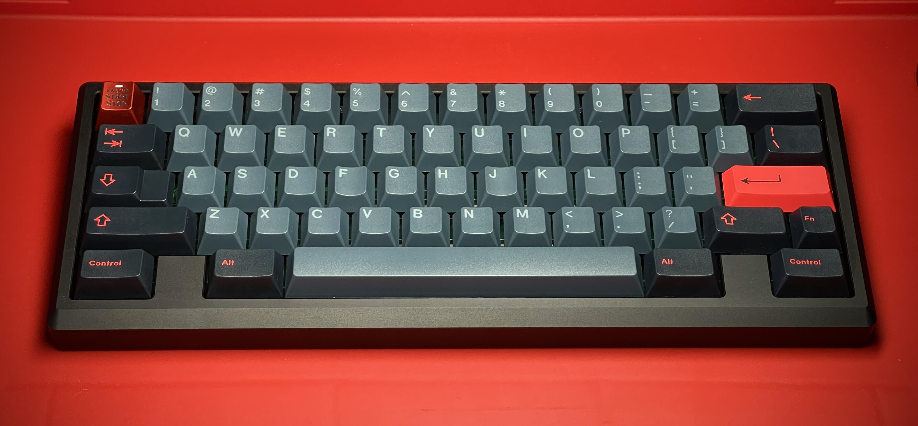

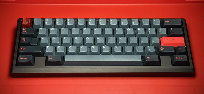

Beautiful build and thanks for the pictures! I was wondering if a standard 60% PCB could be used and they more or less confirm that it cannot be. Enjoy the build - that weight is beautiful!

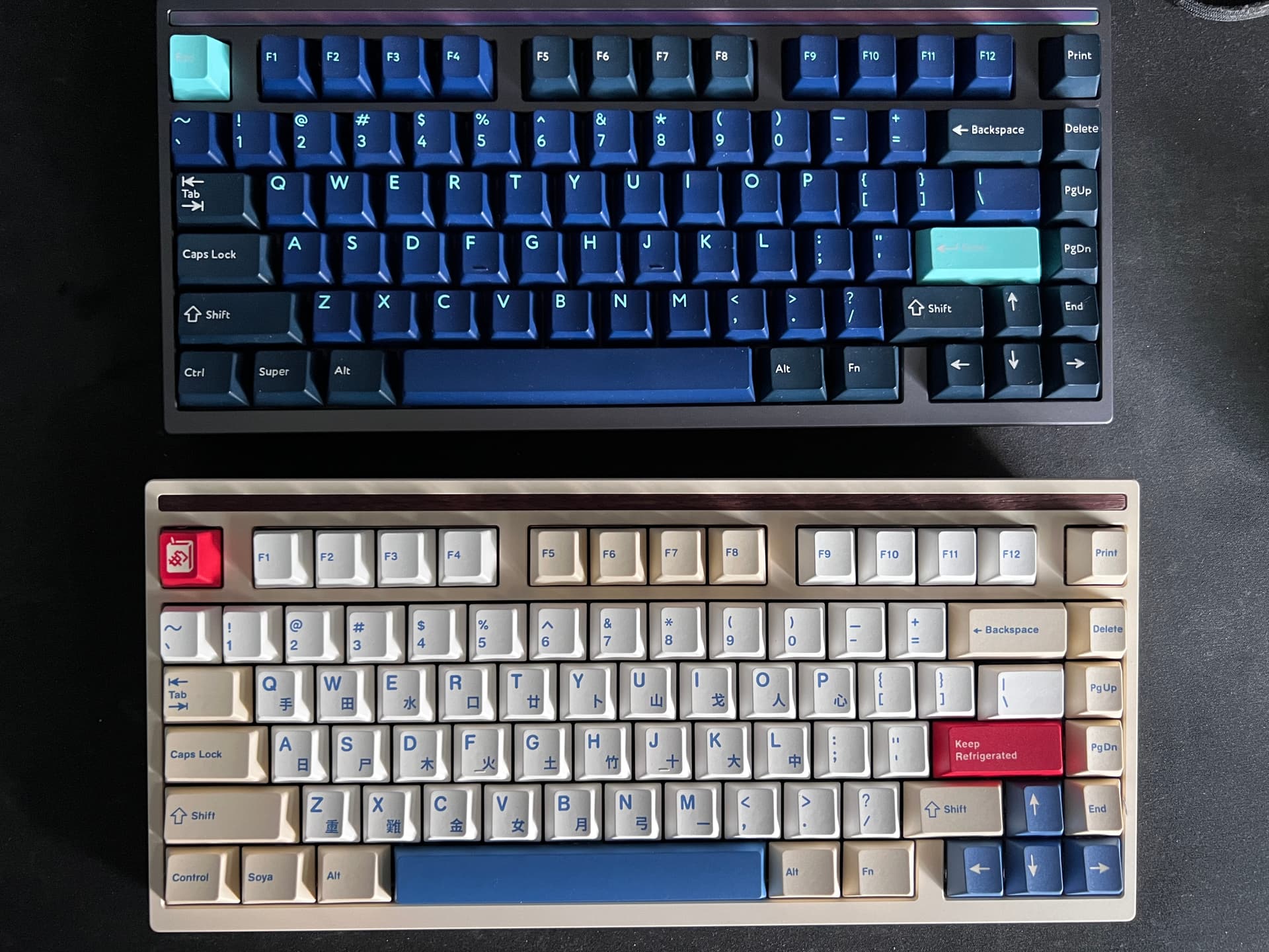

The GF’s Sonnet has been completed.

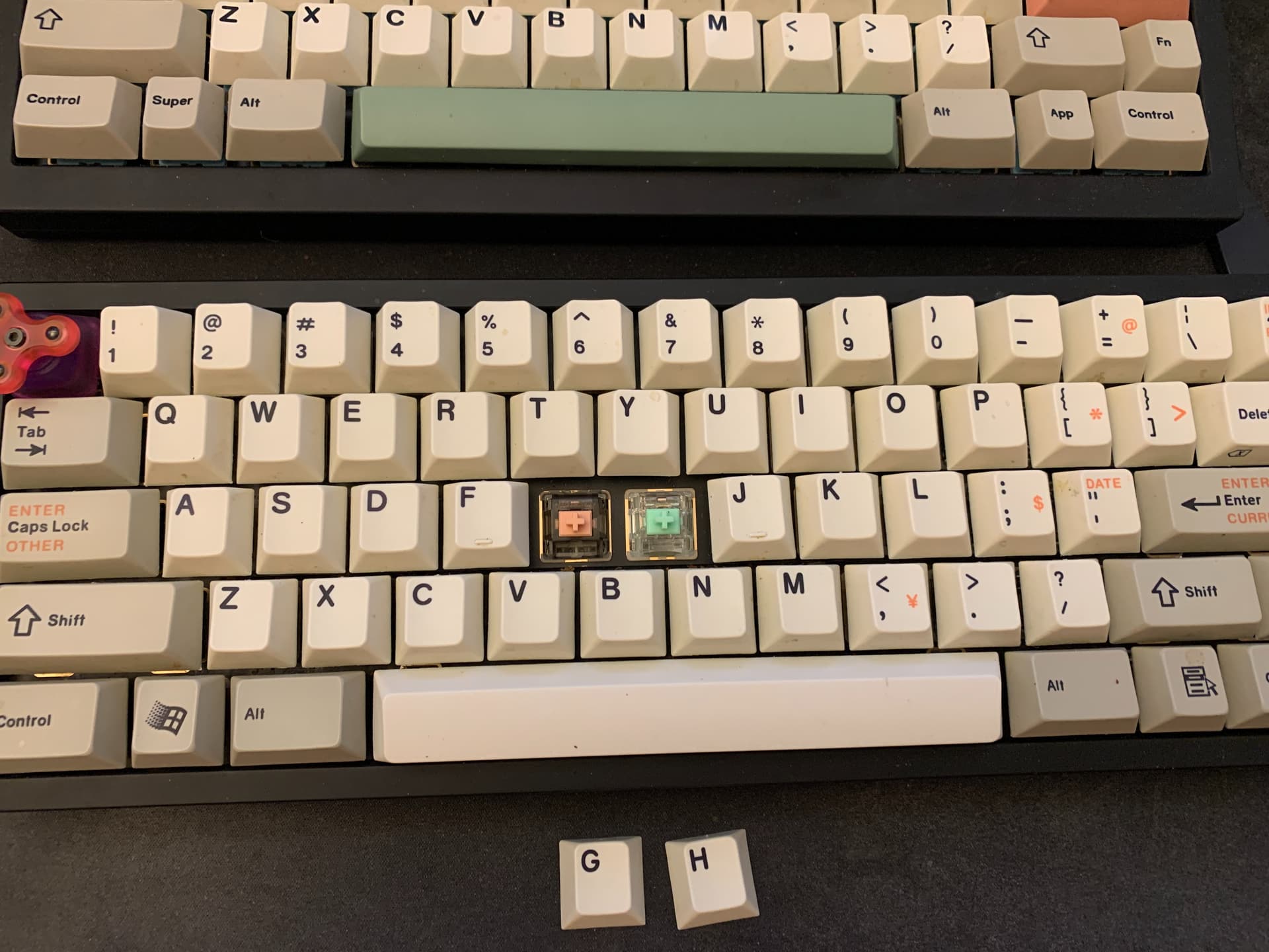

His: V0C1A2F3A4B5A6A7A8B9A
- Grey top, black bottom, multicolor accent, aluminum plate, plate foam.
- Durock T1s with 60g 18mm TX XL springs and a Kiwi with 67g 18mm TX XL in the spacebar. Kiwi is only there because I have one as a free sample from a vendor and its a distinct color from the T1
- PBTfans Deep Sea Predator Hoshoku base with Latin Alphas.
Hers: V0H1F2K3E4B5A6A7A8B9A
- Crema top, polycarbonate bottom, walnut accent, FR4 plate, plate foam, PE foam.
- Durock Medium Tactiles with 62g 16mm TX L springs and a 67g 16mm spring in the spacebar.
- NicePBT Soyamilk.
Both are using my self made stainless steel weights that I made earlier!

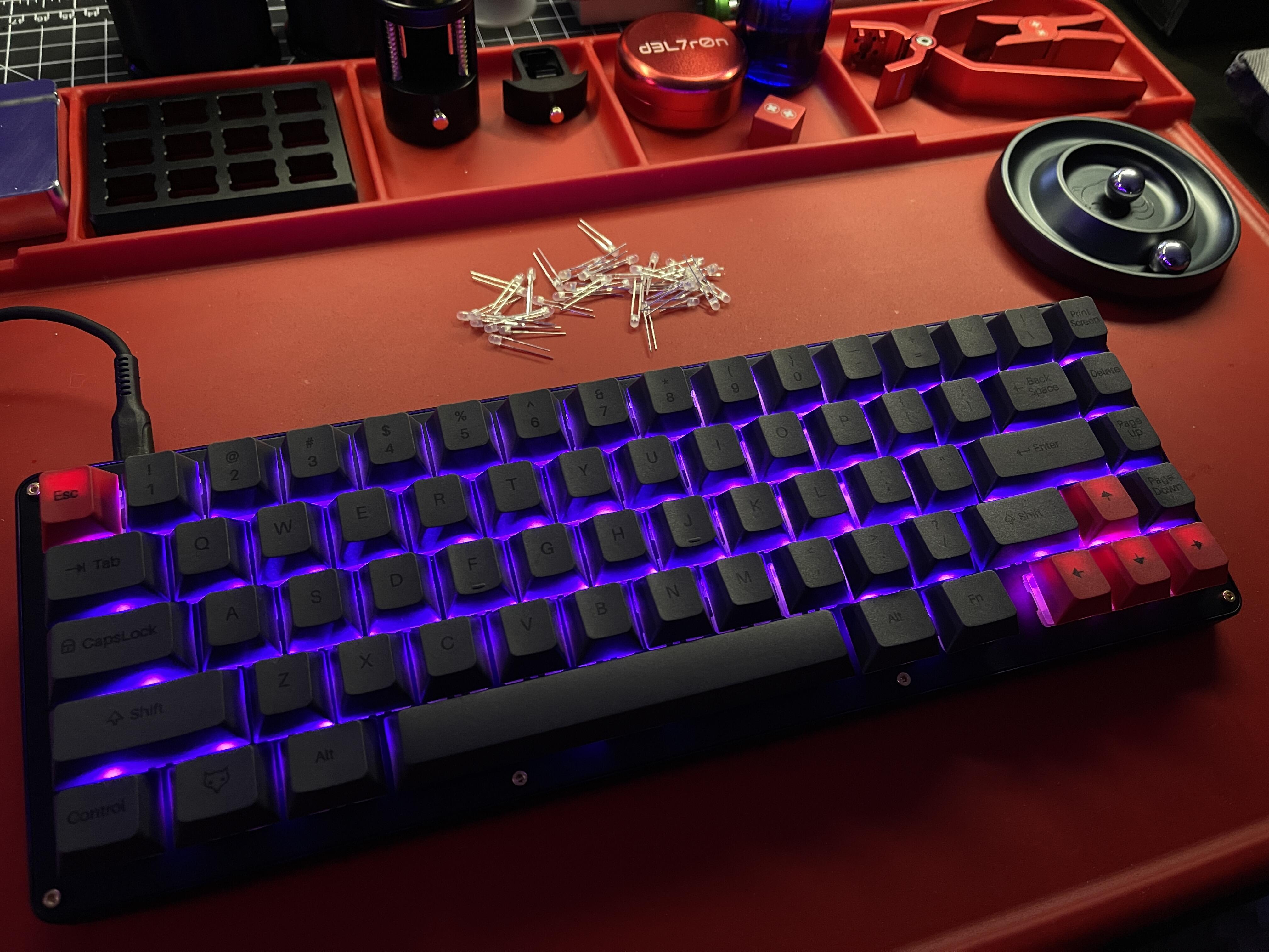

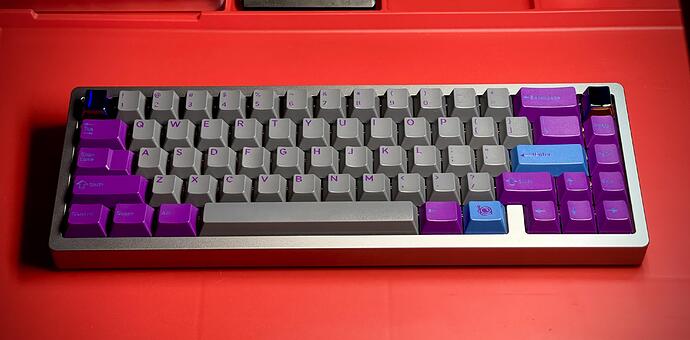

More work on the NightFox!!

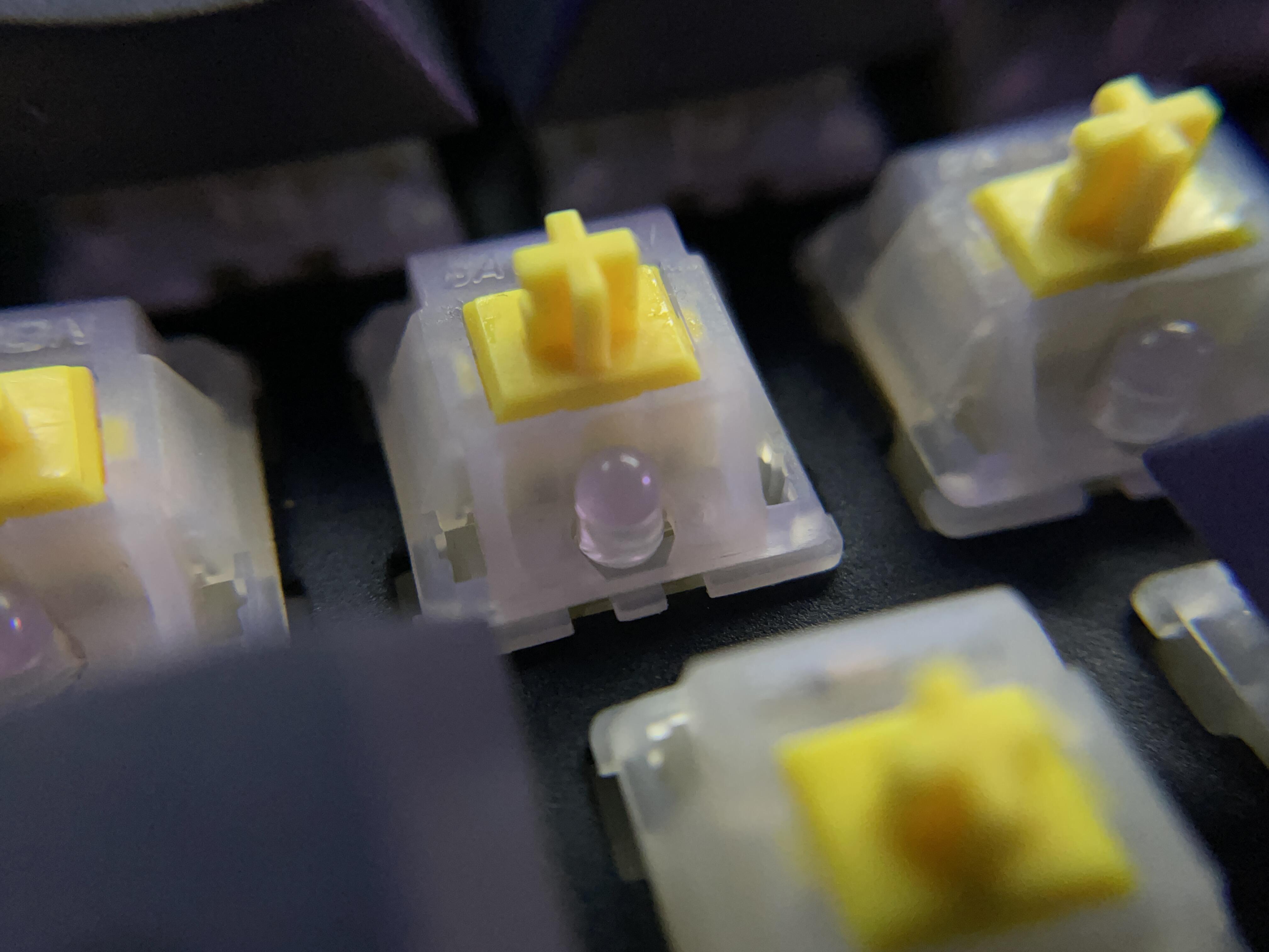

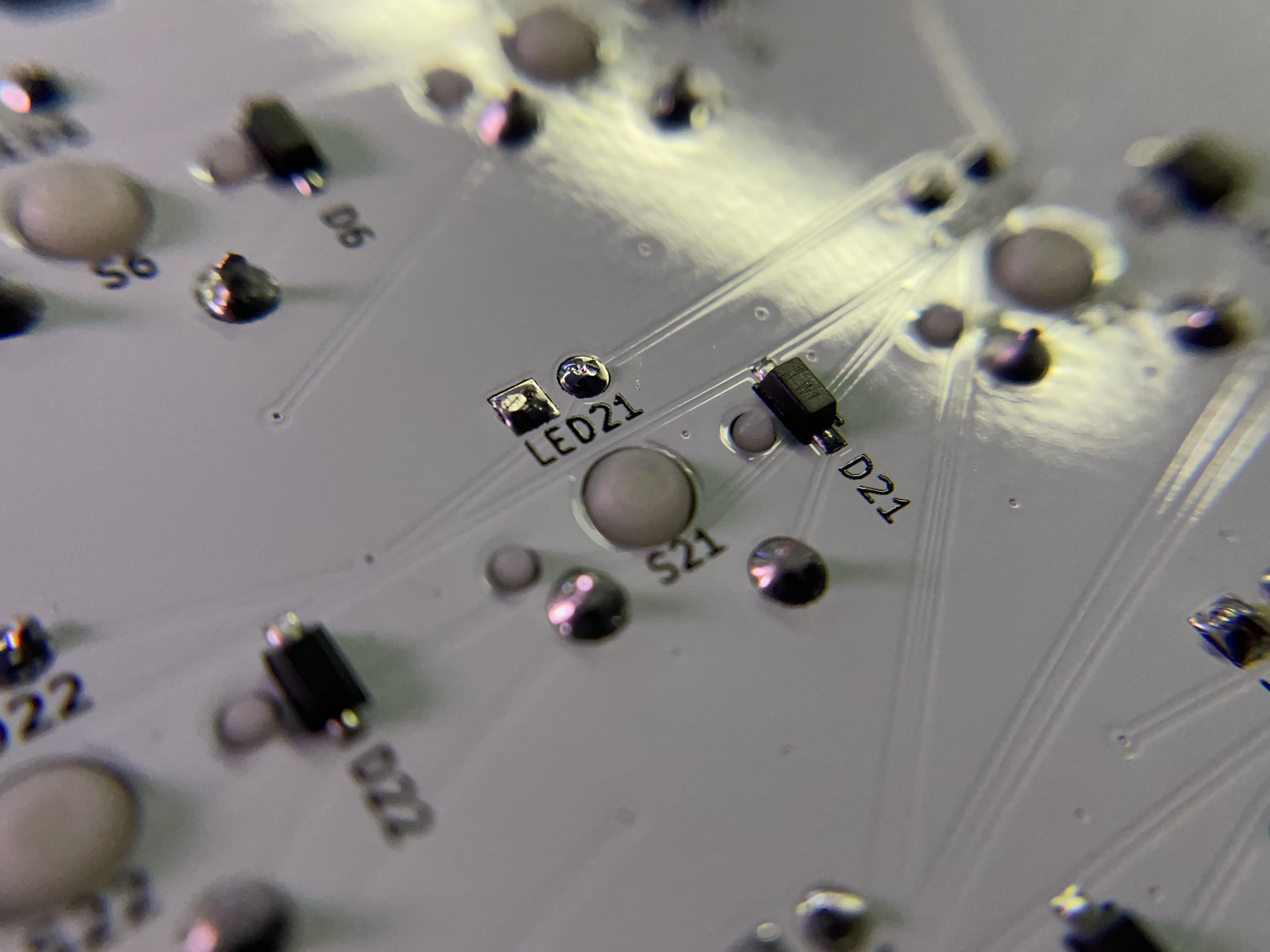

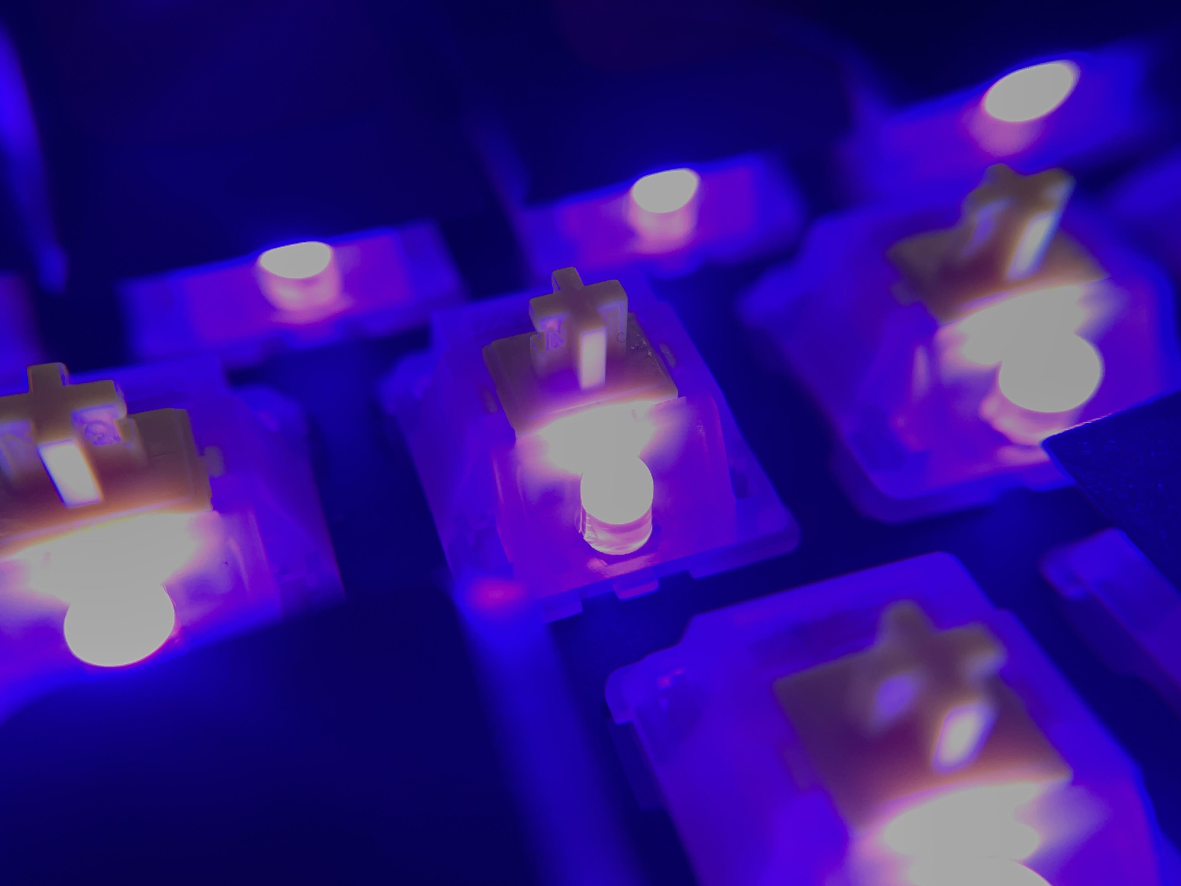

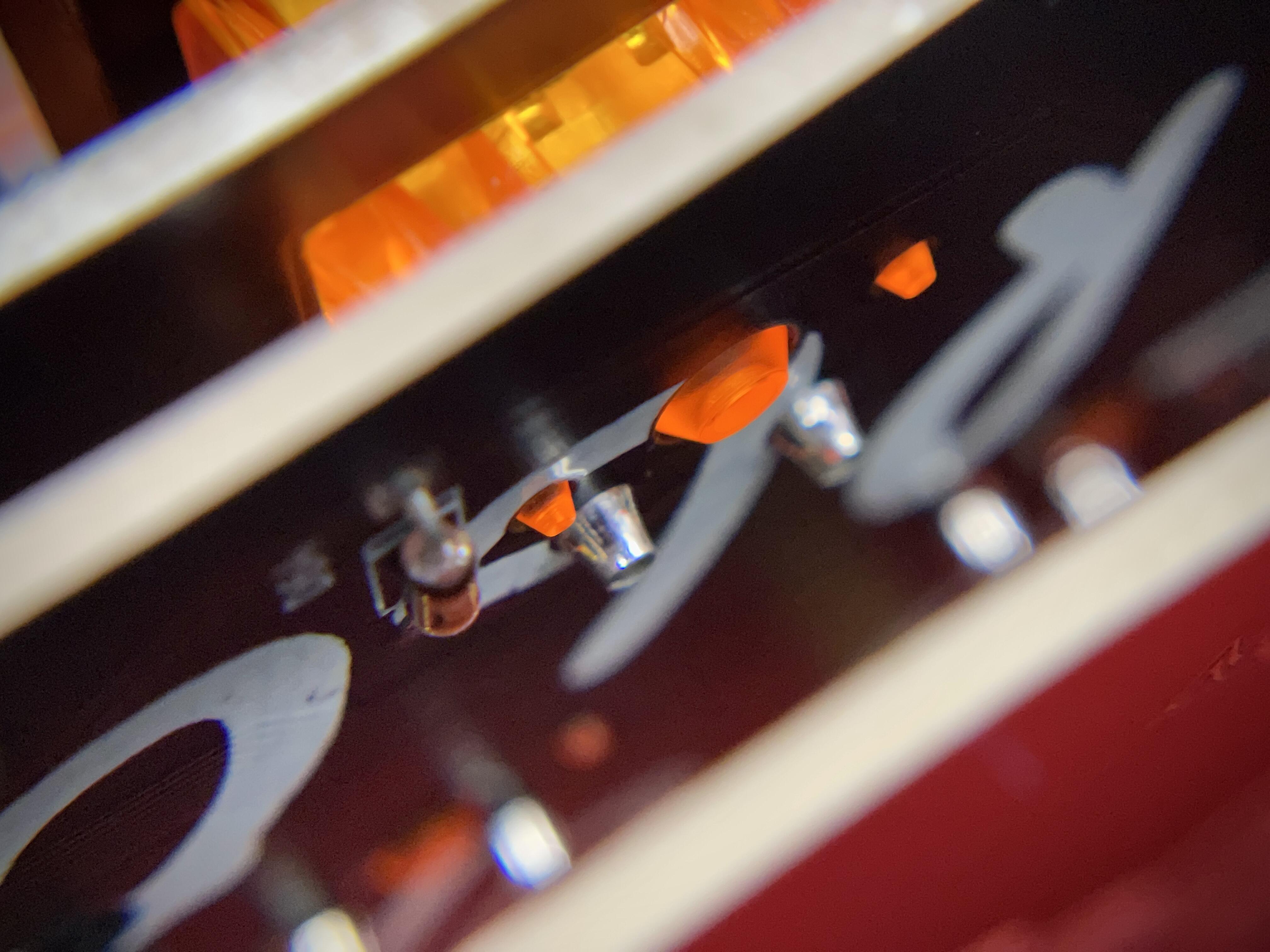

Added some LEDs to it. Didn’t want something super bright, so I went with frosted LEDs from Flashquark. Purple is my jam, so the choice was easy.
Also, chose to swap out the plate screws with something more flashy a la @Deadeye ![]()
Really liked how it turned. Just had to watch a quick tutorial on which way the LEDs were installed (longer leg goes into the “square” hole) and I was off and running. Solder job isn’t going to win any awards, but I’m proud of it ![]()

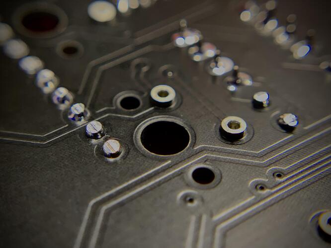

Not really on a physical workbench per se, but I finally managed to make and compile working firmware for a custom RP2040 handwired build, and then port it to VIAL.
It only took about 3 days of barely doing anything else, but most of that was because all of the examples and tutorials I found were out of date, and nothing would compile if I went by what they showed. I guess QMK switched up how their config files work in the past couple years? The VIAL part was weirdly easy after that.

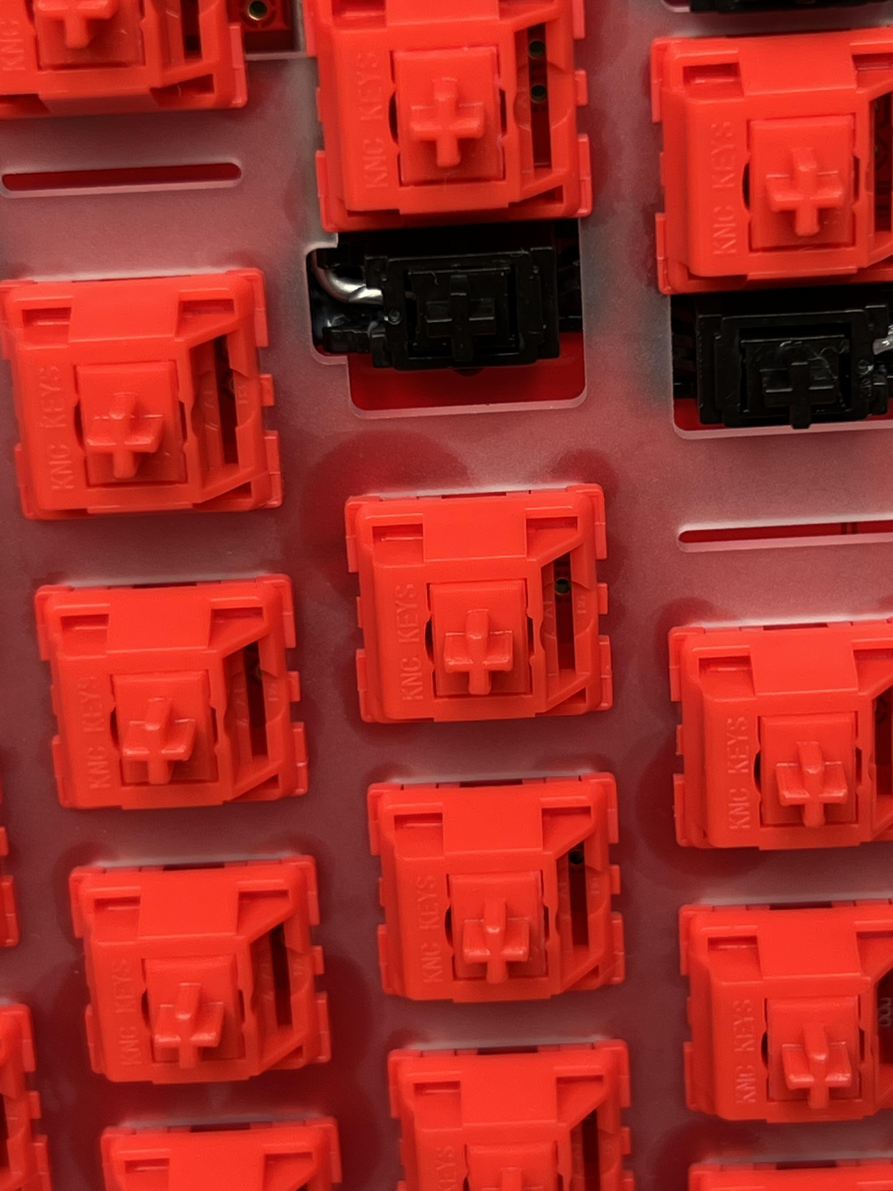

Went with KNC Preference switches. They sound surprisingly poppy for a gasket mounted PC plate.
Apparently they have a lot of oil in them which you can see leaking out onto the plate:
Oh well… maybe oil is good for PC… keeps it moist so it doesn’t get brittle ![]()

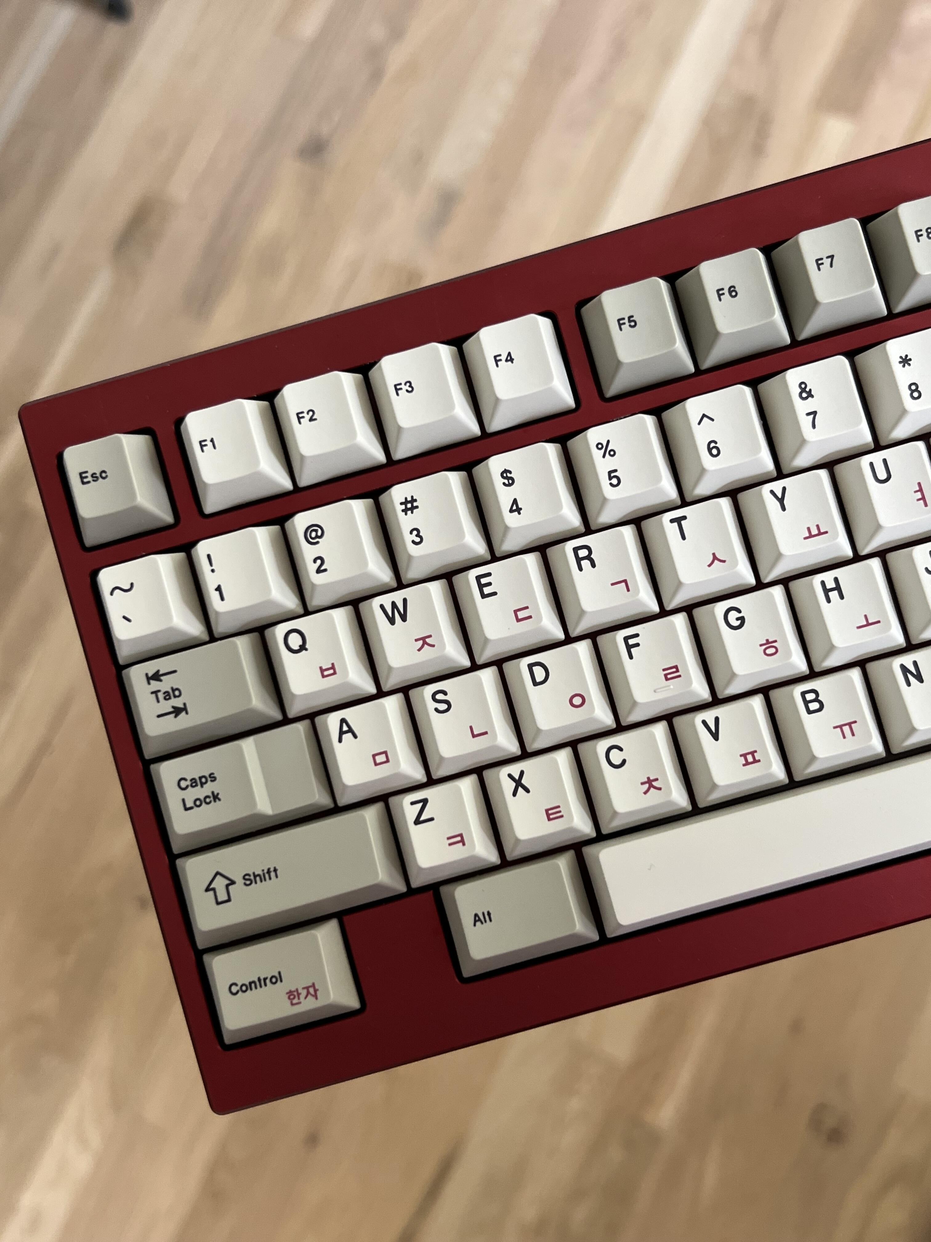

Phew… This was an all day affair. I didn’t expect my Deskeys stuff to arrive so quickly. I wasn’t planning on jumping into a new build the day after the last one, but I was excited to see what the mod would feel like.
The housing is a stone washed titanium Norbaforce.
I modded my Realforce 87u for MX compatibility with deskey sliders, desky 2u housing assemblies, and space bar sliders.
I used v3 domes in pink and #5 silencing rings. Lubed the sliders and PCB with 205g0, while using NyoGel on the stabilizer wires to keep rattle at bay.
I hadn’t done enough research, apparently, and didn’t know about the funky left control key. My housing got a butchering from my dremel. Ooops. @insolentpotato is gonna hook me up with a new housing. It works… I just can’t really touch it or it goes all crooked.
Also, I’m waiting on a daughter board for this bad boy from @insolentpotato. Currently using it without a back and just running the stock cable out the bottom.
Overall I’m pretty pleased with it! The space bar still has a bit of sound. A small tick that I can’t quite seem to tame. I can definitely live it for now. It’s better than some of my MX boards. The 2u housings are pretty nifty. They also have a very slight amount of noise, but man, it beats having to drill out the housing!
I don’t know that I’ll keep GMK Birch on here, but it was the first set I grabbed that had a compatible space bar. Really looking forward to the walnut riser to stick on the bottom of this setup, too!

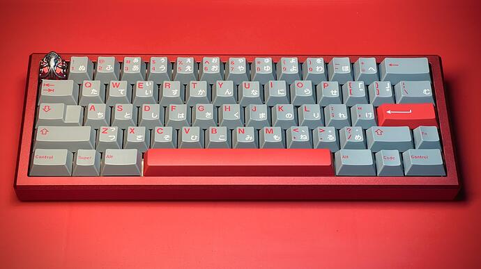

Arc60 with GMK Redline by Omnitype

They all look good but that deep space looks amazing on silver/gray

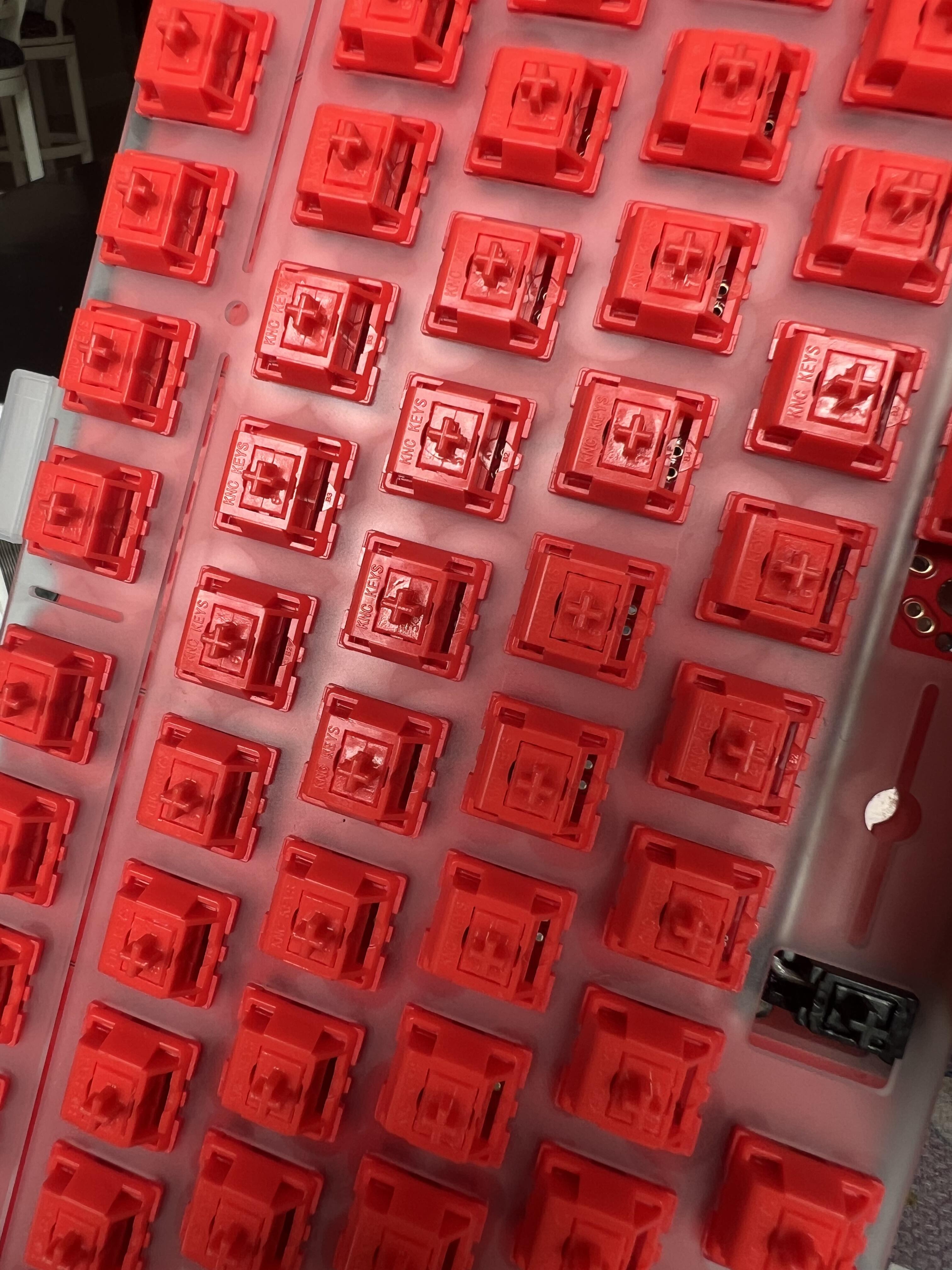

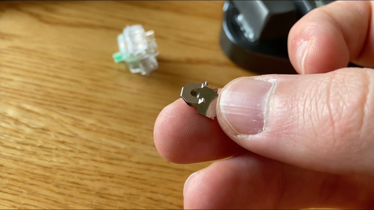

Haimu Whisper silent tactiles: A Nylon-housing switch using Haimu’s silent tactile stem with in-house branding. The good: reasonably quiet, enjoyable bump and bottom-out feel. The middling: modest but extant tick sound on top-out, typical of all Haimu silents. They could use films. The bad: some of the worst pins I’ve ever seen on a switch.
I’m hoping it’s just a weird bad batch or something; the leaf pin is not only very weak, but its two layers are not held together by anything. In my 4-ish years messing around with hotswap boards I’ve bent a handful of pins; 3-4 on a single board if I’m really struggling that day - but with these? More than half of the keyboard was non-responsive. When I checked the switches, all of those had the leaf pin not just bent, but separated into two pieces. Sometimes bent together, sometimes split right apart. I was able to bend them all back to a (mostly) usable state to start testing, but at this point I was getting missed inputs and chatter on a few of them, which I do assume is related to the chewed-up pins. On one switch, one of the two layers broke off, leaving a thinner but ostensibly functional pin.
I wondered if maybe I was having an extra wonky day with the nerves, but I swapped the switches again maybe half an hour later, and all of those worked reliably first try - so it’s definitely the switches and not my senses.
I’ll be posting some photos and stuff at some point - worst experience I’ve had with pins by a mile. Even the dainty ones on old Outemu switches are preferable as far as I’m concerned. Also for what its worth - I haven’t had this happen with other Haimu switches so far - and while I have seen a de-layered pin before, almost never more than one in a session. Mildly horrified

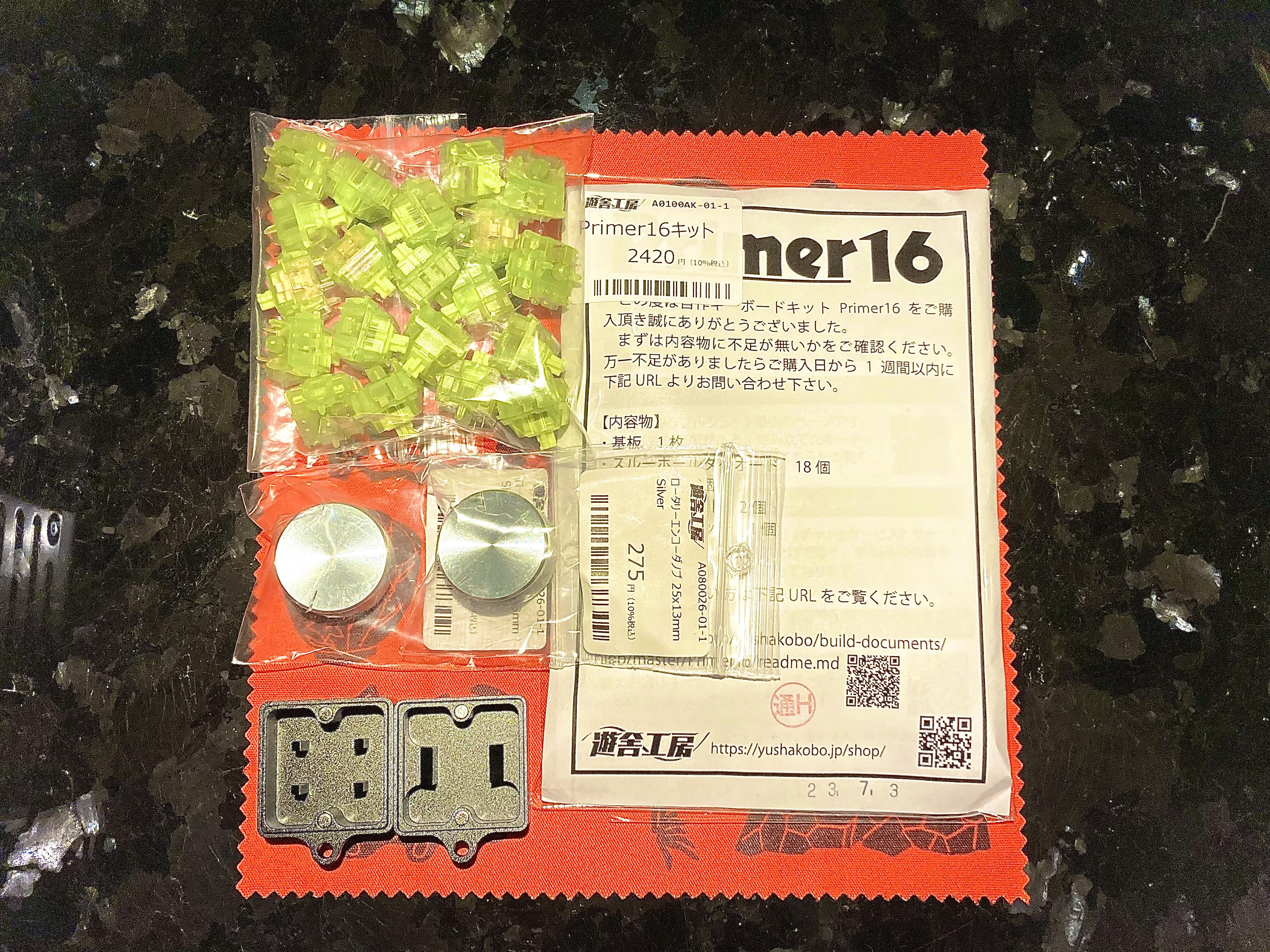

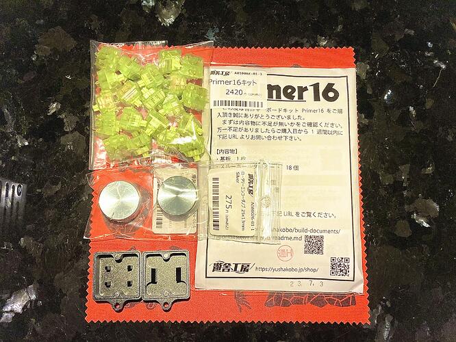

Recently picked up a double-knob macro pad from this specialty shop in japan. It’s called Yusha Kobo and I believe they have an online store.
Really excited for this thing and not sure what I’m gonna do with the second knob (first will be volume), but so far I’m leaning towards fast forward/rewinding youtube videos. Any ideas?
I thought there was some thread on here about uses for rotary encoders, but it’s possible I saw it as a reddit post at some point. I have mine set to volume control/mute, but have a function layer on it to adjust the RGB lighting brightness or turn it on/off with a function + click. A few other ideas and code samples.

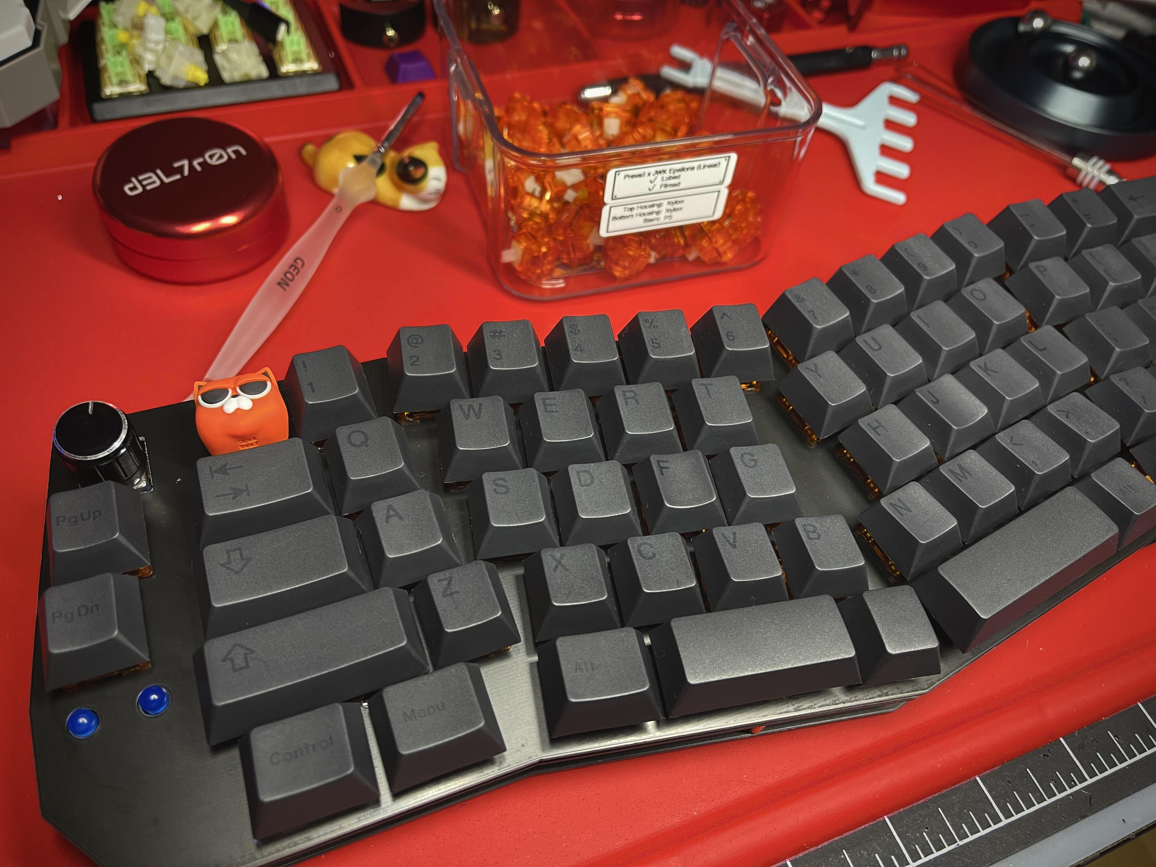

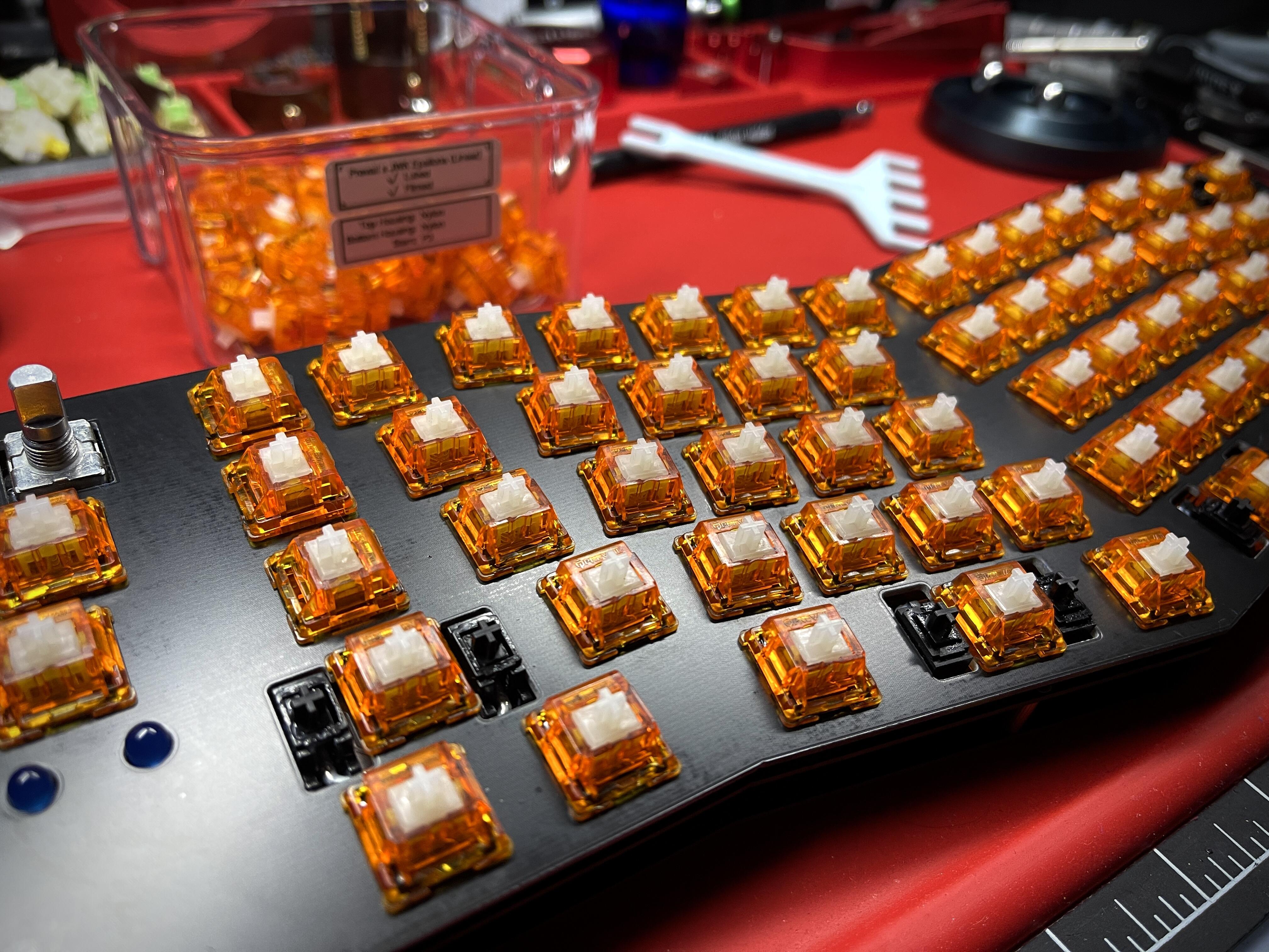

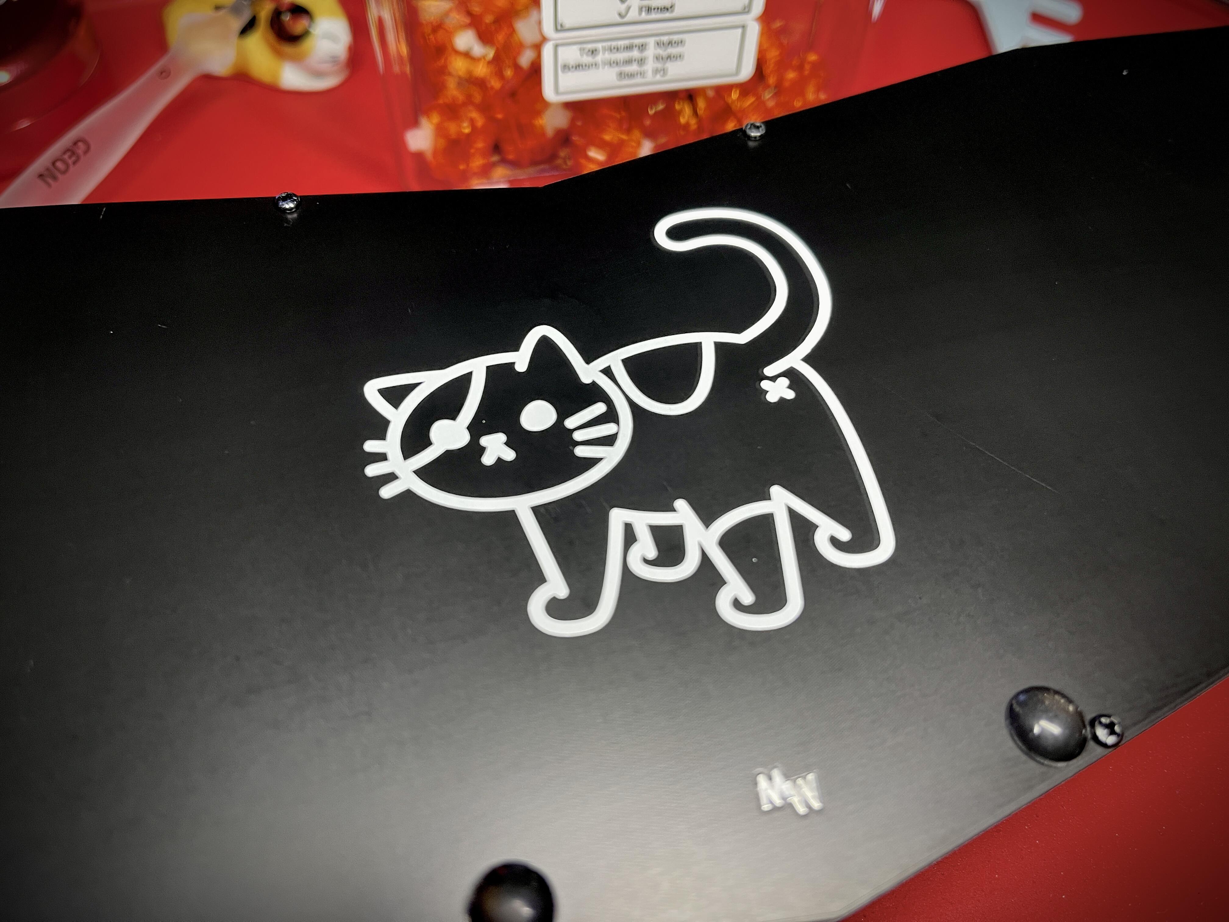

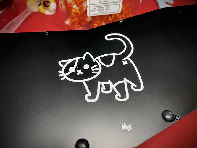

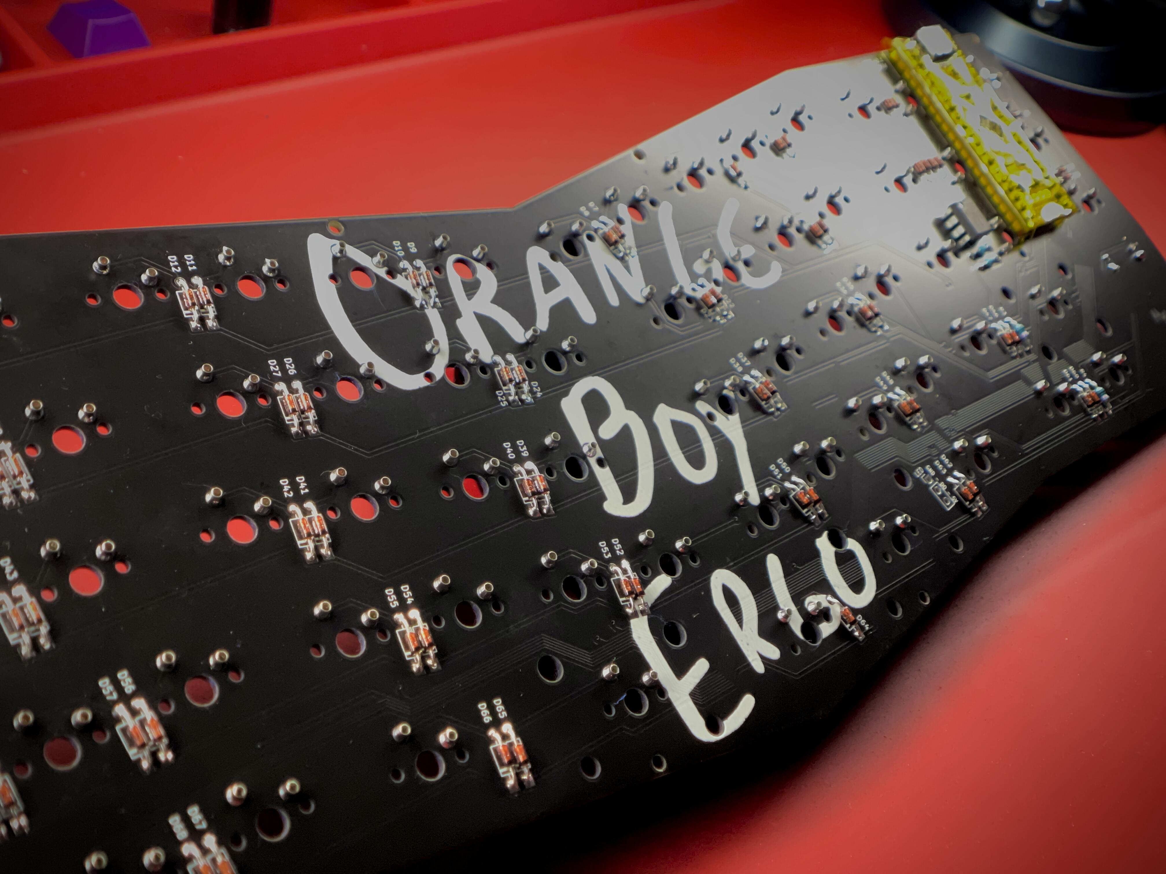

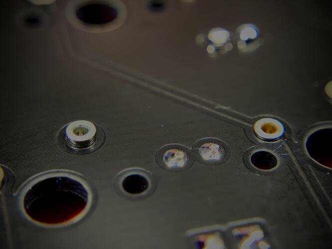

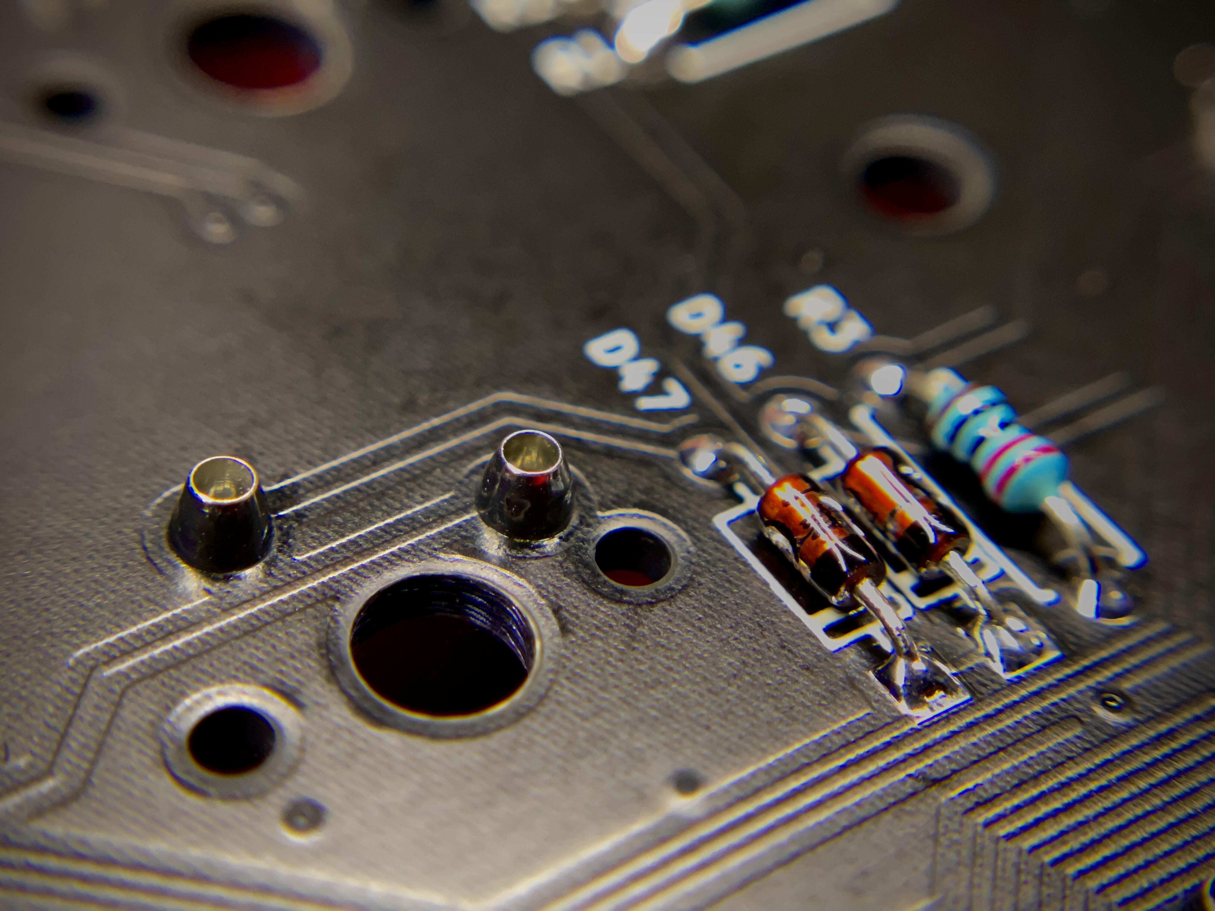

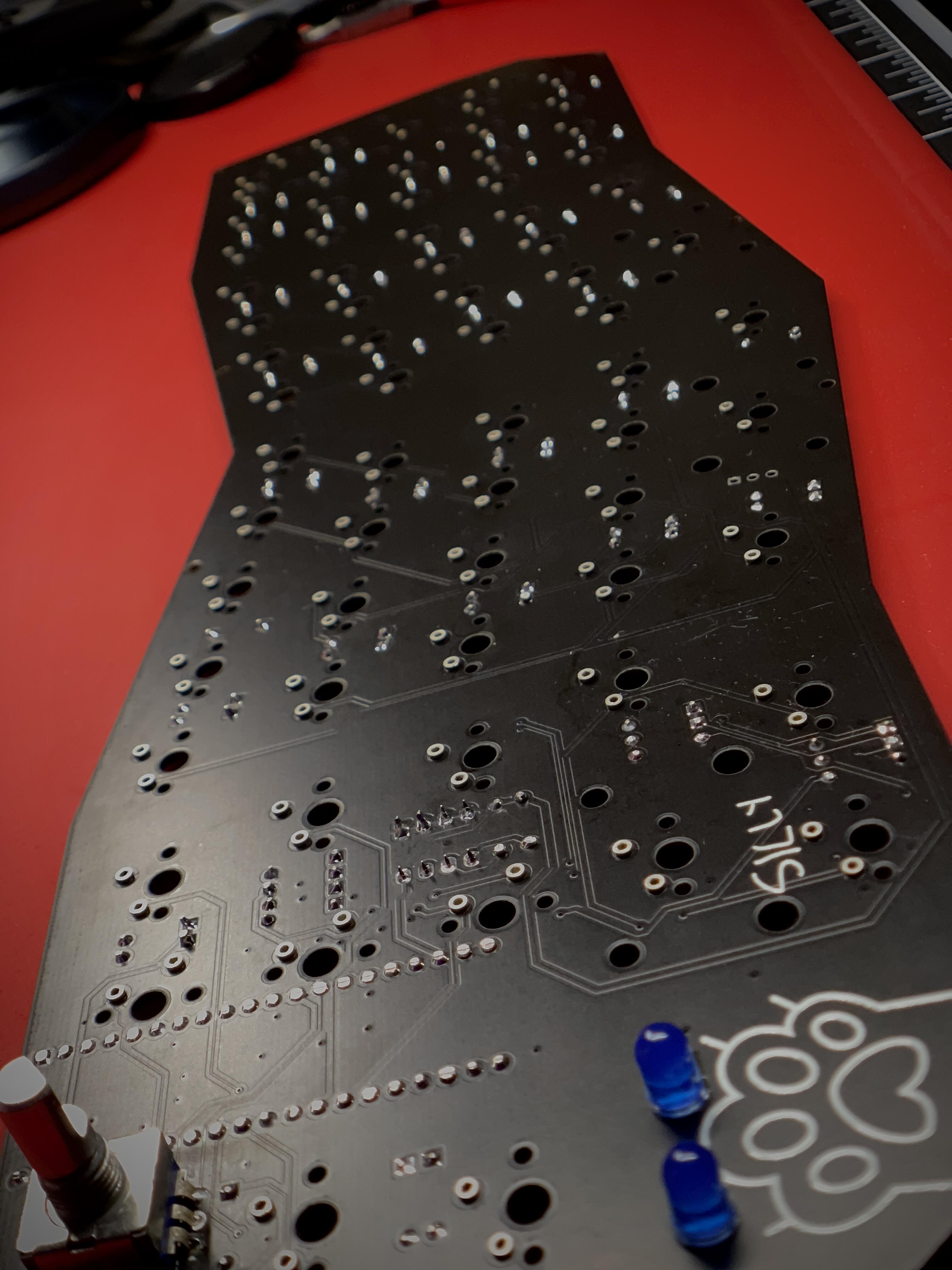

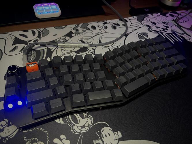

Got some more soldering practice in! Built a friend’s Orange Boy Ergo by MechWild.

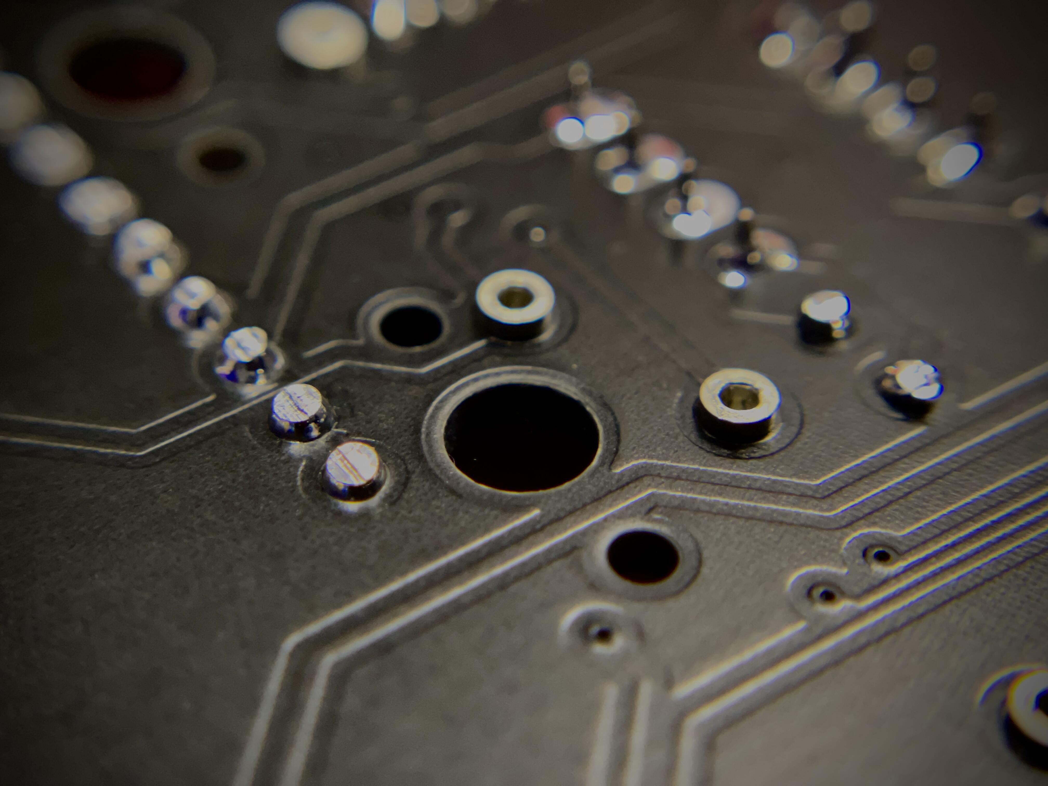

Not only soldering in all of the diodes, resistors, and LEDs, they also trusted me enough to Millmax the board as well.
Everything turned out really well, IMHO, and I can now say I am quite comfortable with Millmax sockets ![]()
Specs
- Aluminum Plate and base
- Blue status LEDs
- Cherry stabilizers (2U x 5; GS2 housing, GS3 wire)
- O.G. Prevail Epsilons (L&F’d)
- Aluminum feet
- Mystery dye-sub PBT keycap set (it was the only one I was sure I had all of the caps for)

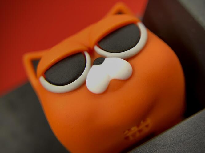

- Orange Zuno Cat from Zuno Studio
