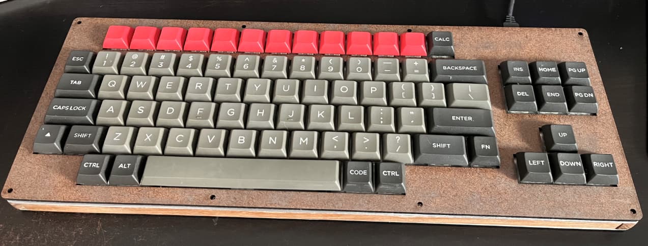

I was also playing with the laser today. Cut a top-plate out of 1/8" hardboard (aka Masonite). Mostly just checking the laser after tightening the belts, as I kind of like the existing look, but I did do a test fit.
Update:

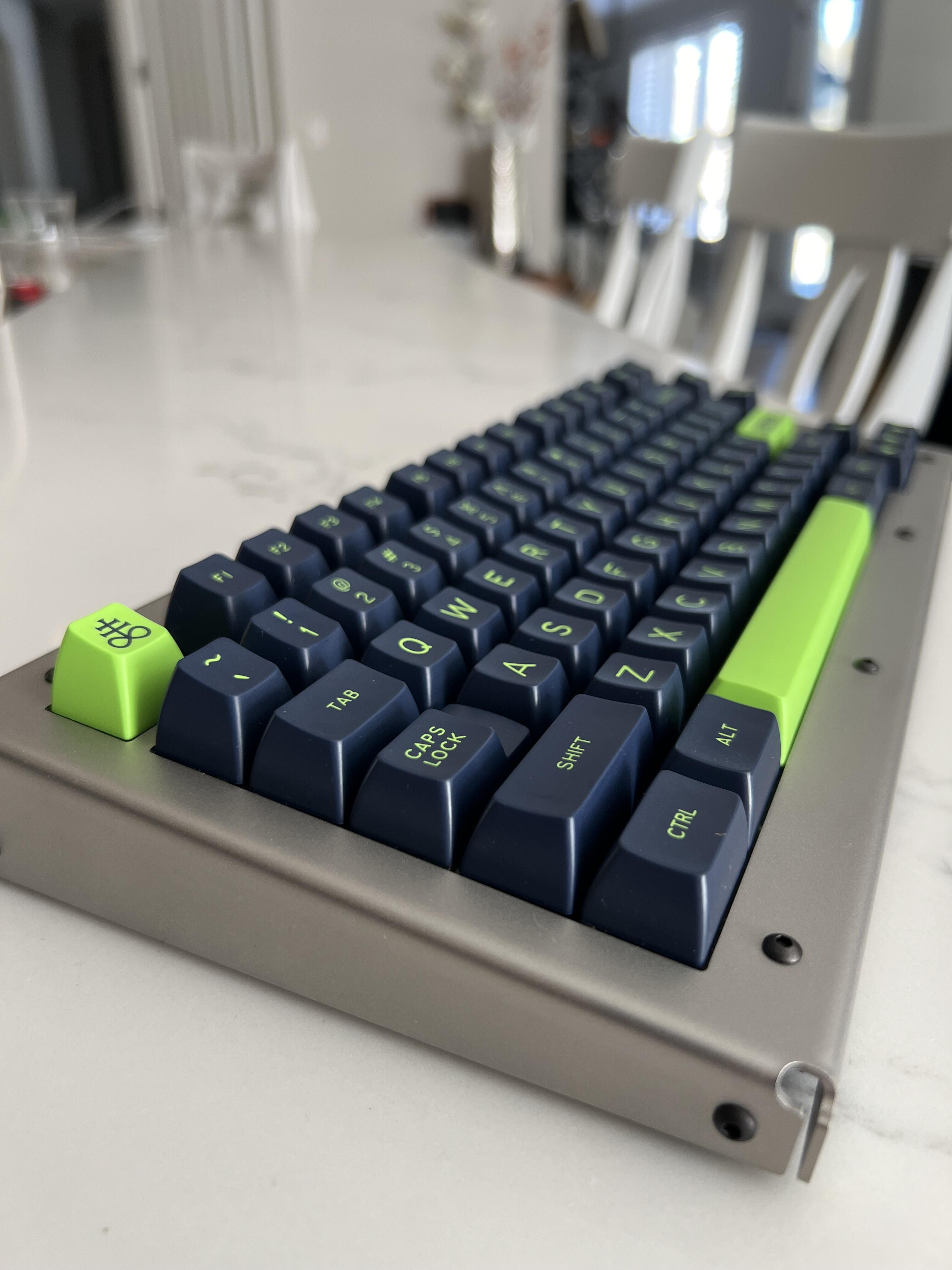

Got one of the birchwood plates installed into one of my Porticos, the currently-available 68 Black Label
More photos, notes, material caveats
It fits! Yay.
It also works, and is even pretty easy to install - I do recommend a plate fork if you aren’t using foam or something else below it, though.

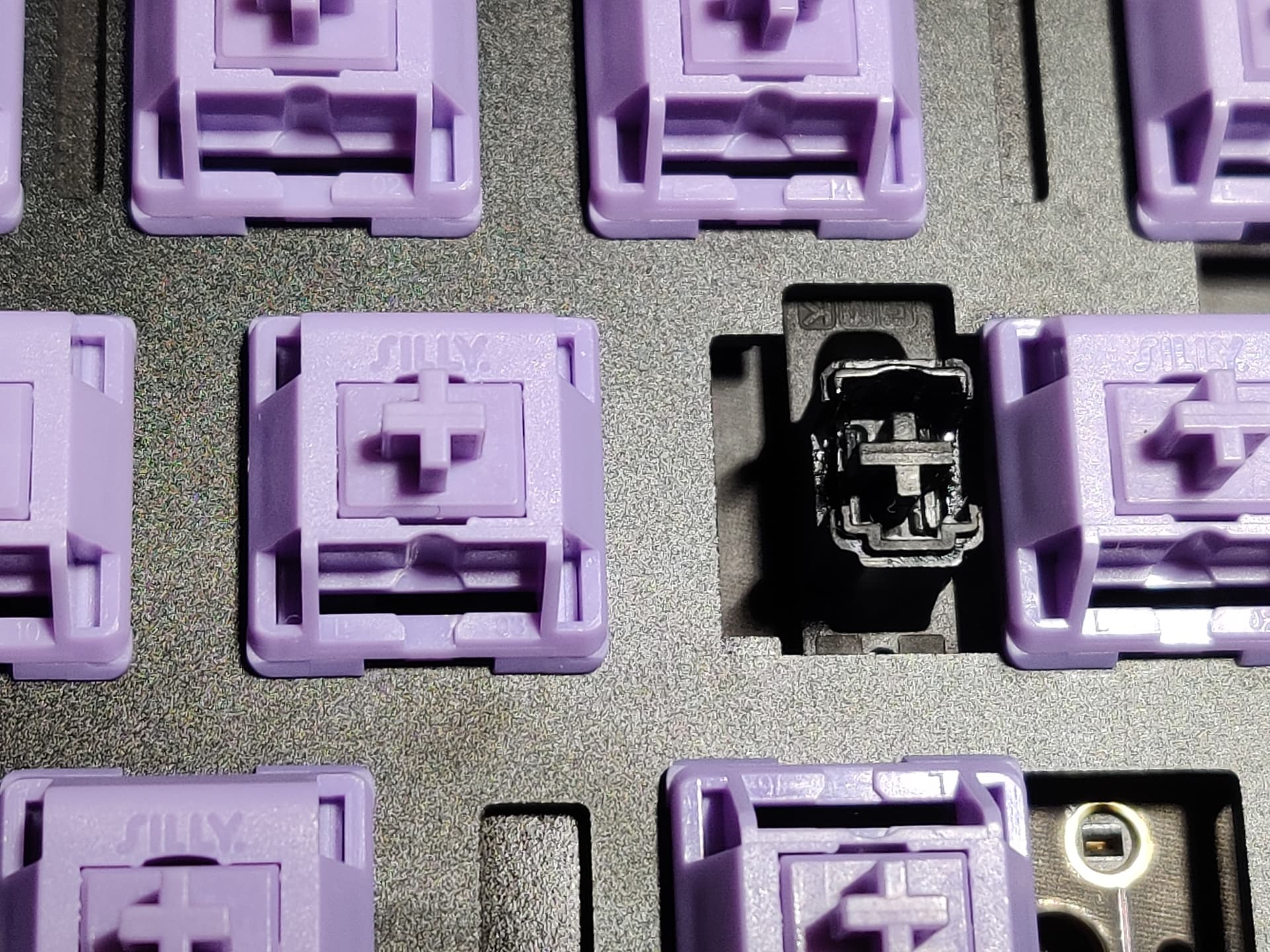

Installing the switches carefully with the fork went well, with only a little de-lamination here and there, caused by the clip teeth. This went much better than the intentional torture test I did earlier, hastily installing tons of different switches in one of these:
It’s actually quite easy to separate the layers accidentally:
But, some switches do seem to get along better with the 1/16" plywood than others:

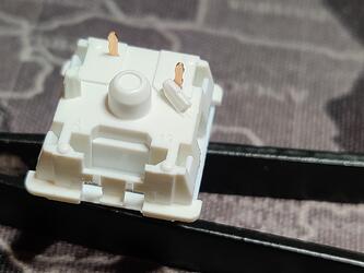

Those clips on the Kailh Box, for example, appear to function just as intended. That gave me some hope after how roughed-up that first plate was by the end of the torture test, and it did work after all. Using the fork went a long way in preserving the layer adhesion and integrity of the fibers.

Considering this was some of the cheapest 1/16" wood I could get without looking very hard, I find this result pretty encouraging.
I’ll keep using this one for a while and see how it goes, and I also intend to continue experimenting with other materials.
Pretty cool stuff, the wood plate sounds pretty damn good too! I wonder if maybe smearing a little wood glue on the outer edges (maybe even in the switch cutouts too) would help to keep it from delaminating when installing switches?

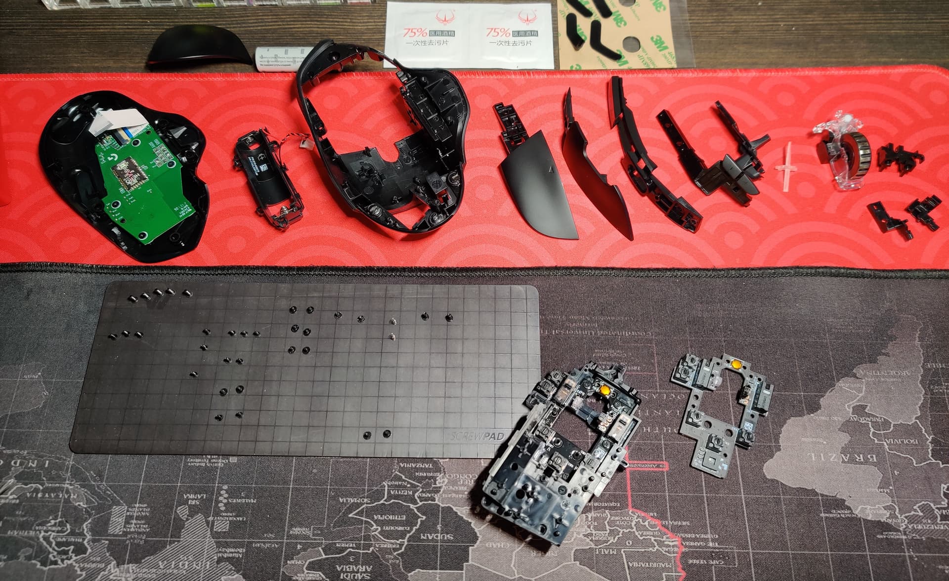

New and old mouse. I took the old mouse, took it apart and pulled out the board. To desolder the mic on the old one and solder the new mics Kail8.0.
And then if everything is ok.
Change only the circuit board in the new mouse that is on the table.
It turned out fine. I spent a long time cleaning it to get the Omron out. But soldering is very quick.

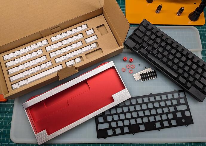

Built my second HMKB today since I have a 3rd on the way. ![]()

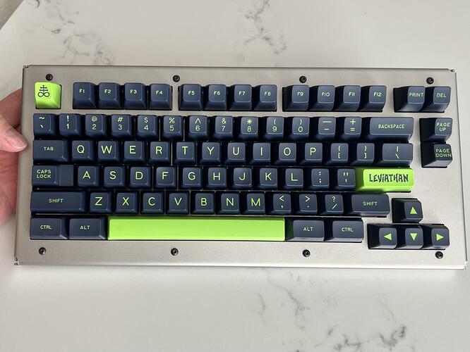

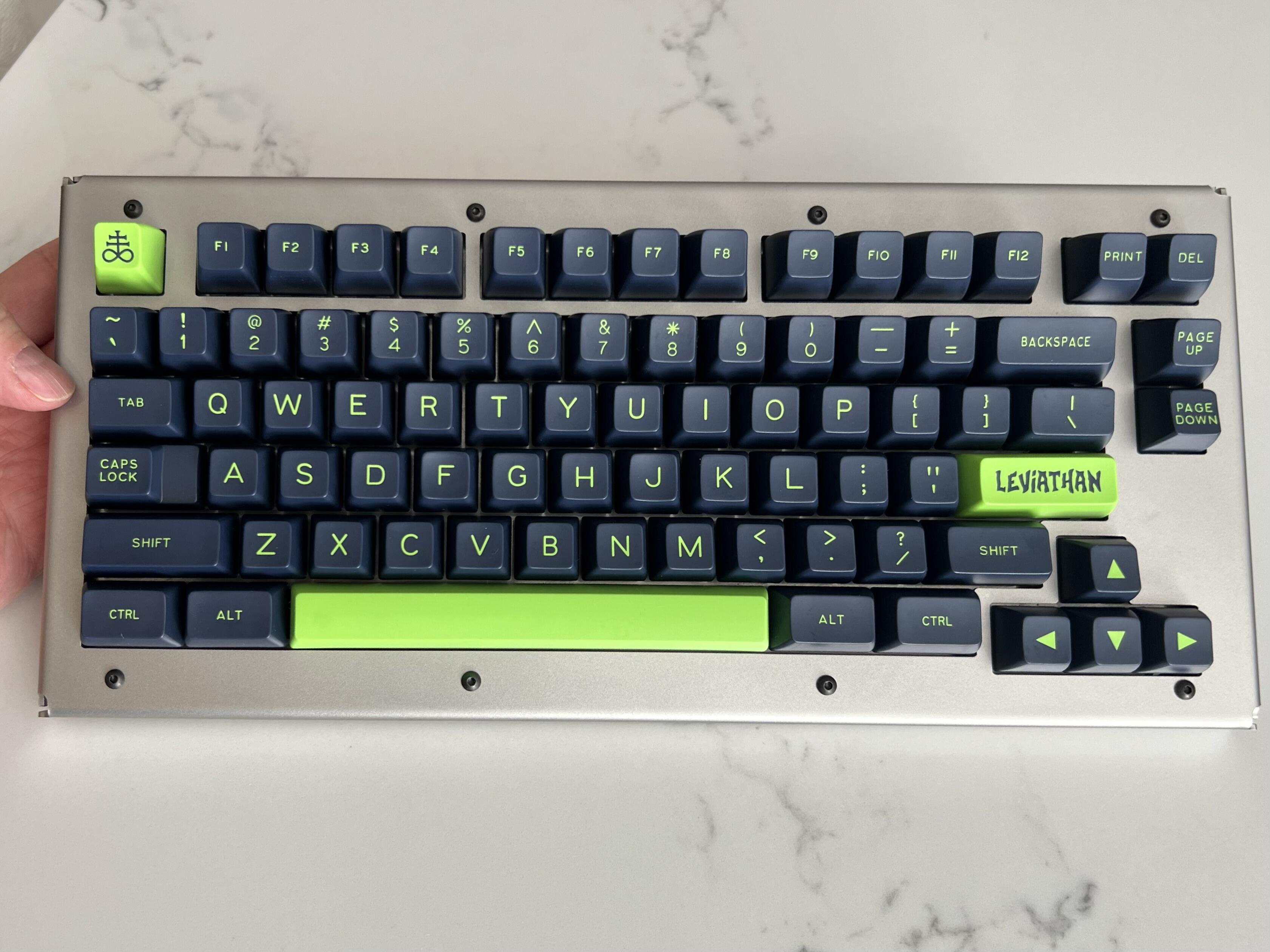

Having a little fun with SA Leviathan. It’s okay to not have super serious keycaps. Right?

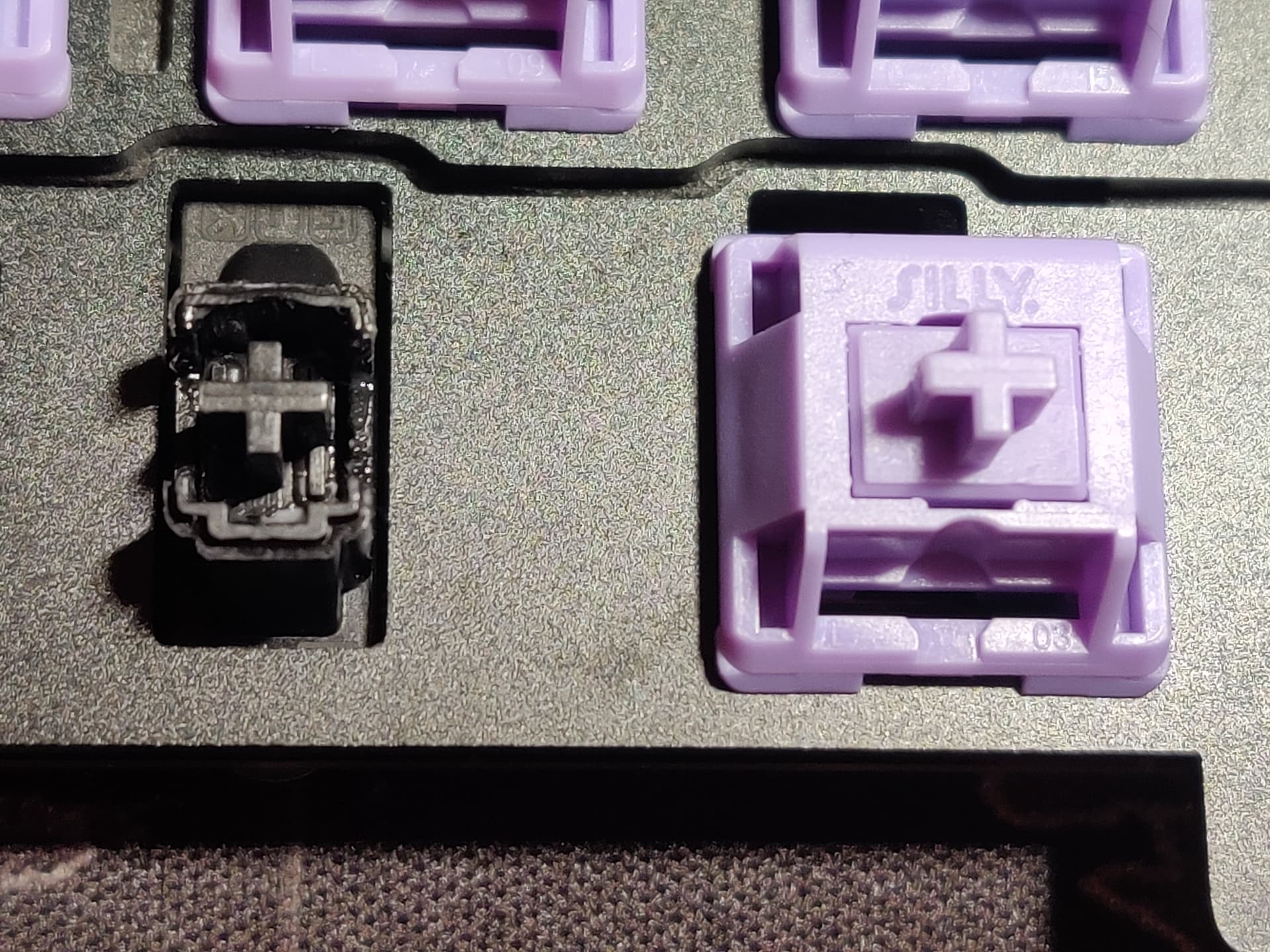

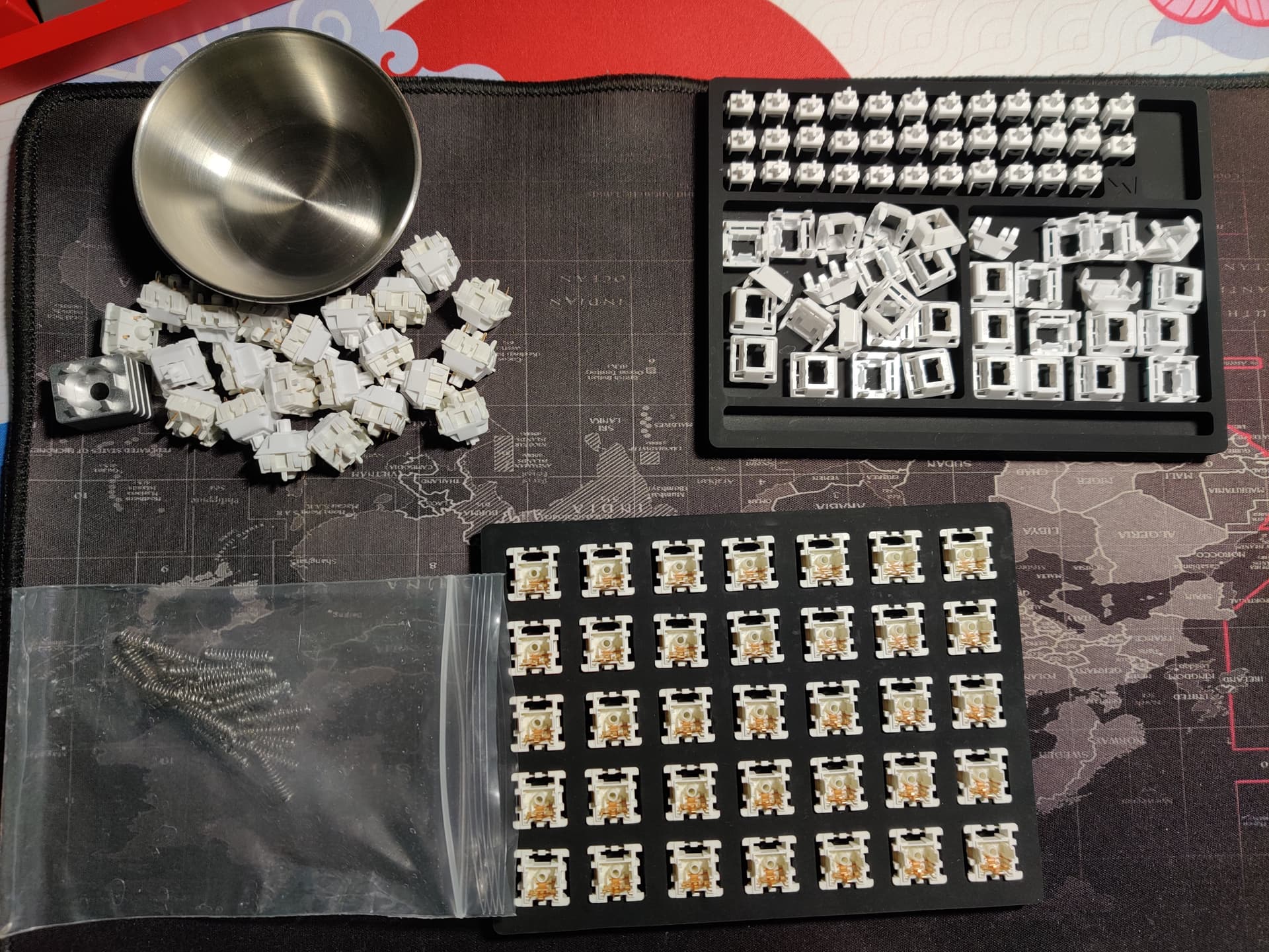

Trying to figure out how to tune Gateron Slay switches. My best recommendation… donut dip spring, 3204 on all surfaces of the stem, 205g0 on the top housing, and a film. Yikes. I don’t want to put that much work into a switch in 2023.
They’re simply too noisy (as in, extra noise from top housing and stem rattle) and high pitched to use stock.
The lubed and filmed result is nice. It’s like a KS-3 but with more clack. KS-3 usually sound pretty good if carefully lubed, but they tend to sound dead in a lot of builds. The longer pole on these fixes that issue. But it’s gonna be a lot of labor. Not sure it’s worth the time and energy.

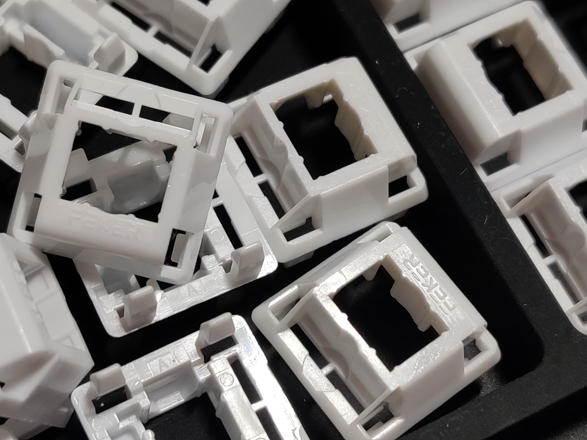

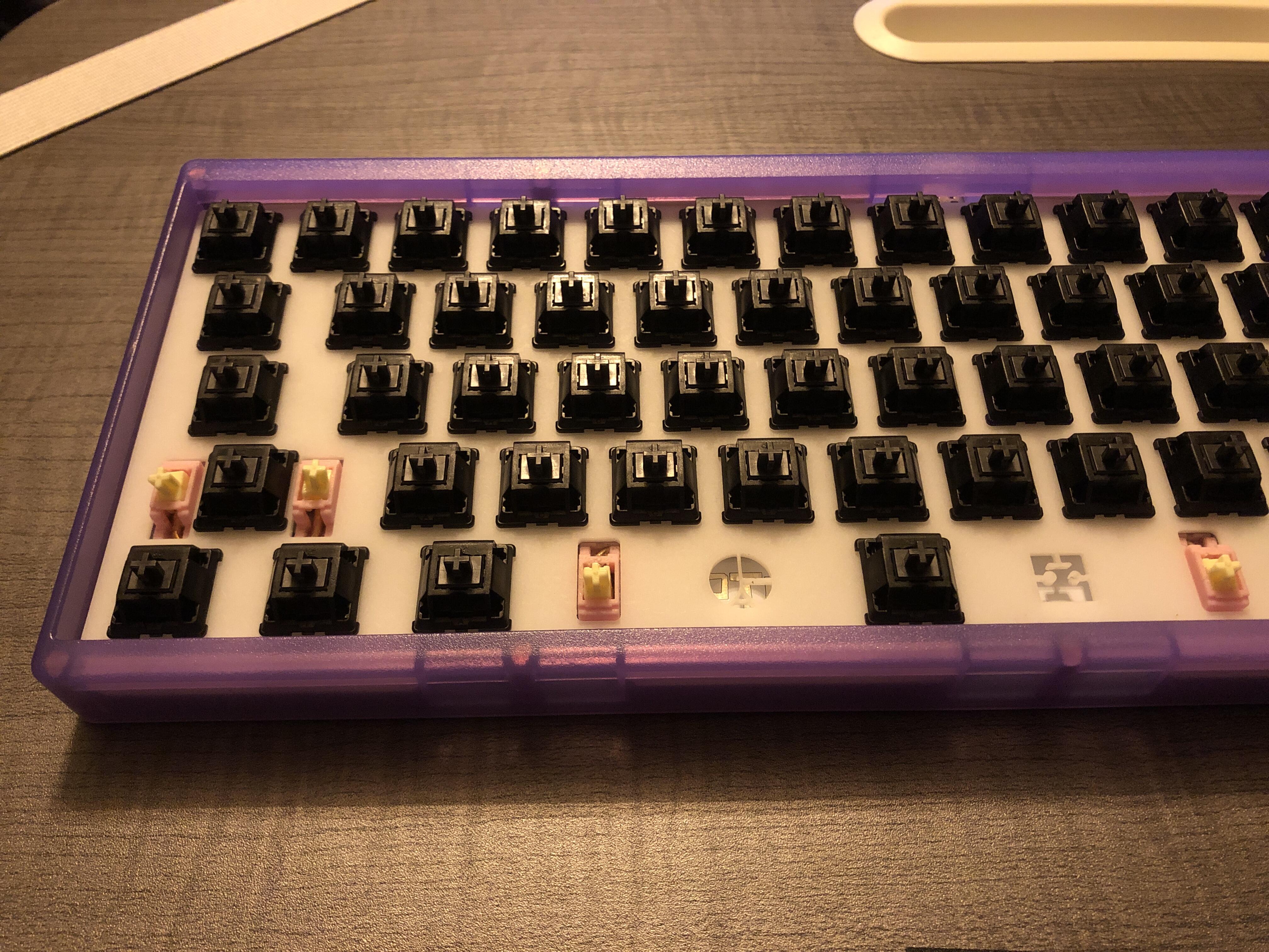

I put a “Fecker” on the Tofu2.0 keyboard, re-lubricated by hand. During lubrication, I found several pieces, even many pieces, where the legs of the bodice were severely bent. And I even found a broken leg on the 5th plastic pin.
And on Cycle7 I installed stock default Hyacinth V2U.

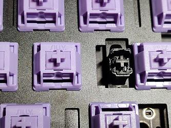

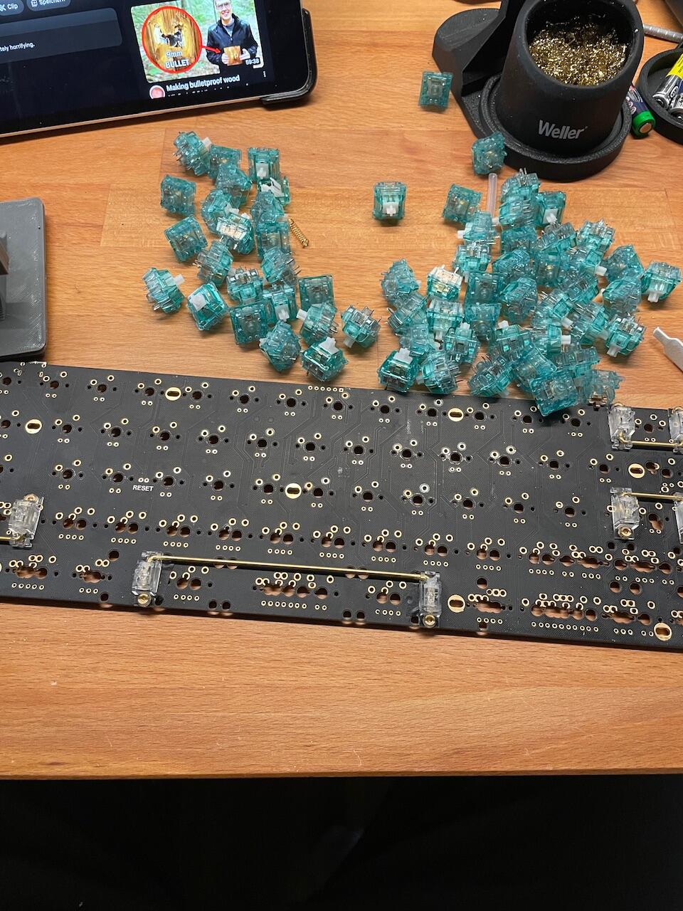

Today I desoldered the orange Alps from one of my m0116 boards. Everything went smoother than expected. I guess my prep work paid off. I started with a good cleaning of 99% Isopropyl and added flux to each joint with a flux pen. Didn’t even have problems with the bent over switch legs.

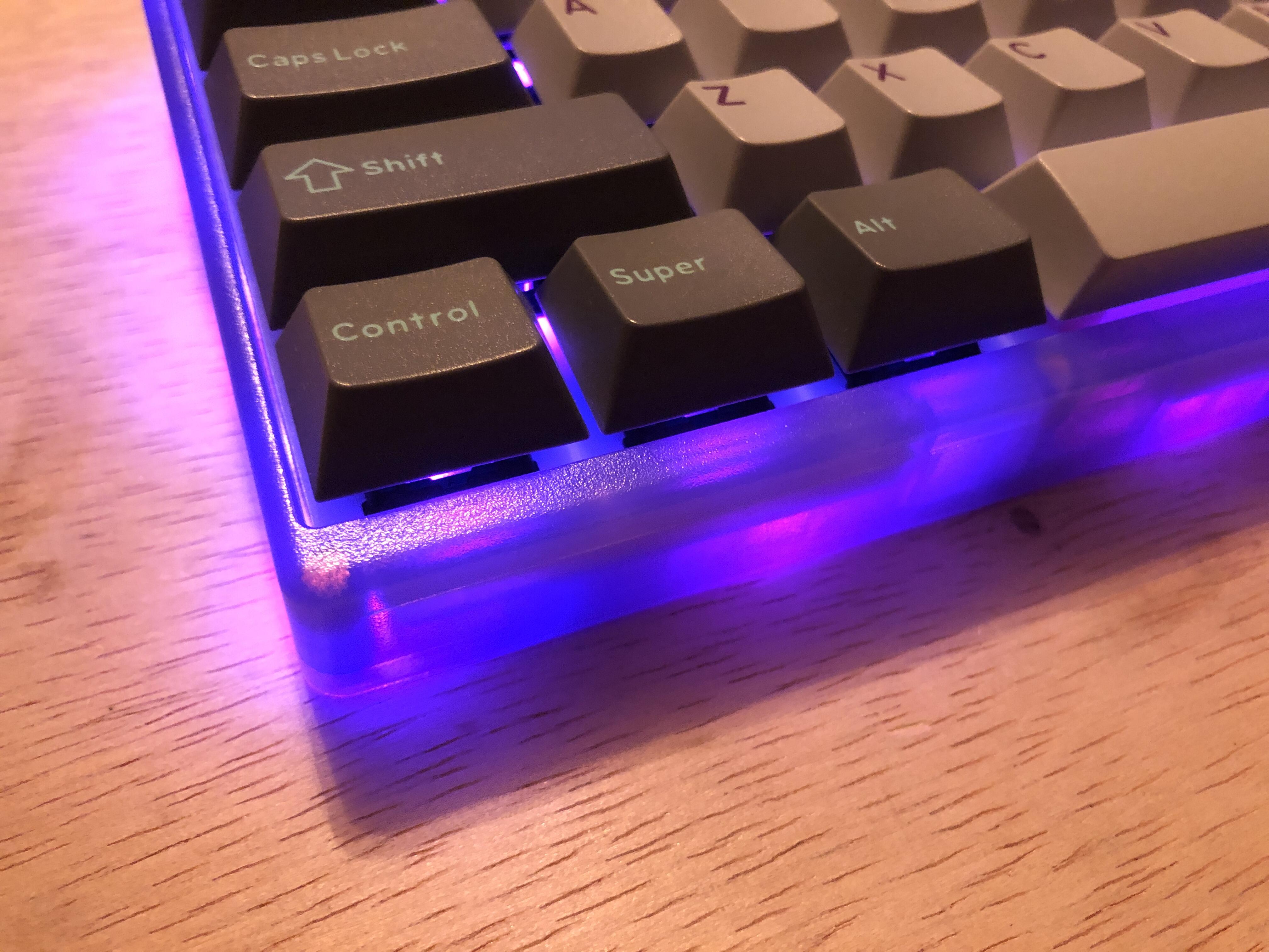

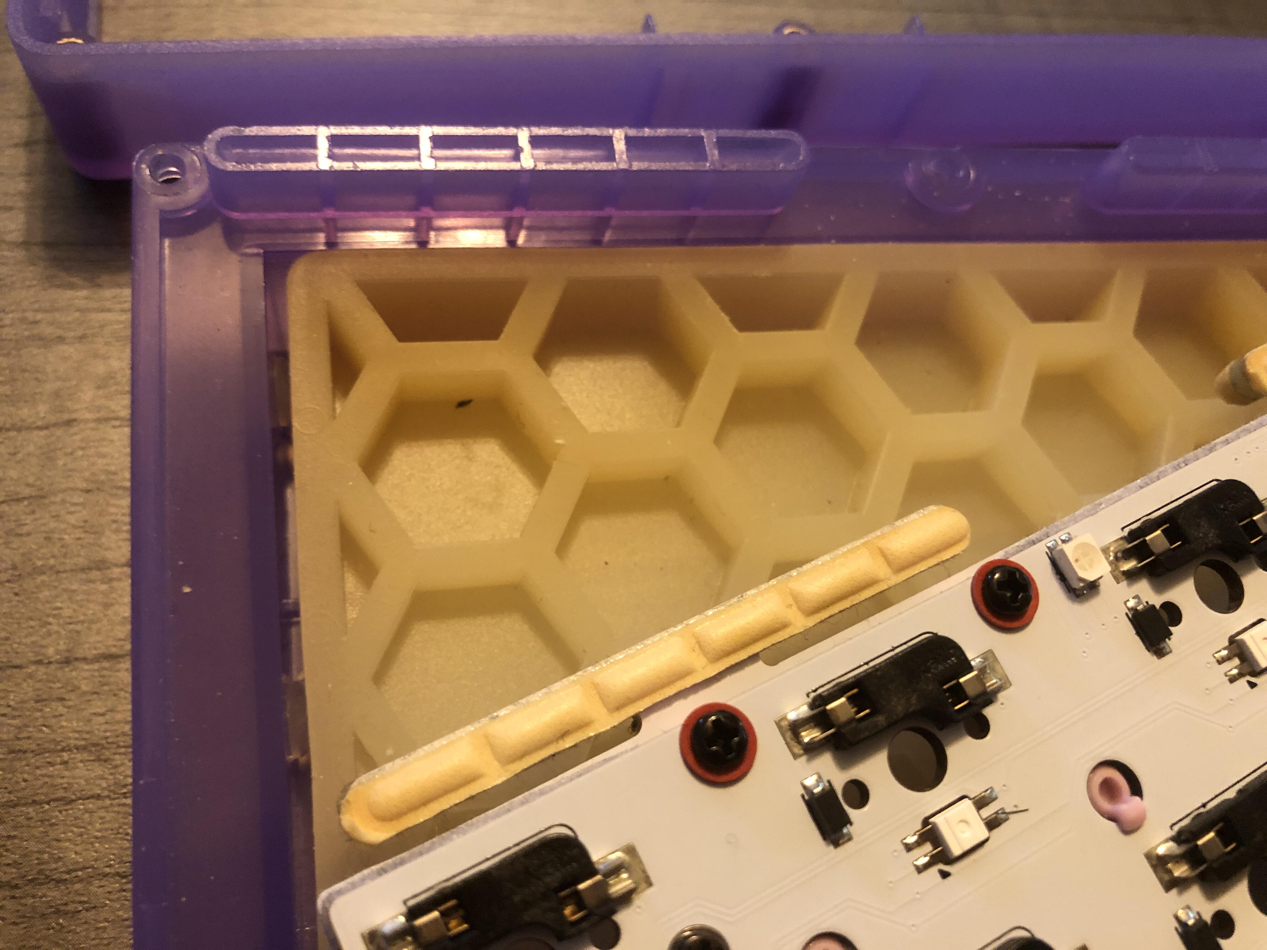

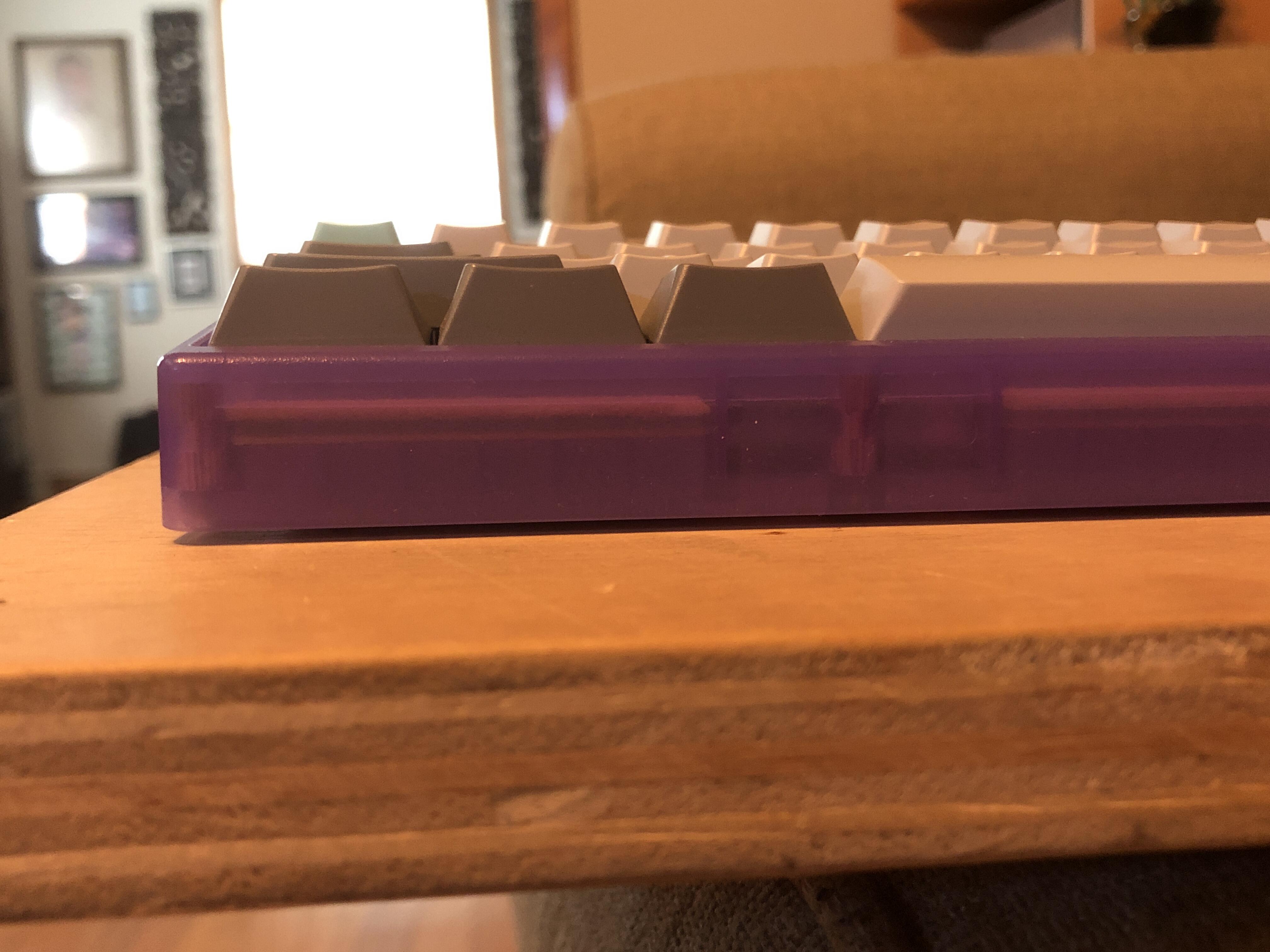

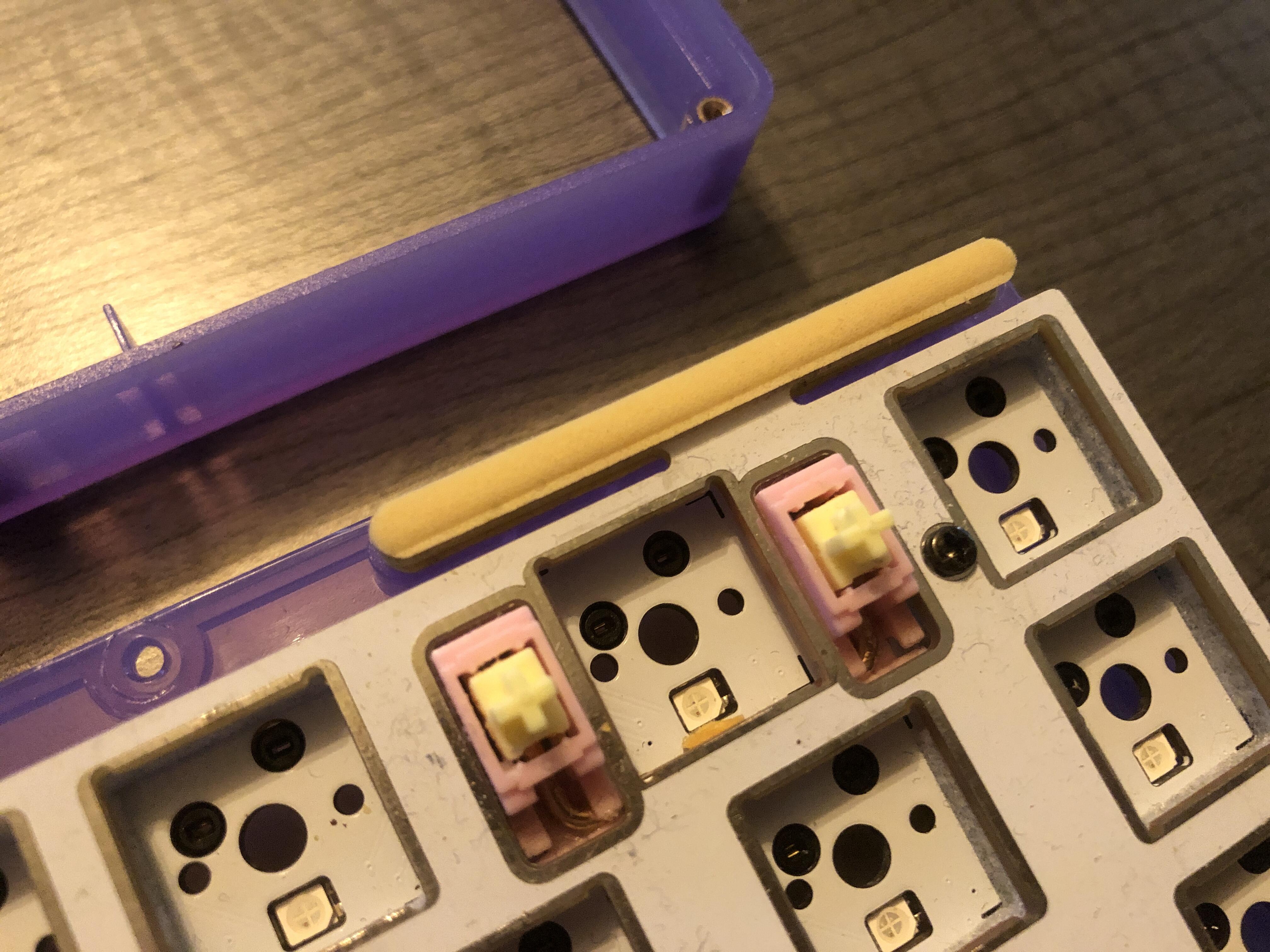

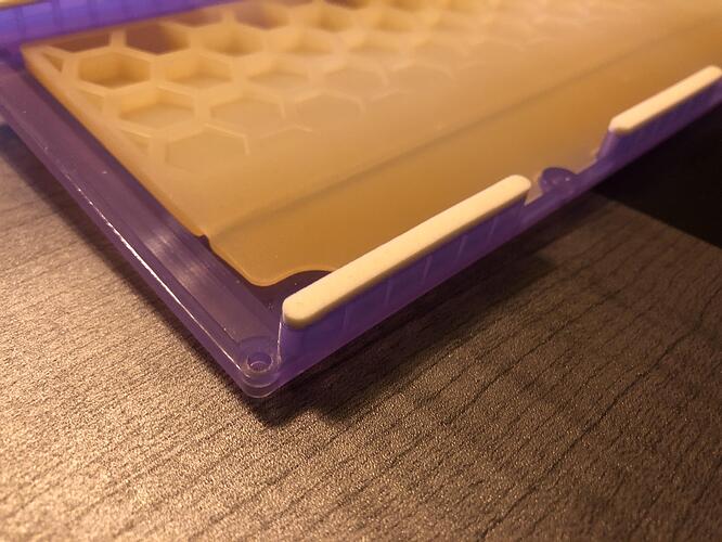

Gave the purple plastic Portico a long overdue refresh today, in the form of a (relatively) new POM plate and pads.
Those are QK01 switches if you’re curious - I was, so I’m trying them out.
More
The impetus:
eewwww
Not only are these original pads toast, the plate they’re stuck to doesn’t keep switches clipped-in as well as it used to.

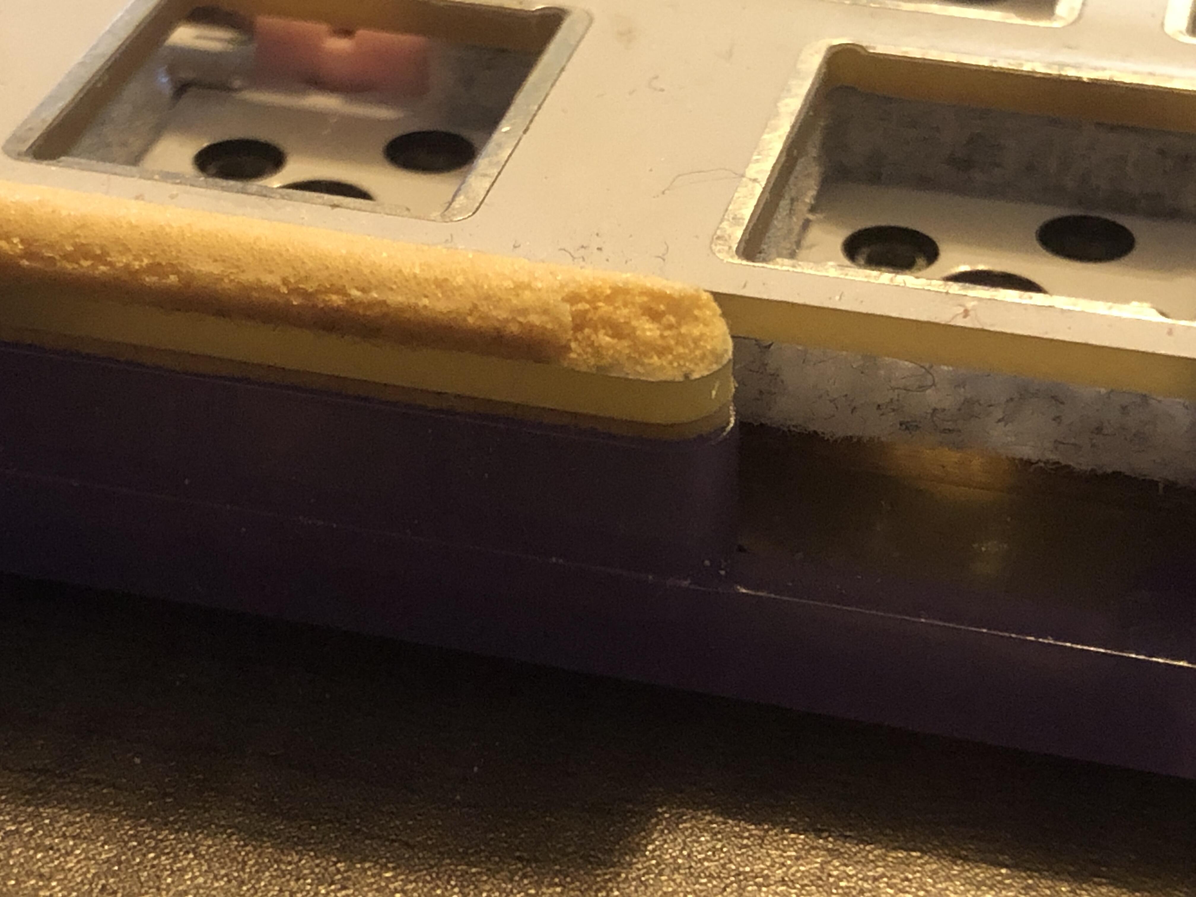

That actually looks kind of neat… but isn’t productive; the pads have hardened into their compressed shape
Also it’s not supposed to look like bread… these were nearly white to begin with. Same goes for that silicone weight - still does its job, though.

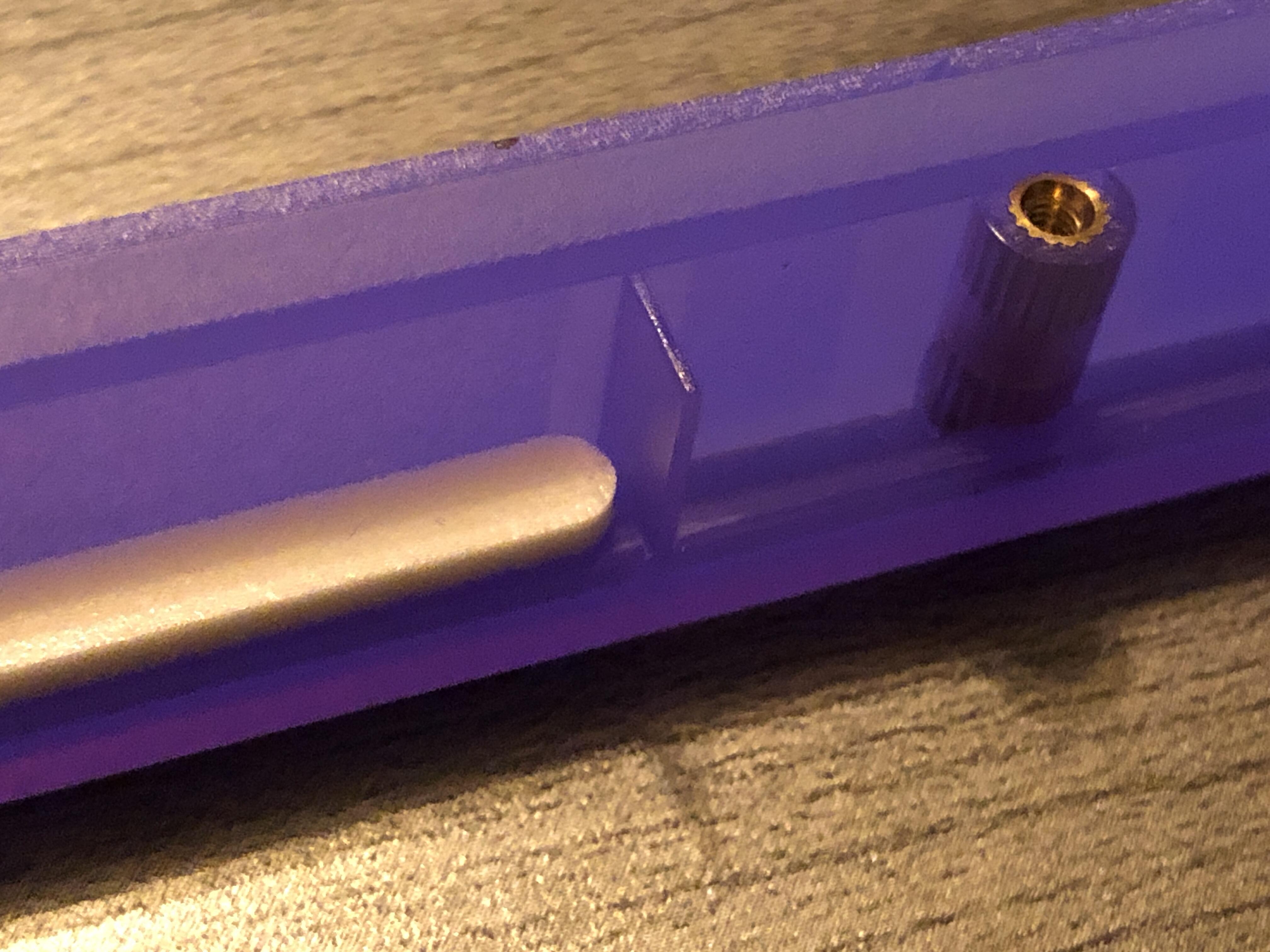

Equivalent business here, looks less neat - but you can see the small contact area from the top case (changed in the metal version: top and bottom both have flat contact on both sides of the pads)
Not as obvious from the outside, but most of these pads are crumbly crunchy things.
Time for some fresh(er) ones! They’re just as old, but unused, and exposed to far less sunlight:
I don’t think putting the pads on the case was intended for this version since there aren’t really full surfaces for it on the top half, but it still seems to work with careful application
The bottom was much easier
Successfully sandwiched!
RGB isn’t in the cool kids club
but you can’t tell me this atomic purple keeb doesn’t look rad ![]()

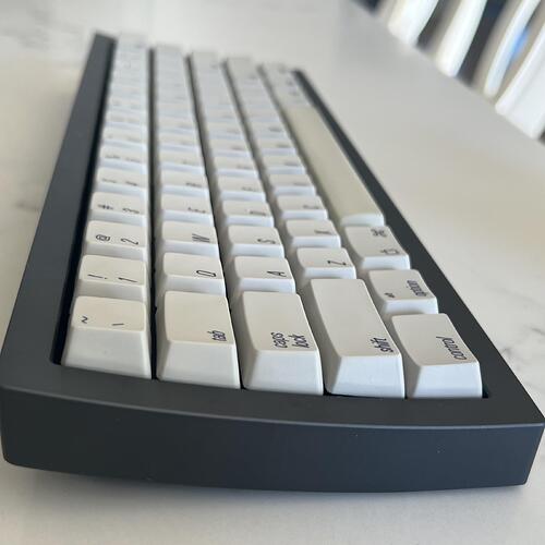

Got my Lunar II finished today. The solenoids are a bit over the top, so say the least. ![]()

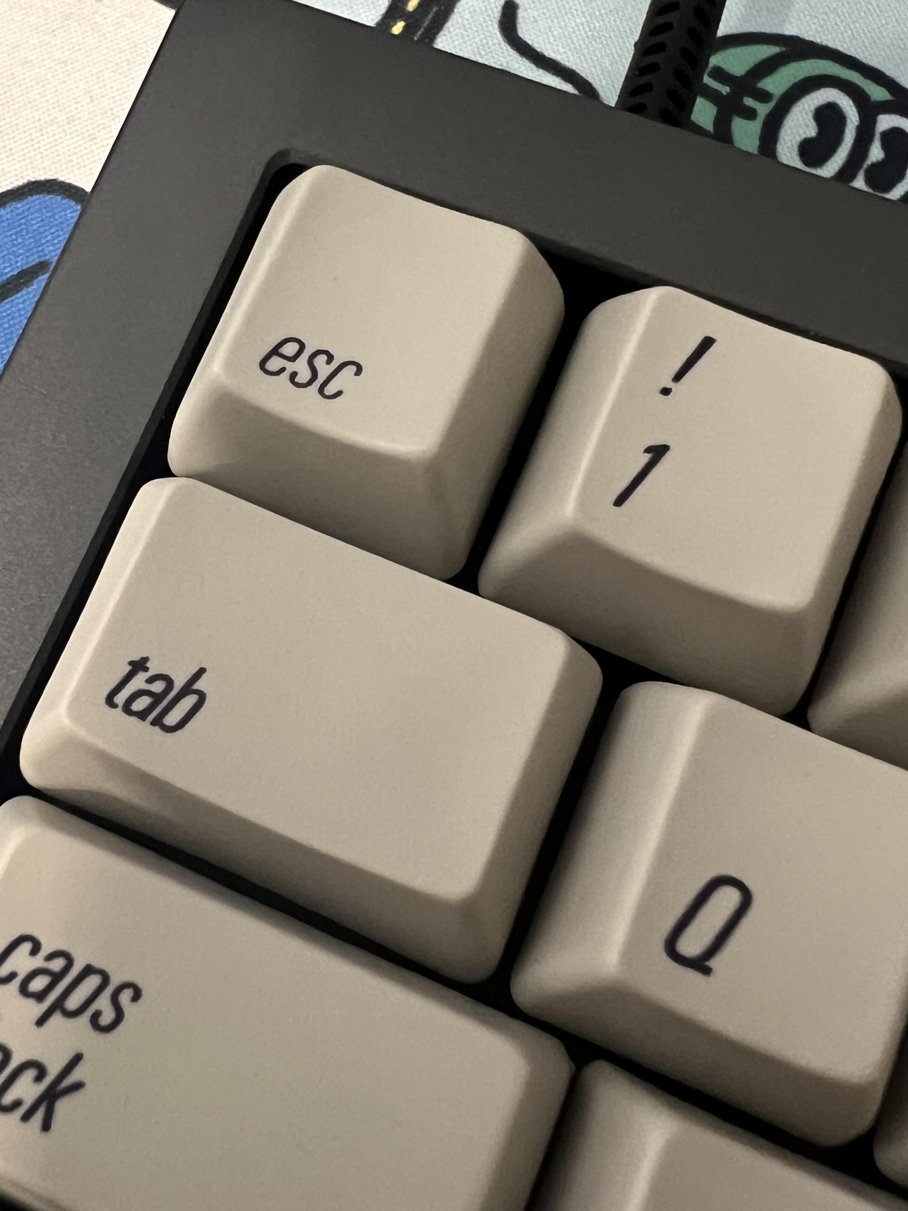

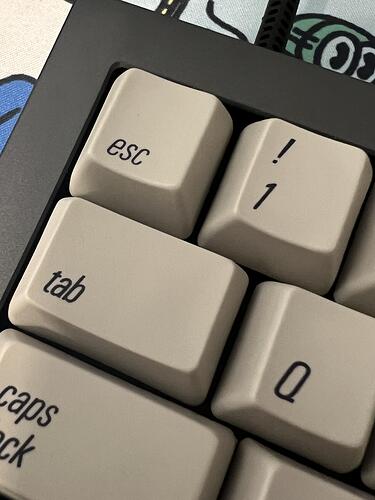

Oh snap. I just realize I can use the esc key from my m0116 instead of the tilde. Nice.
