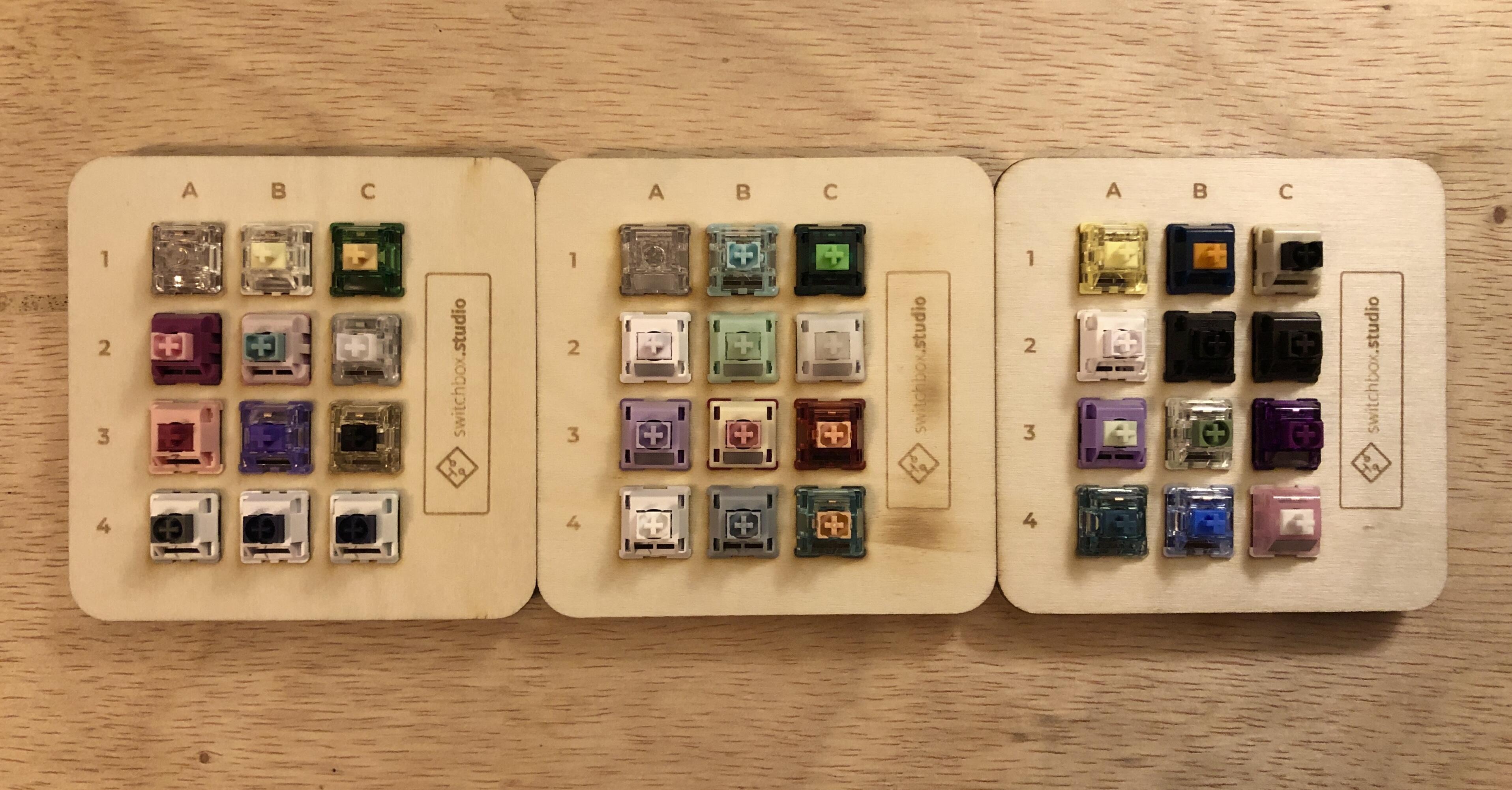

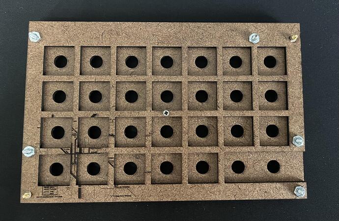

Some curated switch testers for a friend:
Another still-too-yellow photo of some more prototype testers; I’m giving these out to friends, but once I have the laser settings dialed-in and some more ideal feet picked out, I intend to make them more broadly available.
Left:
  • A1: Gateron North Pole 2.0 (with the yellow pad)
  • B1: Gateron Jupiter Banana
  • C1: Gateron Beer
  • A2: Invokeys x Alas Nightshade (Wikuo/LICHICX)
  • B2: Invokeys x Alas Daydreamer (Wikuo/LICHICX)
  • C2: Geon x LICHICX Raw Tactile Small Bump
  • A3: Sarokeys Strawberry Wine (BSUN)
  • B3: CIY Asura (BSUN)
  • C3: NuPhy Fleeting Gold (BSUN)
  • A4: Invokeys Black Sesame Lubed (Aflion)
  • B4: Aflion Thunder Shadow
  • C4: Invokeys Blueberry Chiffon Unlubed (Aflion)
Middle (all Haimu):
  • A1: Geon HG Clear
  • B1: Sea Salt
  • C1: KK Light Wave V2
  • A2: WS Morandi
  • B2: WS Jade
  • C2: Geon x Haimu Raw
  • A3: Moyu Studio EMT V2
  • B3: Moyu Studio Betty
  • C3: Heartbeat (CK exclusive)
  • A4: G-Square x Moondrop Lunalight
  • B4: G-Square x Moondrop Tessence
  • C4: Skyloong Iceberg Silent Rose
Right:
  • A1: Akko Cream Yellow (…V3 I think? made by KTT)
  • B1: KTT Carpinteria
  • C1: Dangkeebs Creamery Cookie Dough (KTT)
  • A2: Geon x Huano Raw
  • B2: Gopolar x OUTVA x SWK Yin
  • C2: NovelKeys x Kailh Clickie
  • A3: Sillyworks Hyacinth V2 (HMX… or KTT?)
  • B3: DUHUK Lumia Matcha V2
  • C3: TTC Flaming Purple
  • A4: Divinikey x JWK Bluey
  • B4: Chosfox Voyager (JWK)
  • C4: Durock White Lotus (JWK)

Not a keyboard, but I feel like this jig is what I need it to be in order to laser dye-sub keycap legends. Still fighting with the laser and my workflow just a bit to get really consistent alignment, but “usable” is already in reach. If I can fine tune things a bit, I’ll make one that can handle more than one larger cap at a time.

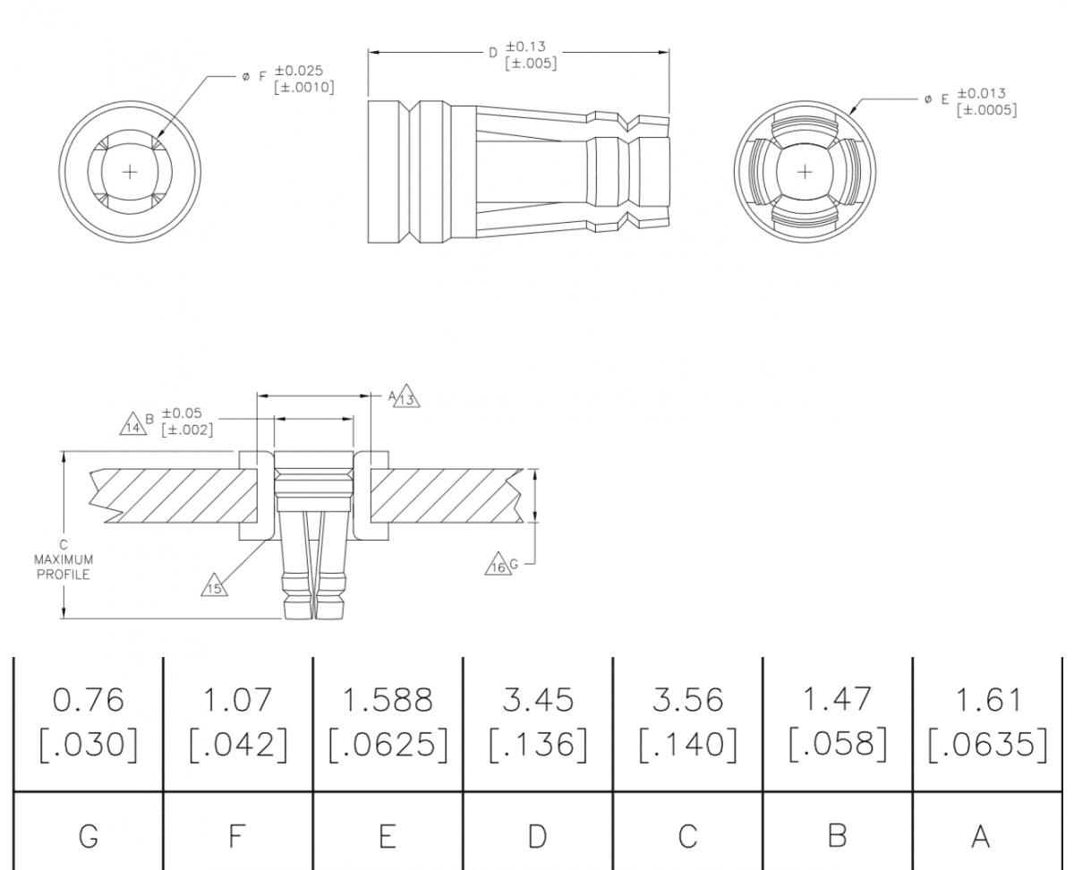

Got my milmax sockets in and found out they wouldn’t work in the pcb they were intended for (too tight :confounded:). Spent a while going through my unbuilt boards until I found a PCB that they would fit in. The winning PCB was the Adelais for my Dodice with some SWK Yang switches in it. Very clacky build. Me likey
Have you tried Holtite sockets? They’re more expensive, a lot harder to find, and even harder to install - but they do sit completely flush, and IIRC their design is a bit more physically flexible. I can send you a few to try if you’d like to test the fit.
I have some in my R1 Unikorn build. I’ve had a few come out when removing switches, but they’re pretty easy to get back in. That might be a good consideration for the original board I had in mind though. I think I have some sitting around.
The Mechlovin pcb is great for mil max. It has nice big pads around the holes for good heat transfer. I did have a few I messed up and had to redo, but that’s par the course for when I milmax :rofl: especially with the shorter sockets. Really easy to get solder over the top and down into the socket. It’s definitely more work than soldering switches in.
Ditto. Had tough time soldering them in as well as out. Also wasted time cleaning up PCB afterward.

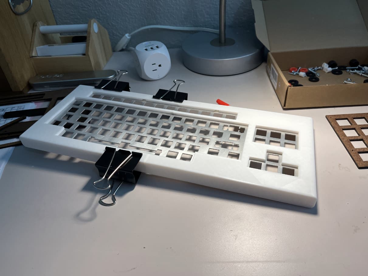

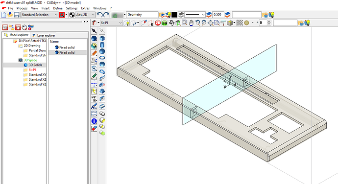

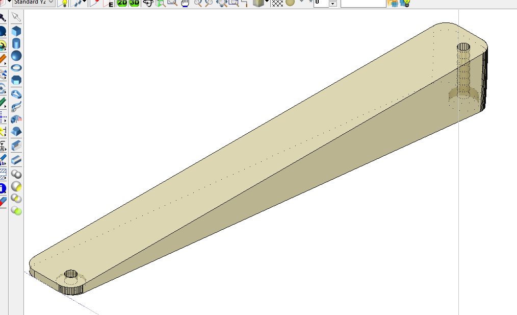

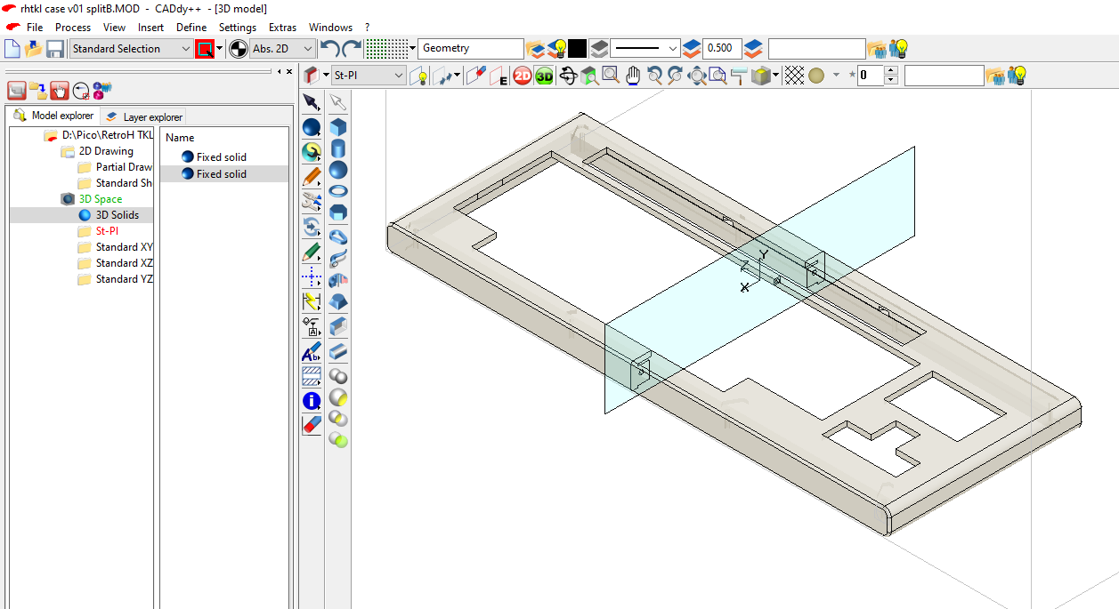

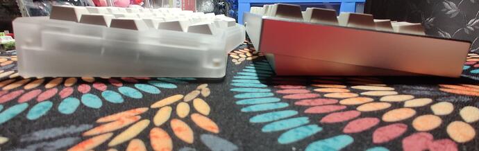

It’s been too cold the last couple of days to play Laser-man in the garage, so I’ve been wrapping up the design and 3D printing a case for the last of my 3 plates for my bespoke TKL-like layout, which kinda looks like the bastard offspring of an HHKB and and NCR80. The case itself is nothing special, though I did figure out how to sneak some captive hexnuts in there to keep the top clean.
I overestimated the precision on one vertical measurement, so it delaminated a bit and I had to glue it back together, but a little sand and paint (“Bauhaus Yellow” Krylon was on sale) should cover that over. The bottom will be 6-degree (I think) wedges for feet.
I haven’t decided on switches yet. The only things I have lying around in sufficient numbers are commodity reds and knockoff 67g holy pandas. I’m leaning towards the latter simply because I’ve never had any heavy tactile before. For keycaps, probably going with some white-on-blue generic Cherry doubleshot, or some apple-legend’ed XDA. I think custom-lasered keycaps will have to wait for the next build.

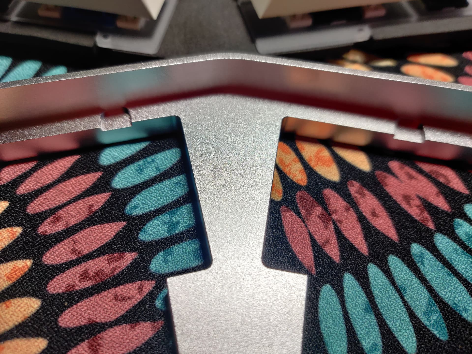

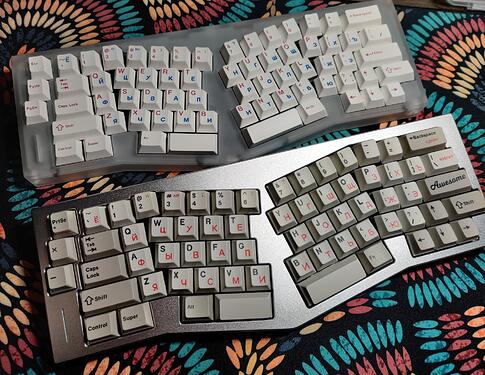

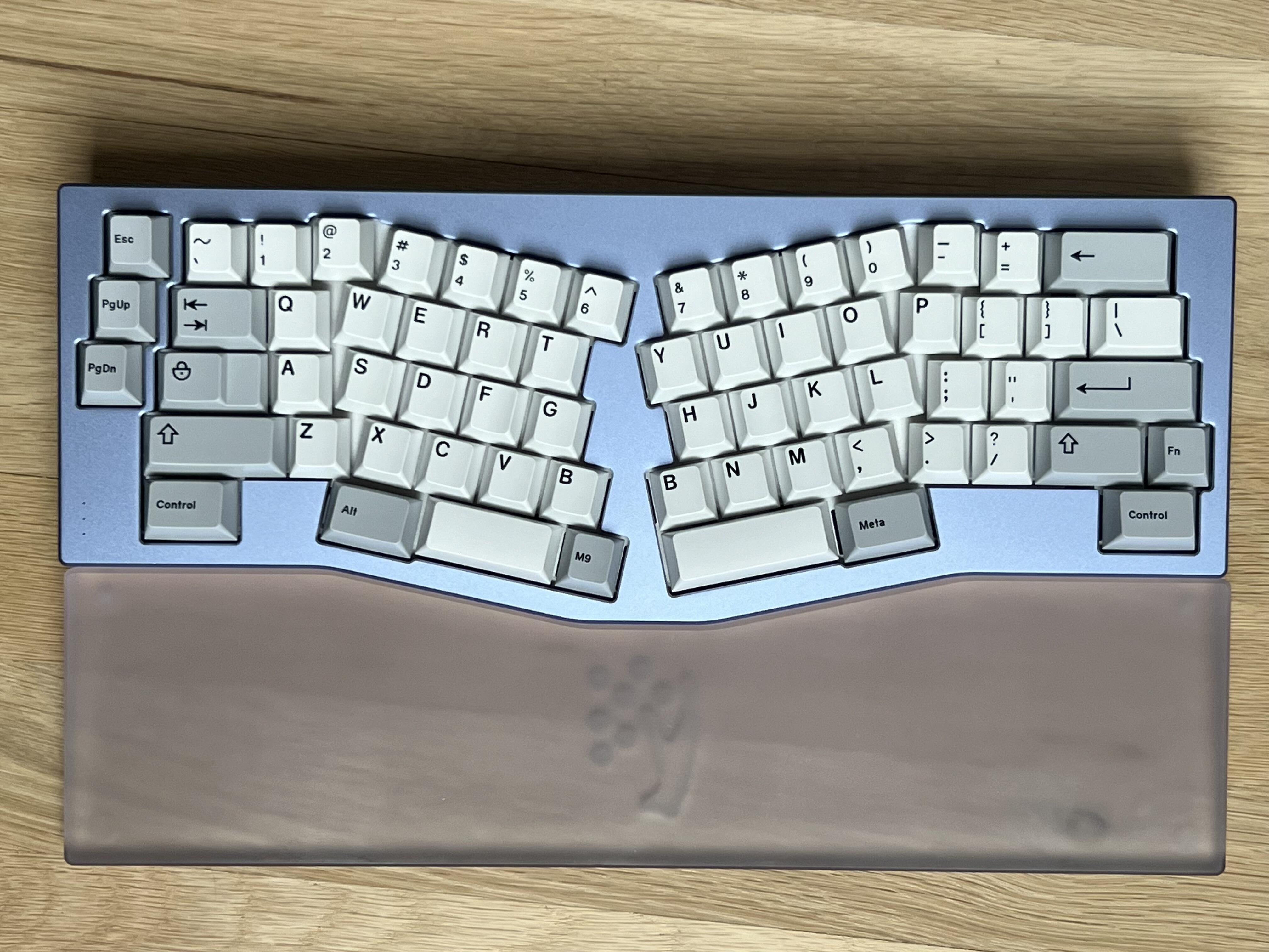

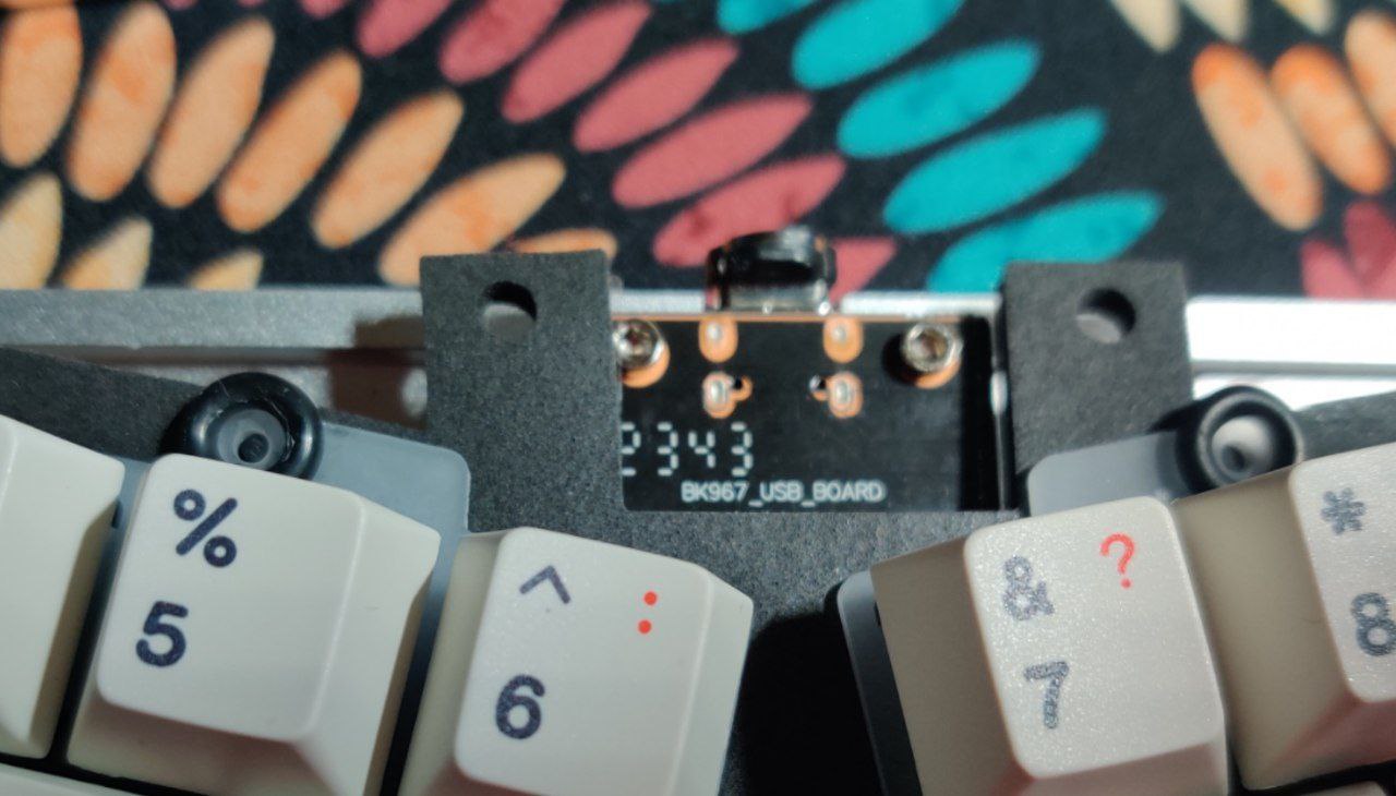

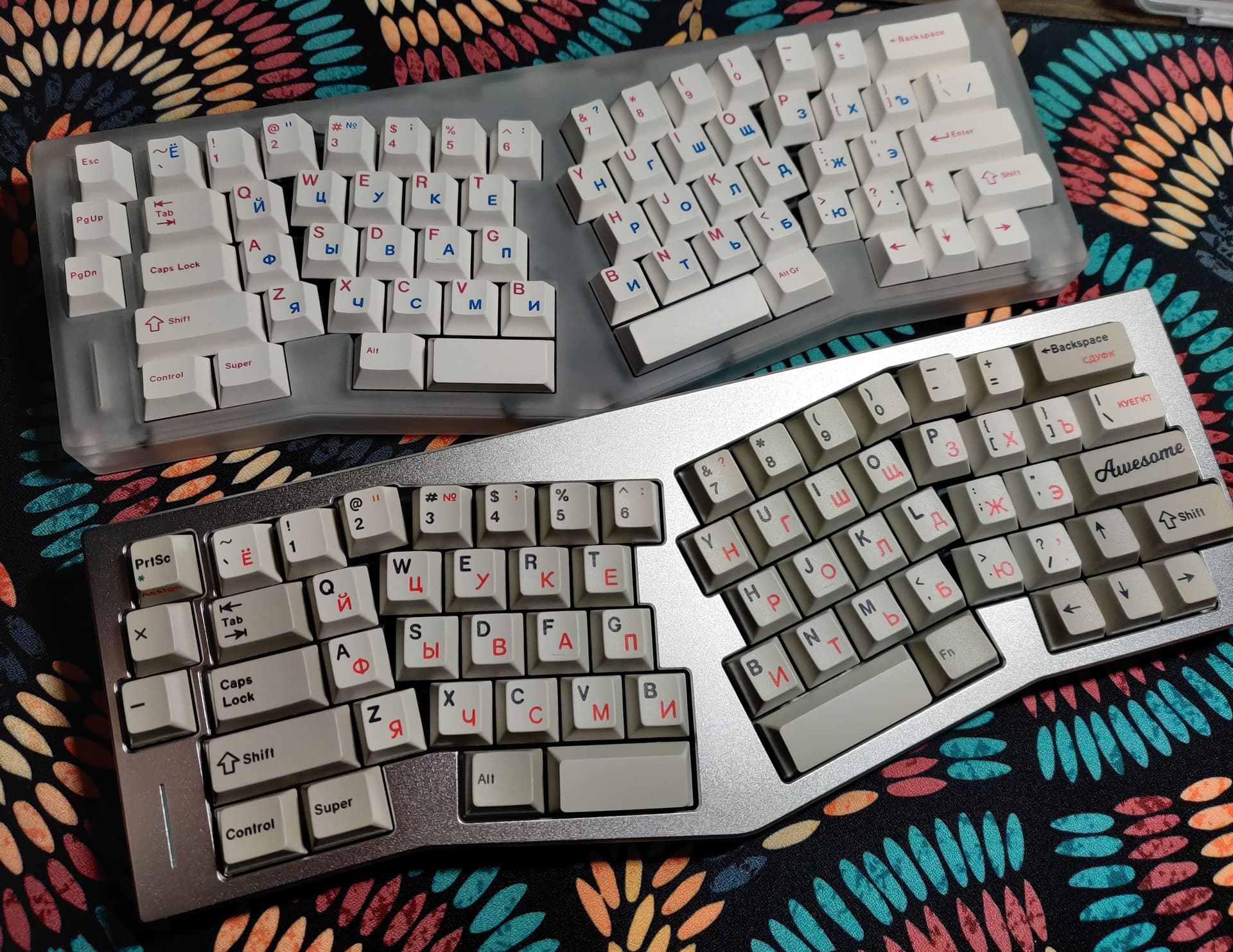

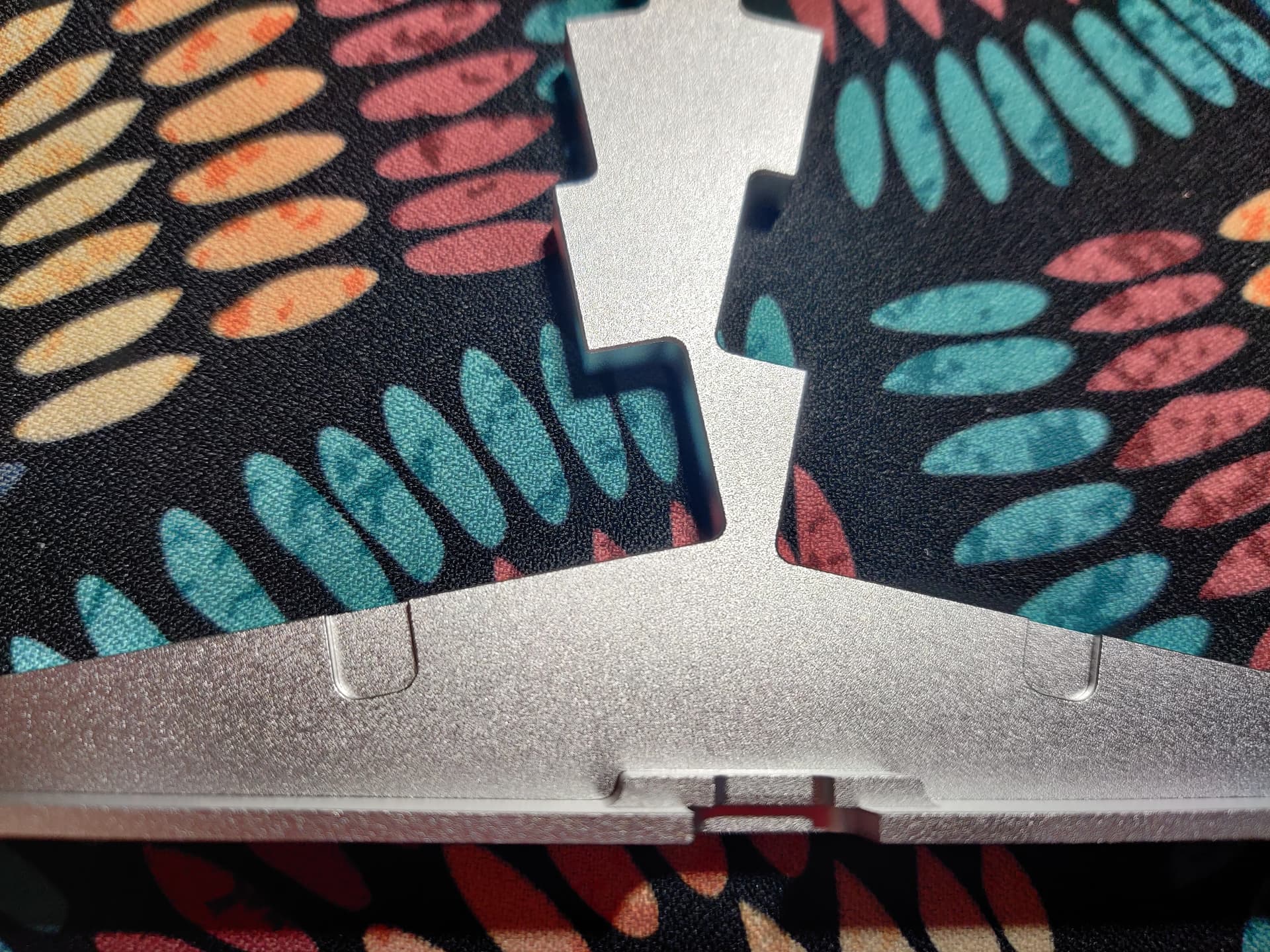

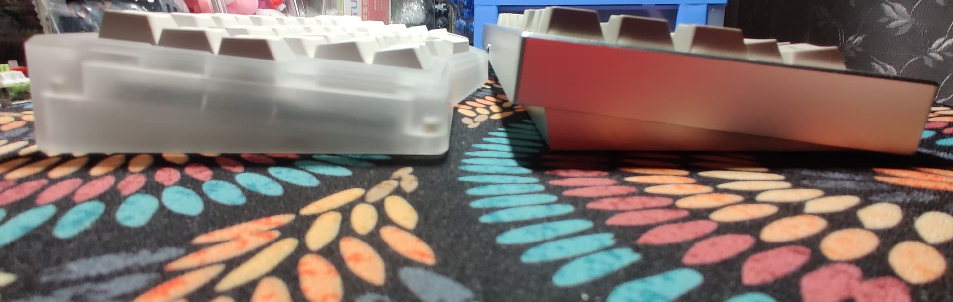

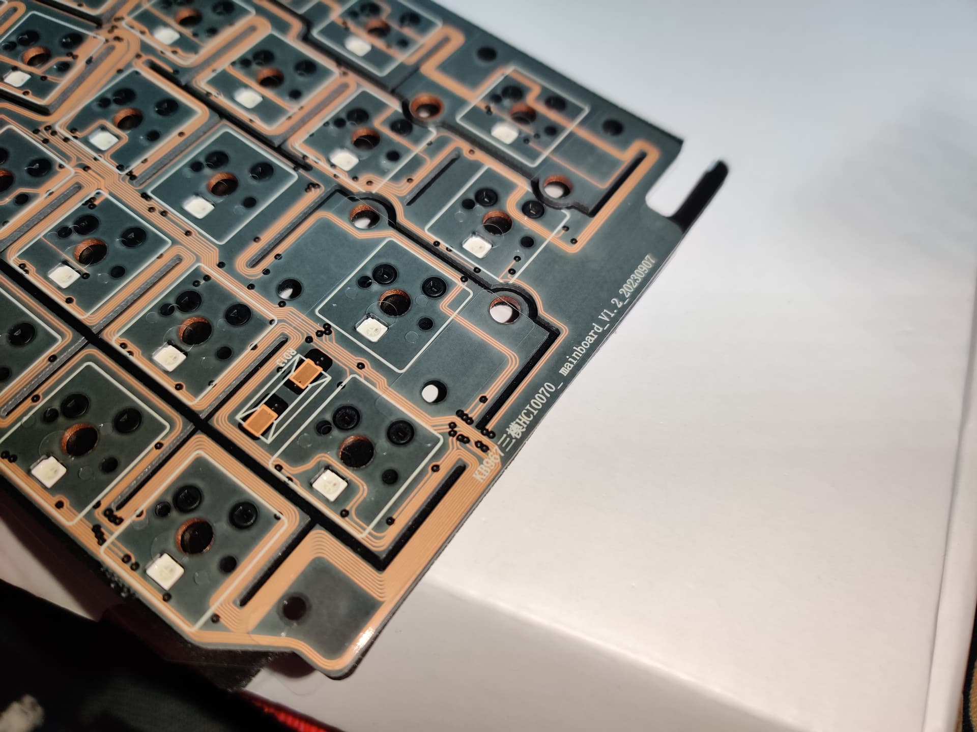

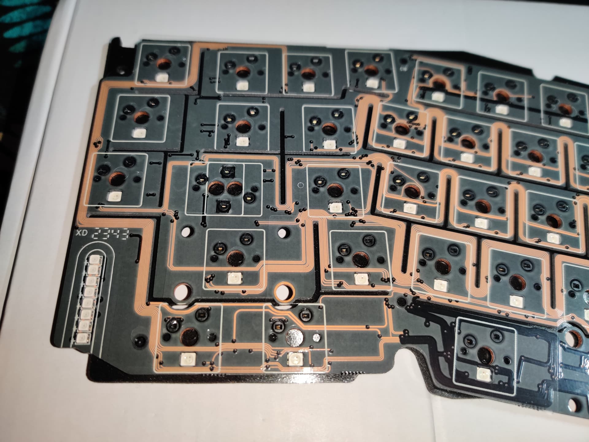

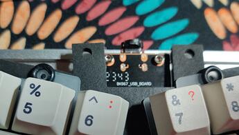

I decided to reassemble the sandwich.
I have three PCB boards.
Two to replace on this aluminum “spring” clone.
I’ll start complaining))))
There is a topic on reddit about this clone with a description of the software features. There are also links there.
Default board record Vika Alice has its own software, and you can also use a json file like Via support. But no. Via doesn’t work here. There is also a program for flashing the firmware to update it. I tried it too and there is a new json file on top. The result is that he only sees but doesn’t plow, there are always mistakes. The main problem is that the chip on this board does not understand layers. And not only does he not understand what a layer is, even change the button to which layer, it’s to the right of the right short space.
You can’t turn off the caps button yet. You turn it off wherever and however you like, but it still works there.
There is still a moment here.
They just stole the design. Maybe even project files.
But they don’t know how it works at all.

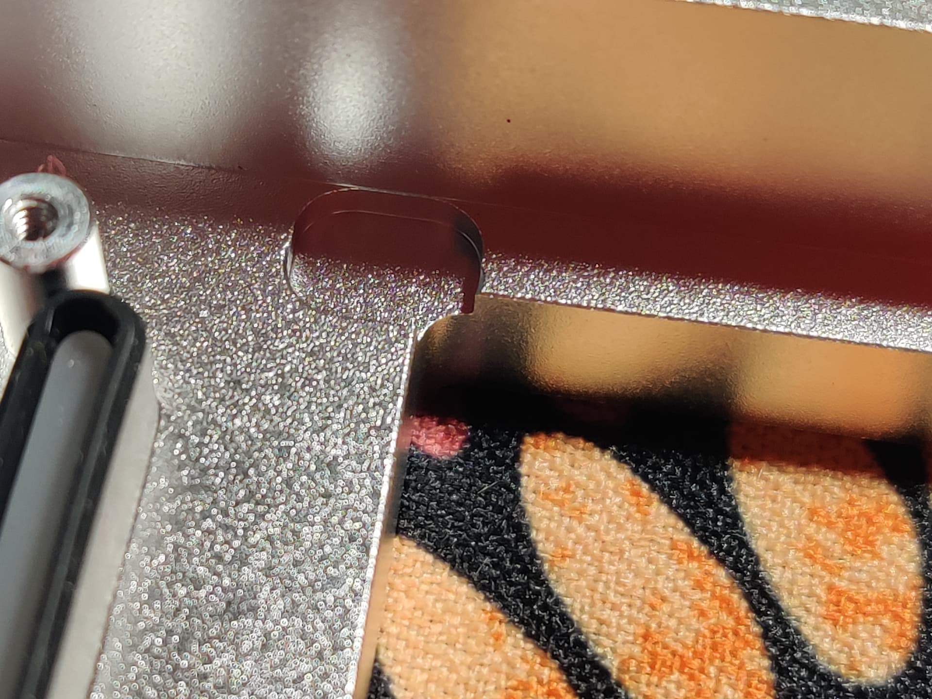

The original or even a TonySpring clone. There are these indentations on the body. And also the original and Tonyspring have rings. which need to be inserted.
But the Alice record wiki doesn’t have them.
And we get that the sandwich, or more correctly our plate, hits the top of the body, and sometimes it can hit so hard that it all rings like a bell.
You need to figure it out yourself.
I tried different options.
These thick black rings are fine. But only as thickness. But the diameter needs to be smaller, one and a half times, I don’t have it.
Since such a diameter does not allow the top to be closed and screwed.
I solved this problem temporarily by finding rings that are thinner in thickness, but have the same diameter. Then you can put the top on and tighten the bolts.
I also noticed that there is data on the PCB board.
The stabilizers out of the box are very good. You don’t need to do anything. They are lubricated and the action is easy to press.

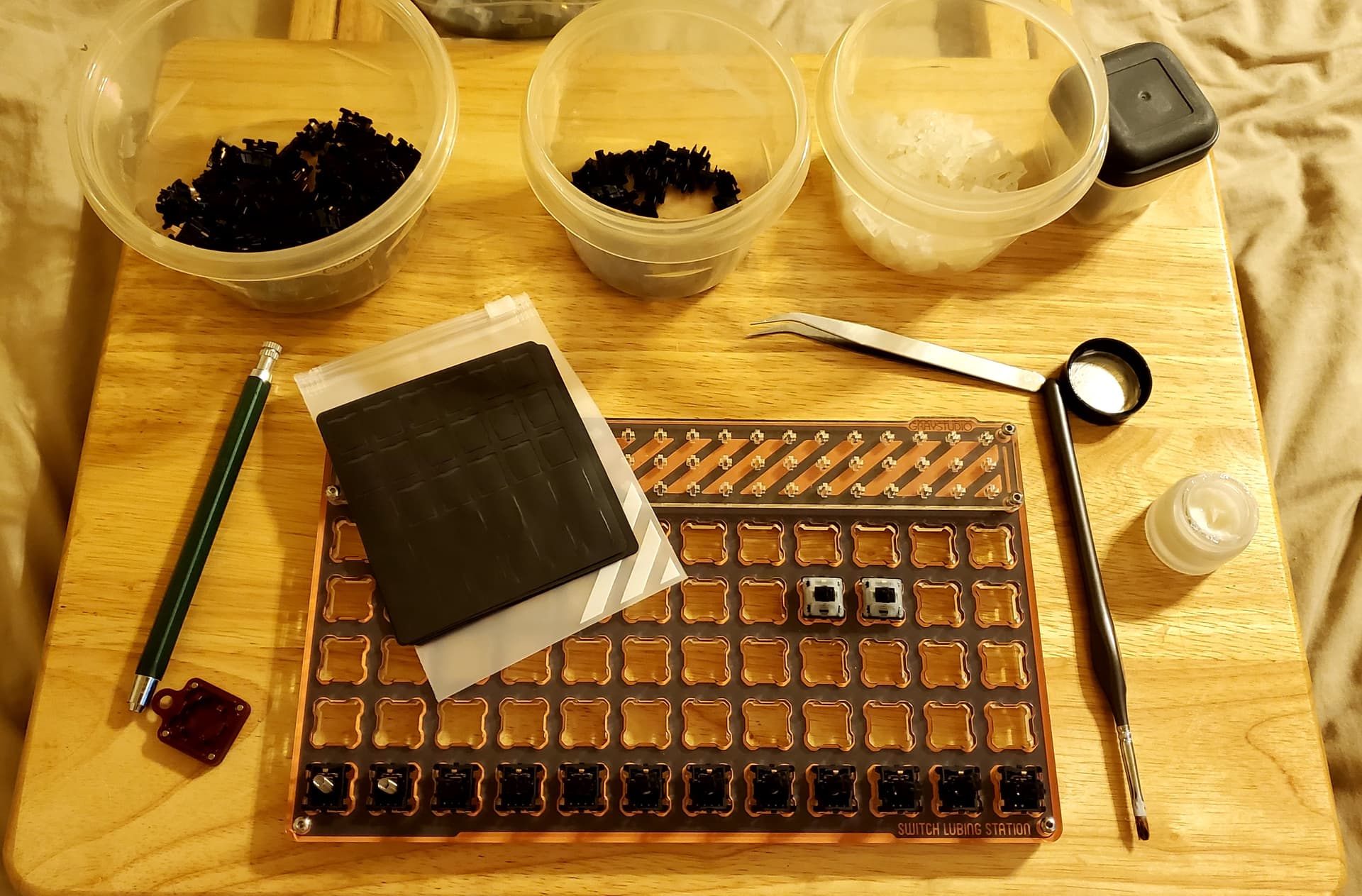

Fixing up some new Nixies for my Dolphin. 205g0 on the housings & stems, 105 on the springs, swapping in 18mm 50g Geon springs, & using Geon poron films.

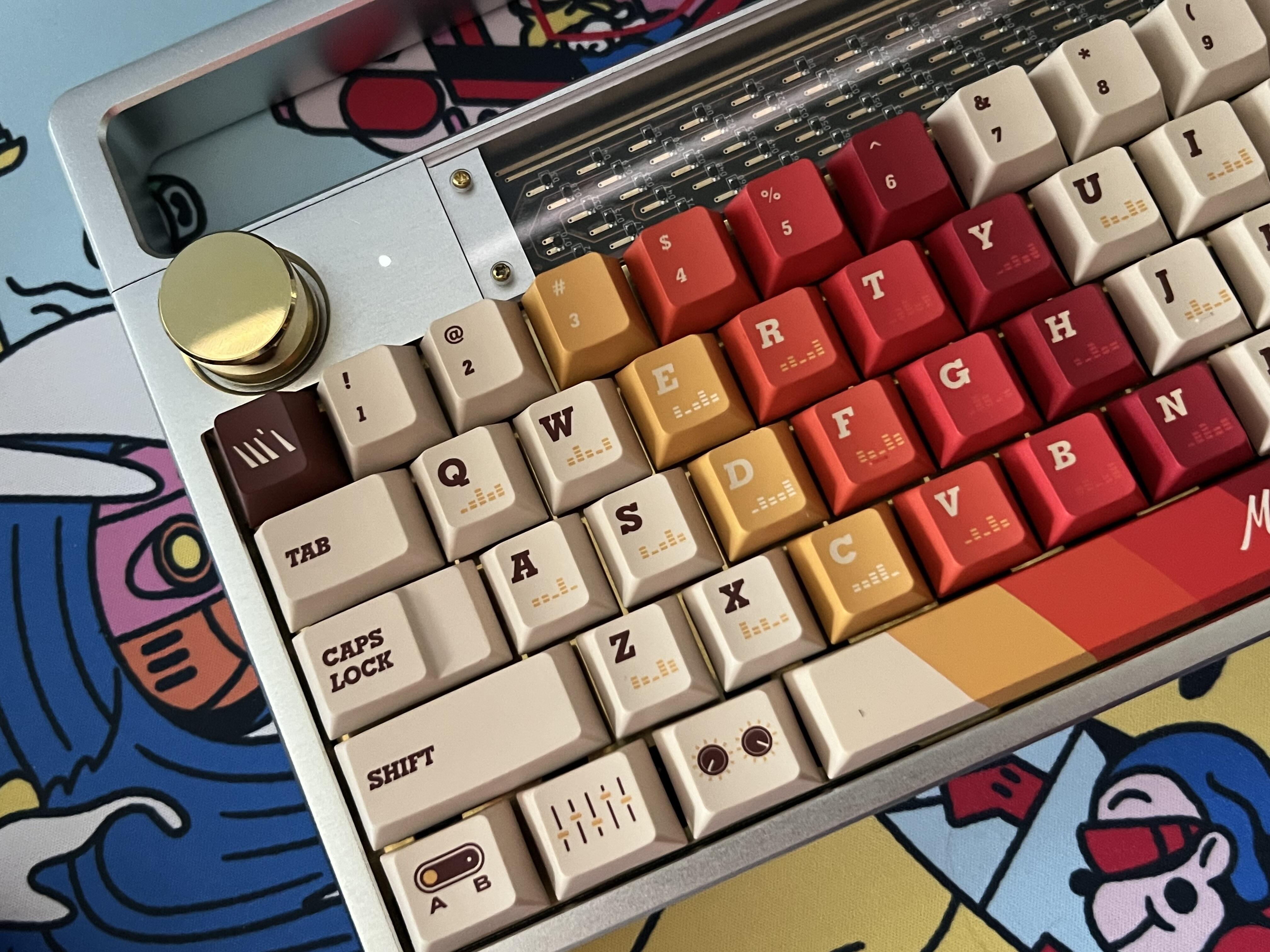

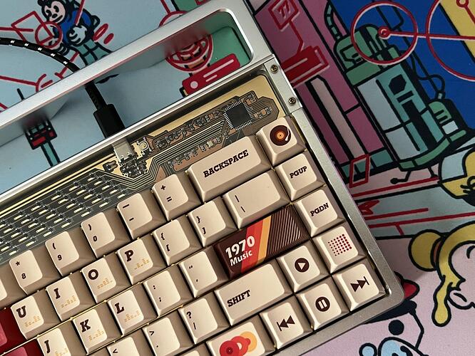

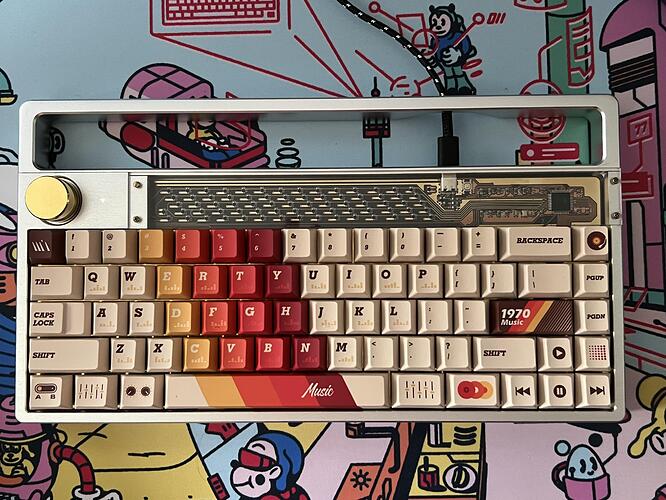

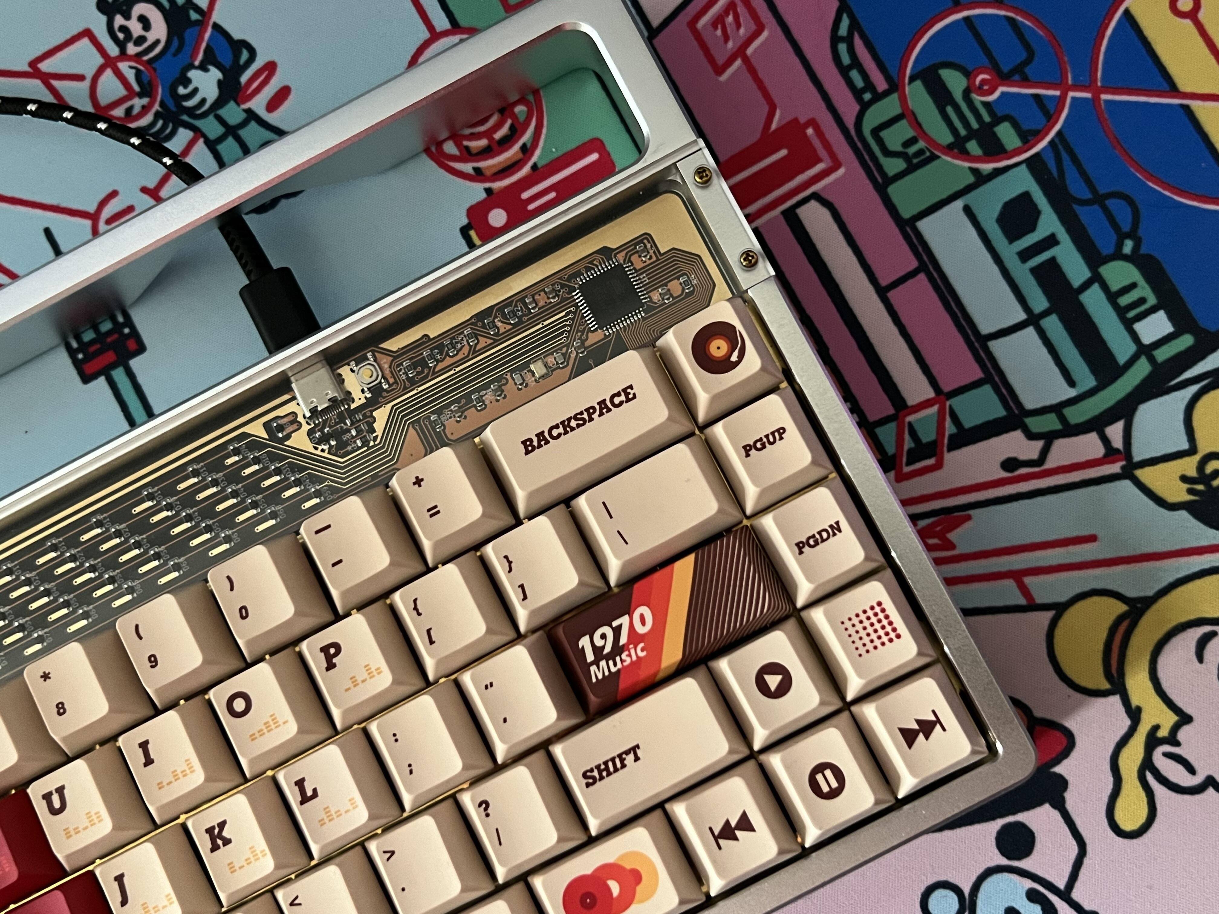

First build of 2024. Disarray65 with Kailh silent (deep sea islet) switches. Very happy with the quality of the keycaps from @velocifire
Huge 80’s boombox vibes, sweet combo bud!
