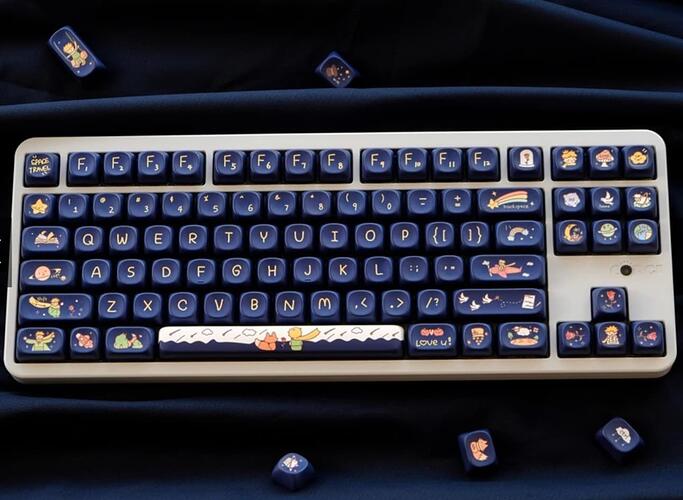

What's This TKL Called, It Has the Longest Spacebar Reaching Up to the Period Key?
Hi, no TKL or 100% full-size layout has a spacebar as long as this and seems to have the longest spacebar by far. What kind of TKL is this? It only has 3 keys below the right shift which is the number of keys found in Apple’s keyboard layout usually (but Apple of course does not have a TKL and doesn’t do thick mechanical keyboards anymore which is unfortunate).
Thank you in advance.
God bless
It isn’t really the TKL, but this layout has a 7u (7 unit) spacebar and is called Tsangan layout. It is characterized by the 7u spacebar and the symmetrical key sizes one each side.
It is my preferred layout. I love the look, and if you do this bottom row on a 60% with split r-shift, you can use the right hand mod cluster in the bottom corner as arrow keys.
You just need a TKL PCB that supports this layout.
The layout in the photo is typically referred to as “Tsangan bottom row”
In the explanation below, the “u” refers to the number of units wide the keycap takes up. A standard keycap like “Q” or “K” is 1u or one unit wide.
This means the bottom row is a symmetrical layout:
1.5u | 1u | 1.5u | 7u | 1.5u | 1u | 1.5u
