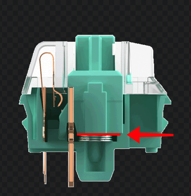

All is not lost even if you bag lube. Just wipe off bottom edges of stem sliders (shown in red color below) with a tissue before inserting each stem into the switch. Shouldn’t take more than a second.
I already did bag lube two of my boards worth of stems and didn’t wipe the bottom of the stems. So far I haven’t recognized any problems or any difference to my brush lubed board.
What exactly does wiping the stems there achieve?
Lube dampens bottom out sound. Thicker the lube, more it dampens. I frankly don’t think the difference matters unless you are, like me, really into how keyboard sounds.
Don’t take my word for it. Test some switches, some with lube at the bottom, some without and see if they sound different. Who knows? You may like the sound of lubed bottom more than dry bottom. :slight_smile:
FYI: Switches with tipped stem, like Holy Panda and Cream, bottom out on the tip so it won’t matter if they’re bag lubed or not.
