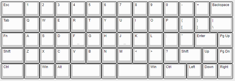

I have a number of XD75RE PBCs as it is a great way to get into ortho. This is a 65% White Fox meets Atomic layout that has done really well in testing and converted more people to ortho using the XD75 with 2u POS caps.
I know people who daily-drive a 4x12 ortho, but I’d strongly recommend you try a Preonic or XD75.

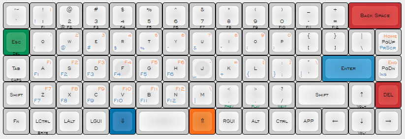

I’m quite happy with my ergo60/boardwalk prototype, seated in my kbdfans 5 degree case. There’s a thread about it here on keebtalk.
I can’t believe I forgot about the Boardwalk. I love the project. I’ve been sketching PCBs like it for a while and am super glad someone produced a version of it – the ergo mods is probably the best part of the design.
I’d recommend something like this kind of keymap but you can check out the other options

  • Having to adapt to ortholinear and 40% (or even a preonic-size) layout at the same time can be very difficult. So by going for a more xd75-type layout you can focus on getting comfortable with ortholinear.

You can do the XD75RE hotswap with the layout I posted above, but be aware that you’ll have to grind off a two or three of the standoffs in most 60% cases. I’ve used XD75AM pcbs with alps switches in stock 60% cases without modification, I think if you solder you only need to cut the peg off of one or two switches.
