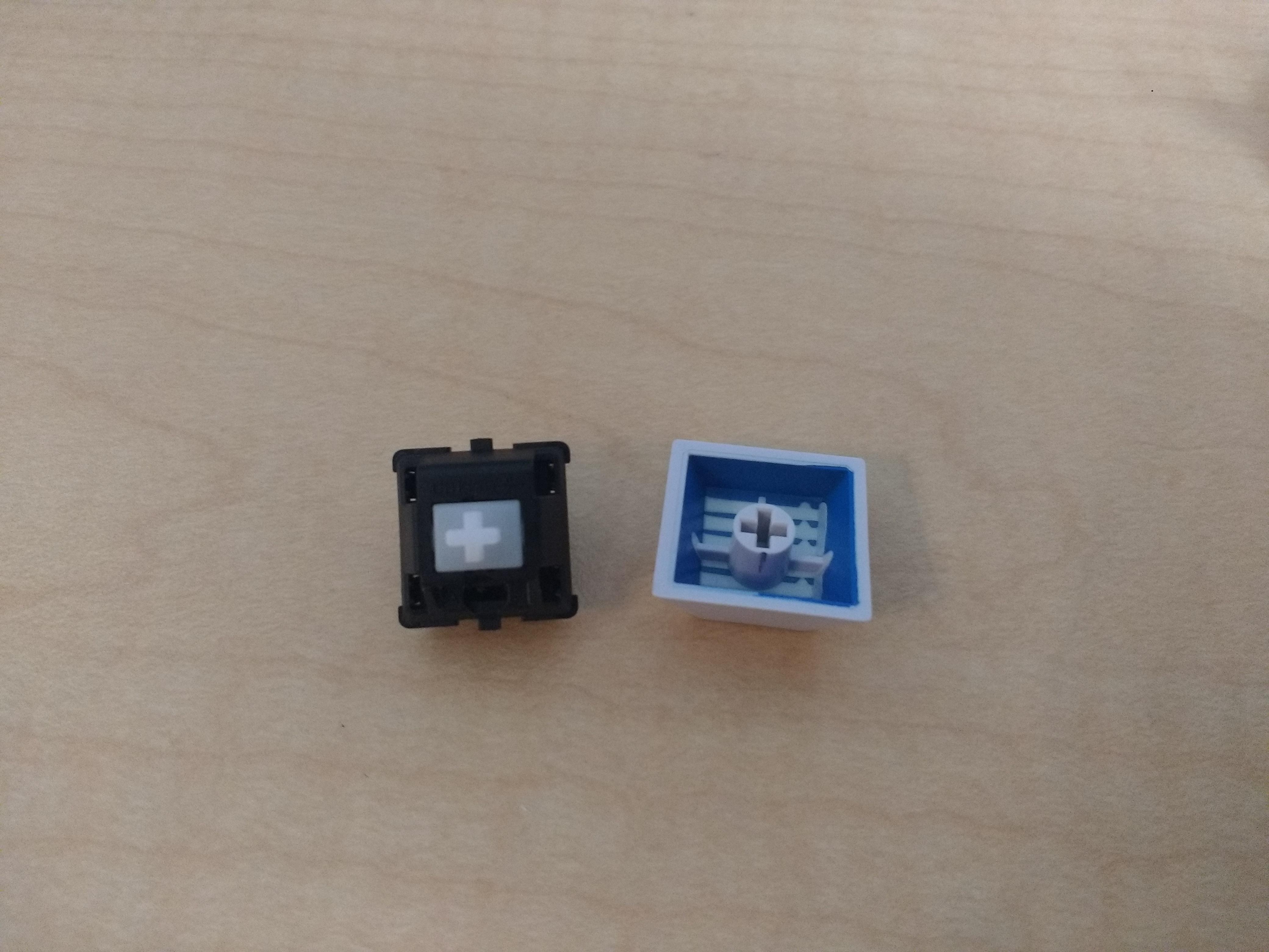

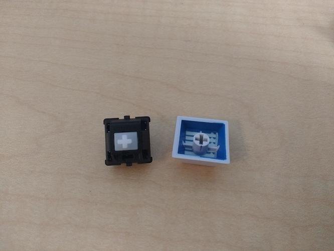

So I bought a fresh pack of Cherry Clears…
North-facing PCB?
Oh no, this is just from me spamming the switch in my fingers after drawing sharpie on the curved part of the top housing, then quickly reassembling. Unfortunately the new top housing moulds have made it to Cherry Clears. Seems like black Gateron housings are going to be the most fitting replacement.
Damn the Clears just keep getting worse and worse. Questionable news, since I’m using some as the basis for silenced tactiles.
Guys, push Cherry to fix their tooling please. CHERRY MX FAQ: Ask Us Everything! - YouTube
