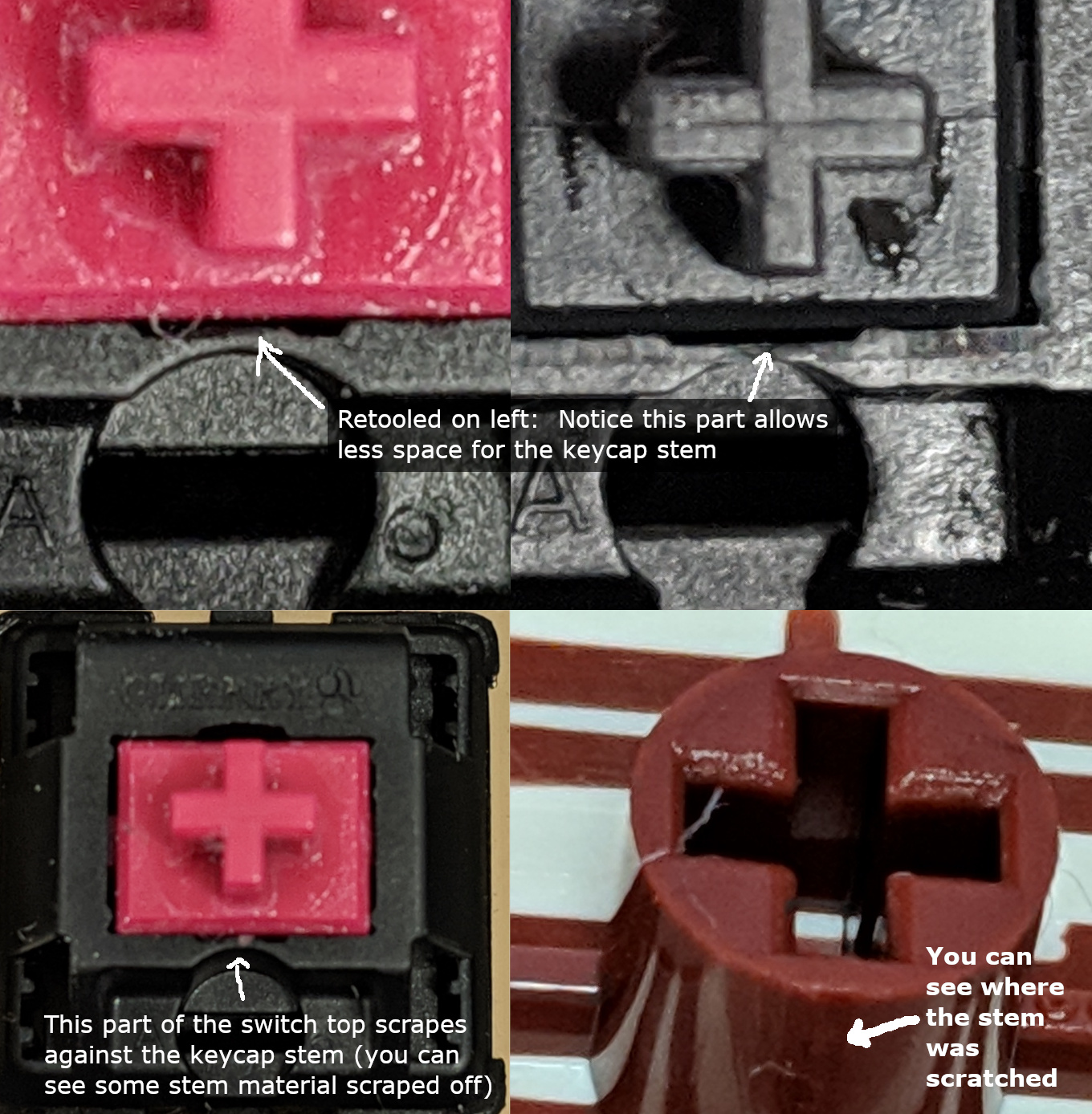

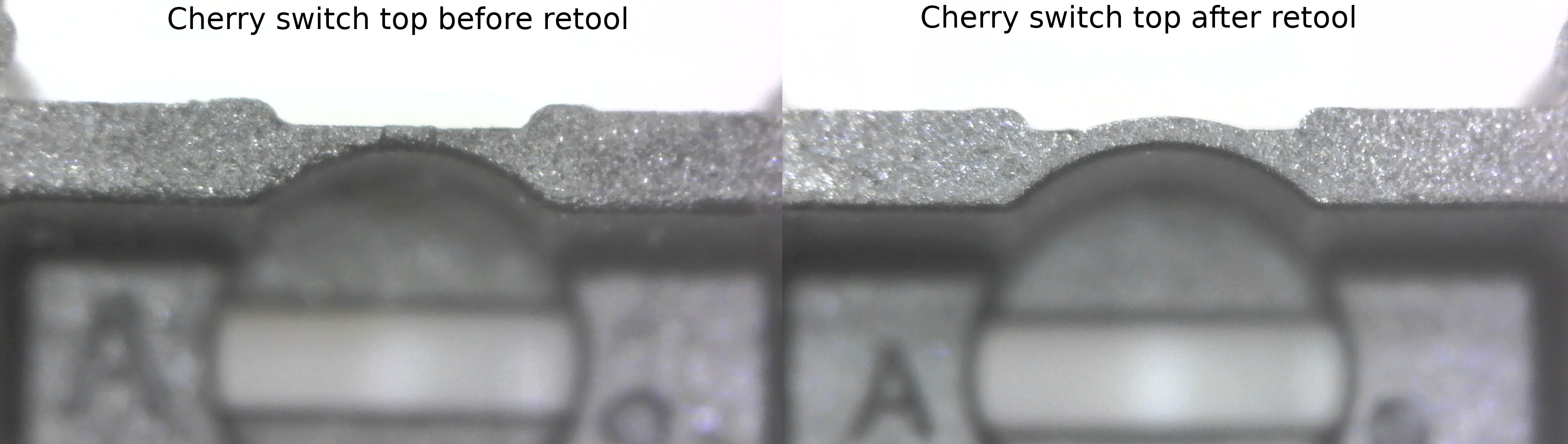

Here is a better picture of why the retooled tops can bind with GMK caps, especially if you use a different stem.
The keycap stem can snag against the curved part in the middle, which used to be flat.
This can happen even with stock Cherry switches and GMK caps, though it is much less likely because the Cherry stems are thicker which spaces the keycap stem away from this curved area. See comparison:

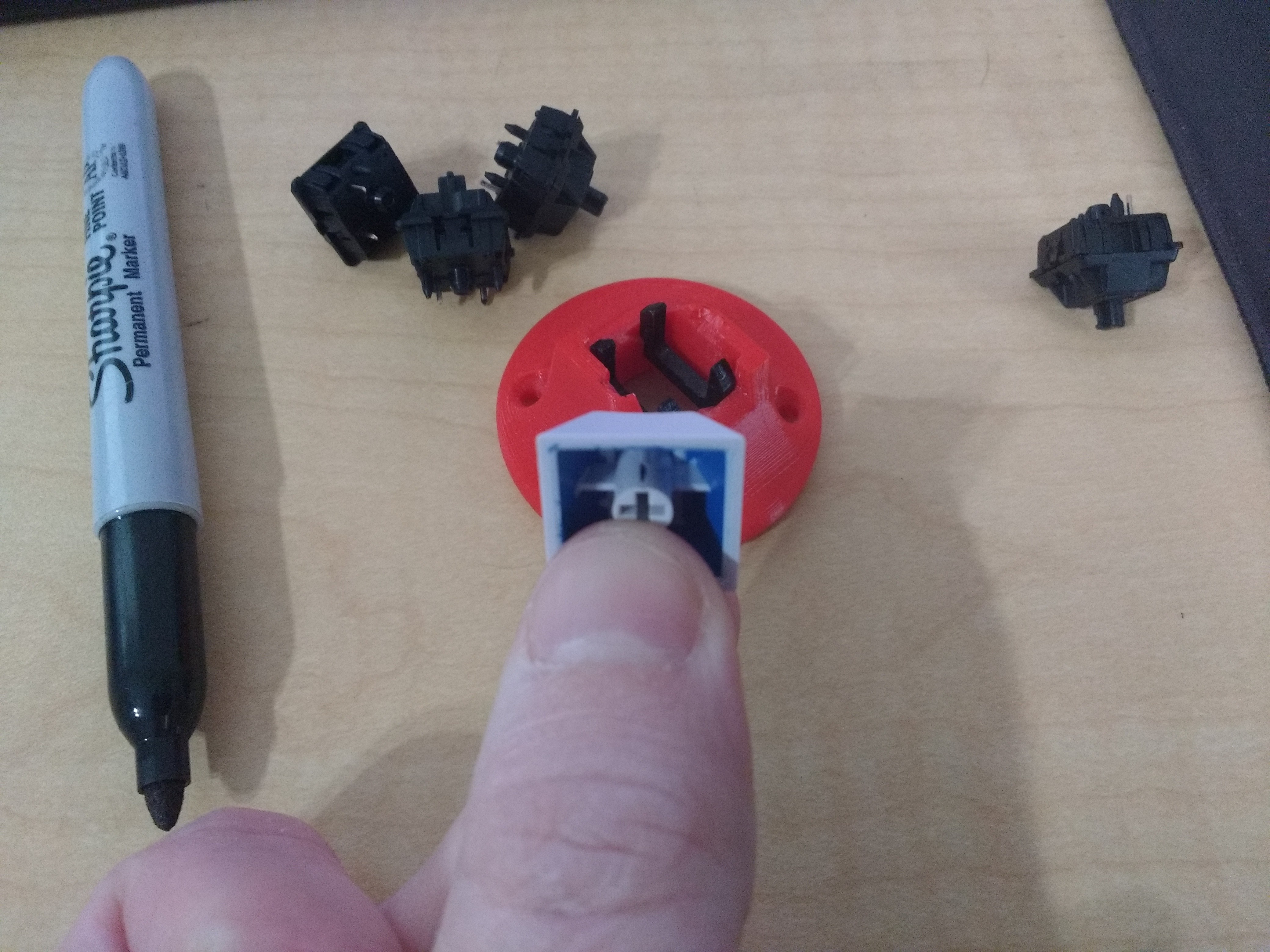

Reporting back; I tried a 1.5mm flat micro chisel and that’s a big negatory on shaving away material. The curve area is ultra thin, so it basically disappears if you try to chisel it flat, and you end up with and opening exposing the front of the stem. Also I stabbed my thumb and it didn’t bleed unless I squeezed it. Mhmmm

Well here are some Hyperglides with GMK Hydro. That sharpie line was transferred to the keycap from the top housing. Everytime I check something with these curvy top housings I am disappointed. You can’t even using GMK on new Hyperglide switches, are you messing with us Cherry?
