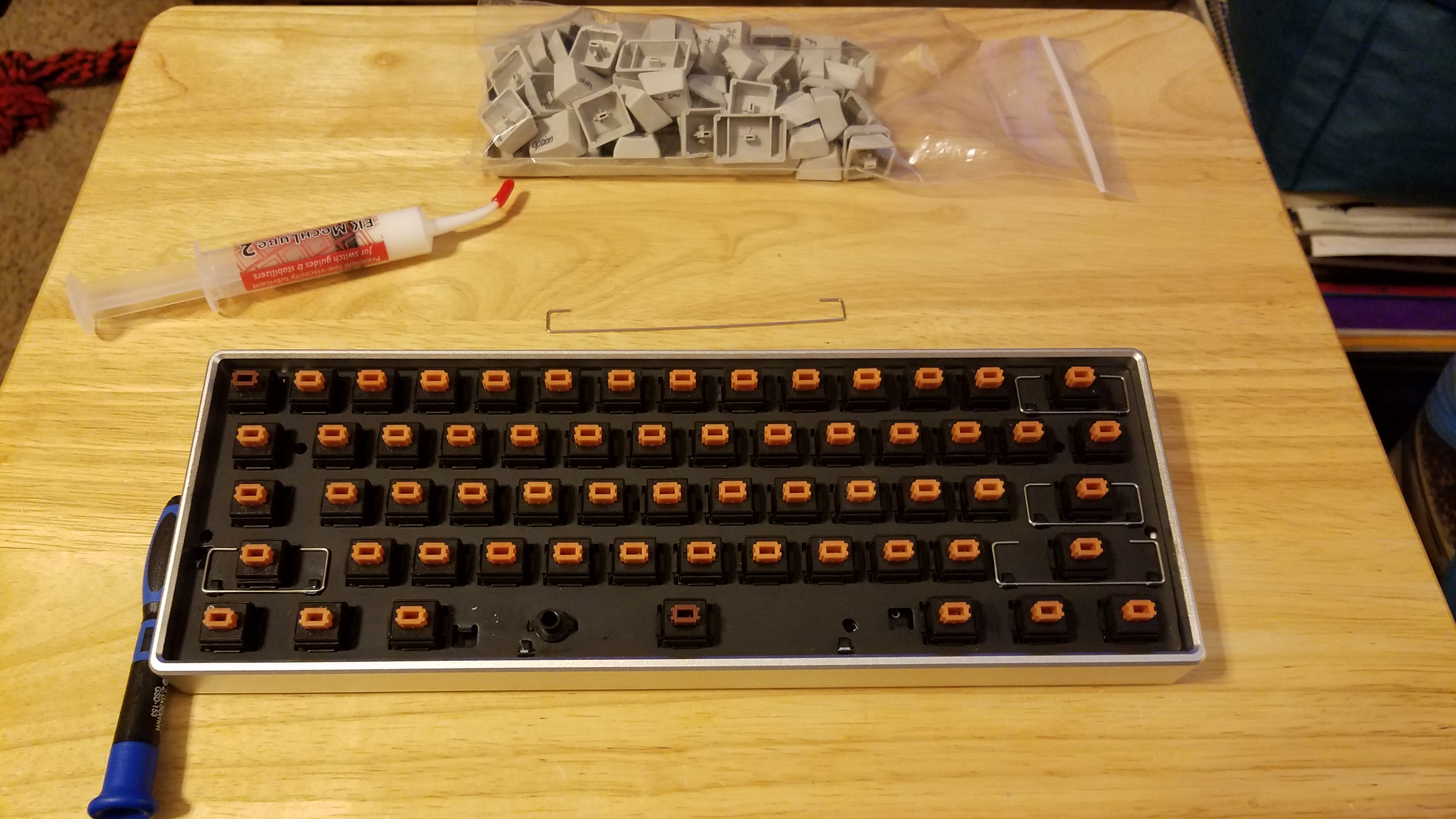

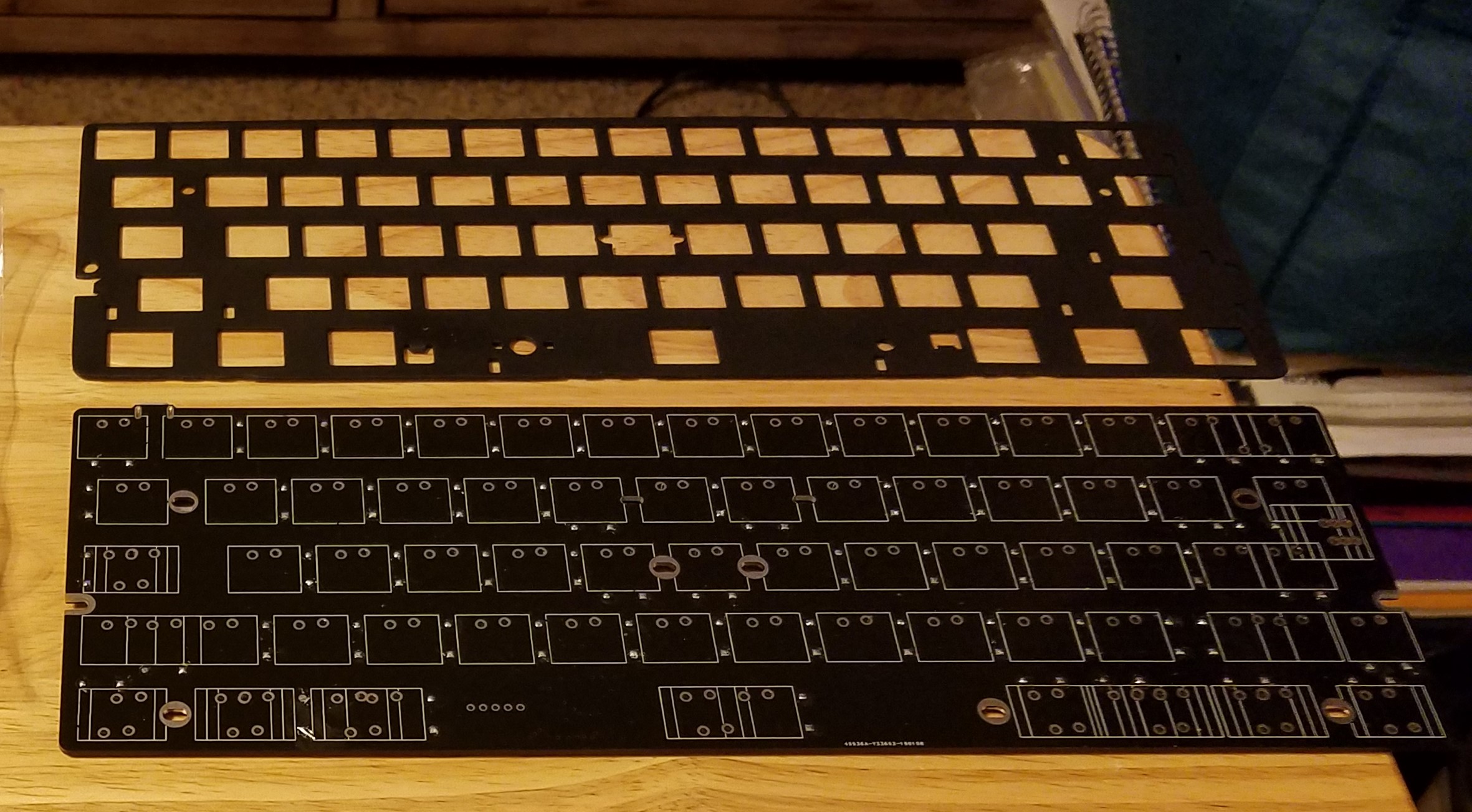

No regular ALPS stabilizers will not fit on to that plate. You can still use ALPS switches, but will have to use caps like Tai-Hao’s ALPS line which uses Cherry style stabilizers for the stabilized keys. Just so you have an ideal of what your looking at here is a pic of a plate with cutouts for for genuine ALPS stabs.

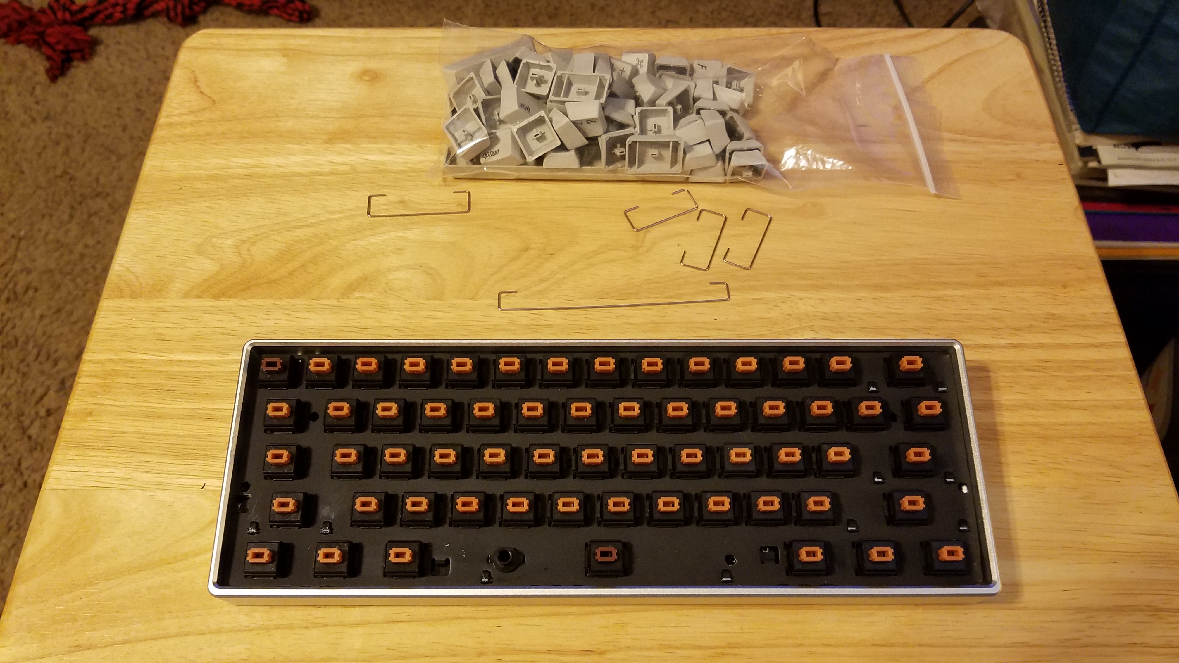

Notice those tiny holes where the stabilized keys are, they are where the clip for the wire of ALPS stabs gets installed. Much, much smaller than an opening for a Cherry style stabilizer. Also here is a couple naked pic of my ALPS64 build I used a a cut down AEKII plate for.
As you can see ALPS style stabilizers are very different from Cherry style stabilizers. Also you can not interchange Costar with ALPS stabilizers even though it looks like you could from a glance. Like I said before best bet would be to find a set of modern ALPS caps that have cherry cross mounts for the stabilizer mount on each stabilized key. Tai-Hao is the only real option for that I know of other than SP’s few DSA & DCS ALPS sets. Although the Sp sets are rare & expensive. Hope this info helps you plan out your build! :metal:
