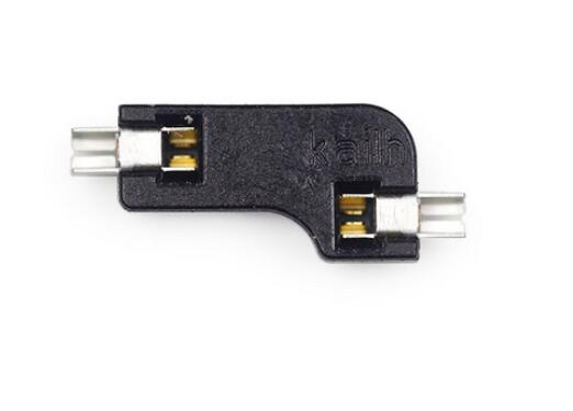

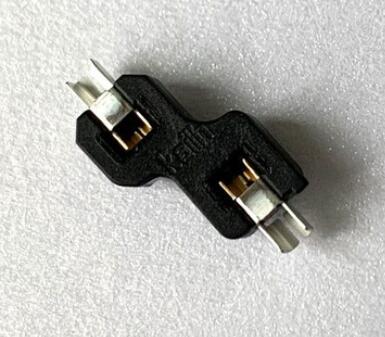

Just to understand the problem. I though that in theory I coul take any wireless keyboard, stick low profile switches to it (if its hot swapable) a knob if pcb supports this an then its about fin the case which fits knob and low profile switches. Lets take a random example which I googled DUKHARO 66 65. it is wireless and has knob, whats prevents me to add low profile switches?
I don’t think there are any hotswap sockets that work for both MX and low-profile switches. The footprint of choc and MX are very slightly different sizes and I don’t think the pins align.
Kailh choc hotswap:
Kailh MX hotswap:

Ou got it, so if I take low wireless pcb it won’t have low profile hotswap sockets and if it will , it will probably won’t have wireless connection :confused:
