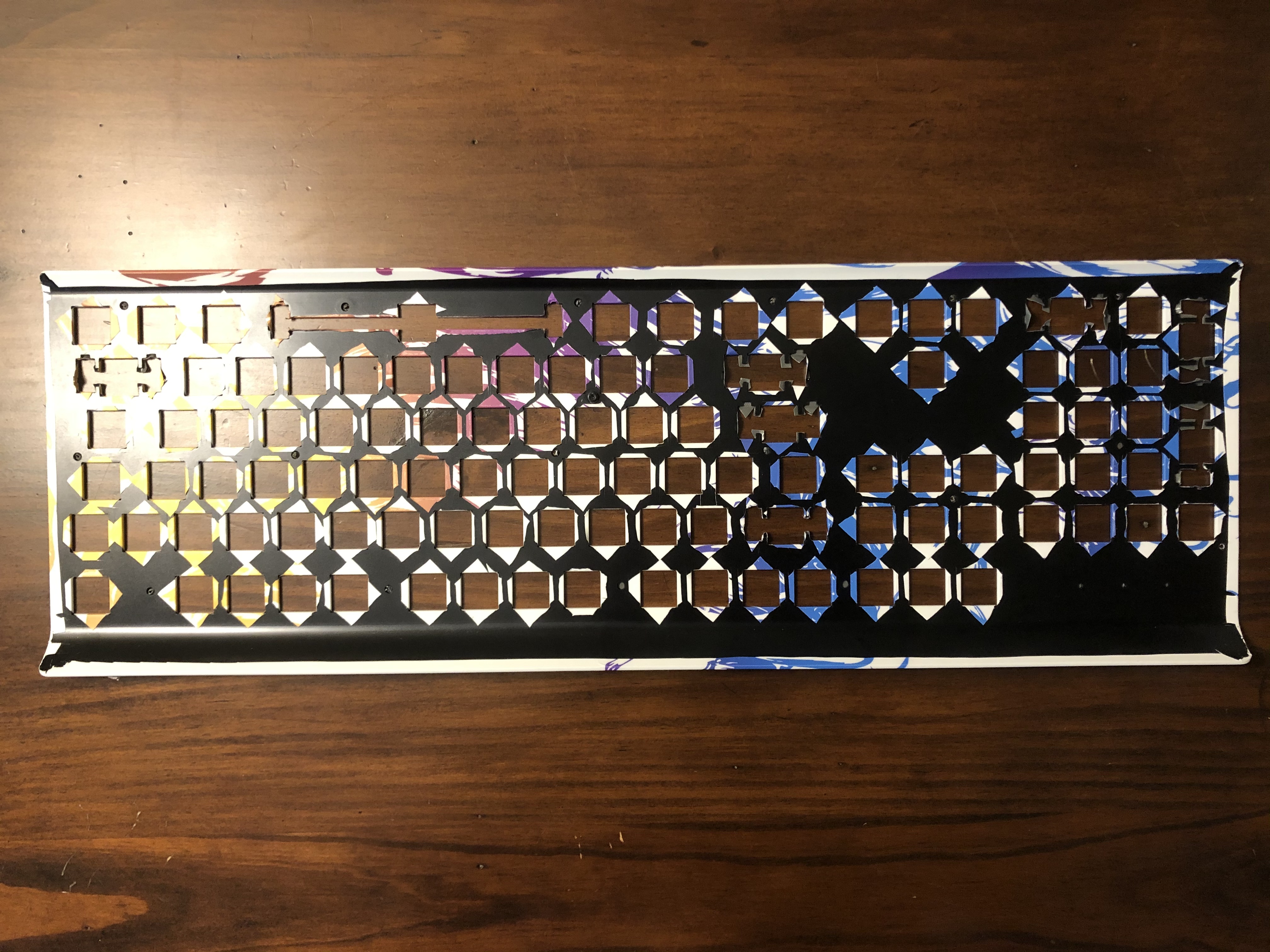

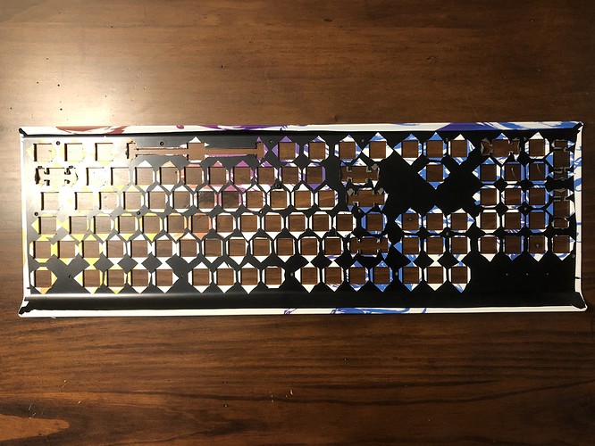

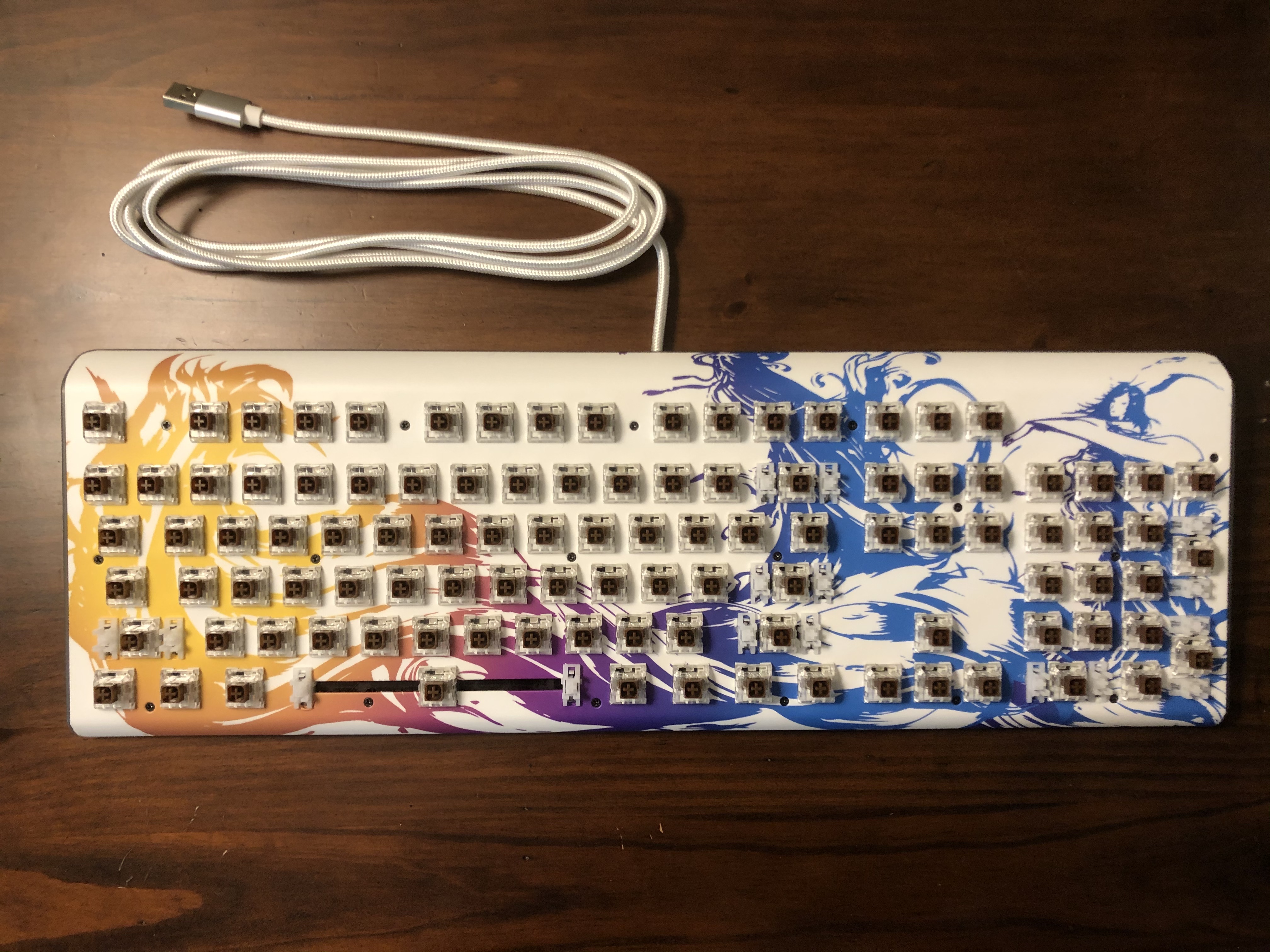

So in general this is possible - I did it myself a couple weeks ago on a fullsize.
One thing to note is it took me around a dozen hours to trim and wrap it to the point where everything worked as it should.

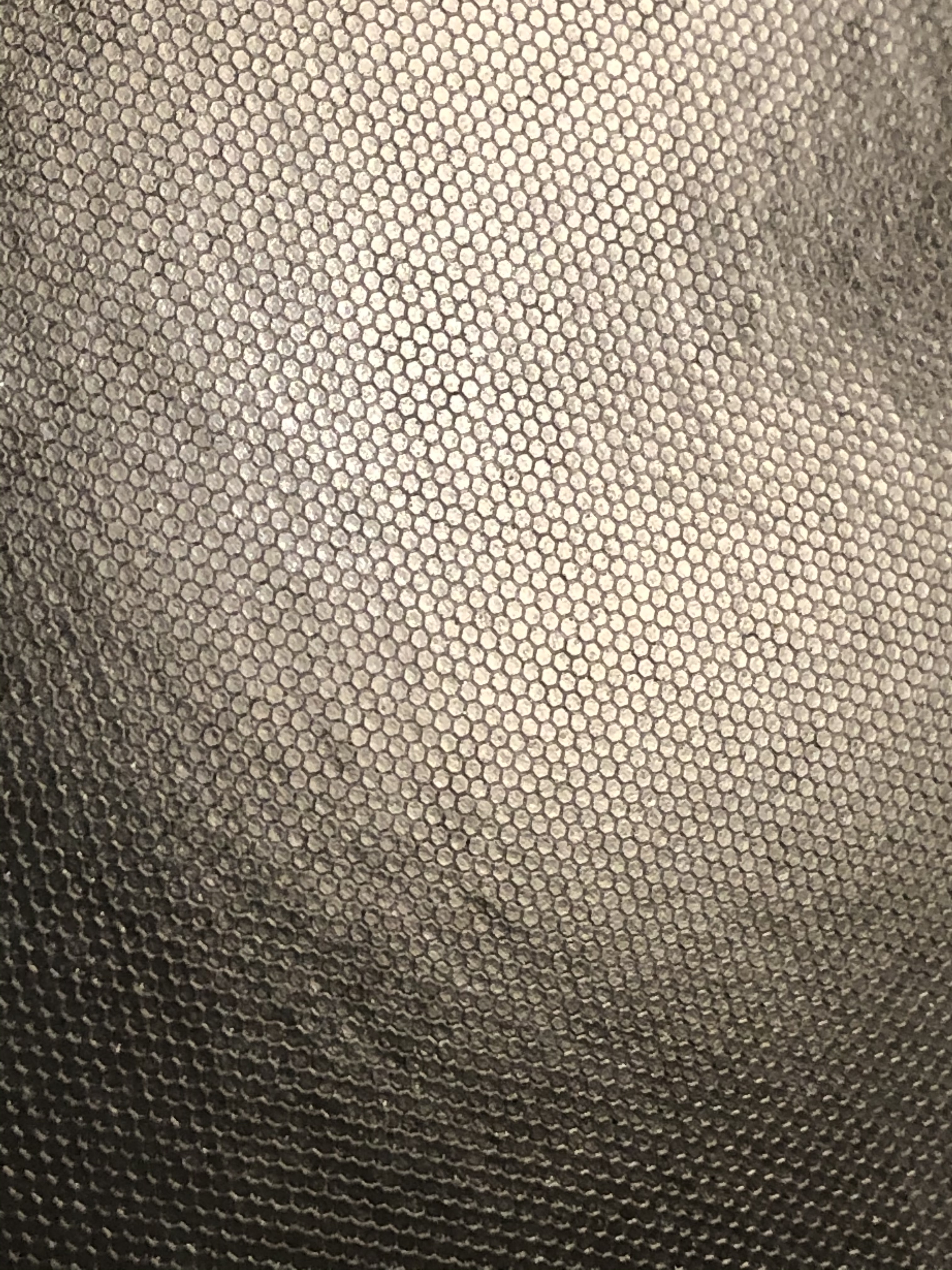

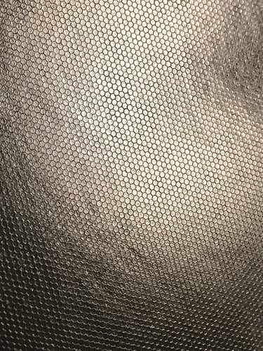

It might be worth asking this vendor if that vinyl has air-release channels in the adhesive - that will make a huge difference in the surface quality and ease of application since it tends not to trap air bubbles. The adhesive side looks like this:
That little grid pattern is tantamount to magic in terms of how effective it is.
