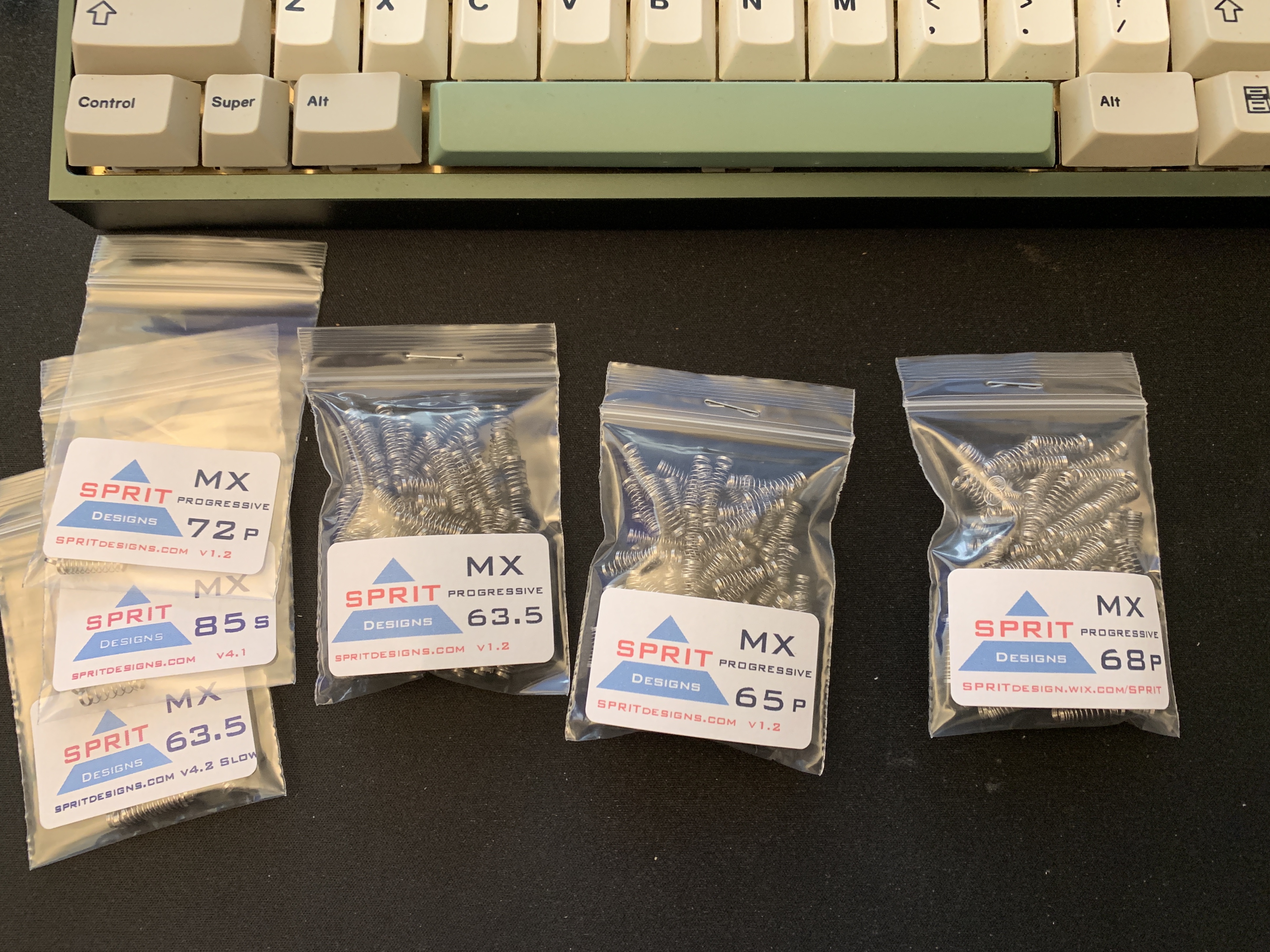

How did you guys go about ordering your springs? I had read some folks having issues with the SPRIT website. Would ebay be better?
I ordered through sprit’s website. No problems for me!
No problem for me either. These arrived today. 63.5P spring label missing the P threw me off for a second but 72P sample made up for it.
