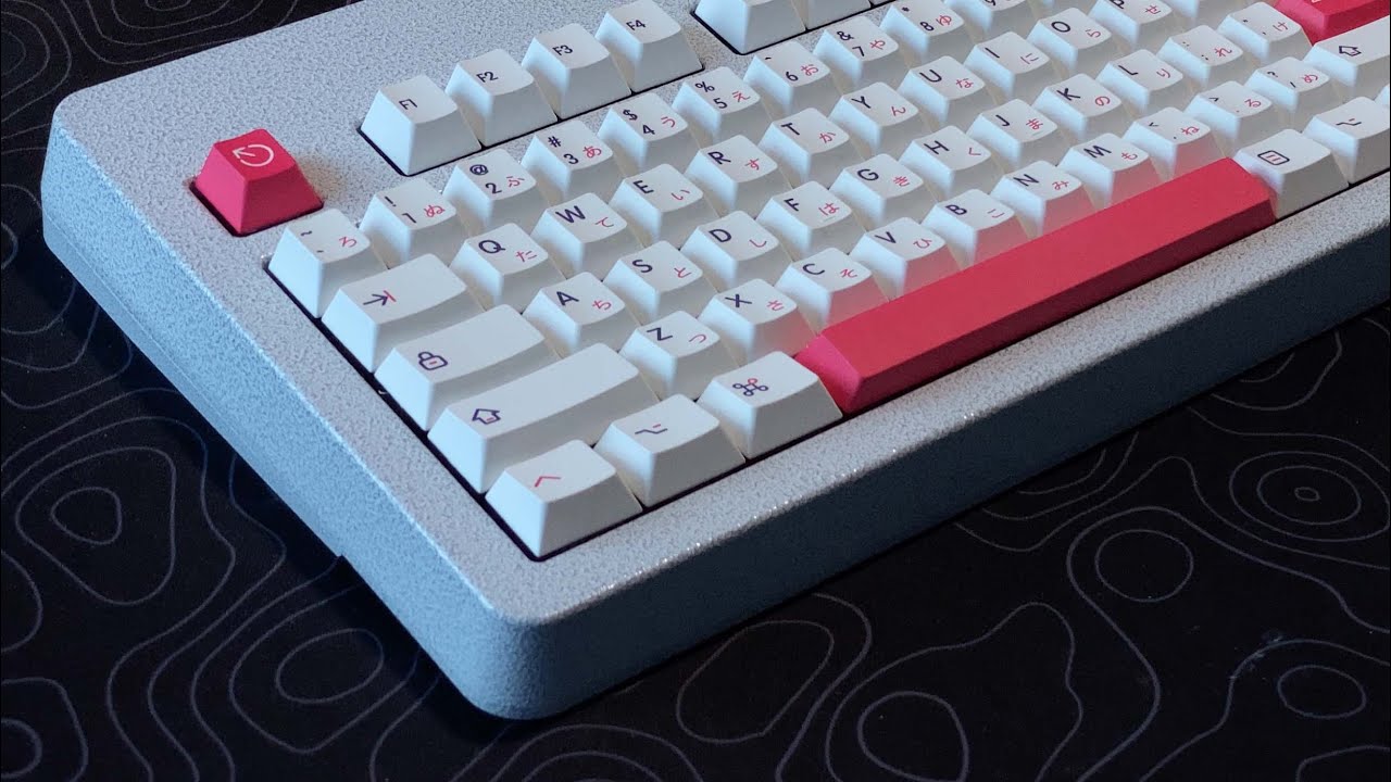

Norbaforce Mk II with an R2. but the 1U Niz sliders in stock Topre housings and Costar definitely affect the sound–I know, bc that’s the same MX-setup I’m running on my own Mk II R2 until Des releases the remaining parts.

i should be clear, I didn’t tape my Norbaforce–my comment was more on how Niz sliders and Costar add additional sounds that are hard to mitigate. tape will definitely not remove that. the Costar stab is mounted so precariously since it’s plate mount but wedged into the open hole left by the Topre spacebar mounts.

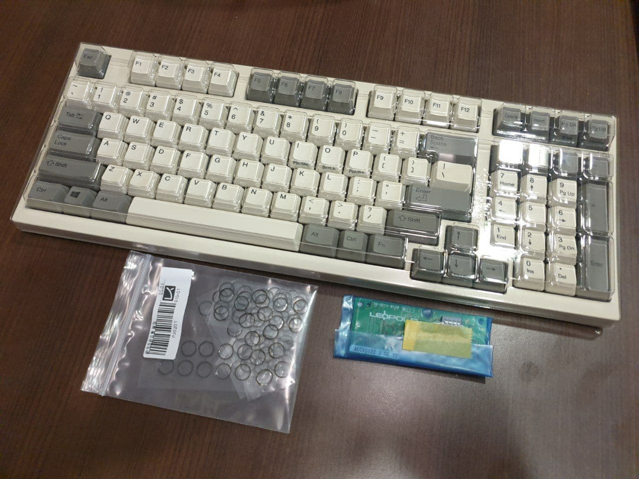

Would like some advice with modding my FC980C, which came with a Hasu controller and some KBDFans silencing rings
I like the overall stock feel of the 45g domes, but the stabilizer rattle is something I want to remediate. I disassembled the keyboard yesterday to lube the stabilizer wires, but it’s mixed results.

Thanks to the advice from @Manofinterests @chono @sarvopari, I decided to give modding another shot. It has significantly improved the user experience of the FC980C! :smiley:
Mod log:

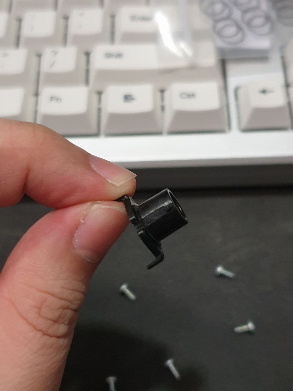

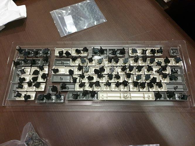

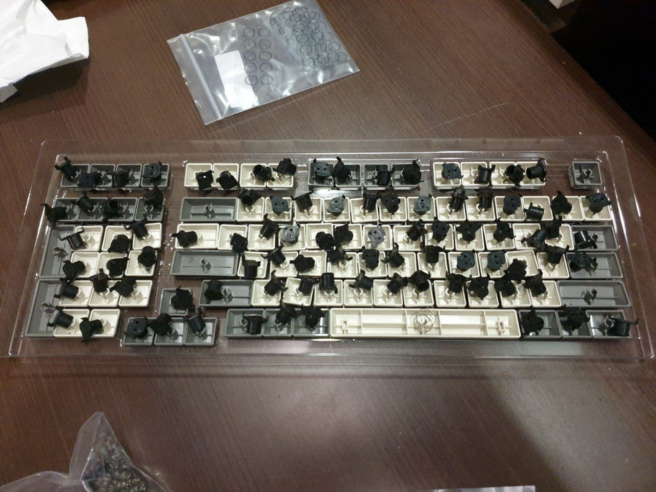

Removing the Topre sliders was a rather painful exercise. I followed a video guide to remove the 98 stems, with a caveat that there’s a little bit of plastic from the slider that gets chipped on removal. I don’t have a picture of it, but that plastic piece seems to serve as a “stopper” for the slider. Thankfully, there was no impact to performance, sound or feel when it got chipped.
The KBDFans silencing rings were rather flimsy and clung rather tightly to the plastic packaging. After getting the hang of it, it was rather easy to place the silencing rings over the stem (stickier side down)
Lastly, I took the time to lube up the stabilizer wires with Krytox 205g0. After a good amount of trial and error, I managed to remove the stabilizer rattle. There was a slight ticking noise for the spacebar, which I remediated with a silencing ring on each of the spacebar stabilizer’s top housing and added some foam within the spacebar keycap.
One mod that I decided not to go for was lubing the slider housings. I tried it for one switch, but preferred the feel of the stock housings.

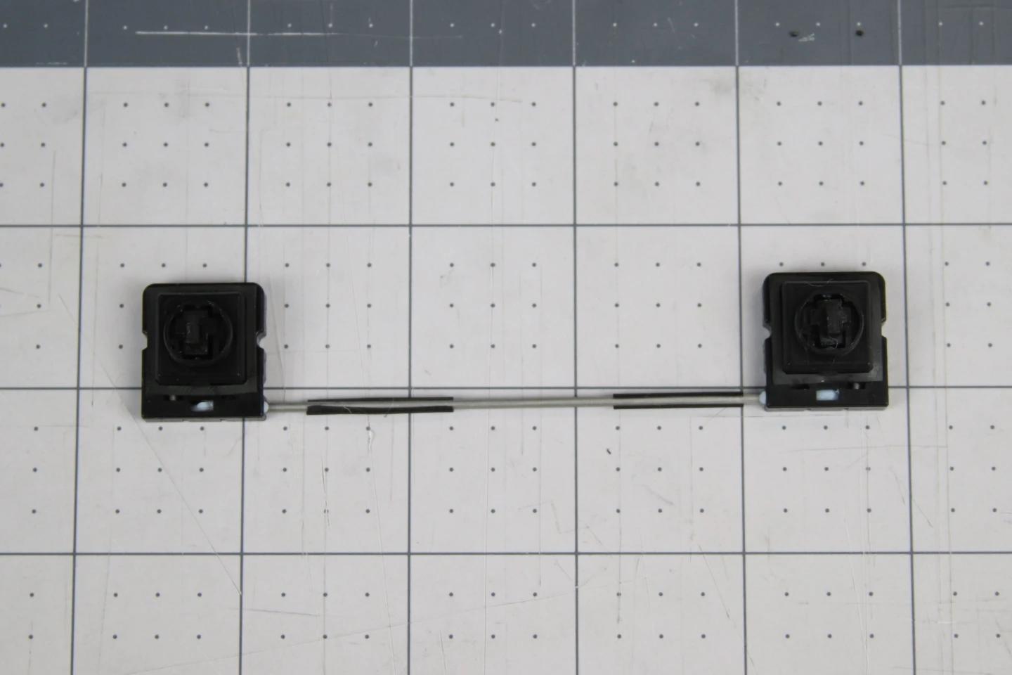

is it more wire noise or the top housing rattling?
there used to be an old mod suggestion to wrap (what looks like electrical tape) on the mounting points of the wire and also on the ends that go inside the housings
but it’s been skipped in favor of liberal lube. you could try the wire wrap perhaps if it’s wire-based noise?
Wire noise for the Backspace, and top housing rattle for the Spacebar. These “defects” only surface when I type quickly, perhaps it’s the force or angle that I’m hitting these stabilized keys. Since they’re quite minor, I’m very reluctant to disassemble the keyboard and risk some other defects or damage
The wire wrap looks like a pretty interesting mod to do! I applied a lot of Krytox 205g0 the last time around, but it seems like it’s not fully effective :stuck_out_tongue:
