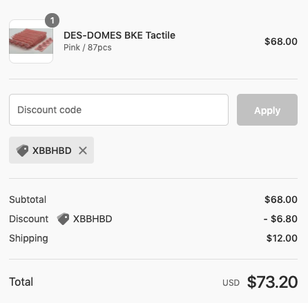

If anyone’s wanting to try Deskeys/Des domes, 10% off with code XBBHBD
$12 economy shipping, $24 Fedex shipping to US
*not sponsored, wish I were though :stuck_out_tongue:
