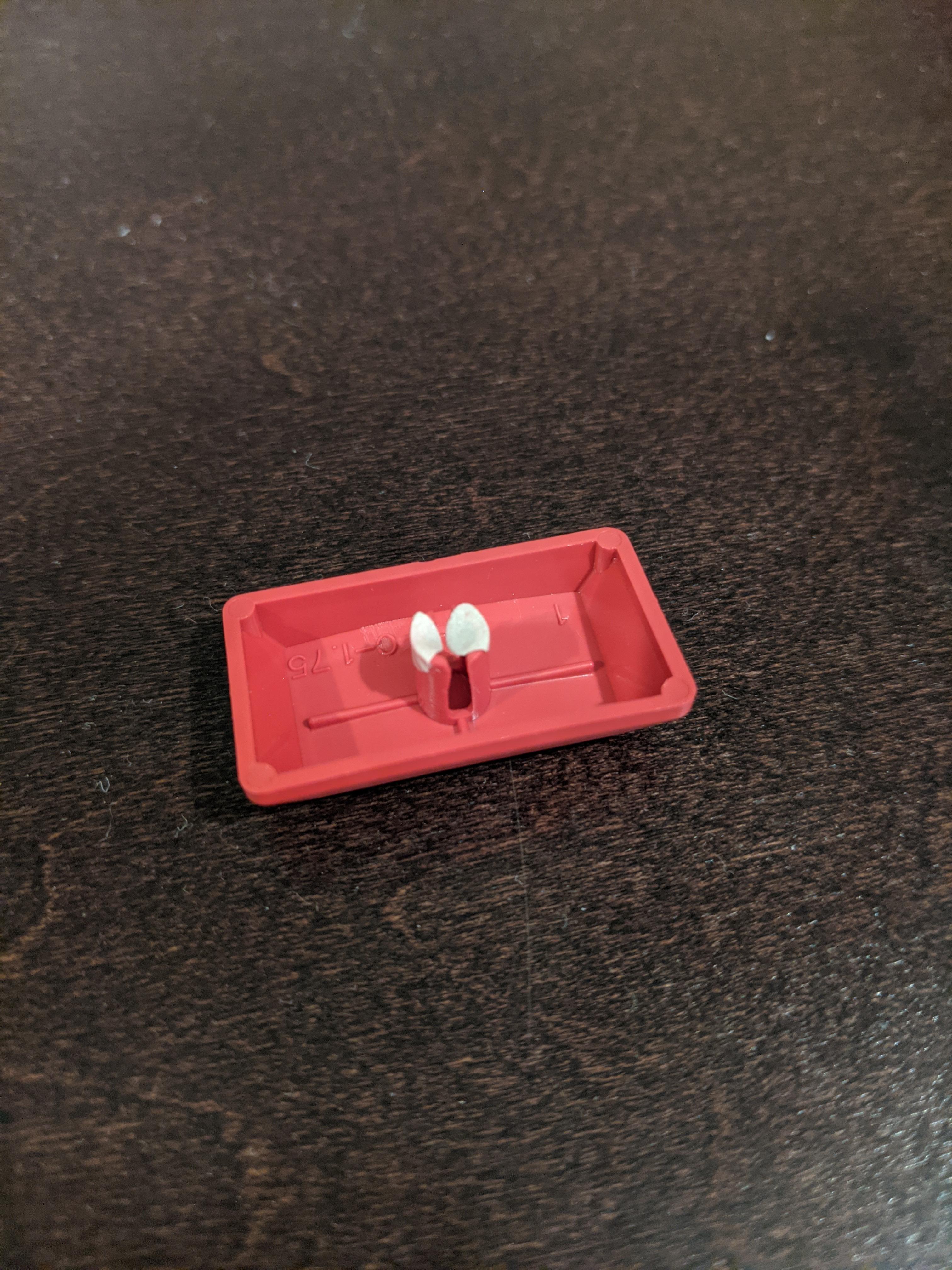

Interested to hear about the upstroke clack mod. My new 980c has keycaps that make a high pitched noise on upstroke only on R2 (zxcv row). Only happens with the one set. Put another 980c set on it and no noise.
My theory was that the stems fit a bit loose in the plunger housings that cause them to rattle a bit on the up stroke, so I put a little painters/masking tape on the bottoms of the stems of the keycaps (as like a cushion dunno what I was thinking I just believe tape can solve any problem) and it worked with the keycaps that made the noise.
I went through my entire board to find the keys that made that noise and did the mod to them as well and found that it reduced the frequency of it by a lot.
Then I was like fuck it just do it to all the keys.
I don’t recommend it at all cause a) I don’t know if it works at all or is just a placebo and b) it makes removing caps so much harder and I feel like I’ll break the stems every time. I feel like using o-rings or something would solve the issue and be less scary.
With the recent proliferation of tape-based mods with frankly astonishing results, I think these are wiser words than you think!
I have also done a similar tape-mod to some of my keycap stems and it totally eliminated excess noise FWIW where everything else was fixed. I agree there must be something inconsistent with how stems are fitting in the slider housings, especially with more aftermarket keycaps.
