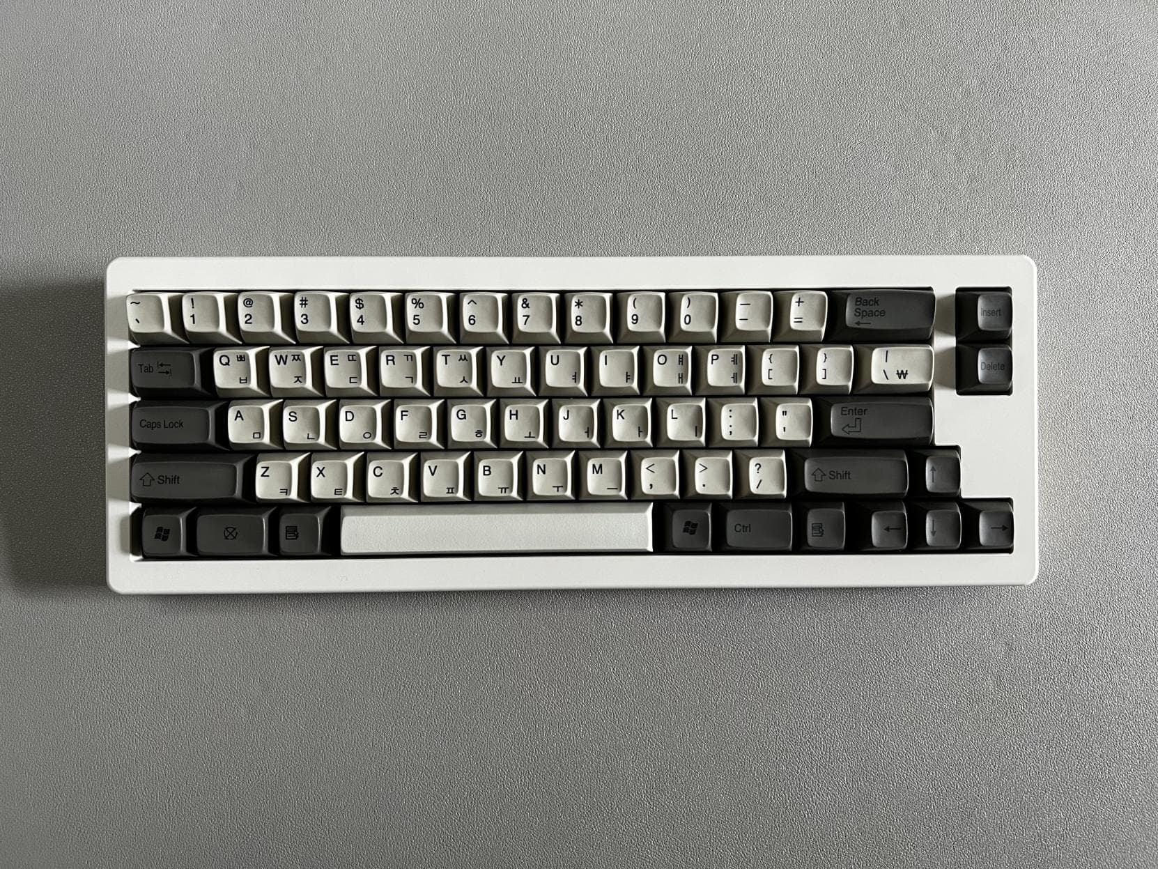

Modded FC660C:
TX-66C case w/brass handles
104UK Hi-Pro keycaps
Deskey Tiffany domes V1
205g0 lubed sliders
Dielectric grease on mods and spacebar
Unreal X Deskey housing gaskets
