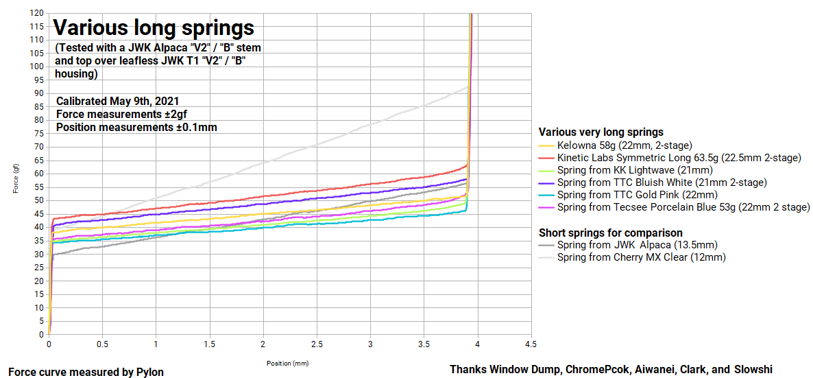

It’d be nice to see force curve of all the springs being retailed. I’m particularly interested in force curve of extra long springs and multi-stage springs.
Pylon’s force curve measurements are on Github here: Open-Switch-Curve-Meter/Force curve measurements at main · bluepylons/Open-Switch-Curve-Meter · GitHub
Close to the bottom of the page there’s the section for Springs, its really long so I’d suggest using ctrl+f to jump directly to the springs section.
Here’s the curves he has for longer/multi-stage springs.
Wow. That’s just great. And all I had to do was ask.
very interesting. Seems all of the long springs have virtually identical linear curves/lines. So I wonder at what point the spring length no longer effects the slope of that curve?
I’m dumb, I just realized all of the long springs are within 1mm of each other in length. I would love something with a curve between the 22mm springs and the cherry 12mm spring.

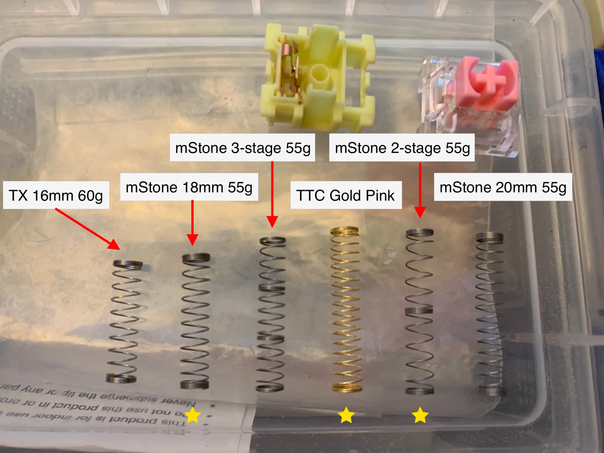

I liked TTC Gold Pink’s chewy feel but wanted a slightly heavier so tried some mStone springs from KPRepublic, mainly for wide variety of spring types at same weight. TX long (16mm) is what I’m currently using in most of my boards so included it in this photo as reference point.
As replacement for TTC Gold Pink, two winners:
- mStone 2-stage 55g - chewy like TTC Gold Pink, slightly heavier top weight
- mStone 18mm 55g - chewy like TX 16mm 60g, slightly heavier top weight
Two are close but differs slightly in how it’s chewy. 18mm is slightly heavier at top than 2-stage but the later is more bouncy at the bottom, making it closer to TTC Gold Pink. Because of heavier top weight, 18mm will feel more speedy or shorter in key travel and bottom out more loudly, making it more appropriate for great sounding switches like Cherry black. TTC Gold Pink is loud and decently nice sounding but not at the Cherry black level (in my mind) so 2-stage makes more sense.
Both mStone 3-stage and 20mm felt tad too heavy at top for prolonged use but are promising enough to try them again at lower weight.
NOTE: Since these springs don’t come with spring top weight, I went with 55g bottom-out weight to get a good feel for how these irregular springs differ. Too early to generalize nor expect linear dynamics but, for at least 18mm and two-stage, reducing usual bottom-out by 5g is a good start. For 3-stage and 20mm, I’d reduce by 7~10g.
DISCLAIMER: I could be wrong and have been wrong countless times (lost count out of self-interest) so take a basketball sized grain of salt before bed and don’t call me in the morning.

Early in-use feedback on mStone 55g springs.
Despite initial impression, I chose to use 18mm and 20mm single-stage springs in two boards. Used 18mm with TTC Gold Pink and 20mm with Hyperglides. In switch tester, 20mm felt tad heavy but not in-use. Both feel really good, arguably more lively than my usual go to spring: 60g TX 16mm.
I punted on two-stage and three-stage springs this round because, when I tried them on a single row, they felt less lively than 18mm and 20mm. That said, I’m no longer sure what role switch housing played.
Some mysteries:
- 20mm lowered pitch slightly, making me wonder if added pressure against top housing due to pre-load may have caused the change.
- 20mm and three-stage springs initially felt tad heavy. They don’t in-use.
I also had this thought, BOX Navies are lower pitched than BOX Jades despite having only one difference, the spring.
