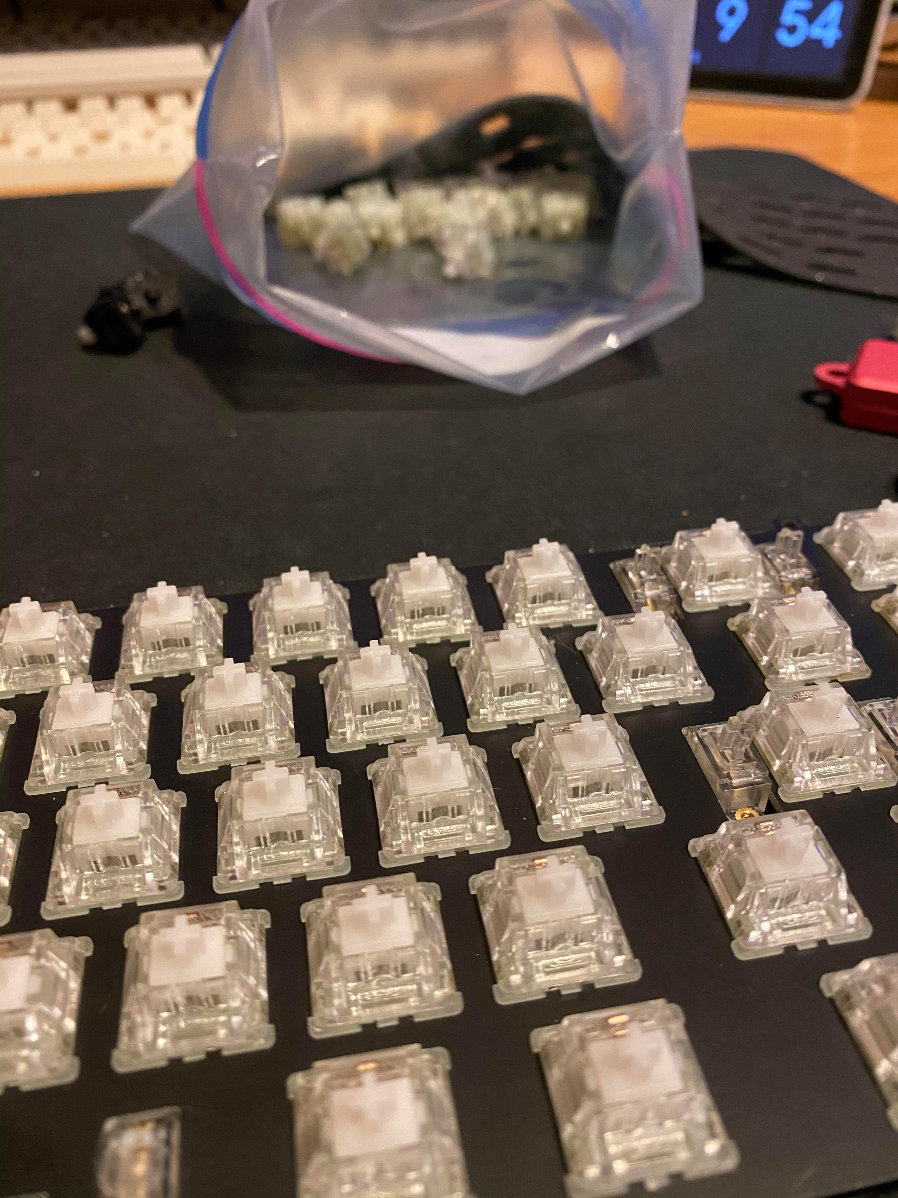

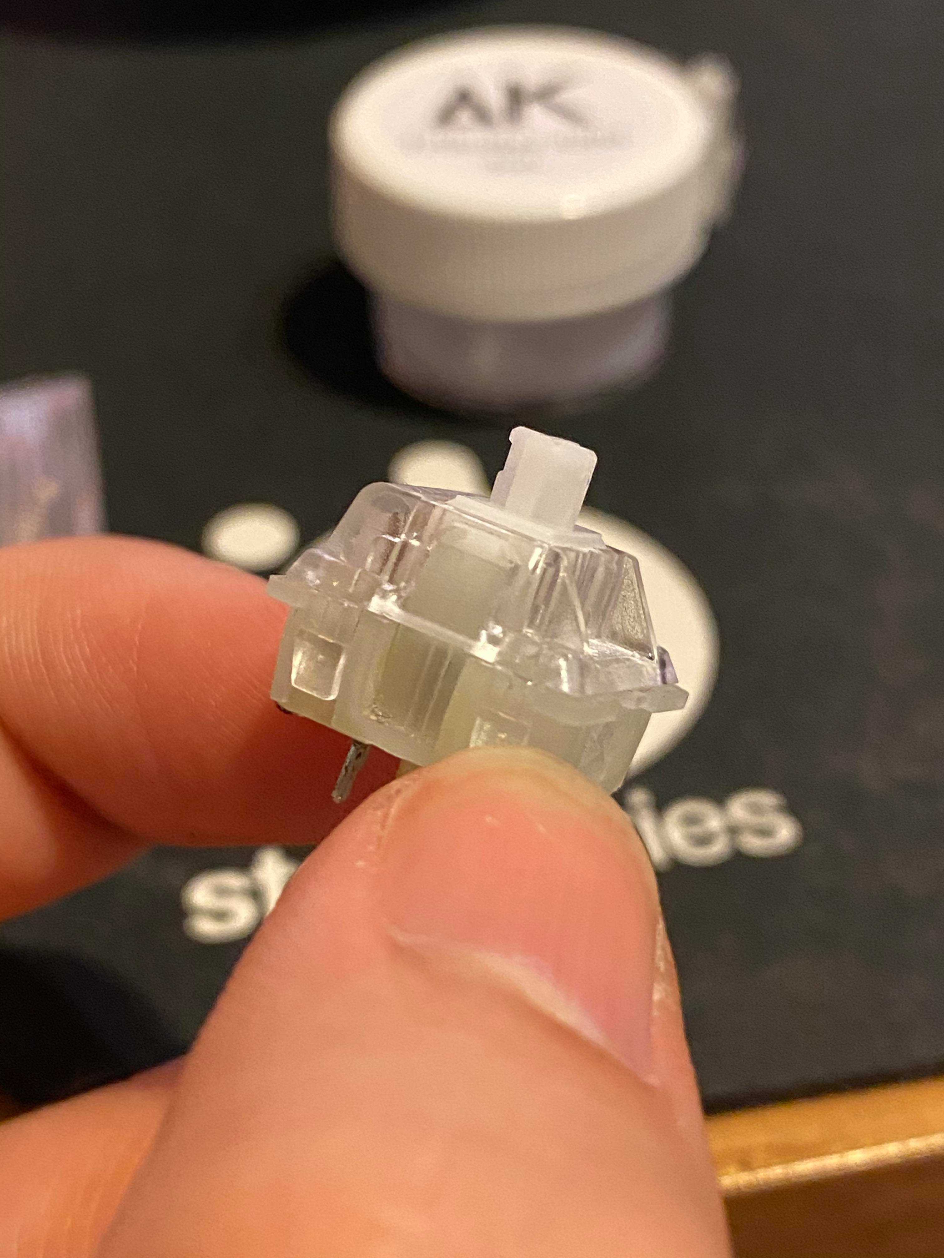

Finally got around to getting a friend to desolder my Coolermaster Masterkeys Pro S with Cherry MX Blues last night (bless her soul), and I threw these together just now.
I really like the feel of the tactility of these. It’s similar to the medium tactility of my Deskhero POM Pandas but with the bump after the start of the keypress, with what feels like 4mm of full travel for a satisfying bottom out travel after the bump.
My only gripe with this switch would probably be a slight return issue, that carries forward from Ergo Clears. It’s a little bit more apparent than the return issue of Ergo Clears, but it’s really no big deal to me. Using heavier 67g springs did nothing to change this, since the issue is at around the activation force which most linear springs would not have too much energy at. Instead, Sprit 63.5g Extreme Slow springs seemed to do the best job. I love these.
