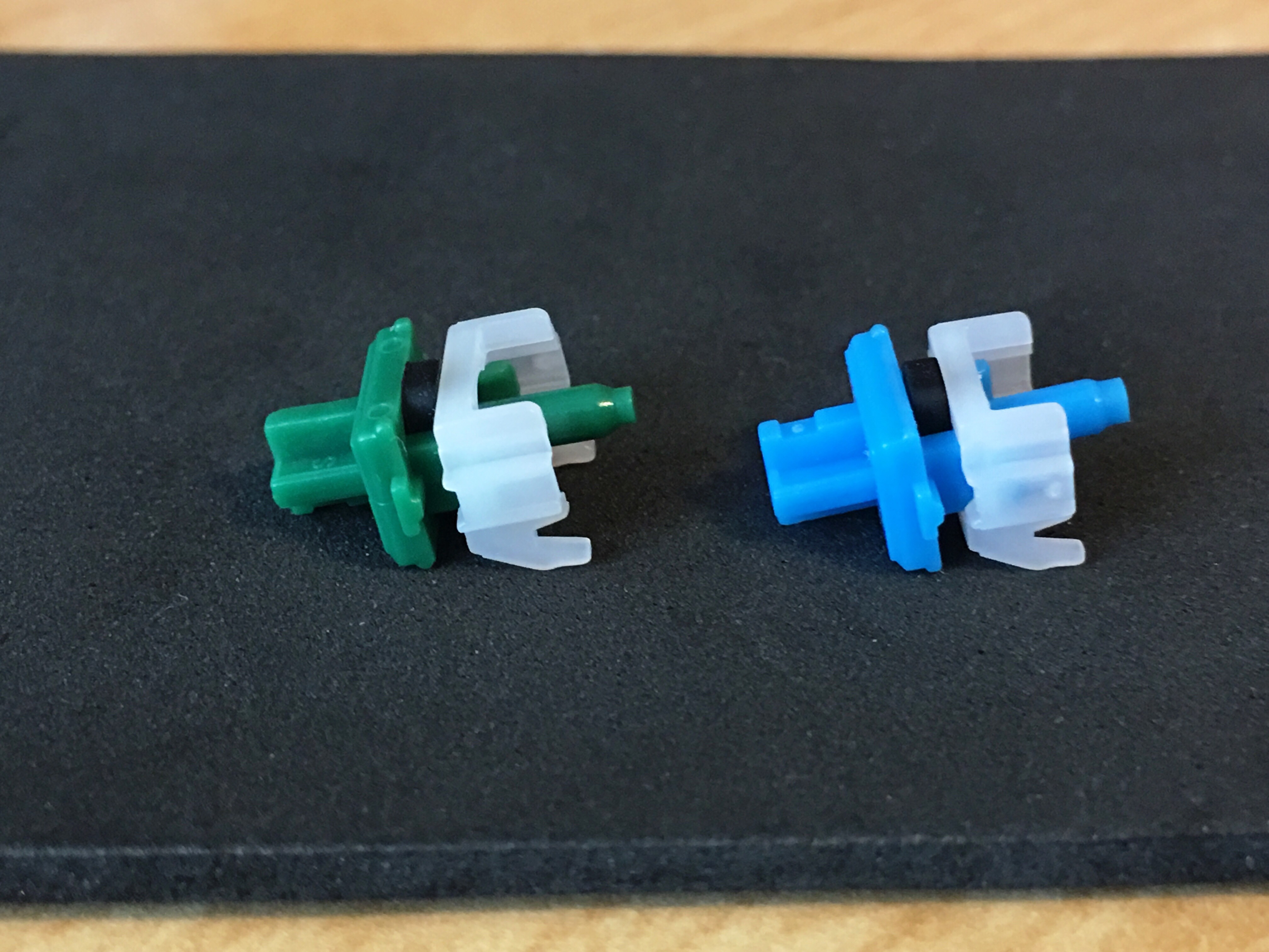

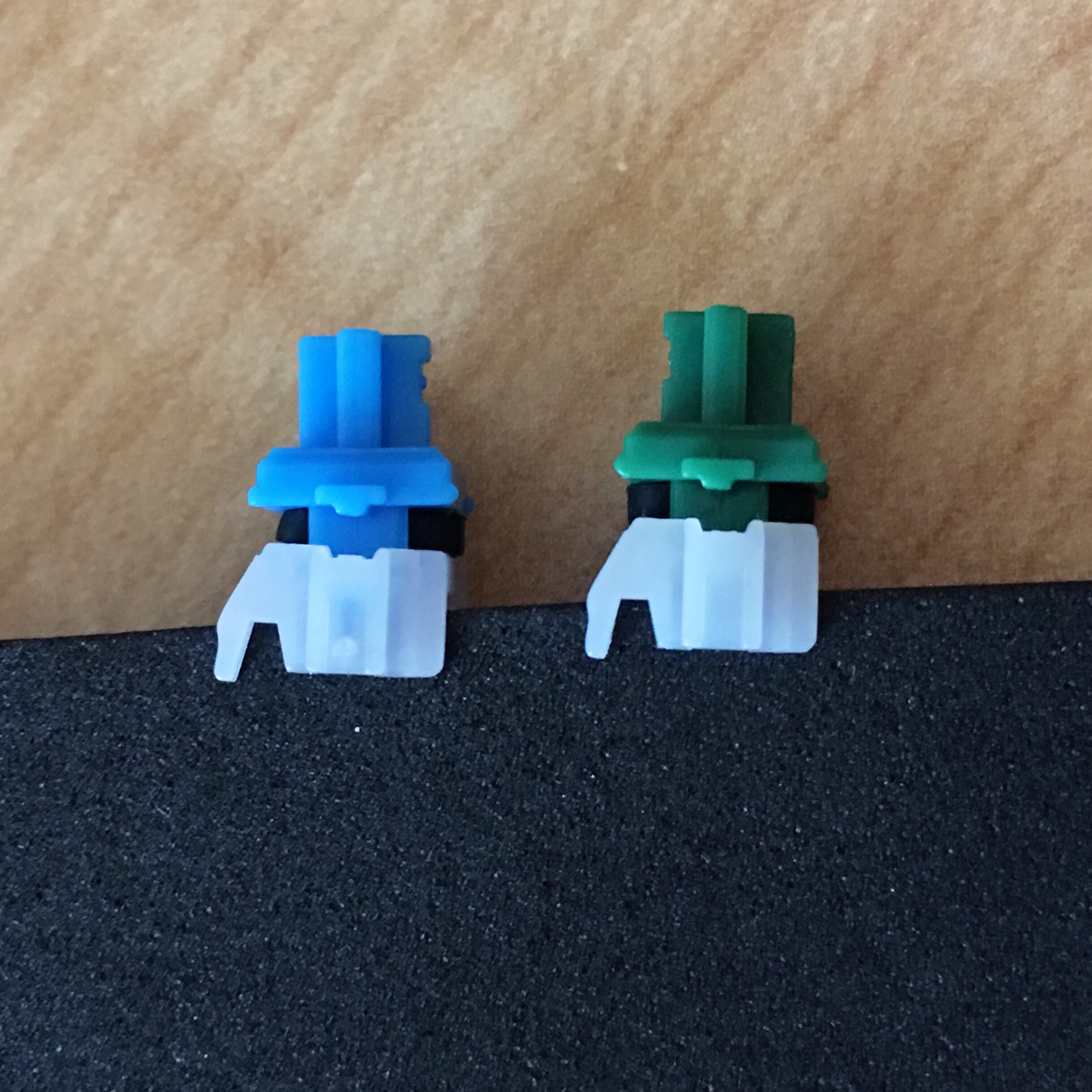

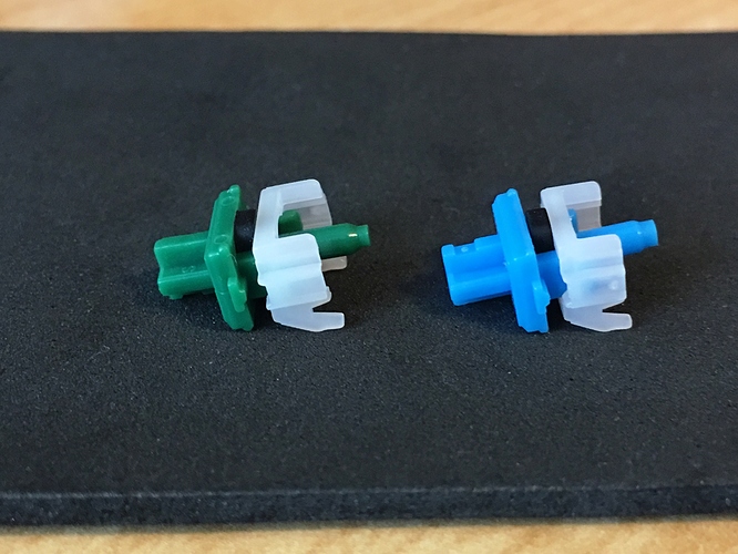

I bought some J-spacers from thevankeyboars and some 50g springs. The mod was a bit tedious, but I got it finished and I’m really pleased with the switch. I put them in one of my hotswap boards for the moment.
I modded all 100 of the switches that I had, and I ended up pruning out 8 or 9 due to irregularity in sound. Some of them had a tiny click still and some were extra noisy on the way back up. I’m not sure if it’s tolerance issues with the jspacers or if it’s the leaf spring or stem. Anyway, I ended up with almost all of them usable.
When you insert the spacers between the stem and the click jacket, you are essentially making a very long stem that sits right at the bump and actuation point. Also, the spring will be partially depressed at the top of the switch movement, making it feel significantly stiffer than normal. I highly recommend 50g springs for this mod.
