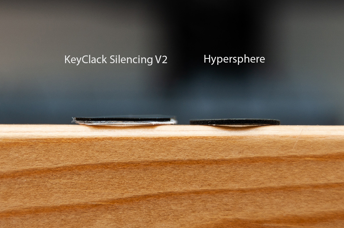

Here’s a comparison of the thickness of a V2 ring and a Hypersphere ring. Please excuse the shotty image quality, unfortunately I don’t own a macro lens.

Great pic! Thank you so much for that! does it get any thinner when you peel the adhesive paper backing off? at the moment it looks like it’s riding a bit high compared to the hypersphere, but looking at only the black rubber part, it looks thinner to my eyes
I haven’t tried peeling off the paper yet. I can try doing it tomorrow and take a new picture. But the V2 is definitely thinner than the Hypersphere, at least by a good 25% I’d say.
v2 appears to be about twice as thick as v1 rings. Key travel wasn’t noticeably short but I only tried a few keys so YMMV. I am planning to put back BKE Redux domes along with these rings because, while v1 was OK for stock HHKB 45g domes, v2 should be better with more ‘violent’ domes.
