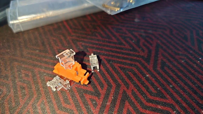

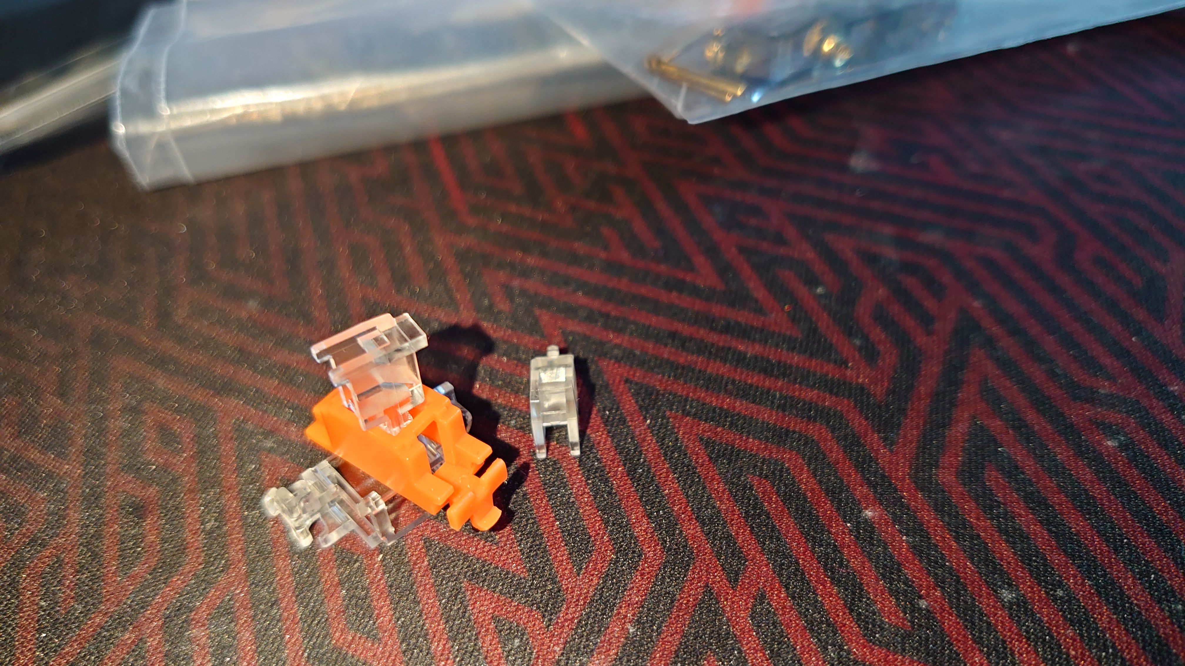

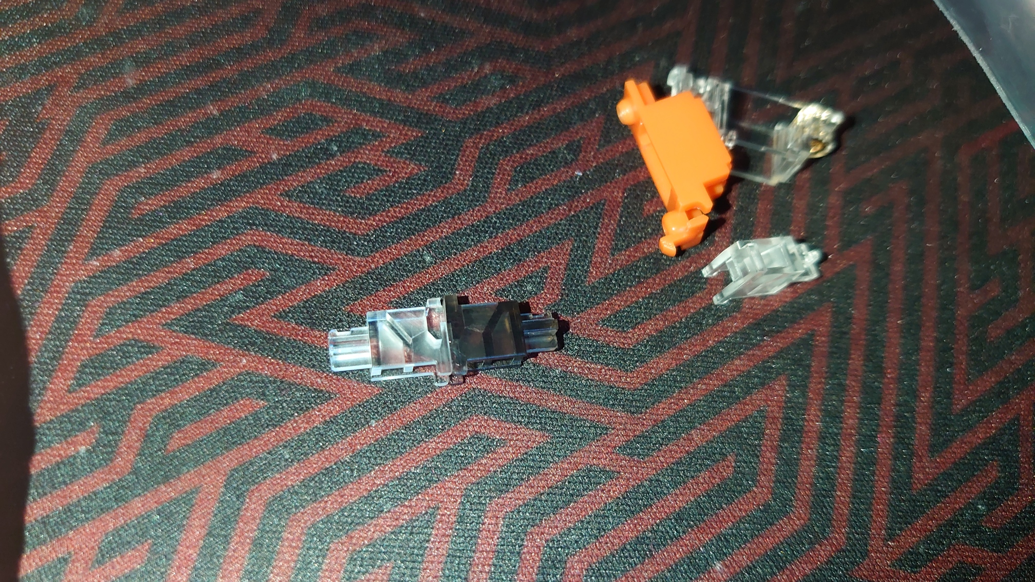

My Durocks don’t have legs to clip of.
Whoa, when did they make that change? (another notch in the “Durock is really differentiating its stabs from their initial offering of a knockoff of Zeal V1 stabs” counter)
Yep you’re right, do not clip anything. The legs you clip off of Cherry stabs is for a softer landing & most others do not have them. If you clip any of the legs on a Durock or Zeal it’ll have nothing to catch the slider on the top out.
