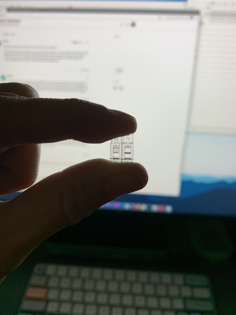

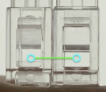

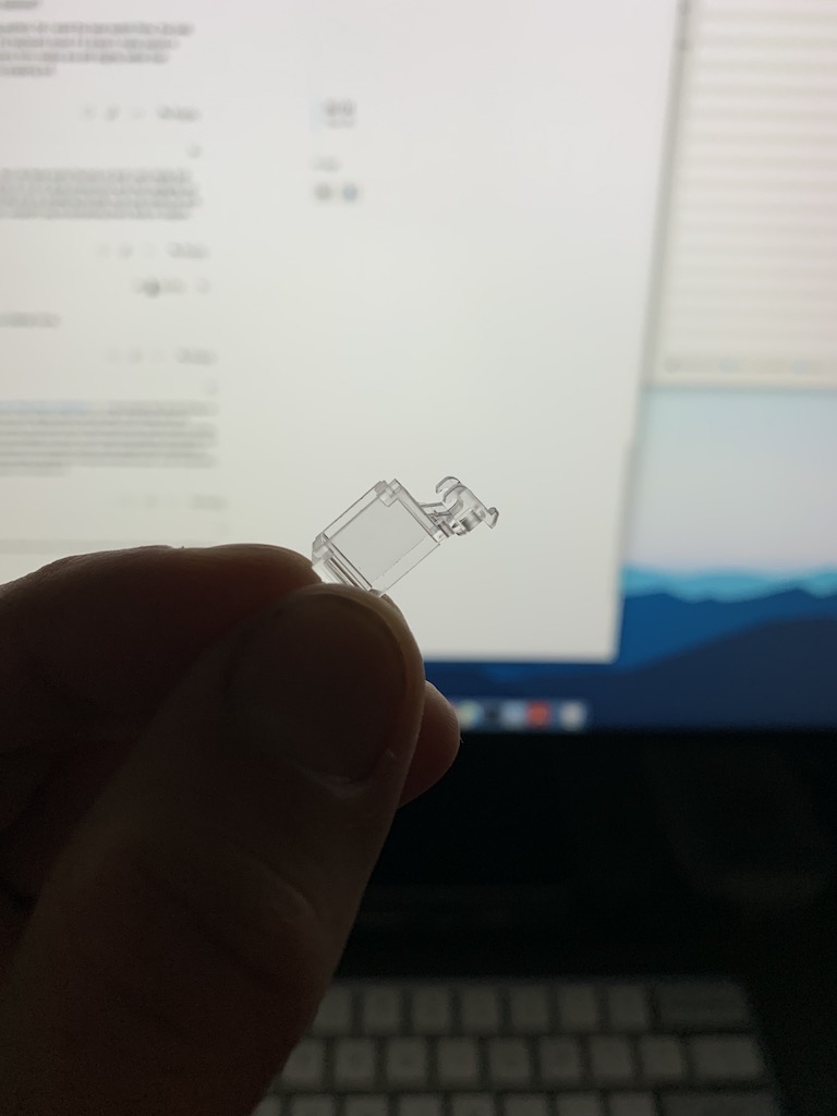

ZealPC (left) and Durock v2 (right)
Thanks for the comparison between the two stabilizers. So I understand it correctly that you still feel Zeal Stabs a bit smoother? (but the redesign with the preventing the wire from popping out is awesome)
Oh they’re both incredibly smooth. I can’t discern any difference. However, ZealPC’s tighter slider tolerance is a stab-rattle killer. I’ve never popped out a stab wire myself, but I hear it’s not a good time. It’s really what matters most to you. But if you frankenstab them, you won’t have to settle.
The pictures that we truly needed to see!
I might be wrong, but I believe that extra rectangle of plastic on the bottom on the zeal stabilizer insert is designed to break inward as you insert the wire.
I always use zeal or durock stabilizers. After lubing I cannot tell a difference. I use 205g0 on the housing inside and the sides of the insert. I coat the ends of the wire in superlube (dielectric grease) before putting them in.
You’re right. More of a bend I think, allowing the wire to rest on the area it creates for itself.

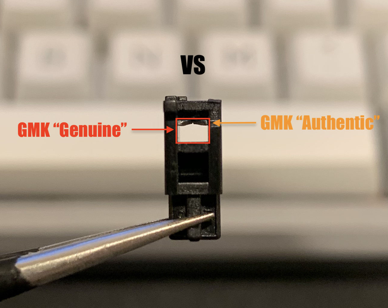

In the name of science, I purchased some “Genuine” GMK plate mount stabilizers from Kebo thinking ZealPC was slipping. I should have known better. ![]()
TLDR; there’s a huge difference between the two. Below is a ZealPC stab insert showing the extra material designed to bend around and cradle the wire upon insert. Seems like a solid solution for preventing unwanted vertical/horizontal wire movement or rattle. It looks like NK_ makes a point to use the word “Authentic” when describing their plate stabs, so there might be something going on here.
Is GMK “Genuine” code for cheap clone?
