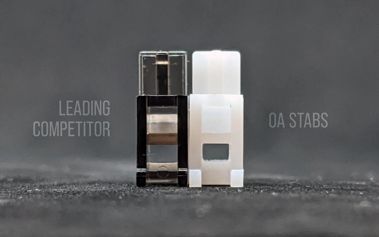

Ooo. I so hope this becomes the standard.
Do we have a term for this difference? We were kicking around “Zeal Seal”, but it turns out Cherry (snap-in) was the originator.

I just built my Ikki68 Aurora and which came with some OA stabs. So far so good (granted it’s only been a couple of days). They feel as good as the C3 stabs for sure (they have a similarly deep sound), and also feature metal thread inserts.

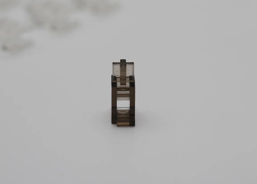

I’m into wrapping the stab wire now when modding so tight stem tolerances aren’t much of a concern for me anymore, but I think ispy that extra mold plastic Zeal does with Swagkey’s new V2. In a smokey too, classy.
They do sport the box housing design still, something KBD and AEBoards seem to moving away from.
