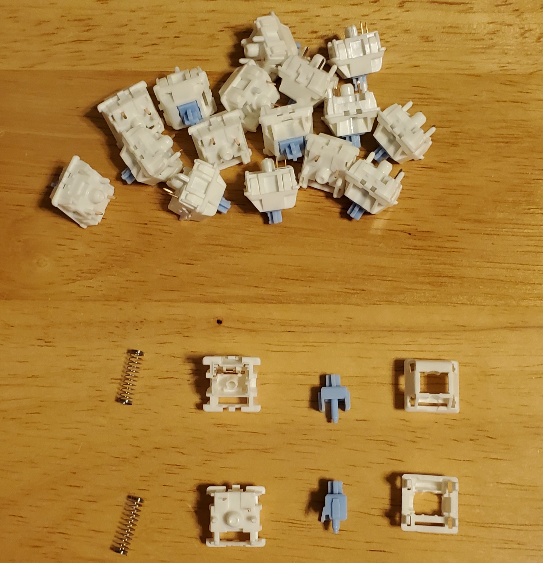

I got my hands on the tactile Blue Velvets.
They’re impressively smooth, and from other people’s impressions of the switch (and other possible recolors) I thought it might be a much smoother panda. They’re however a lot less tactile than a Holy Panda.
After comparing a halo stem with a Blue Velvet stem though I have to say they both look really similar. I put a Blue Velvet stem in a leftover YOK Panda housing and I couldn’t feel a difference.
Hmm wonder if they’re using the same leaves for both the tactile & linear variants? That would account for the drop in tactility even though BV stems & halo stems are shaped pretty much the same.
They’re likely the exact same, just different colors for the linear and tactile variants.
IMO, the tactility was disappointing. To make the most of it you could put a two-stage long spring in it and that could make it a bit more tactile, almost like a Holy Panda.
But I also think the stems will be great alternatives to Halo stems since they feel the same at least to me (and maybe smoother if Holy Panda’s scratch is partially because of Halo stems???), and the tactile Blue velvets are cheaper than Halos.
